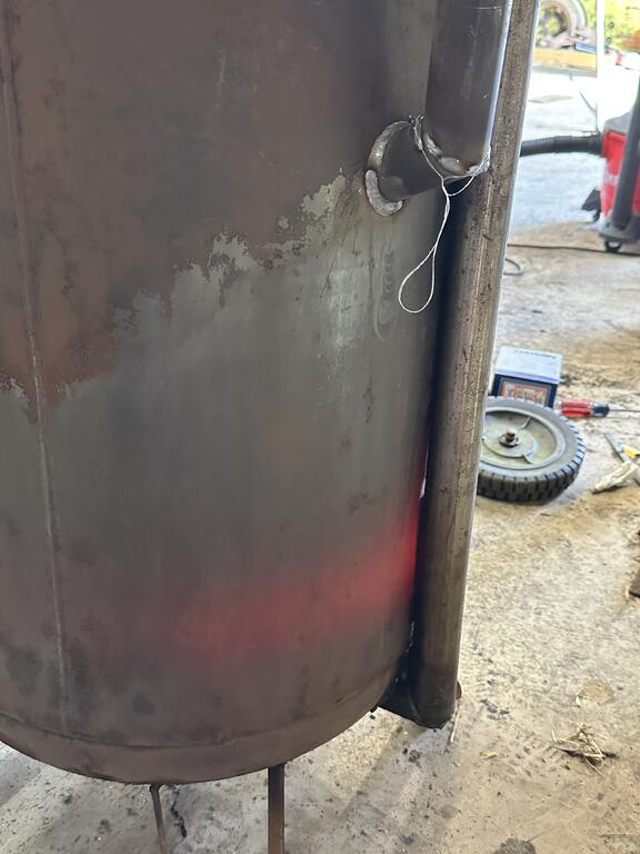

Pullstart 71,561 #84 Posted February 25, 2025 I just shut it down. Once the fire was out, my rotor stack was close to 950 degrees without fire. 2 3 Share this post Link to post Share on other sites

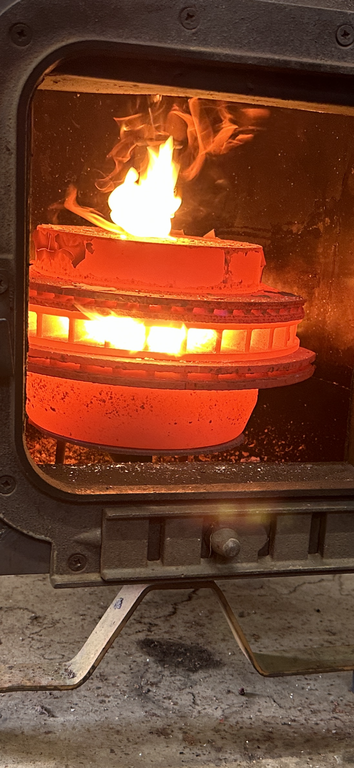

Pullstart 71,561 #99 Posted March 7, 2025 I finally achieved a good hot burn! It was fun to ramp this up to the point of making the entire burner system glow. 3 6 Share this post Link to post Share on other sites
