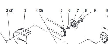

Rick53 3 #1 Posted February 12, 2025 I an older toro 264H tractor with a snowthrower 79263 attached. Looks new. It was shipped. So the snow thrower was taken apart. Here's what I can't figure out for parts schematic pictures. Can you buy any type of basic chain ? There's no chain. The idler pulley has 2 washers a bolt, nut and I'm assuming a spacer. Does anyone know the order they go in? I am not sure if the spacer goes after the idler pulley when setting on the chain or at the beginning. I'd sure appreciate some advice Share this post Link to post Share on other sites
gwest_ca-(File Mod) 12,017 #3 Posted February 12, 2025 The illustrated parts lists should show all the parts and how it is assembled. Share this post Link to post Share on other sites
Lagersolut 793 #4 Posted February 12, 2025 (edited) 29 minutes ago, Rick53 said: I an older toro 264H tractor with a snowthrower 79263 attached. Looks new. It was shipped. So the snow thrower was taken apart. Here's what I can't figure out for parts schematic pictures. Can you buy any type of basic chain ? There's no chain. The idler pulley has 2 washers a bolt, nut and I'm assuming a spacer. Does anyone know the order they go in? I am not sure if the spacer goes after the idler pulley when setting on the chain or at the beginning. I'd sure appreciate some advice Toro is very proud of their chain - around/over 100 when restored mine 5 years ago - option two is tractor supply for a roll - I went with the roll bought a chain break was still 50-60 bucks ahead - should be 40 chain - 10 foot roll you'll have enough left for a spare Edited February 12, 2025 by Lagersolut 2 Share this post Link to post Share on other sites
Rick53 3 #5 Posted February 12, 2025 9 minutes ago, Lagersolut said: Toro is very proud of their chain - around/over 100 when restored mine 5 years ago - option two is tractor supply for a roll - I went with the roll bought a chain break was still 50-60 bucks ahead - should be 40 chain - 10 foot roll you'll have enough left for a spare Aah thanks I have several chain brakes . Tractor supply is just down the road . I have an electric bike chain I thought might work . Appears to be just as heavy duty. Do you have any idea the order of where the spacer for the idler pully goes ? Share this post Link to post Share on other sites

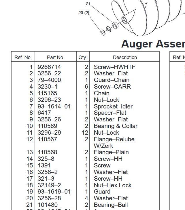

Lagersolut 793 #6 Posted February 12, 2025 (edited) 23 minutes ago, Rick53 said: Aah thanks I have several chain brakes . Tractor supply is just down the road . I have an electric bike chain I thought might work . Appears to be just as heavy duty. Do you have any idea the order of where the spacer for the idler pully goes ? Inside between the idler and blower frame #8 is your spacer - I put a new nylon lock nut on my idler .... Edited February 12, 2025 by Lagersolut Share this post Link to post Share on other sites

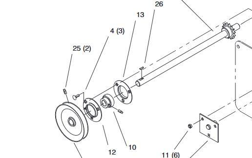

Lagersolut 793 #8 Posted February 12, 2025 (edited) 40 minutes ago, Rick53 said: Nothing should be sticking - sticking makes me wonder and nervous a bearing is getting tired - you have 4 bearings - 1 on each side of the blower drive shaft - 1 on each side of the auger - # 21 is the auger bearings - #10 is your main drive shaft bearings - the bearing plates on the outside for the auger can be stubborn but once you get them started it's a cake walk - if I had to guess the auger bearings is the first thing I'd check - moisture can get in there - replaced all 4 on mine because my luck if I didn't - spin one with 2 feet snow in the driveway . Bearing 10 part # is 110569 Edited February 12, 2025 by Lagersolut Share this post Link to post Share on other sites
Lagersolut 793 #9 Posted February 12, 2025 I priced your bearings on the bay - 16 for the shaft ( each ) 12 each for the auger both free shipping 1 Share this post Link to post Share on other sites
Rick53 3 #10 Posted February 14, 2025 Yeah thanks I really appreciate this . Where are you finding these quality schematics . The one's I've found are the same drawings but you can't really see anything. These you are posting are great . I ordered auger bearings as well as shaft bearing collars . Found a place on the bay . Looked them up and ordered direct. Should be here Saturday . Saved a few more $$ from buying them thru the same place directly . Again many thanks I sprayed some molly grease as a temporary solution on the auger where bearing is . Smoothed it right out . So that is obviously the part of the culprit . There mist be some rust on the shaft . I loosened the bearing collars and they refused to move . Same for the pully . It's friction welded. Even after removing the 2 set screws holding it in place . It won't budge Rather then force, I sprayed WD and will let it set. Might have to use a heat gun to get it off. For now it appearing the auger bearings are the main issue. Fortunately you can get these parts from somewhere other than Toro Dealers MORE ISSUES Looks like my main problem is the shaft collar bearings . It came with 2 new looking belts . Both say toro and match the serial numbers . They fit fine . Hard to get on . I checked the adjustment on the 2 rear idler pullies and that looks fine .Other then the spring is loaded with rust .When I engage the PTO after a minute or less the belt will fall off . Looks like when the PTO is engaged there is some side to side play of the shaft .I don't have the new ones yet to check . It appears by the pictures you posted The collar and bearing fit together as one piece. If that's correct . both mine appear to be broken allowing the shaft to go back and forth. It's not much but appears to be just enough the shaft pulley isn't turning concentric . I can see the belt wobble ever so slightly. Sorry to keep bugging you but I have searched all over the net . I find no info at all on the setup. The lift lever doesn't hold up the deck either . It catches and then slips out of the slot. Doesn't appear to be damaged . I see there's a way to adjust the lever pull height . I assume that only effects a mower deck . I didn't even know that adjustment was there . Yet everything that goes with the blower mounted just fine. Again sorry to keep pestering you . Share this post Link to post Share on other sites

Rick53 3 #15 Posted February 15, 2025 What about the large pully . Mine doesn't seem to want to budge . I've taken it all apart but obviously can't install the bearing collar at that end without removing that pulley. Do they just come off hard? Based on pictures it doesn't seem to thread on . I removed the 2 small square head bolts . We I be correct it assuming it just needs the rust broken to move it? Thanks . Share this post Link to post Share on other sites
wallfish 19,400 #16 Posted February 16, 2025 1 hour ago, Rick53 said: Do they just come off hard? Yes 1 hour ago, Rick53 said: We I be correct it assuming it just needs the rust broken to move it? Yes Share this post Link to post Share on other sites
Rick53 3 #17 Posted February 17, 2025 (edited) On 2/15/2025 at 8:03 PM, wallfish said: Yes Yes You were right . Thanks . I also had to cut the bearing collar on the sprocket end . It wouldn't budge . Dremel was a life saver . After taking it all apart there doesn't seem to be much use for the ability to put grease in the flange once put back together . Most of the grease doesn't even reach the bearing collar . I greased the old parts on a regular basis . When I took it apart grease was everywhere except where it would have done some good . LOL Edited February 17, 2025 by Rick53 1 Share this post Link to post Share on other sites

Rick53 3 #23 Posted February 19, 2025 3 hours ago, wallfish said: Original bearings were greasable. Apply anti-seize compound on the shaft before the parts go on and those things will come off much easier for replacement in the future. Sorry for the too late advise but maybe next time Not a problem already thought of the anti seize. I have it all together and discovered the bolt I was sent for the idler sprocket on the chain is bent. You can't tell until you install it . The person I bought this stuff from practically gave it away. He didn't include the chain and idler pulley, Said he lost them . Based on the bolt I'm guessing they were in bad shape . Anyway now the search goes to find that bot Toro 325-8 . Hoping the local hardware might have a substitute . So far on line it's a week to get one Share this post Link to post Share on other sites
wallfish 19,400 #24 Posted February 19, 2025 (edited) 23 minutes ago, Rick53 said: Not a problem already thought of the anti seize. I have it all together and discovered the bolt I was sent for the idler sprocket on the chain is bent. You can't tell until you install it . The person I bought this stuff from practically gave it away. He didn't include the chain and idler pulley, Said he lost them . Based on the bolt I'm guessing they were in bad shape . Anyway now the search goes to find that bot Toro 325-8 . Hoping the local hardware might have a substitute . So far on line it's a week to get one Use a cup point set screw or bolt. Hex head or square head. It's always a good idea to replace them anyway Just search the size https://www.mcmaster.com/products/set-screws/set-screws~/ A good hardware store should have the hex socket type screws. Edited February 19, 2025 by wallfish Share this post Link to post Share on other sites
Rick53 3 #25 Posted February 19, 2025 11 hours ago, wallfish said: Use a cup point set screw or bolt. Hex head or square head. It's always a good idea to replace them anyway Just search the size https://www.mcmaster.com/products/set-screws/set-screws~/ A good hardware store should have the hex socket type screws. Thanks again. for sharing your obvious superior knowledge . Share this post Link to post Share on other sites
