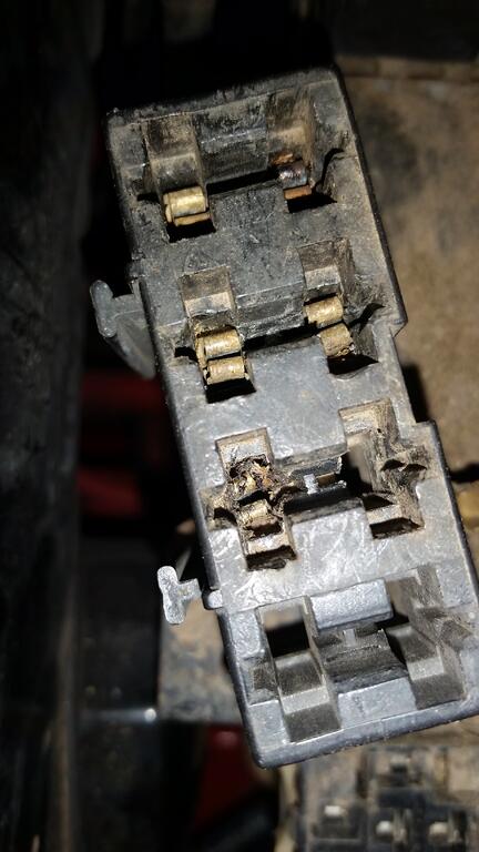

WHX?? 57,640 #3 Posted February 11, 2025 (edited) Cole What Cleat said. Pay attention to any connections long the way that can get hot and burn out. More than one fuse block been melted out that way. On a 516 but same difference. Edited February 11, 2025 by WHX?? 2 Share this post Link to post Share on other sites
