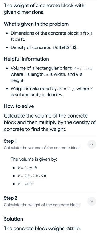

HyperPete 939 #45 Posted February 15, 2025 Do you think I can hang this from the weight box? 😉 https://www.facebook.com/share/15soLNb615/?mibextid=kL3p88 1 Share this post Link to post Share on other sites
Handy Don 17,480 #46 Posted February 15, 2025 Well within the ~11,000 lb capacity of the UniDrive 4 Share this post Link to post Share on other sites
Ed Kennell 47,377 #47 Posted February 15, 2025 11 hours ago, Pete D said: Do you think I can hang this from the weight box? No problem if you have a FEL with the capacity to lift it. You will need to increase the pressure in the rear tires to 110 -115psi. 4 Share this post Link to post Share on other sites
