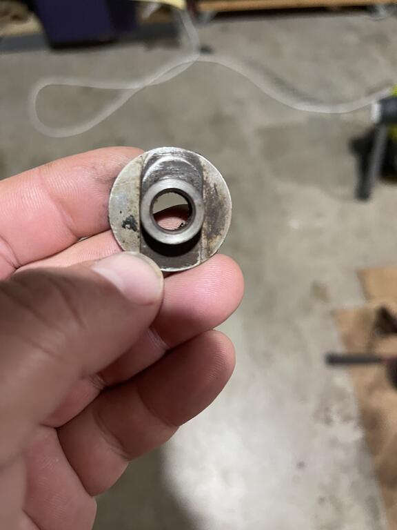

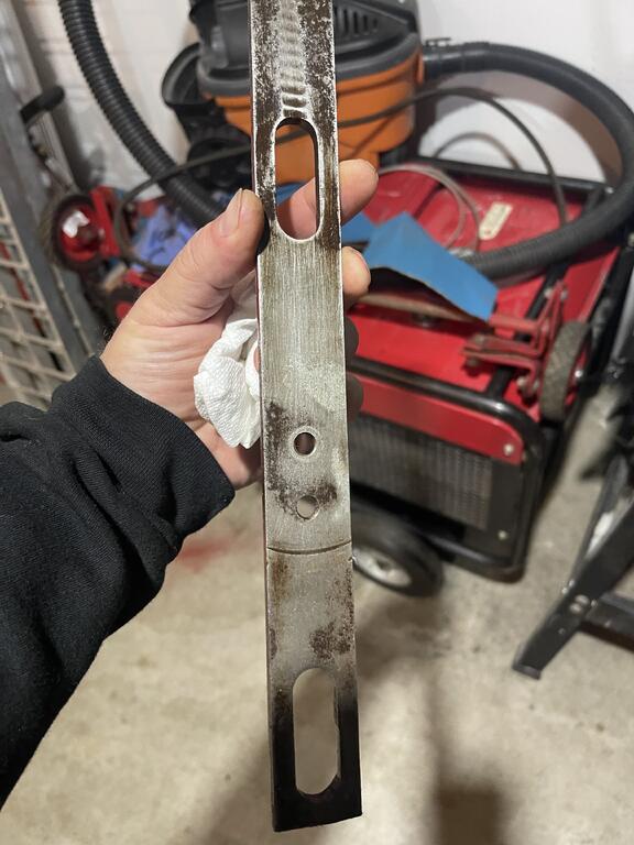

stvski80085 279 #1 Posted February 9, 2025 (edited) It has two of these on the spring loaded tension slide for pulley. One is good and one is really just a flat washer now. I have an exploded view and it doesn't show these at all. Tension slide is not like what the show in the diagram. I added the pic of the bar they slide in. Any help would be great. Steve Edited February 10, 2025 by stvski80085 Share this post Link to post Share on other sites
Lee1977 7,709 #2 Posted February 10, 2025 You have a newer deck then a 1977. they changed the slide to that type of bushing in the early 80's. Looks like a Toro 107674 Spacer Bushing. 1 Share this post Link to post Share on other sites

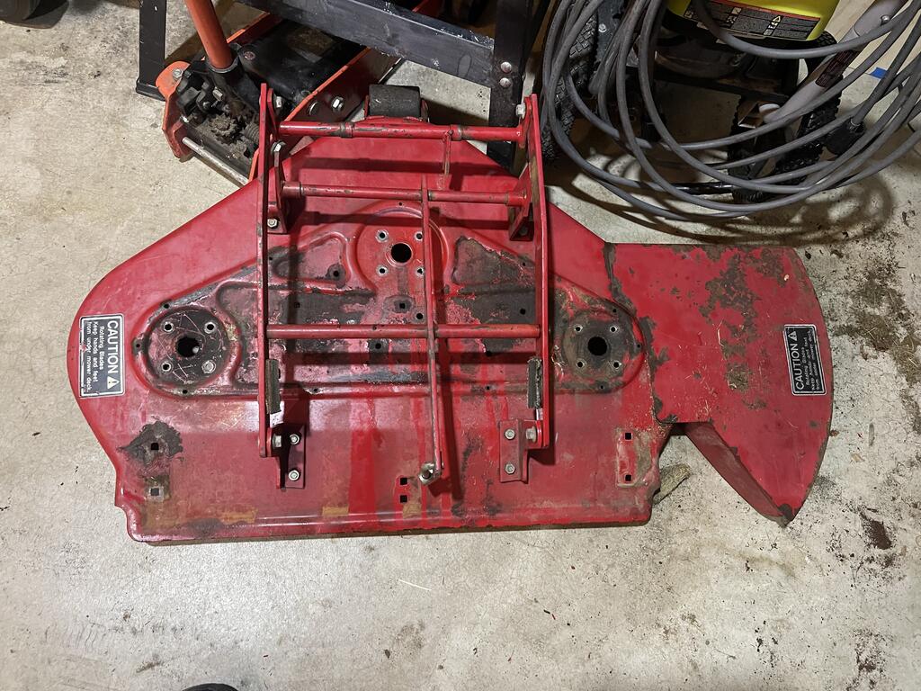

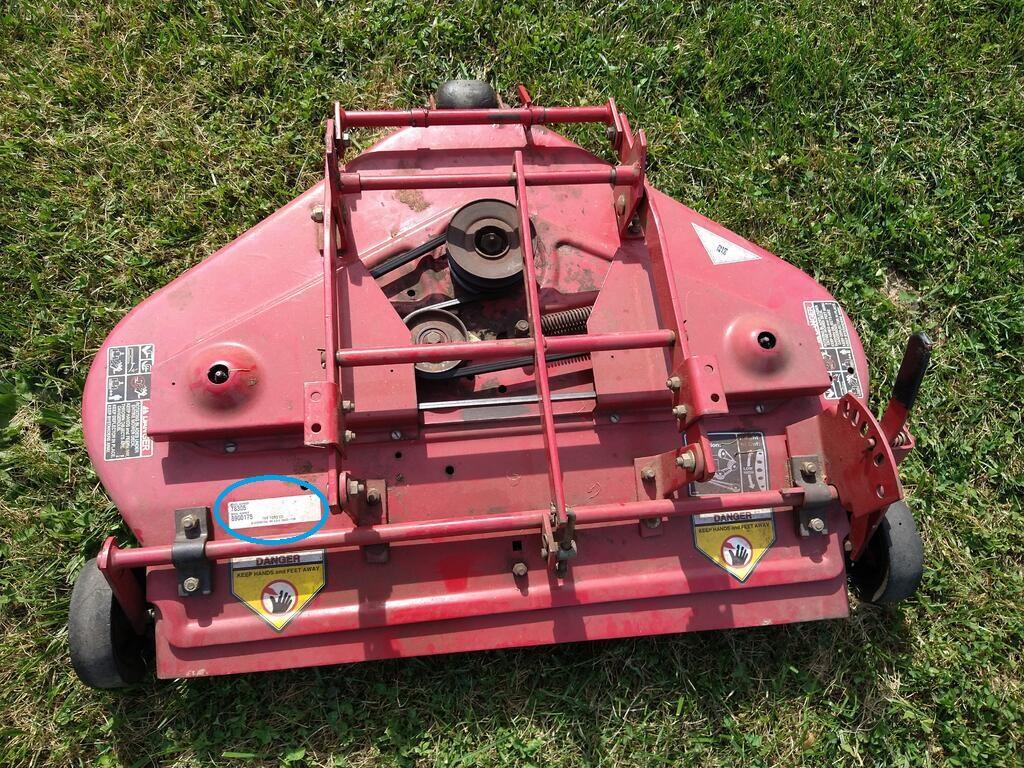

stvski80085 279 #3 Posted February 10, 2025 (edited) ok, That's the info I have on the tractor and he said he bought it all in 78. The info on the tractor is 1977. I will check that part out. That part doesn't have the grooved sides to it.107674 The owner insists it is original to the tractor. I think it's a 65-36ms01 but the tensioner on this one is different. Everything else looks the same. Edited February 10, 2025 by stvski80085 wrong pic Share this post Link to post Share on other sites
stvski80085 279 #4 Posted February 10, 2025 I think you may be right about the part. Maybe it's just a new style but should work. Share this post Link to post Share on other sites
gwest_ca-(File Mod) 12,346 #5 Posted February 10, 2025 Mid year change to the idler tension bar 1977 model 75-36MS02 - First 36" deck to use bushings in center of idler tension bar. 1 Share this post Link to post Share on other sites
