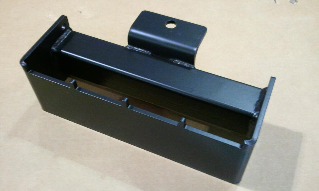

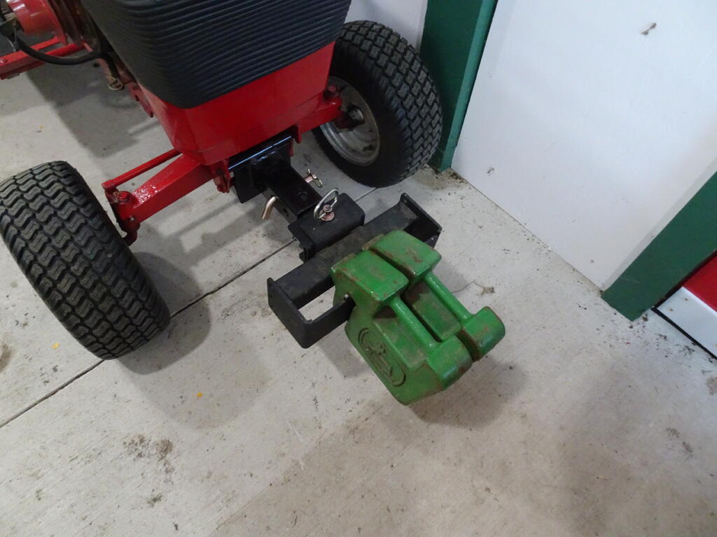

sergeant 350 #9 Posted February 9, 2025 Well This works fine on a Wheel Horse Clevis Hitch called the 4X Multi Suitcase Pinned Weight Receiver from Johnny Products. https://johnnyproducts.com/ordermain.htm#SLVACC $125.00 + shipping. I am still a little Leary of it though because of the cable on the Clevis Hitch. But My Other Tractors with Sleeve Hitch with Mechanical Linkage or Actuator Linkage it works fine on 2 Share this post Link to post Share on other sites
RED-Z06 2,718 #10 Posted February 9, 2025 1 hour ago, sergeant said: Well This works fine on a Wheel Horse Clevis Hitch called the 4X Multi Suitcase Pinned Weight Receiver from Johnny Products. https://johnnyproducts.com/ordermain.htm#SLVACC $125.00 + shipping. I am still a little Leary of it though because of the cable on the Clevis Hitch. But My Other Tractors with Sleeve Hitch with Mechanical Linkage or Actuator Linkage it works fine on That's pretty much what im needing, and i have 4 JD 42lb weights on hand too. Awesome Share this post Link to post Share on other sites

sergeant 350 #14 Posted February 9, 2025 1 hour ago, Goldnboy said: You also use this on the front too! I use it On the front, But it sticks out a Little Far as I am using this WHEEL HORSE/TORO LAWN GARDEN TRACTOR TEMP. FRONT HITCH RECEIVER DRAWBAR ATV | eBay Then I use this https://heavyhitch.com/product/sleeve-hitch-adapter-2-inch-receiver/ and then I finally add the Johnny Bucket weight bracket. 2 Share this post Link to post Share on other sites
