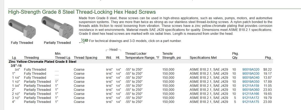

pfrederi 21,342 #6 Posted February 6, 2025 12 minutes ago, mike avad said: This doesn't have a locking nut on it just a bolt and when I tighting the bolt the wheel hard to move? The washer needs to press against the inner race of the bearing and nothing else. If it hits the outer race or the wheel hub it will jam the wheel when you tighten it. I bought some of these a few years ago use them on the left side... 2 Share this post Link to post Share on other sites
