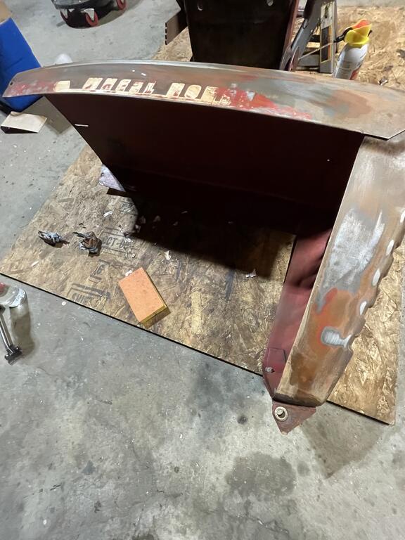

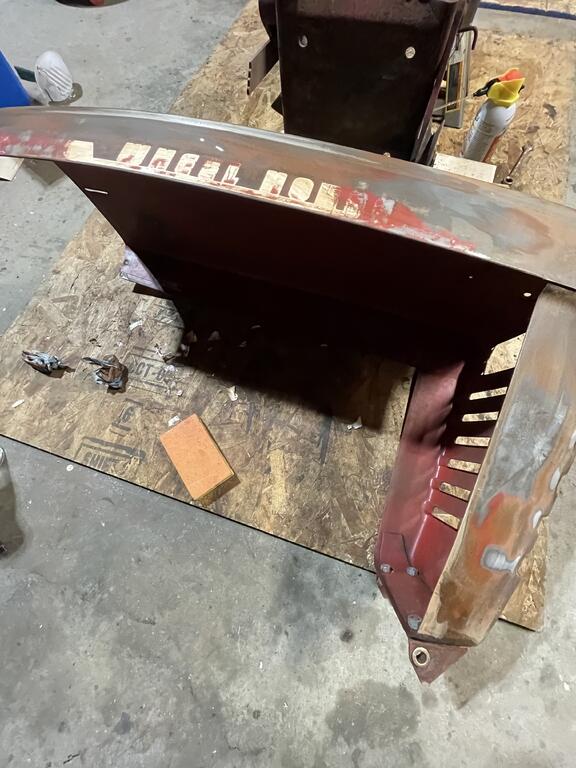

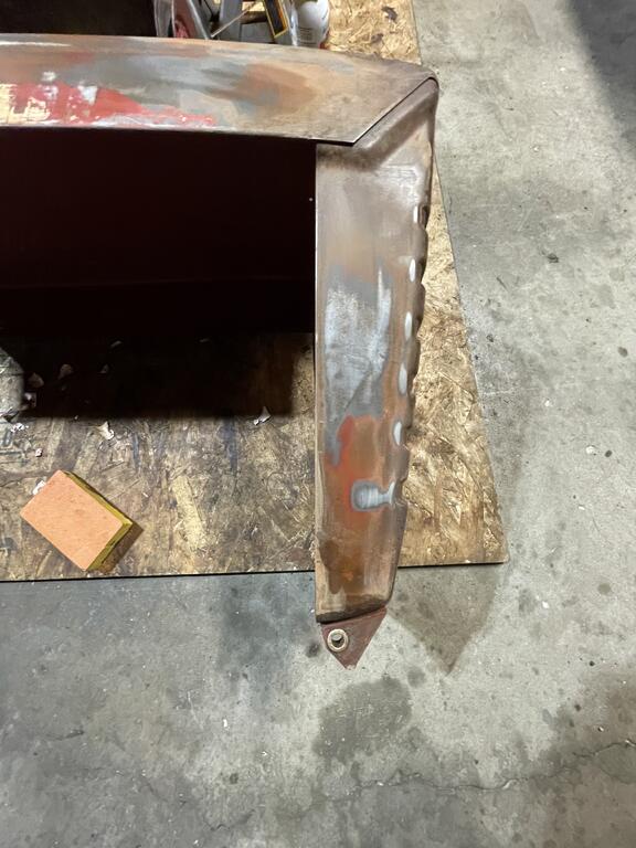

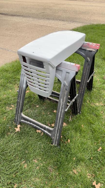

Well, I went and got a paint stripper wheel for a grinder and put on a mask opened up the garage and windows in the garage plus the side door in the garage, and had a fan moving air. And then I got the top of the hood done and realized this thing worked great…..the breathing situation….not so much sooo I went and talked to my parents and we decided to wet sand and it looks ok in my opinion I don’t really know what I’m doing but hey,I’m trying, anyways that’s the update here’s some pictures for yall.
  • Like 5
ebinmaine
Pics?
That might work well for your decals too.

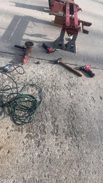

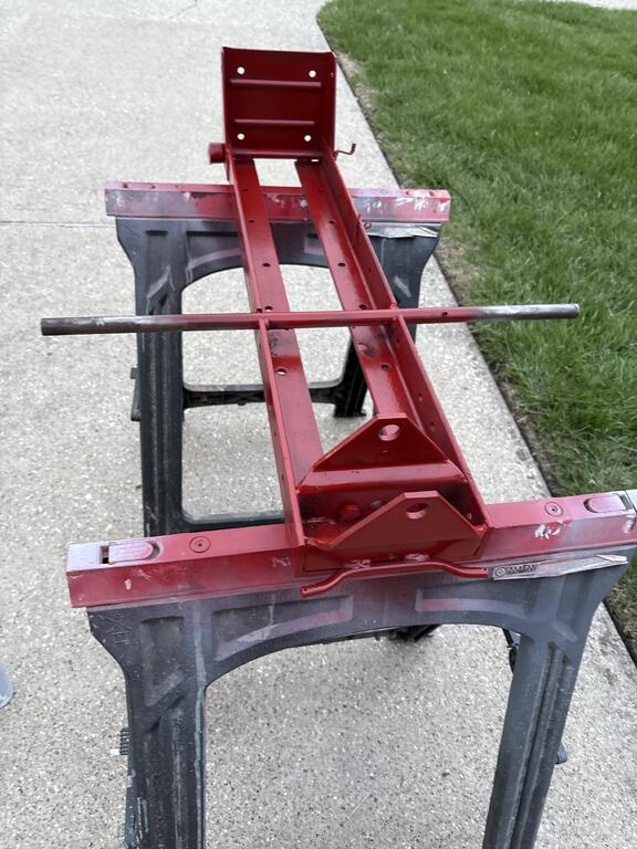

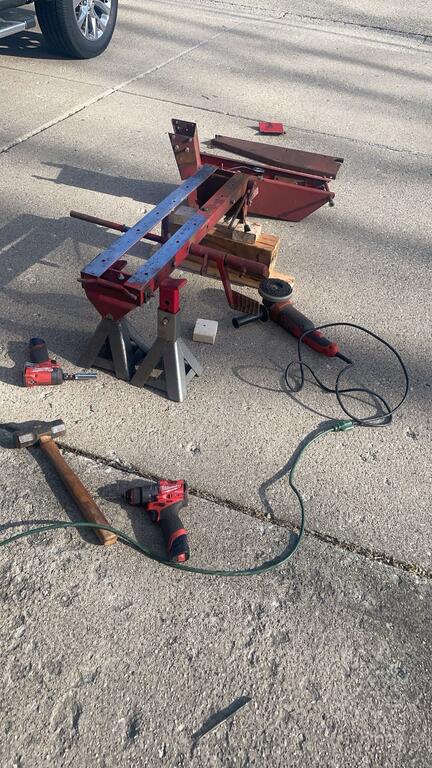

Soo it’s crazy how time flys I can’t believe it’s been a month since I’ve posted on here I’m sorry, weathers been colder so I haven’t been working on the project much until lately this weekend I got the frame and other pieces sanded now I just gotta wait till warmer weather to get it primed not the best pictures but I figured nobody would really care to see sanded metal, also a question for yall,  I messed up when drilling thru the hood support bar and now there’s a broke drill bit stuck in there the hole is all the way thru and I’ve been using a punch go try and remove it and it’s not working is there any other solution to try and get it out?
  • Like 2
ebinmaine
Can you get a close up picture of the bit broken in the hole?
I'm thinking maybe a file and then a punch and maybe a better quality harder drill bit?

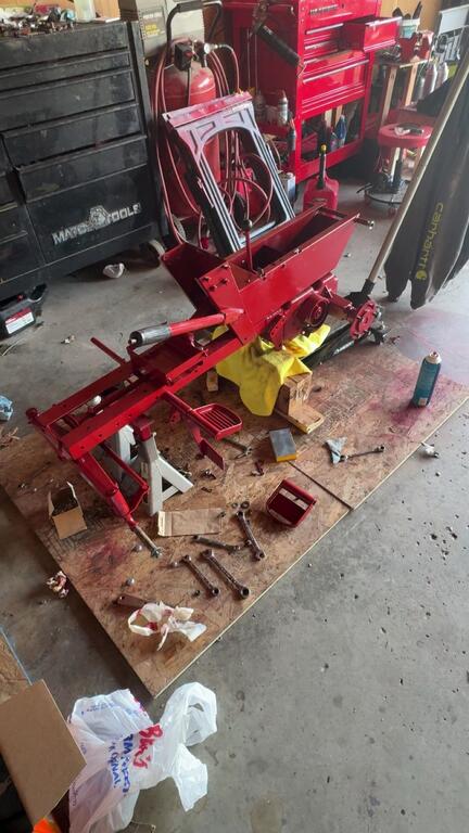

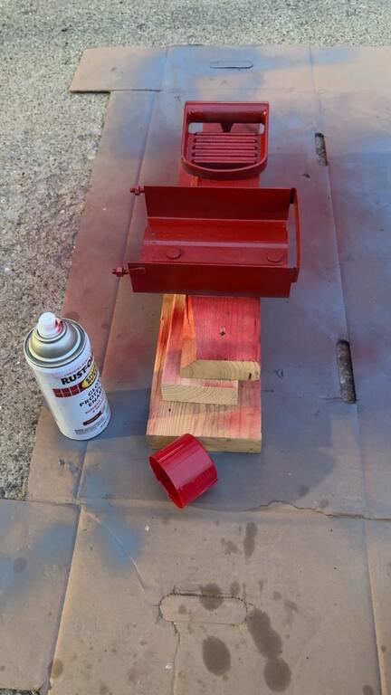

1968Commando
Hello all, update for you all, I’ve gotten alot of priming done and just started pairing last night here’s some pictures for yall to enjoy IMG_4389.jpeg.58c76c8679ae3b05a5a9d064da346d66.jpegIMG_4393.jpeg.57f87685dc3e308324e80bc8f95014f3.jpeg
  • Excellent 5
1968Commando

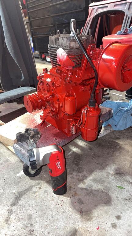

Well it’s going back together!  1 question I am going to rebuild the starter generator how do I go about painting it? Without messing it up IMG_4491.jpeg.cbc7ba1ae14e7ebc258929529f564d84.jpeg
ebinmaine
 I've seen a couple with the case painted separately from the end caps.
Red case. Silver or aluminum caps.
In  the Pic below...
You may want to remove the paint from the drive pulley.  That can cause slippage.
