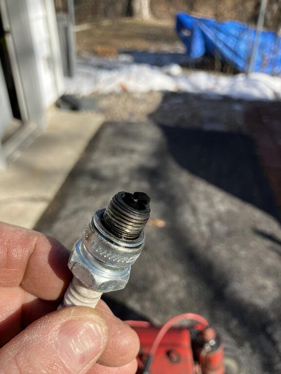

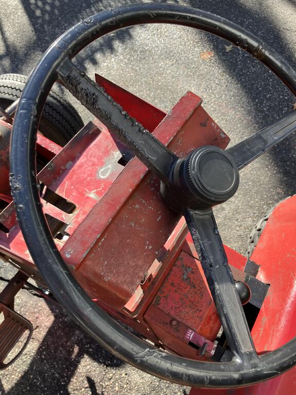

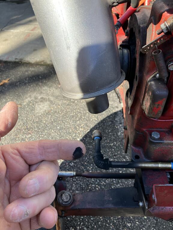

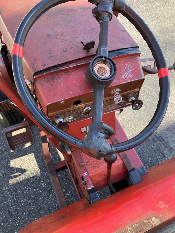

Retired Wrencher 7,043 #1 Posted February 1, 2025 Some of you may remember this tractor being a 1056? It was in bad shape when I picked it up. But slowly working on it. The steering wheel was busted clean by P O. So thanks to @JimSraj for the s/wheel and Mike’s horse barn for the Shaft. Now I have something to steer by. Also engine runs real rich buy the black soot. I did the points two carbs also adjusted these carbs with the same result. I am going to take the head off to see how the valves are doing. Any info on this is welcome. 4 1 Share this post Link to post Share on other sites
Sparky-(Admin) 26,898 #2 Posted February 1, 2025 28 minutes ago, Retired Wrencher said: What’s going on with the spoke of that steering wheel? Mouse chew on it? 1 Share this post Link to post Share on other sites
ebinmaine 81,282 #3 Posted February 1, 2025 47 minutes ago, Retired Wrencher said: soot. Burn any oil? Share this post Link to post Share on other sites
Retired Wrencher 7,043 #4 Posted February 1, 2025 25 minutes ago, Sparky said: What’s going on with the spoke of that steering wheel? Mouse chew on it? Mike that is the way I bought from Jim Saraj. He said what happen to it before I bought it. This 1056 is no show queen. Just my winter plow tractor if I can get to run right. Bad black soot And I di try two carbs on it. Runs better in warm weather. 1 Share this post Link to post Share on other sites
Retired Wrencher 7,043 #5 Posted February 1, 2025 10 minutes ago, ebinmaine said: Burn any oil? Not that I can see Eric. I am taking the head off and also the valves out to check the hole combustion chamber. 1 1 Share this post Link to post Share on other sites
JimSraj 593 #6 Posted February 1, 2025 46 minutes ago, Retired Wrencher said: Mike that is the way I bought from Jim Saraj. He said what happen to it before I bought it. This 1056 is no show queen. Just my winter plow tractor if I can get to run right. Bad black soot And I di try two carbs on it. Runs better in warm weather. Good to see that steering wheel back in use! Whatever chewed up that steering wheel did it before I owed it. It came off of a roller I bought, through Handy Don, for the transmission. It had been sitting around the barn taking up space as a parts tractor for over a year so I finally got around to disassembling it. Still quite a few parts left if anyone needs 1267 parts check out my post in classifieds. 2 Share this post Link to post Share on other sites
Retired Wrencher 7,043 #7 Posted February 2, 2025 16 hours ago, JimSraj said: Good to see that steering wheel back in use! Whatever chewed up that steering wheel did it before I owed it. It came off of a roller I bought, through Handy Don, for the transmission. It had been sitting around the barn taking up space as a parts tractor for over a year so I finally got around to disassembling it. Still quite a few parts left if anyone needs 1267 parts check out my post in classifieds. Jim thanks again for the S/wheel. This is not a show tractor as you can see,so that is why I like it. Some day I will sand it down. Enjoy your week end. 1 Share this post Link to post Share on other sites
Pullstart 71,561 #8 Posted February 2, 2025 5 hours ago, Retired Wrencher said: Jim thanks again for the S/wheel. This is not a show tractor as you can see,so that is why I like it. Some day I will sand it down. Enjoy your week end. If I have any spare 3 spokes, I’d rather trade you and keep that thing all ratty, than see it sanded down. Share this post Link to post Share on other sites

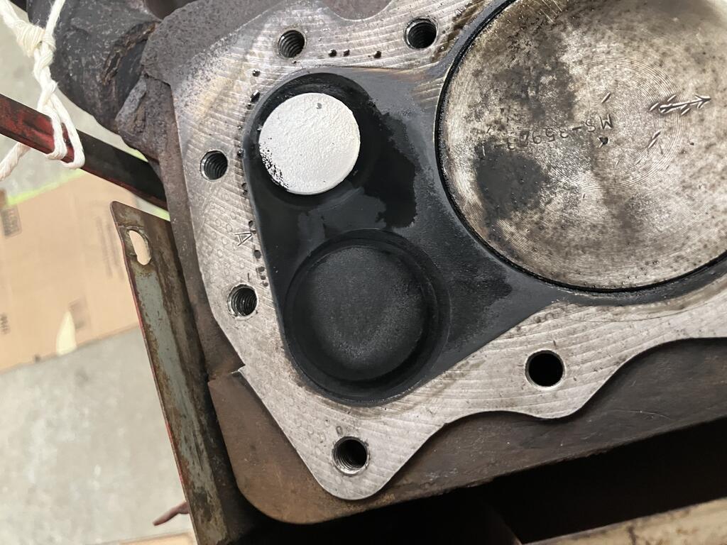

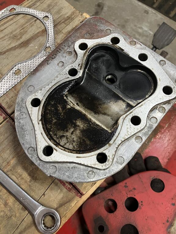

Retired Wrencher 7,043 #10 Posted February 2, 2025 This is a little up date. I send all my carbs to Eric in Maine because I have small part dropsies. So I was talking him to day he seems to remember this cab was border line useable. I am going to lap the valves wile it is apart. Who know when if ever they where done being 59 years of service. Here is a couple picks. 1 1 1 Share this post Link to post Share on other sites
ebinmaine 81,282 #11 Posted February 2, 2025 1 minute ago, Retired Wrencher said: was border line useable Yepp. That one has a well worn throttle shaft so even the replacement bushing didn't solve it. I'll be looking forward to seeing what solves the carbon buildup. 1 1 Share this post Link to post Share on other sites

oliver2-44 11,847 #15 Posted February 3, 2025 @Retired Wrencher If you haven't pulled the valves yet, try this little test before and after to see it you made some improvement. With both valves closed fill the little cavity around the valve head with a lite fluid like penetrating oil. See how low it takes to leak through the valve seat. Also measure the valve stem where it passes through the valve guide and down lower to see how much wear there is. A worn valve stem can cause a valve to never seat well. The Kohler manual list the intake should be 0.3105 to 0.3110 and the exhaust as 0.3084 to 0.3091. While the valve guides may also have some wear, replacing a valve with a worn stem is easy and can at least reduce half the wear. 3 Share this post Link to post Share on other sites

squonk 48,427 #17 Posted February 3, 2025 Looks like some dingleberries got dropped down into the cylinder! 1 Share this post Link to post Share on other sites
Retired Wrencher 7,043 #18 Posted February 3, 2025 You never know Mike. It was not the best shape when I bought it. Share this post Link to post Share on other sites
