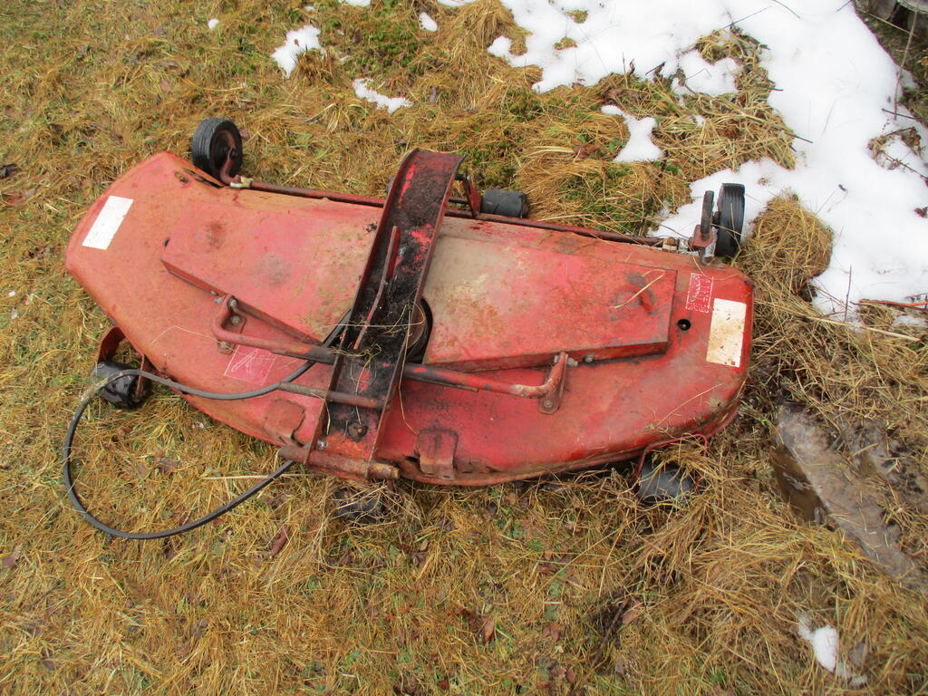

pfrederi 19,271 #4 Posted January 31 3 minutes ago, artfull dodger said: I thought the D series frame was wider so the tach matic lift gear would be wider to match that. I have the front pulleys, tensioner found but not bought, same for my missing mid tach a matic brackets on the frame, someone removed those as you can see it had them at one time. the mid lift is still in place up in the frame thankfully. Hopefully I can roust up a mower deck in good shape soon. Let me get some pics of the GT 14 deck I have. It is trash but the mounting parts are OK..I think... You might be able to put them on a standard WH deck shell. I have tachmatic parts for the D also if you need them. mine has an FEL never a deck.. Share this post Link to post Share on other sites

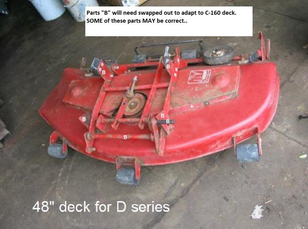

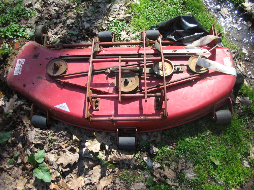

daveoman1966 3,881 #8 Posted January 31 The 48" deck shell and spindles are all the same for C or D series. The lift hardware for the D is different but can easily be swapped out....may have to drill a couple holes in the deck from a C series. Here are two 48" decks...one with lift hdwe for D and the other for C series. 2 Share this post Link to post Share on other sites

pfrederi 19,271 #11 Posted January 31 Just realized the GT-14 deck use the older mounting style won't work on your D ...sorry Share this post Link to post Share on other sites
artfull dodger 440 #12 Posted January 31 Yup, different mount all together. Share this post Link to post Share on other sites
