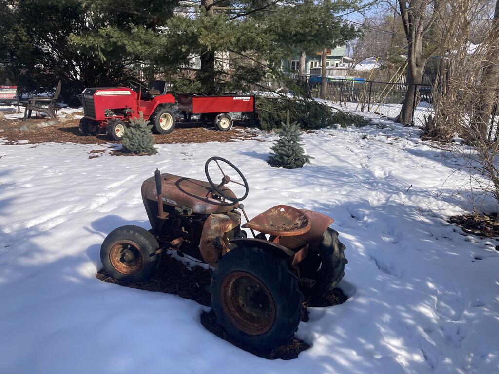

ebinmaine 80,743 #2 Posted January 29, 2025 Traction. Is. Key. This was my first Wheelhorse. 6 years ago. We use chains and cables to pull. Note. I'VE STOPPED USING THIS METHOD. We find it much easier to fell, buck, cut and split at the site where the tree was. 7 1 1 Share this post Link to post Share on other sites

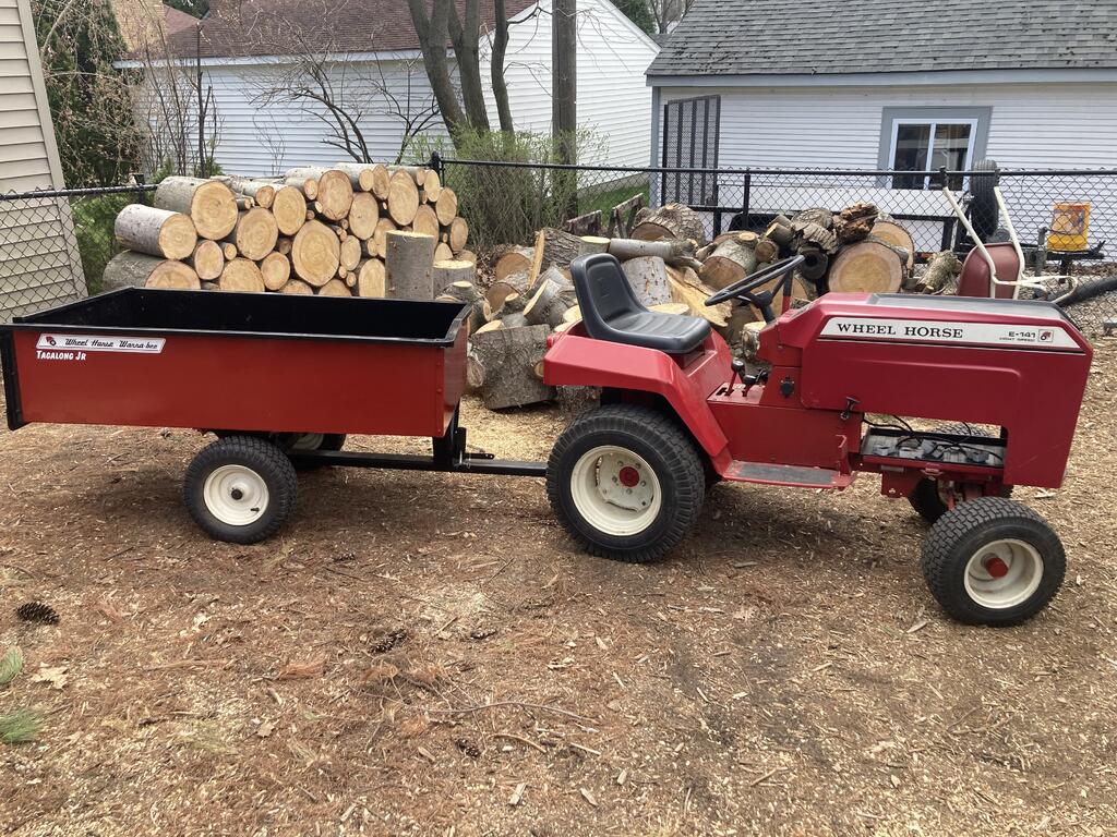

SylvanLakeWH 32,549 #3 Posted January 29, 2025 Here's what I used... 4 Share this post Link to post Share on other sites
Retired Wrencher 6,989 #4 Posted January 29, 2025 Personally I do not use would because I have non.But if I did I think I would use Eric method. Sounds like he has working as a process. Just my 1 Share this post Link to post Share on other sites
ebinmaine 80,743 #5 Posted January 29, 2025 48 minutes ago, SylvanLakeWH said: Here's what I used... Pretty much same as us. We've used half a dozen tractors and several trailers over the years. Seems to be the best way. 1 Share this post Link to post Share on other sites

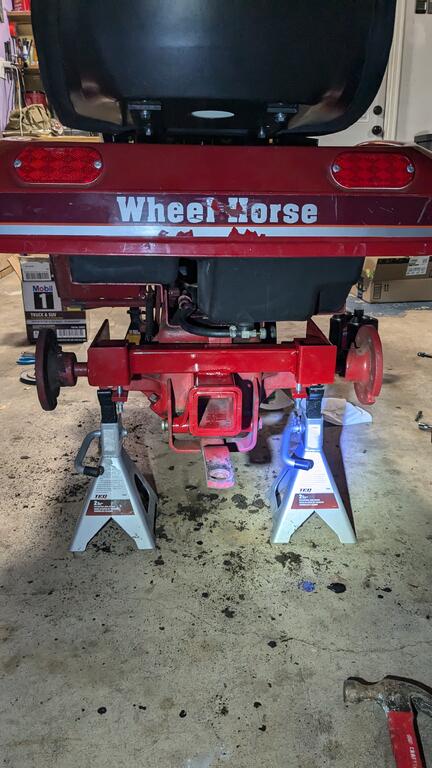

Alrashid2 476 #22 Posted January 29, 2025 (edited) All really great ideas! I'm going to start with what I have and a few essentials and then go from there. I wouldn't be doing much skidding often but want to at least give it a shot, safely of course. OK, so I've got 5/16" chain and some 5/16" grab hooks with safety latches. I just purchased the Skidding Tongs which will be much easier than wrapping the chain around the log for me, since the logs are stacked and sometimes hard to get under! So I'm thinking about this in my head... I understand how to attach the Tongs to the chain, and how to get the tongs onto the log... but what's is the best way to attach the chain to my Wheel Horse? Is it better to attach to the factory Clevis hitch, or should I attach to my aftermarket Wheel Horse Parts and More Class III hitch? And what do I use to attach to it? Just a hitch pin, or something else? Photo is from when I installed my hitch, only difference since is I have the plow axle bracket now too Edited January 29, 2025 by Alrashid2 Share this post Link to post Share on other sites
ebinmaine 80,743 #23 Posted January 29, 2025 1 minute ago, Alrashid2 said: what's is the best way to attach the chain to my Wheel Horse? Is it better to attach to the factory Clevis hitch, or should I attach to my aftermarket Wheel Horse Parts and More Class III hitch? And what do I use to attach to it? Just a hitch pin, or something else? Definitely attach to the Wheelhorsepartsandmore hitch. Stronger by a long shot. Get a trailer ball mount but leave the ball off. Use that hole with an appropriately sized pin or clasp to the chain. 2 Share this post Link to post Share on other sites
Alrashid2 476 #24 Posted January 29, 2025 That's good to know! I know the WHPM hitch seemed much more robust but wasn't sure. I was thinking of throwing one of these shackles into the hitch, and looping the chain through this. Similar to what I used to do with Jeeps. Think this would work fine? https://www.amazon.com/Rough-Country-Receiver-Shackle-Retainer/dp/B09L34D5B7/ref=sr_1_11?crid=1NN1NPF4L6TZI&dib=eyJ2IjoiMSJ9.l0uZLxFHlJU6aew48rXmxq7rU5s-WTVue7OLz0QI34C2luQnneGfruzXtoXZ1pksK0q2MyZSKQ5YS8lyPekMOmY04pE7SDQqEtq2TySTmUv5p5TWxd12No2oYH8WENY4CV4QcB-ACjUOC422d-JIvE1F0IeF0Zv_iulwL8w1t4KbRxQWhgIcJbkyy6_vqqR0pmem6eMFhKhjbQhQ9Zuck9LuGMNiG9iOLKh_ovv83mzXv6wnSlQeM4LDSSe11vNvgt2lRUW_6Fl4W__0ZZBgDbpkaRxaAV9kOSC-Om5G1ucQGbxi0ifzhlfI0AyzY_tIBQbMu9f1HfYCPv_lVbYVIDMg9w9cGUYIZjsoad-tOeY.ZHH3ADQBaWwofv_6HNVV62GK--6vx6Se1i78Y2kGDiw&dib_tag=se&keywords=d+ring+shackle+hitch&qid=1738179740&s=automotive&sprefix=d+ring+shackle+hitch%2Cautomotive%2C119&sr=1-11 1 Share this post Link to post Share on other sites
ebinmaine 80,743 #25 Posted January 29, 2025 14 minutes ago, Alrashid2 said: Similar to what I used to do with Jeeps. Think this would work fine? I wouldn't buy THAT one because it's too pricey but yes... The connection would be proper. Share this post Link to post Share on other sites
