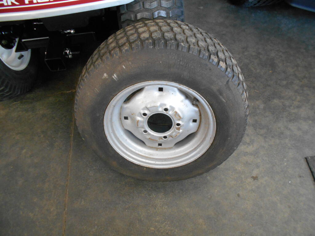

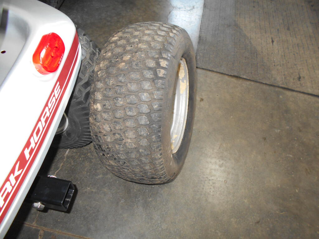

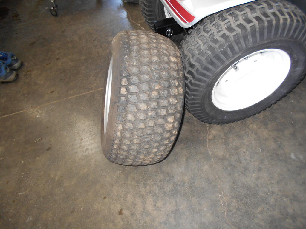

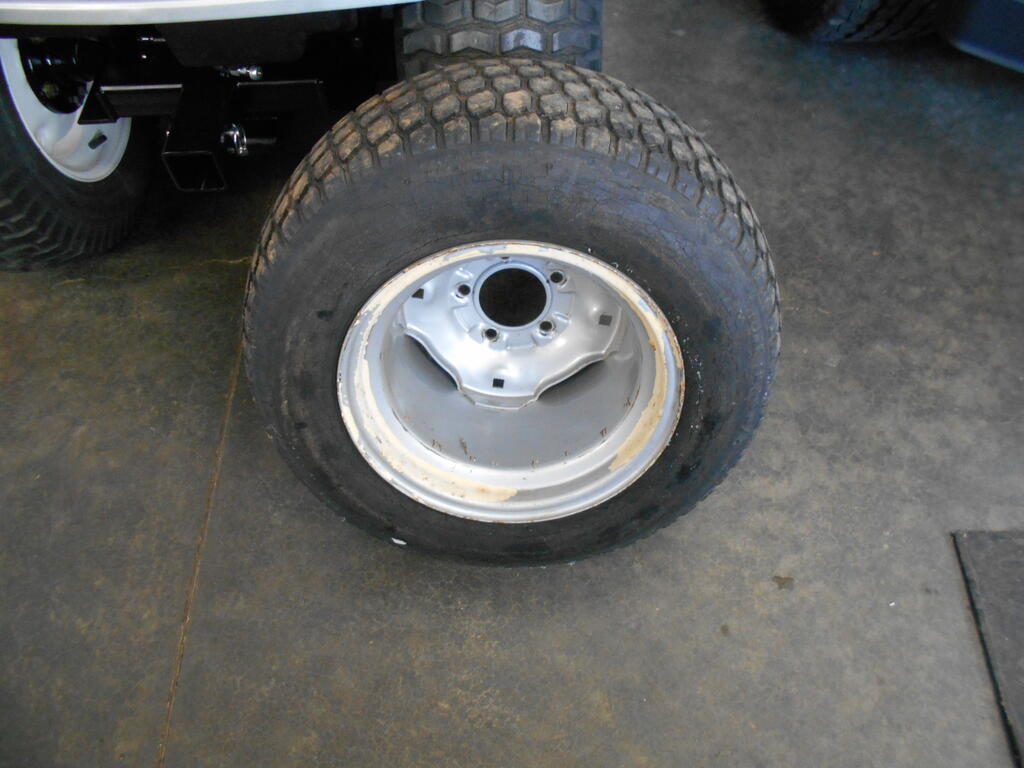

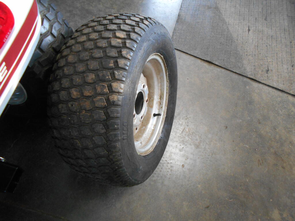

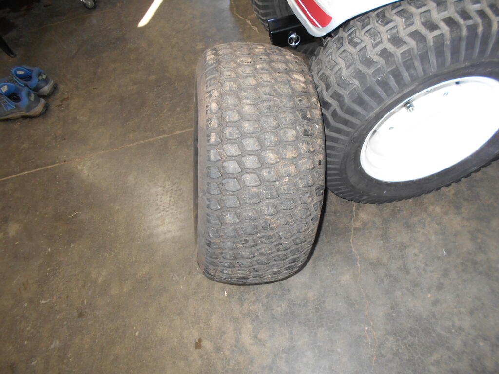

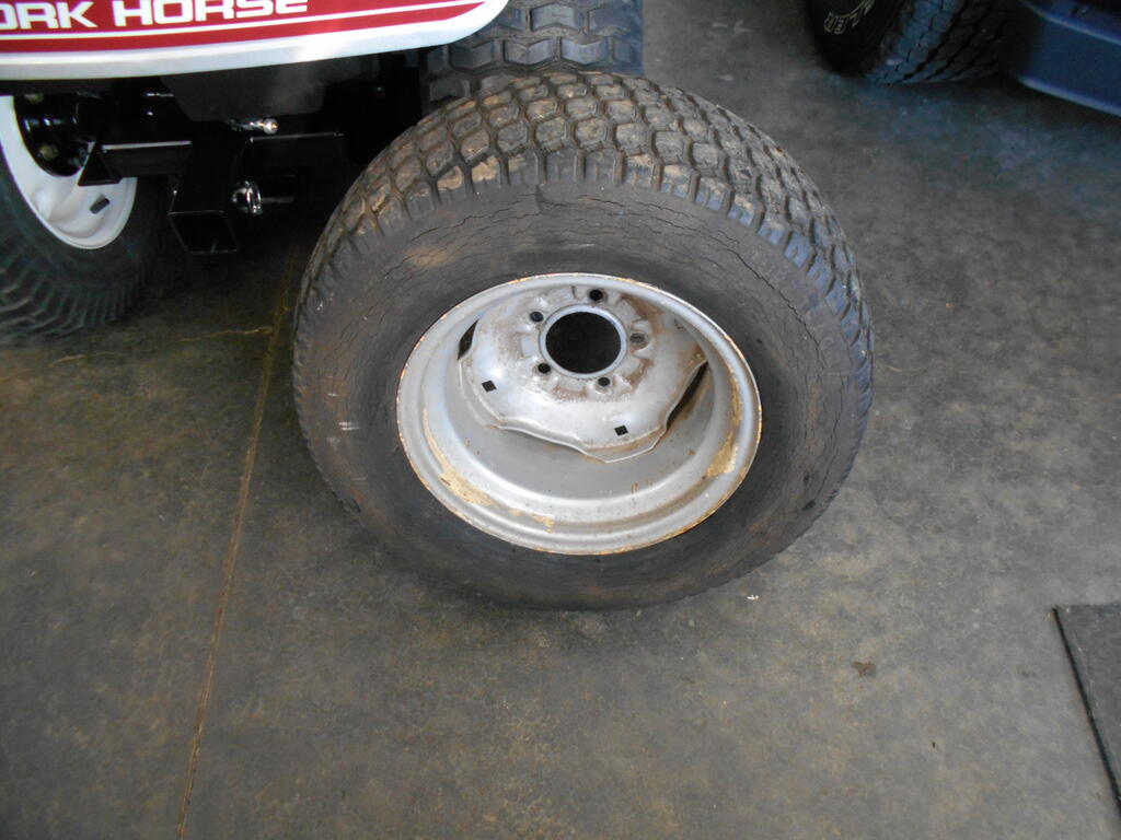

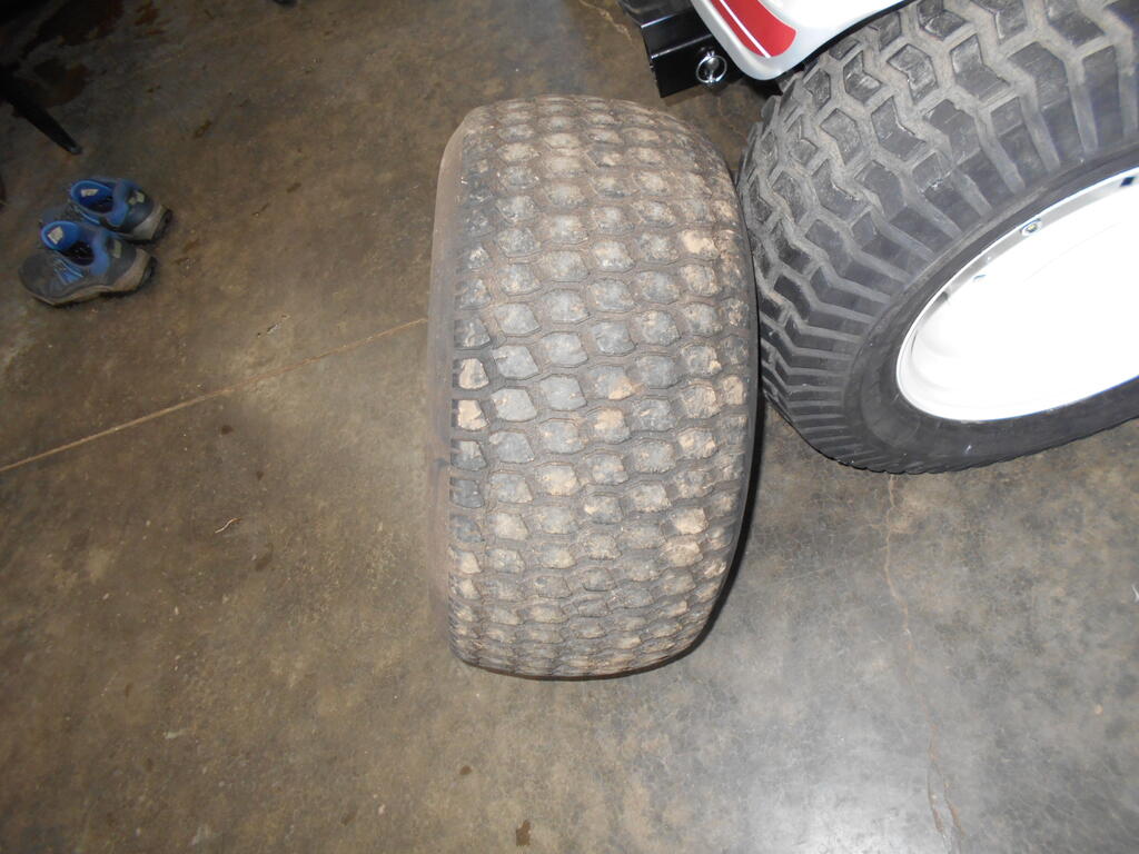

cleat 9,093 #1 Posted January 24, 2025 I guess I was bored and curious so I mounted an old Dico 23x10.5-12 tire on 7" and 8.5" wheels. Here it is on the recommended 8.5" wide wheel. I then de-mounted the tire and mounted it on a 7" wide wheel. The tire sits just fine. 3 Share this post Link to post Share on other sites
OutdoorEnvy 1,817 #2 Posted January 24, 2025 Cool little experiment. Both will work but it does look like the 7" rim is showing much more sidewall cracking than the 8.5" rim. Seems like running smaller rims can be harder on the tire for wear and stretch purposes. 1 Share this post Link to post Share on other sites
cleat 9,093 #3 Posted January 24, 2025 That old tire is in very bad shape. I was actually a little nervous inflating it and stopped at 10 PSI. I doubt cracking would be an issue with a good tire. 1 Share this post Link to post Share on other sites
oliver2-44 11,662 #4 Posted January 24, 2025 With the off brand tires running significantly smaller a 23x10.5 tire is actually closer to an 22x8.5x12 tire. So a 7" rim would be the perfect size. 4 Share this post Link to post Share on other sites
Maxwell-8 4,371 #5 Posted January 24, 2025 7" looks better to me, probably a little taller too 2 Share this post Link to post Share on other sites
cleat 9,093 #6 Posted January 24, 2025 Yes, it looks good and the 7" wheels are much easier to find. Now, the Dico tires are more round shaped than the Carlisle so I don't know what a Carlisle would look like on the narrower wheel. 1 Share this post Link to post Share on other sites

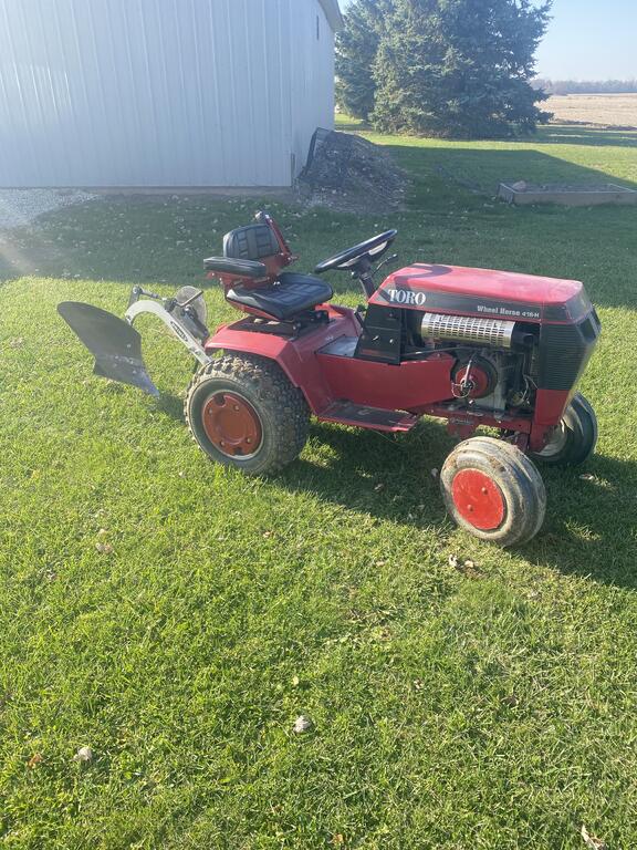

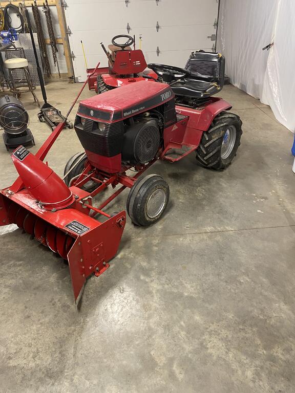

Handy Don 17,197 #15 Posted January 25, 2025 (edited) 23 hours ago, Tonytoro416 said: I think you want to flip the side plates on the snowblower so that the short flanges point forward (and slice into the snow before sliding it in into the auger) instead of sideways. 😄 Edited January 26, 2025 by Handy Don 1 Share this post Link to post Share on other sites
Tonytoro416 1,372 #16 Posted January 26, 2025 Yea I have. This photo was 3-4 years ago and was just like it sits there when I bought it 1 Share this post Link to post Share on other sites
