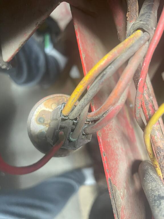

S416-8 398 #29 Posted February 1, 2025 (edited) well got some time on it and get nothing.. I'm sure a big issue on why is the fact that the ignition switch is shot. Have a new key switch ordered and then will get the wires run to it IMG_3421[1].HEIC Edited February 1, 2025 by S416-8 Share this post Link to post Share on other sites
S416-8 398 #30 Posted February 2, 2025 finally got out to the tractor and after messing around with out without ever getting it to turn over I pulled the starter and no go.. took it apart and 2 of the wries to the brushes are bard and grounding against the case.. so start point looks to be a bew starter.. Share this post Link to post Share on other sites

S416-8 398 #32 Posted February 7, 2025 (edited) Update is that I got my starter and got it installed. I wasn't able to get it started but it truns over, has great compression so now I acan work on getting plug for the ket swicth wired in, The new swich has it being deliverd tomorrow.... Edited February 7, 2025 by S416-8 wording 2 Share this post Link to post Share on other sites
S416-8 398 #33 Posted February 11, 2025 First signs of life. New switch and starter on now and got her to fire with a little gas in the carb now to drain the tank change the oil and get her running for real. Need to find what battery it needs because my spare doesn’t have the kick to it. Any fluid and filter recommendations would be great. Thanks Share this post Link to post Share on other sites
