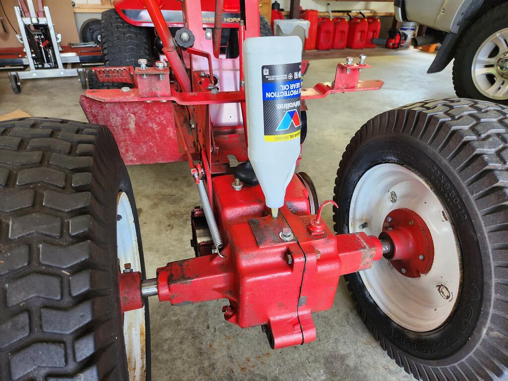

ebinmaine 77,505 #2 Posted January 20, 2025 The side fill is really not useful. When you drained it did you do so from the bottom rear by the hitch? Filling is much easier by using a straw in the funnel to allow air to escape. 1 Share this post Link to post Share on other sites
953 nut 64,263 #3 Posted January 20, 2025 The dipstick tube is a bit narrow and air has to escape as the oil is being added or it will burp and push oil back up the tube. A straw in the funnel that goes the full length of the fill tube like Eric suggested is good or you can put a piece of wire in the tube to keep the funnel away from one side of the tube allowing air to escape. 1 Share this post Link to post Share on other sites

Racinbob 12,798 #5 Posted January 20, 2025 It's been many years (decades) since I've even removed that 'oil fill' plug. Like Eric said, it's not really useful (I usually say worthless). Assuming you have a manual go with 1.5 qt. in the 3 and 4 speeds, 2 qt in the 6 and 8 speeds. There's been other recommendations over the years that are probably fine but I keep it simple. The nozzles on the gear lube I use work well. If I'm in a hurry a few squeezes speed things up. If it's torn down to this extent the seat bolt hole holds it fine. Or the filler tube. I find that there's plenty of air seepage around the shifter without removing it. Hydros are a different beast and that's where some of the tricks do well. 1 1 Share this post Link to post Share on other sites

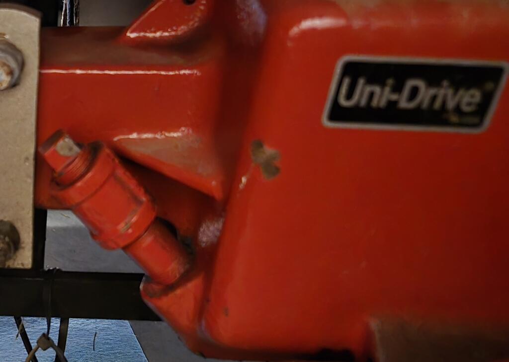

kpinnc 17,265 #7 Posted January 20, 2025 3 hours ago, Larry Chamberlain said: is there a trick to putting the other quart in On my 867, I had no top dipstick and filler tube. The hoodstand frame had no hole cut for adding one. But I saw the setup in the pic below. I think it was in the 867 manual but I can't remember. Just add a 1 inch long pipe nipple and union so you can keep the plug but raise it. Never had issue with adding two quarts since. 1 1 Share this post Link to post Share on other sites
Handy Don 15,993 #8 Posted January 20, 2025 1 minute ago, kpinnc said: But I saw the setup in the pic below. I think it was in the 867 manual but I can't remember. Yep. this was the trick for raising the gear oil level on the 6-speeds without dipsticks--took nearly an extra quart! 2 1 Share this post Link to post Share on other sites
