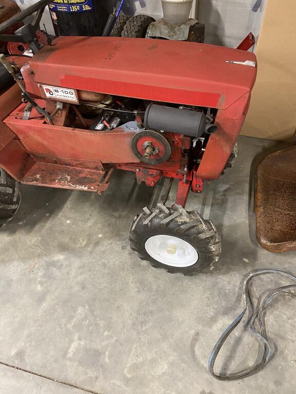

Tonytoro416 1,309 #12 Posted January 20, 2025 Did some cutting and welding to orient this one the way I wanted it. 2 Share this post Link to post Share on other sites
