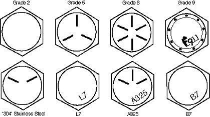

Achto 32,760 #4 Posted January 7, 2025 If you can not find regular shear bolts, then I would suggest using some grade 2 bolts. I like to call them "butter bolts". These are the ones found in the bulk bins at hardware stores. They will have no markings on the heads at all. 5 3 1 Share this post Link to post Share on other sites

GWNORTH 7 #7 Posted January 8, 2025 On 1/7/2025 at 7:23 AM, Achto said: If you can not find regular shear bolts, then I would suggest using some grade 2 bolts. I like to call them "butter bolts". These are the ones found in the bulk bins at hardware stores. They will have no markings on the heads at all. OK, Thanks for that Info. I will try to locate some 'dollar store' heavy duty grade 2 Bolts. BTW I printed the chart so that I can identify othe bolts in the future. 1 Share this post Link to post Share on other sites
