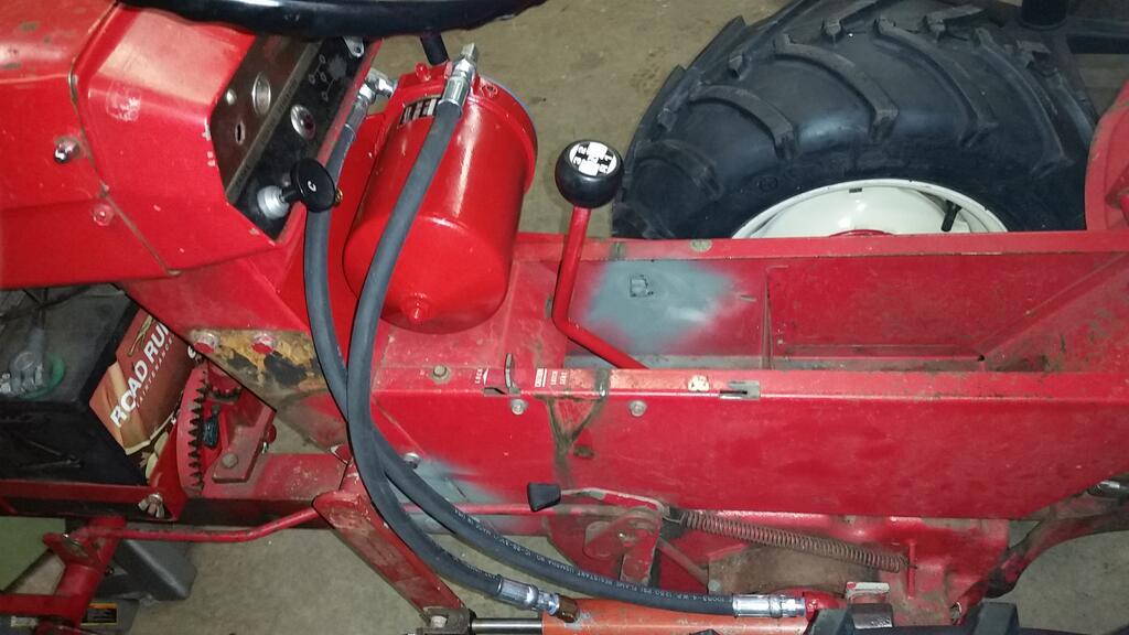

adsm08 4,607 #1 Posted January 7, 2025 At least I'm not trying to rebuild the stupid thing this time. First off, does anyone have a source, or a number, for just the shaft seal? I know Lowell had them listed alone a few weeks ago, but now I don't see them. I have trouble installing them and usually screw up one or two to each one I install successfully, so I'd like to buy a few. Second, I blew a line tonight while plowing. Short of having the local hydraulics shop make me a set ($$$$) does anyone have a source for these? I'm pretty sure I'm going to have to make a temporary repair to get through the next storm coming this weekend, but I'd like something better than a flare and a hose clamp long term. Share this post Link to post Share on other sites

Mike'sHorseBarn 3,563 #5 Posted January 7, 2025 My HY 2 leaks like a sieve even with 2 seals in it. I wonder if anyone could drill out the hole and bush it to bring it back to spec? Lowell sells the hoses too, but my local hydraulic shop made some from me and I didn't think they were expensive. 1 Share this post Link to post Share on other sites

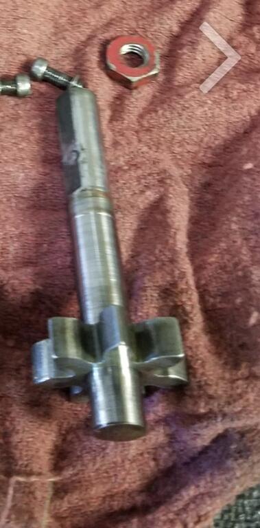

Lane Ranger 11,983 #9 Posted January 7, 2025 This geared shaft is the shaft the pulley for the belt runs on outside the casing. The shaft wears and this one does show some wear . A new gear reduces the wear gap on the shaft which one or two seals won’t seal. It would be a great assistance to have some machinist make some of these and sell through Lowell at wheelhorsepartsandmore.com 3 1 Share this post Link to post Share on other sites

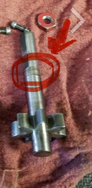

Lane Ranger 11,983 #10 Posted January 7, 2025 See the wear on the shaft! 1 1 Share this post Link to post Share on other sites
Mike'sHorseBarn 3,563 #11 Posted January 7, 2025 I think I'll ask lowell and see what he thinks. Maybe I can send mine to him for a refresh. I've had it apart enough times lol I need to order some other things from him anyway. 3 1 Share this post Link to post Share on other sites
Mike'sHorseBarn 3,563 #12 Posted January 7, 2025 Just now, Lane Ranger said: See the wear on the shaft! I wonder if you could weld that up and turn it back down to spec? 2 Share this post Link to post Share on other sites
Lane Ranger 11,983 #13 Posted January 7, 2025 23 minutes ago, Mike'sHorseBarn said: I wonder if you could weld that up and turn it back down to spec? A good welder might ! Share this post Link to post Share on other sites
squonk 46,923 #14 Posted January 7, 2025 When shopping for hoses ask how many wires are in the hose and what brand fittings. There are expensive ones and some cheap junk. I made Weatherhead brand hoses at Napa. 3 wire hose and quite stiff. I bought a cheaper pair of hoses online for my C-160 and they made it a year. I'd rather spend the money than spray my shop and clothes with hyd. fluid. 2 Share this post Link to post Share on other sites
Handy Don 16,762 #15 Posted January 7, 2025 3 minutes ago, squonk said: When shopping for hoses ask how many wires are in the hose and what brand fittings. There are expensive ones and some cheap junk. I made Weatherhead brand hoses at Napa. 3 wire hose and quite stiff. I bought a cheaper pair of hoses online for my C-160 and they made it a year. I'd rather spend the money than spray my shop and clothes with hyd. fluid. Good points all, Squonk, but please note that 3-wire hoses are also very stiff and larger in diameter--possibly too stiff or large to work for a particular application. The HY (as well as other WH hydraulics) are all at much lower pressures than “commercial” systems (~700 psi vs. 2-4,000 psi). A one-wire hose will easily contain the pressure. Focus on where there is movement in the hoses, the type of fitting (and that it is correctly sized for both the inner and outer diameter of the hose), and how the fittings are attached to insure no “fatigue” ruptures. Also, if there is a place on the hose where in regular use it will rub, provide hose sheathing or support clamps. Share this post Link to post Share on other sites

oliver2-44 11,554 #17 Posted January 7, 2025 (edited) A Speedi Sleeve might work in this location. It might be a little far to drive one on the shaft. But I see the shaft has a flat on it from the end that might help reduce the squeeze fit until you get to that seal area. I used one on my Oliver tractors diesel injector pump 10+ years ago. Dang out correct kept changing Speedi to Speedo Edited January 7, 2025 by oliver2-44 3 1 Share this post Link to post Share on other sites

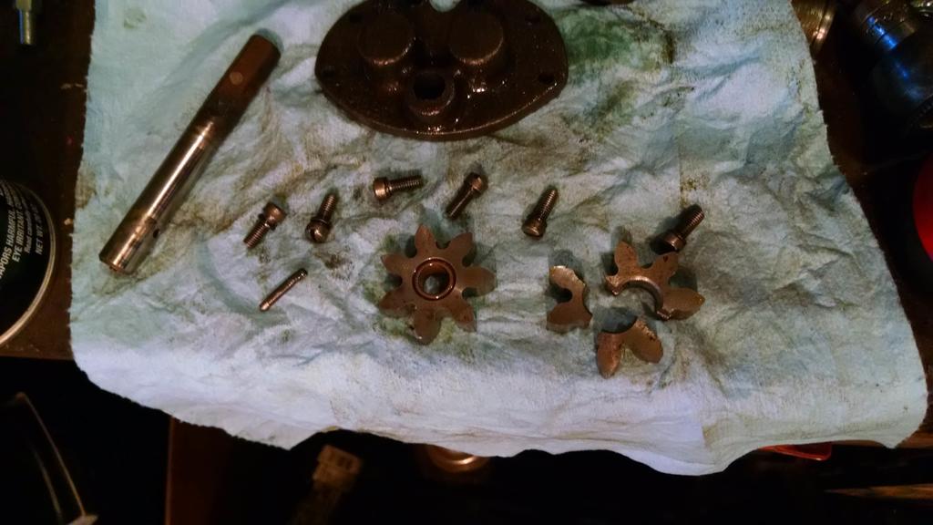

Achto 31,931 #18 Posted January 7, 2025 (edited) 44 minutes ago, WHX?? said: I forgot that gear is part of the shaft @Lane Ranger That gear was not part of the shaft on the Hien Werner pump that I took apart. In the pic below you can see that my dumb a$$ shattered that gear when I took my pump apart. Never tap on the shaft to remove the belt pulley unless the gear cover on the inside is removed. Lesson learned. This gear was held on by a roll pin that drove into a blind hole. The hole for the pin is in between two of the gear teeth. I would have absolutely no idea how it could ever be removed with out damaging the gear. Lucky for me. Lowell just happened to have a replacement gear. Otherwise my pump would have been scrap. Edited January 7, 2025 by Achto 2 Share this post Link to post Share on other sites
Lane Ranger 11,983 #19 Posted January 8, 2025 41 minutes ago, Achto said: @Lane Ranger That gear was not part of the shaft on the Hien Werner pump that I took apart. In the pic below you can see that my dumb a$$ shattered that gear when I took my pump apart. Never tap on the shaft to remove the belt pulley unless the gear cover on the inside is removed. Lesson learned. This gear was held on by a roll pin that drove into a blind hole. The hole for the pin is in between two of the gear teeth. I would have absolutely no idea how it could ever be removed with out damaging the gear. Lucky for me. Lowell just happened to have a replacement gear. Otherwise my pump would have been scrap. Dan. I thought the gear and shaft were two pieces. I never removed a gear from shaft and maybe like you say it would be a difficult job on a blind hole. But when I took apart pumps I never had a problem getting the outside belt pulley off. The internals I have had completely apart except for the gear from the shaft. 1 1 Share this post Link to post Share on other sites
