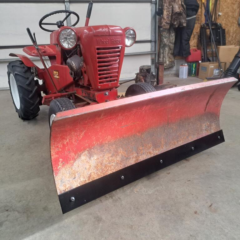

WHX?? 57,773 #7 Posted January 7, 2025 @Achto and I made some for a plow blade. I think they were 48" . I needed one for a single and I cut one down. About two inches off each end & most of the holes lined up I think I had to drill two new holes. Instead of having square holes for carriage bolts we just used button heads. 1 1 Share this post Link to post Share on other sites

peter lena 10,013 #11 Posted January 8, 2025 @WHX?? nice blade set up , glairing to me ? dry rusty blade , a lubrication soak down , would add a very slick , snow release finish to that , while in the area , might even , touch up plow / steering quadrant / function lube . the squeeze lever , to quadrant functional detailing makes for , very easy , light blade swing , basically the lever to quadrant slide pin spring , lubrication , makes for very smooth / easy blade use , that slick blade finish is like free HP , pete 1 Share this post Link to post Share on other sites
peter lena 10,013 #12 Posted January 8, 2025 @WHX?? did that years ago , basically verifying function , since doing that , have touched up many areas , amazing to me AT HOW LITTLE ENHANCEMENT TO ORIGINAL SET UP , IT TAKES TO MAKE IT BETTER , would suggest if you are having any PIA area , to try and eliminate it , THE REPITITION , IS SHOWING YOU THE WAY . just trying a lever / linkage sloppy / rusty zone , is like a gold mine of corrections . washers / lube , verifying how things are intended to move , is like , this is so easy to correct . pete Share this post Link to post Share on other sites
