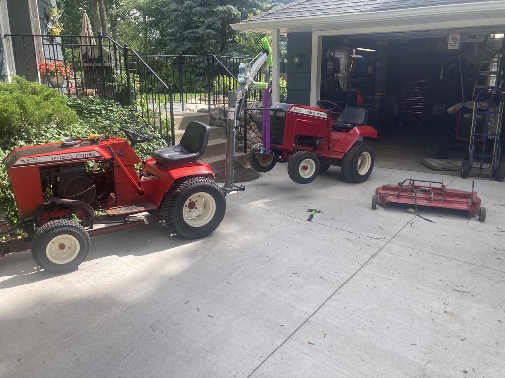

SylvanLakeWH 32,921 #2 Posted January 6, 2025 Here's what I use... Harbor Freight pick up lift mounted on a winch plate. Removable 2" hitch mount... 4 Share this post Link to post Share on other sites

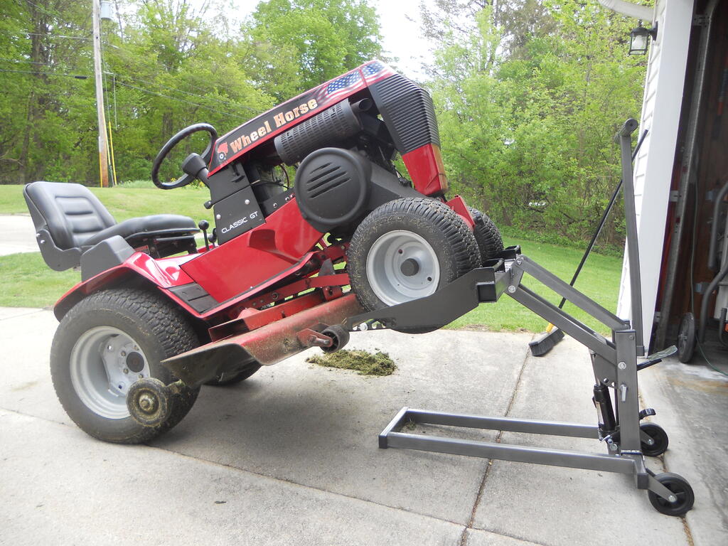

Racinbob 13,290 #4 Posted January 6, 2025 I use this one every time I mow. 9 Share this post Link to post Share on other sites

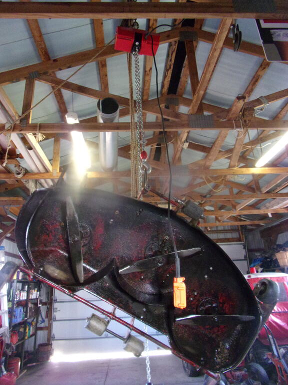

Ed Kennell 47,946 #5 Posted January 6, 2025 8 hours ago, heysavoy said: The older I get the more difficult it is for me to remove my deck in order to sharpen my blades each year. . Age has a habit of making our chores more difficult and at times dangerous. I still like to remove my decks and turn them over for cleaning, coating, lubricating and sharpening before winter storage. I use a small jack to raise the front enough to get the deck carriage to clear the frame. Then use the hooked end of a wrecking bar to pull the deck out from under the tractor. I would not attempt to sharpen or remove blades while laying under a suspended tractor. 5 2 Share this post Link to post Share on other sites
heysavoy 22 #6 Posted January 6, 2025 1 hour ago, Racinbob said: I use this one every time I mow. I like it! What kind of lift is this? Do you use it when you remove your blades? What keeps the tractor from roling backwards out of the wheel holders? Thanks Share this post Link to post Share on other sites

rjg854 13,454 #10 Posted January 6, 2025 2 hours ago, Racinbob said: I use this one every time I mow. Same one I have as it looks the same anyway. The tires fit well into those pockets; I don't worry about them coming out. And it locks in place once you have it raised. Saves having to remove the deck just for cleaning. When I remove the deck for winter, that's when the blades get sharpened and a good used oil soaking before storing. I think it came from Horror Freight. 2 Share this post Link to post Share on other sites
lynnmor 9,081 #11 Posted January 6, 2025 I had the lighter version from Harbor Freight, what a piece of junk! The mount holding the bottom of the hydraulic cylinder bent and tore till the cylinder was pushing against the ground. I welded i up and sold it to a neighbor with a disposable tractor. If you buy from HF, at least get the $280 heavy duty version. Keep in mind that the base of that type of lift will interfere with the mower deck which makes installation and removal difficult or impossible. Share this post Link to post Share on other sites
Racinbob 13,290 #12 Posted January 6, 2025 3 hours ago, heysavoy said: I like it! What kind of lift is this? Do you use it when you remove your blades? What keeps the tractor from roling backwards out of the wheel holders? Thanks That's the cheaper of the two that Harbor Freight sells. The tires are well cradled and there's no real chance of them rolling off. I clean the grass clumps that hold moisture off after every mowing. The tractor is a 2005 Classic 15hp. The deck is a 1970's 48" that I purchased new. Share this post Link to post Share on other sites

John2189 605 #17 Posted January 10, 2025 I just use a chain hoist hooked to a beam in my garage 2 Share this post Link to post Share on other sites

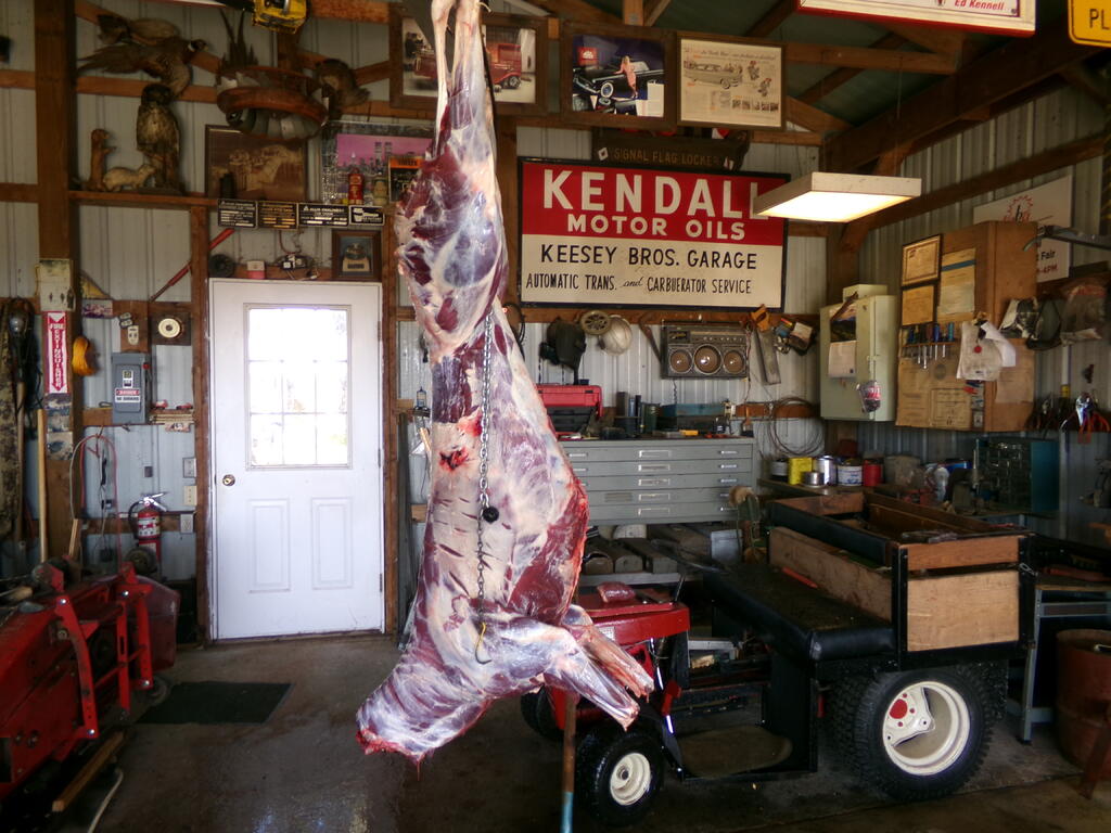

Ed Kennell 47,946 #24 Posted January 13, 2025 I use my 500lb. electric to lift the front end of tractors, to load decks and blowers, and deer. 3 2 Share this post Link to post Share on other sites

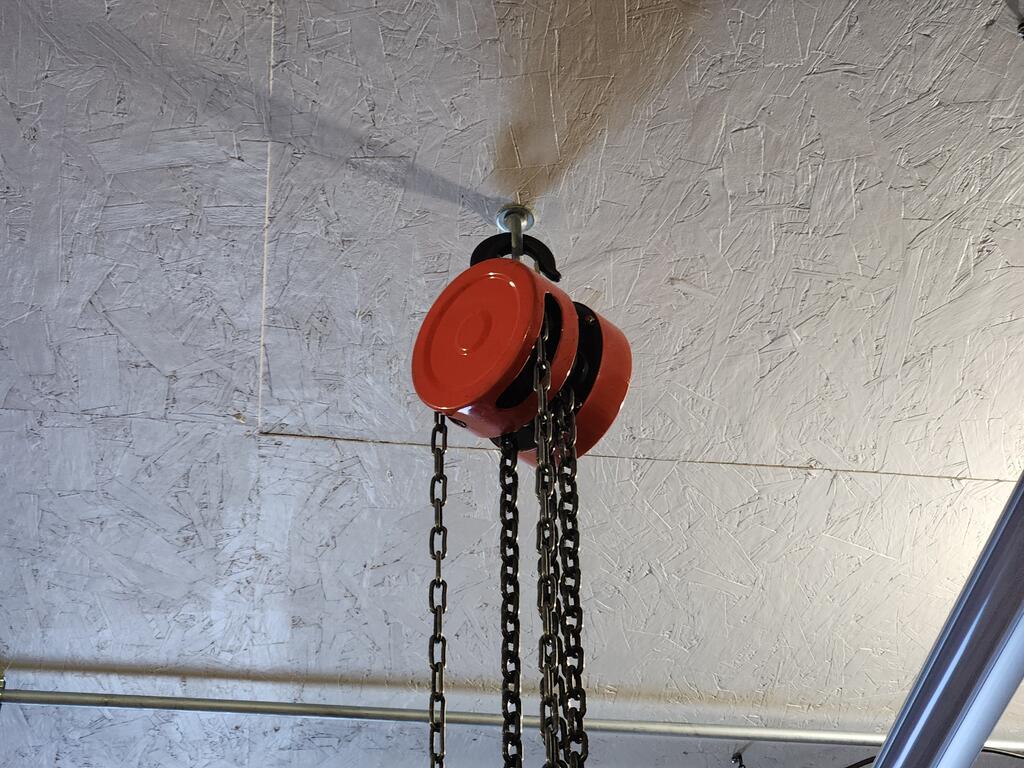

Racinbob 13,290 #25 Posted January 13, 2025 I use a elcheapo 1 ton chain hoist. The eyebolt goes through a 4x4 spanning the trusses. It probably wasn't needed but I added reinforcing the truss cords to spread the weight better. I just did this a few months ago and immediately wondered what took me so long. You'll see it in action in a lot of my pictures. 1 Share this post Link to post Share on other sites
