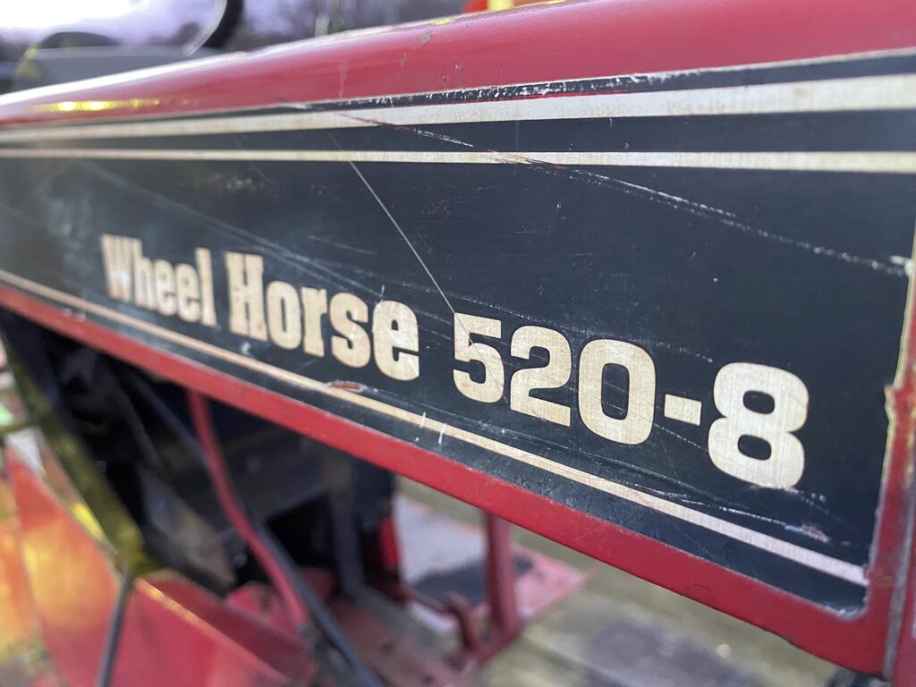

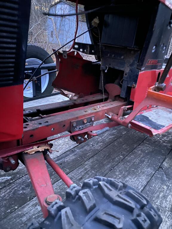

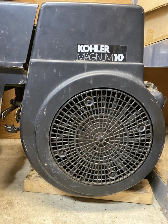

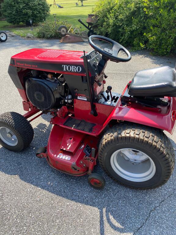

Sparky-(Admin) 26,898 #1 Posted January 5, 2025 Picked up a 520-8 today, no motor, needs a lot of love. But should be a fun project. Not a fan of the Onan so it won’t be getting one of those. I do have a nice running Mag 10 and some fat AG’s that will eventually end up on it. When the weather is more favorable here I’ll get into it and start a thread in the projects section. But for now it can wait. 11 7 Share this post Link to post Share on other sites

Sparky-(Admin) 26,898 #14 Posted January 6, 2025 55 minutes ago, Retired Wrencher said: Well Done Mike. Something to keep you busy this winter. Thanks Gary,needs to temps to come up so I can degrease it and power wash it all before tearing into it. Might do some mock-ups with the engine, just for fun. Check out clearances and see how throttle/choke cables will route 2 Share this post Link to post Share on other sites
Moparfanforever 940 #15 Posted January 6, 2025 Nothing to it except to just do it!! Easy Peezy!! Just a few tips on what I did as far as throttle/choke cables. The throttle cable on the 520h worked just fine. There is a thin metal plate that I guess acts like throttle stop on the handle that I cut a slot in it with a dremel for more travel. I was to lazy to to unbolt it and take it off. I took a throttle cable off of a 314H and used it for the choke cable. It is just a tad long, but I clamped it to the frame and it works perfect. Your results may vary!! Good luck!! 2 1 1 Share this post Link to post Share on other sites

peter lena 10,125 #17 Posted January 6, 2025 meadowfield ?@Sparky nice project ! also like the v twin idea , also not a ONAN fan , see more issues than dependability , that bare frame shot , makes me think of the OPPORTUNITY to correct issues , possibly change existing trouble spots . like the idea of a chain drive steering gear chain set up . meadowfield ? eliminate the fan gear set up , also look at the opportunity to lay in a frame protected , 5/16 steel brake line , for new main fuel line supply , only having clear vinyl at fuel tank / carb areas , ( eliminate fuel hose break down debris ) , regularly add a WHAT IF ? to an opportunity , have changes , paint matched to red / black , you would never know , good luck with it , pete 1 Share this post Link to post Share on other sites
