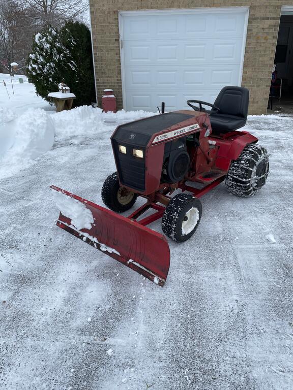

Sodaking27 1,358 #1 Posted January 5, 2025 Removed the deck off of the C105 and installed the plow. Now the plow will not lock in the up position. The deck would lock in the up position without any issues. I tried adjusting the height setting with the adjuster, made no difference. I can pull the handle back and the plow frame will hit the front crossbar. Any thoughts? Nothing like waiting to the last minute to get ready for the storm. Share this post Link to post Share on other sites

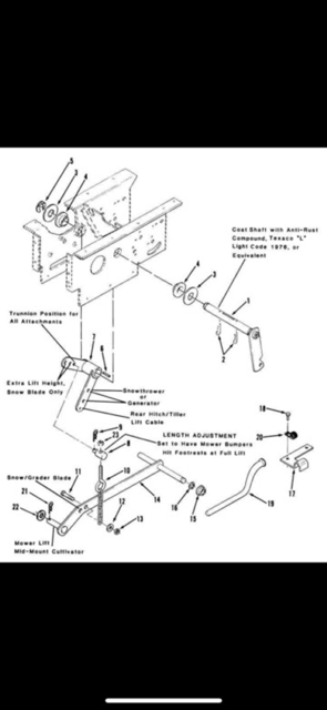

oliver2-44 11,753 #2 Posted January 5, 2025 Is the button on the top end of the hand spring back out? If not, that could indicate a weak spring in the handle. Are you using a solid lift link? If so, do you have it in the correct hole so the lift mechanism is actually coming up far enough for the lift larch mechanism to engage? Just some thoughts! 3 Share this post Link to post Share on other sites
AHS 1,701 #3 Posted January 5, 2025 It’s either #23, the nut. I don’t think it would be the nut. Or do you have the plow in the right hole? 1 Share this post Link to post Share on other sites
Sodaking27 1,358 #4 Posted January 5, 2025 (edited) 1 hour ago, oliver2-44 said: Is the button on the top end of the hand spring back out? If not, that could indicate a weak spring in the handle. Are you using a solid lift link? If so, do you have it in the correct hole so the lift mechanism is actually coming up far enough for the lift larch mechanism to engage? Just some thoughts! Button is popping back out. Thought about the lift link as well. It’s not stock and has several holes. Will check in the AM. Thanks for your advice. 1 hour ago, AHS said: It’s either #23, the nut. I don’t think it would be the nut. Or do you have the plow in the right hole? Will check on the lift link in the AM. Thanks for your advise. Edited January 6, 2025 by Sodaking27 Share this post Link to post Share on other sites
Ed Kennell 47,380 #5 Posted January 6, 2025 4 hours ago, Sodaking27 said: plow frame will hit the front crossbar You answered your own question. Increase the length of whatever you are using to connect the plow frame to the rock shaft. 3 1 Share this post Link to post Share on other sites
Sodaking27 1,358 #8 Posted January 6, 2025 (edited) x 3. Old age and being in a hurry doesn’t work too well sometimes. As everyone stated the lift link was in the wrong hole. Thanks to everyone.. Edited January 6, 2025 by Sodaking27 1 Share this post Link to post Share on other sites
