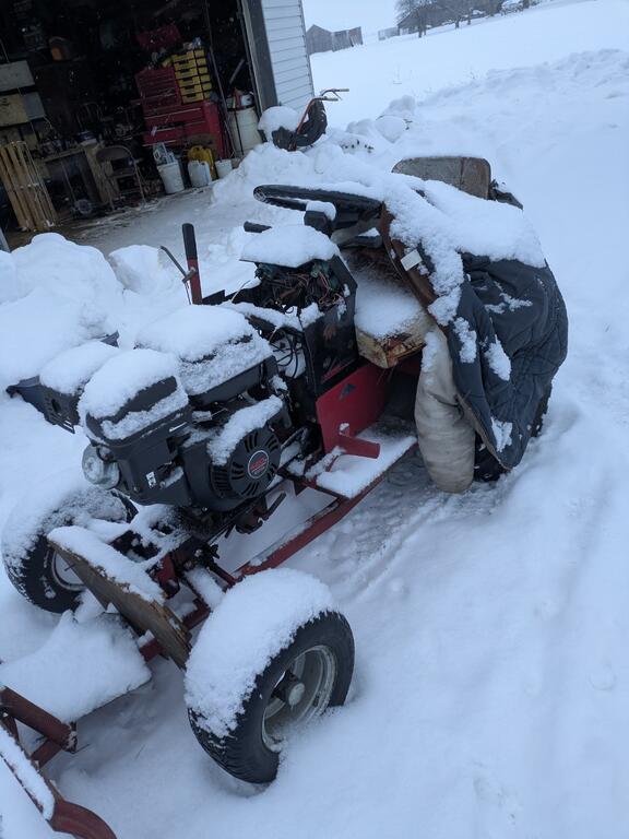

ohiofarmer 3,509 #5 Posted January 10, 2025 It's ugly but it wotks for now.Used some 3/4 plywood with notches to contain center 1 Share this post Link to post Share on other sites

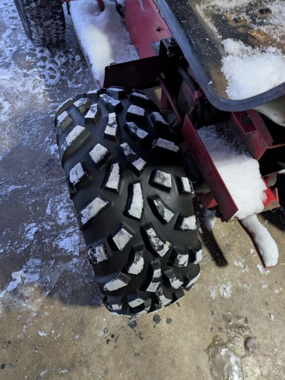

ohiofarmer 3,509 #6 Posted January 11, 2025 These tires are great I got them for forty the pair from a surplus go cart site and they are four ply and speed rated. No chains needed and Long term plan is to add the other blade to abC,160 auto and make a centering bracket for it. The Predator 420 is an excellent engine and can be counted on to start the second pull regardless of the weather I have never used a battery to start it because there is no need to put one on when it starts so easily 2 Share this post Link to post Share on other sites
