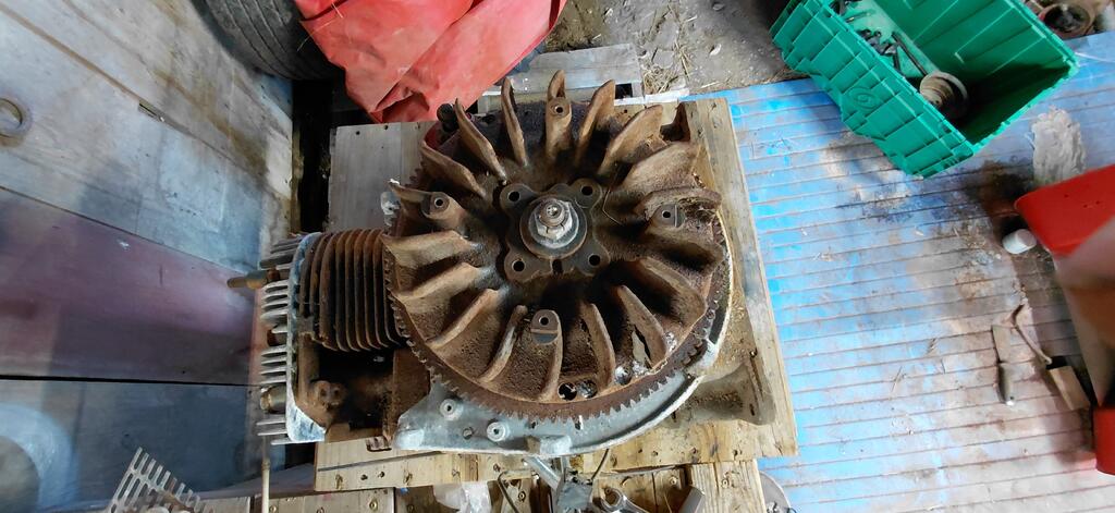

Easton Rich 1,230 #157 Posted March 8 Here is what we are working with. I got this mystery K-321 at an estate sale for $5, not off a WH. It was a turquoise green and had a push button starter on it, so I can only guess it was supposed to be something for industrial work? It had a #30 carb on it with NO varnish. I mean this thing is GLEAMING! I pop the head of and there is no carbon or anything? No oil? My guess is that it's N.O.S? Anyway I need to pull the oil pan off and its GLUED on there, how do I go about this? Share this post Link to post Share on other sites

kpinnc 18,238 #162 Posted March 9 8 hours ago, Easton Rich said: It was a turquoise green May have been on a generator. Not all of them use a tapered shaft. Turquoise green is also common on several brands of fixed generators. I've picked up a couple engines that had a propane diffuser in front of the carb and they looked like brand new internally. You should have bought a lottery ticket on the way home! 1 Share this post Link to post Share on other sites
