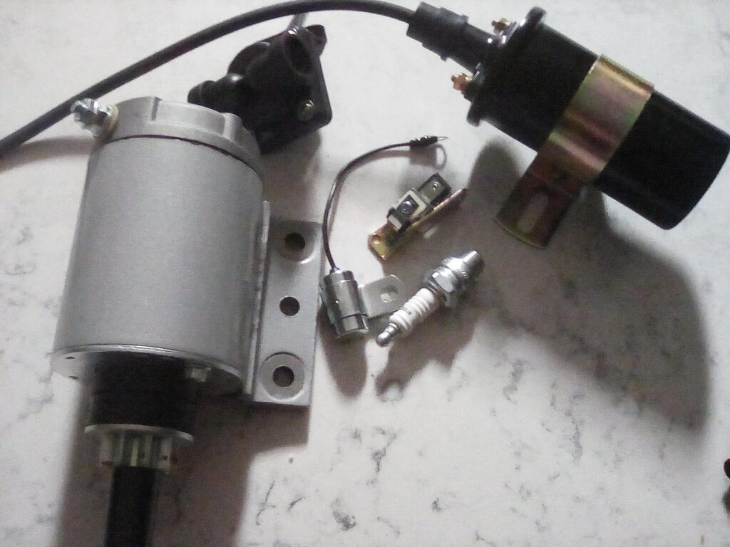

Easton Rich 1,294 #126 Posted February 7, 2025 Another $200 down the drain 1 Share this post Link to post Share on other sites
ebinmaine 81,281 #127 Posted February 7, 2025 Did you not have any of these parts? Share this post Link to post Share on other sites
Easton Rich 1,294 #128 Posted February 7, 2025 Nope Share this post Link to post Share on other sites
Easton Rich 1,294 #129 Posted February 7, 2025 The motor came with a carb only. It was free 2 Share this post Link to post Share on other sites

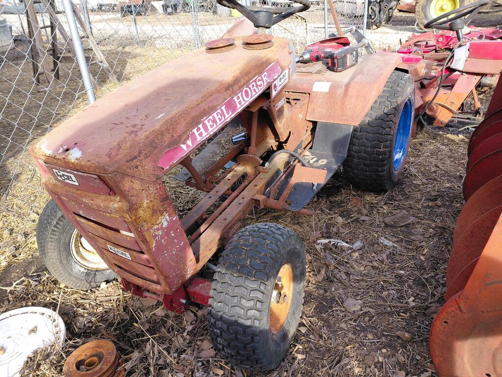

Achto 32,963 #133 Posted May 15, 2025 7 hours ago, Easton Rich said: How do you guys think I could fit some 26x12-12 on it? Anything appreciated To fit 26x12x12 tires on my C101-ish I added 1/2" to the top of the riser under the seat. Pictures are in reverse order. This gave ample clearance from the tire to the fender. Had to do a little bending & grinding on the edge of the running board where it come close to the tire, but not much. 3 1 Share this post Link to post Share on other sites
