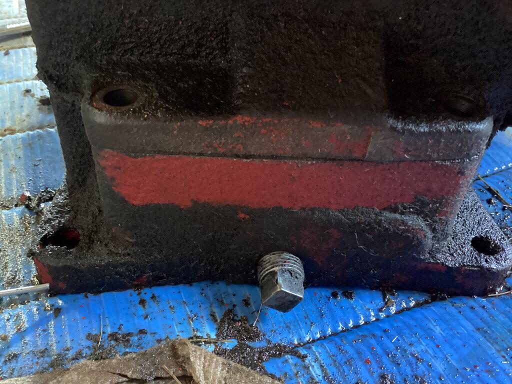

Easton Rich 1,292 #120 Posted February 3, 2025 How do you get an oil pan off when they used rtv on it? Share this post Link to post Share on other sites
ebinmaine 81,281 #121 Posted February 3, 2025 1 hour ago, Easton Rich said: How do you get an oil pan off when they used rtv on it? Got pics? Share this post Link to post Share on other sites
Easton Rich 1,292 #122 Posted February 3, 2025 It’s rtv I just picked off the squeeze out 1 Share this post Link to post Share on other sites
ebinmaine 81,281 #123 Posted February 3, 2025 First, the safety disclaimer. USE EXTREME CAUTION WHEN HANDLING SHARP OBJECTS. If it was my engine I'd consider using a series of tools including but not limited to. A razor knife. Small very sharp chisels. Small putty knife. I'd cut the groove of the RTV. Make sure you slice AWAY from your body. 1 Share this post Link to post Share on other sites
Handy Don 17,735 #124 Posted February 4, 2025 There are reasons why engines are not assembled with RTV in the first place. Difficulty disassembling is one. Squeeze out in the inside breaking off can affect in eternal oil circulation by blocking passageways or other critical places. 2 1 Share this post Link to post Share on other sites
Easton Rich 1,292 #125 Posted February 5, 2025 I GOT IT!!! I show pictures tomorrow. 1 1 Share this post Link to post Share on other sites
