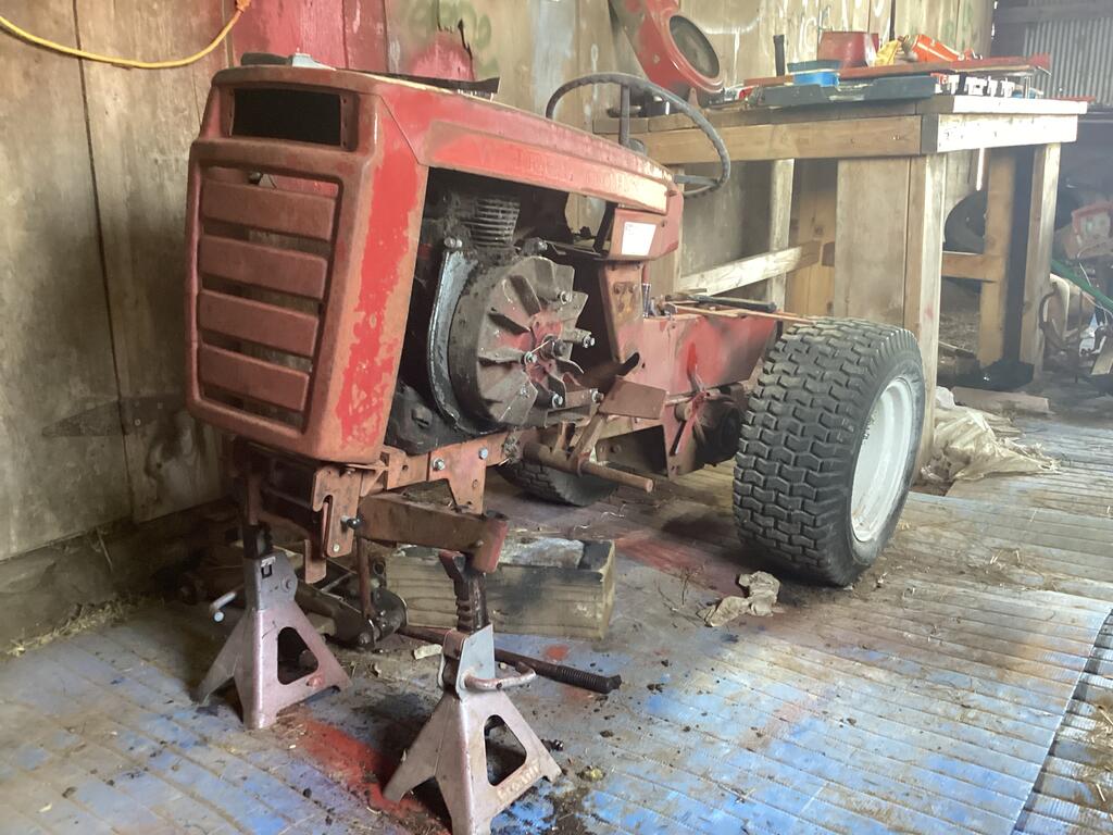

Easton Rich 1,292 #98 Posted January 26, 2025 Looks cool like this, maybe it’ll do this someday Share this post Link to post Share on other sites
TonyToro Jr. 2,560 #99 Posted January 26, 2025 35 minutes ago, Easton Rich said: Looks cool like this, maybe it’ll do this someday I noticed in the picture you have your axle flipped. Make your you CHECK all your club rules about everything you do like that. I know in our club flipping or spindles and or axles are not allowed. 3 Share this post Link to post Share on other sites
