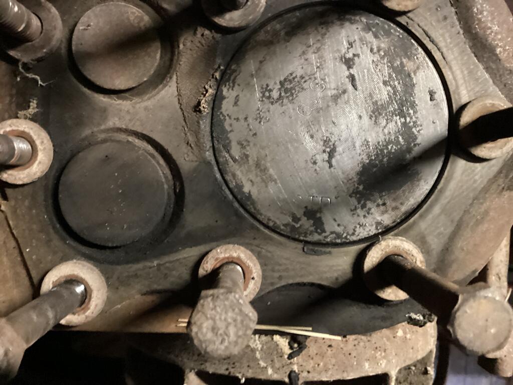

ebinmaine 81,281 #54 Posted January 4, 2025 1 hour ago, Easton Rich said: Was it bored? Double check the top of the piston. I can't quite read it. Does it read "STD" ? 1 Share this post Link to post Share on other sites

Achto 32,963 #56 Posted January 5, 2025 1 hour ago, Easton Rich said: Was it bored? I see STD on the piston, this would indicate standers bore. Boring the cylinder .030 over will gain your a little power, very little though. Share this post Link to post Share on other sites

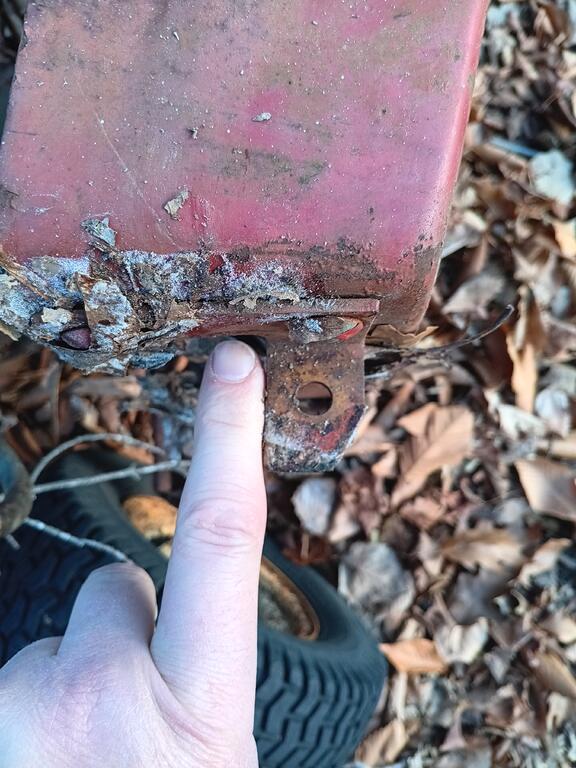

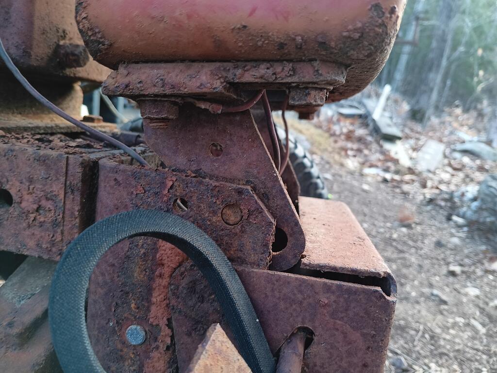

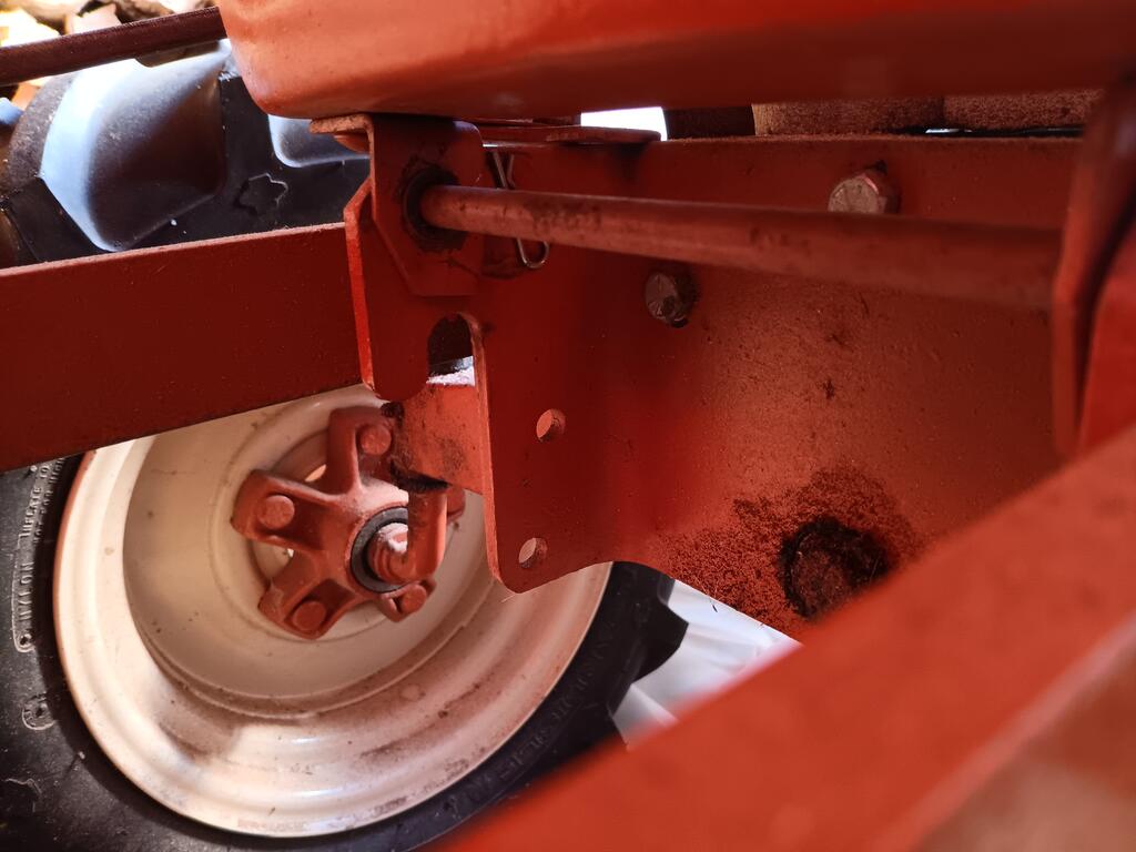

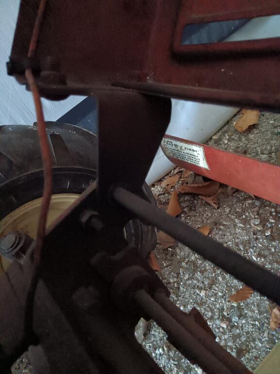

ebinmaine 81,281 #64 Posted January 5, 2025 On 1/3/2025 at 9:21 PM, ebinmaine said: I can show pics with the difference between the Kohler hood and Tecumseh hood tomorrow. The Tecumseh is an OHV160. Over Head Valve. Much taller engine than the Kohler. The hood hinge is maybe 1.5" taller. @Easton Rich Here's 4 pics of hood hinges. Top two are Kohler K341 Powered. Numbers 3 and 4 are from OHV160 Tecumseh engine tractors. Note the extra height of the Tecumseh hinges. 1 Share this post Link to post Share on other sites
Easton Rich 1,292 #65 Posted January 5, 2025 Wow that’s a very large difference 1 Share this post Link to post Share on other sites
