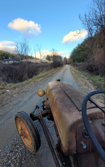

Bar Nuthin 2,219 #4 Posted January 3, 2025 (edited) My tractor (I'm naming, Sanford) is a self-perpetuating project all unto itself. Every day it reveals something new that needs attention. Edited January 3, 2025 by Bar Nuthin 8 Share this post Link to post Share on other sites

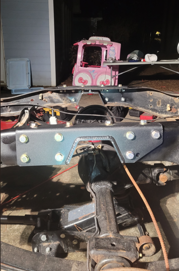

Easton Rich 1,040 #6 Posted January 4, 2025 My project is combining a b80 and Commando 8 to make a stock pulling tractor. It’s name is Steven. You can see it on here I have it posted as Steven the Commando/B80 puller 1 2 Share this post Link to post Share on other sites

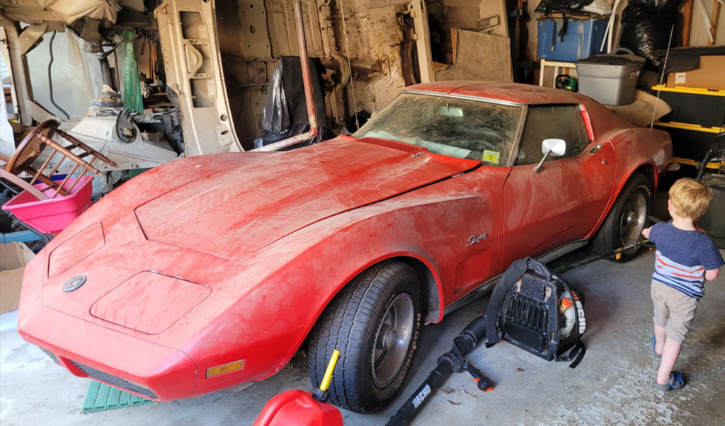

Jrblanke 918 #16 Posted January 4, 2025 I've got several projects cooking! Most are automotive related. The most pressing ones involve getting old cars out of my parents garage! They have retired and are selling the house in the spring. So both my car and dads car need to get out of there. My folks have allowed me to store my old corvette in their garage, so I've been riding that free storage gravy train for about 17 years! In the fall I got it running and rebuilt the calipers and replaced the brake lines. I ran into a problem with the master cylinder and haven't sourced one yet. Once I get the master cylinder and bleed the brakes, I just need to connect the exhaust and install new tires. While working on the corvette, the elephant in the room has been dad's 66 Q code thunderbird convertible. Its been on a rotisserie for about 25 years, and he just never had the time to finish it. Now that he is retired, he wants to do other things with his time and just wants it gone. But before it can be sold and put on a trailer, we have to get the rear axle back under it and front hubs put on the spindles. So next weekend I'll be headed back to their house to hopefully mount the rear axle and put on whatever stuff go on the front spindles. The goal is to have the car on the ground by the end of the weekend. Now, while the 2 cars at my folks house are priority, we (wife/kids) still had to run the holiday gauntlet at the inlaws, outlaws, and everyone in between. While I didn't get much accomplished, I was able to wrap up the flip kit and C notch on my '84 C10 before Christmas. I hope to get the bed back on this weekend. That truck has been apart for 12 years, but I can see the light at the end of the tunnel. It started with needing a carb rebuild and an exhaust manifold gasket, but snowballed into an LS swap and static suspension drop. Lastly, I replace the alternator on my uncles 1952 8N tractor. It had previously been converted to a 12v system, but the alternator wasn't charging. I got that replaced in about 15 minutes, but when I tried to turn the tractor over, there were sparks coming from the solenoid. I could hear it clicking, but the starter wasn't turning over. I took the starter loose to test it, which was unnecessary and ultimately proved to be a mistake. I had never taken an 8N starter off, so I didn't expect it to fall apart in my hands when I took it off. I had to get a 2nd set of hands to realign the brushes so I could get the armature back in. In the end, I think the connections on the solenoid just needed cleaning. So back together it went, and the tractor cranked up after sitting for over a year! 4 1 Share this post Link to post Share on other sites

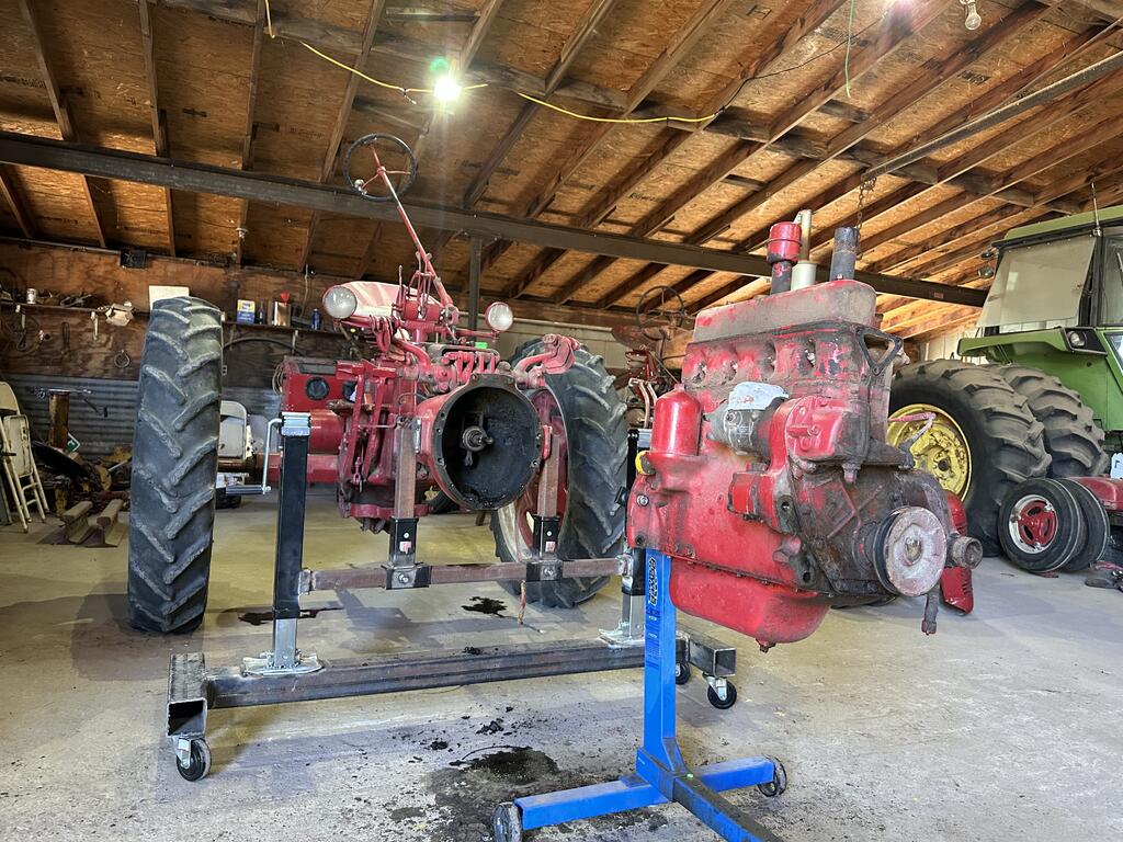

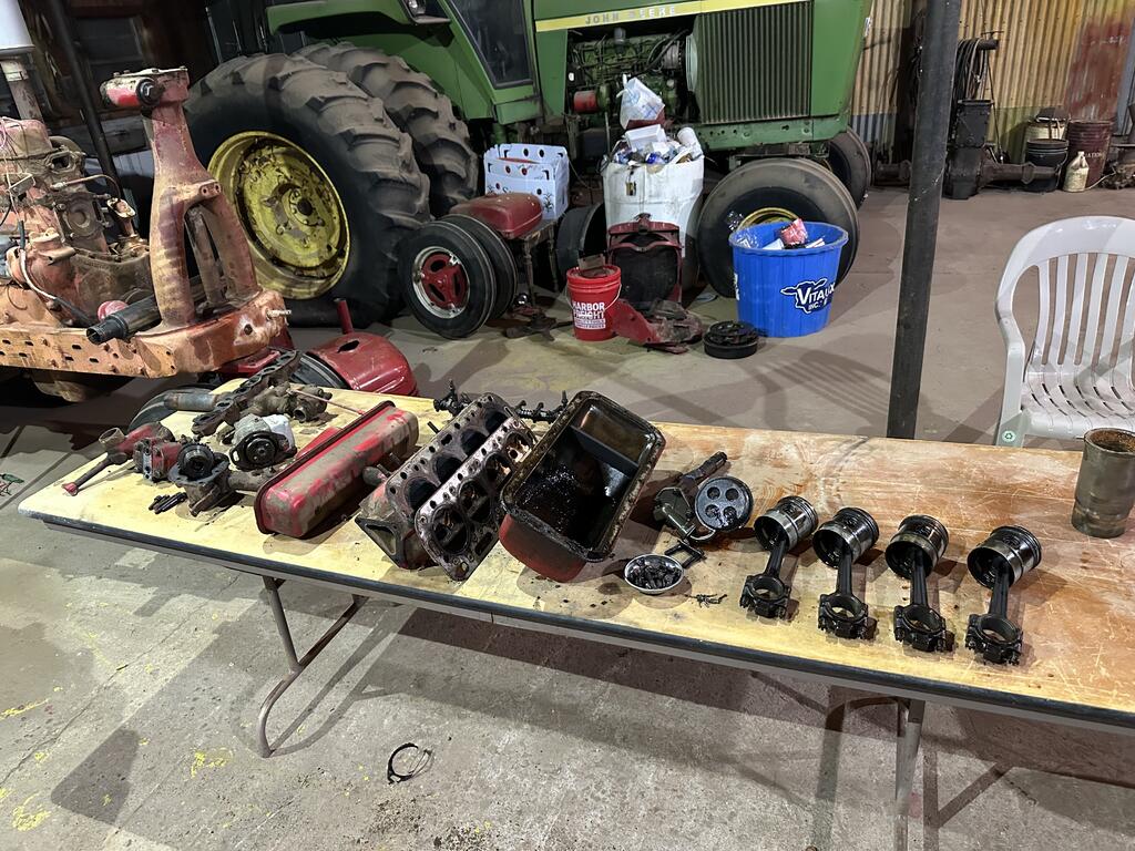

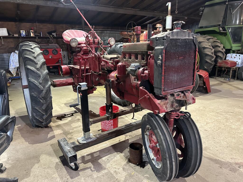

ClassicTractorProfessor 5,455 #17 Posted January 4, 2025 Main project for this winter is an engine rebuild on the 49 Farmall C that does most of our mowing and light chores around the farm. I noticed towards the end of summer that it was emitting a haze out of the exhaust, figured it was using a little oil. Ended up chewing a few teeth off the flywheel ring gear at our local show in September so figured this winter I’d split it and replace the ring gear and put in a new clutch while I was there. Took a peek down inside the cylinders before taking it apart and found about 1/4” of coolant sitting on top of the #4 piston. Got it tore down, just waiting for the time to be able to take everything to the machine shop. 1 4 Share this post Link to post Share on other sites
