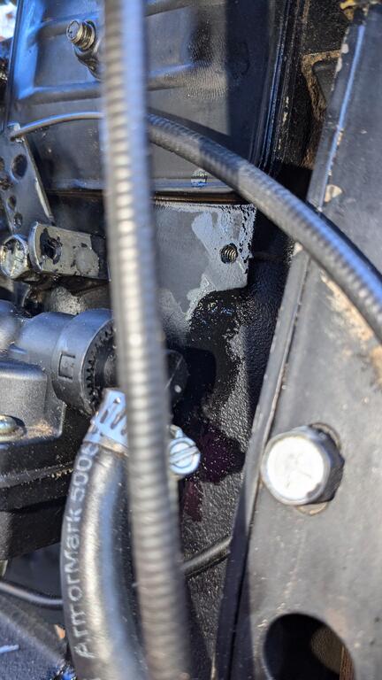

Alrashid2 468 #1 Posted January 2, 2025 (edited) In my hunt to stop oil leaks on my Kohler K301 on my Wheel Horse 312-8, I have found that the Governer Stop Pin is the last thing leaking oil profusely on my engine block. After cleaning the engine block and running the tractor for just 5 minutes, the area around the Stop Pin (looks like a Philips head screw) will be seeping in oil. I know that the engine shouldn't be pushing oil out ideally, but I'm thinking this 1985 engine is getting up there and there may be a bit of blowback. Breather is assembled correctly. Anyway, to my question. I disconnected the governor from the carb control and was able to get a screwdriver in there to ensure it was tight. I then loosed it a bit (before I knew what it was) and pulled it out an inch before tightening it back down. Am I able to pull the Stop Pin out of the engine to replace the copper seal washer? Or would pulling it out be a big no no? Should I just let the engine leak a bit of oil instead of getting too far ahead of myself? Thanks guys for your advice here Original discussion on oil leaks from the Camshaft Cover that lead me to finding the Stop Pin leak: Edited January 2, 2025 by Alrashid2 Share this post Link to post Share on other sites

Alrashid2 468 #8 Posted January 5, 2025 (edited) Thanks guys for the advice here! Definitely seems to be from excess blowby. Breather is installed correctly. Seems like when I seal up one spot, oil pushes through another spot... The Governor Stop Pin is close to the exhaust though and seems to be spitting up onto the muffler as it was smoking when I finished running her today... I pulled the dip stick and there was a lot of air pushing out of the tube, which tells me I've got pressure instead of vacuum I think... I may go back and let the oil push out from the camshaft cover as that was easier to wipe away! After running 20 min I had about as much oil seeping out as I'd pull off wiping the dipstick 4 or 5 times... Edit: attached a photo of what the oil leak looked like from the breather gasket, before I replaced various gaskets... Same amount of oil leaking from the governer stop pin screw now. Is that too much oil? Not sure if worrisome or not. Edited January 5, 2025 by Alrashid2 Share this post Link to post Share on other sites
pfrederi 19,881 #9 Posted January 6, 2025 16 hours ago, Alrashid2 said: Thanks guys for the advice here! Definitely seems to be from excess blowby. Breather is installed correctly. Seems like when I seal up one spot, oil pushes through another spot... The Governor Stop Pin is close to the exhaust though and seems to be spitting up onto the muffler as it was smoking when I finished running her today... I pulled the dip stick and there was a lot of air pushing out of the tube, which tells me I've got pressure instead of vacuum I think... I may go back and let the oil push out from the camshaft cover as that was easier to wipe away! After running 20 min I had about as much oil seeping out as I'd pull off wiping the dipstick 4 or 5 times... Edit: attached a photo of what the oil leak looked like from the breather gasket, before I replaced various gaskets... Same amount of oil leaking from the governer stop pin screw now. Is that too much oil? Not sure if worrisome or not. Have you done a leak down test on the engine??? If you are getting excessive blowby from old age/use then you have to expect some oil seepage...If you feel a lot of air coming out the oil fill during the test your rings are bad creating the blowby. Share this post Link to post Share on other sites
