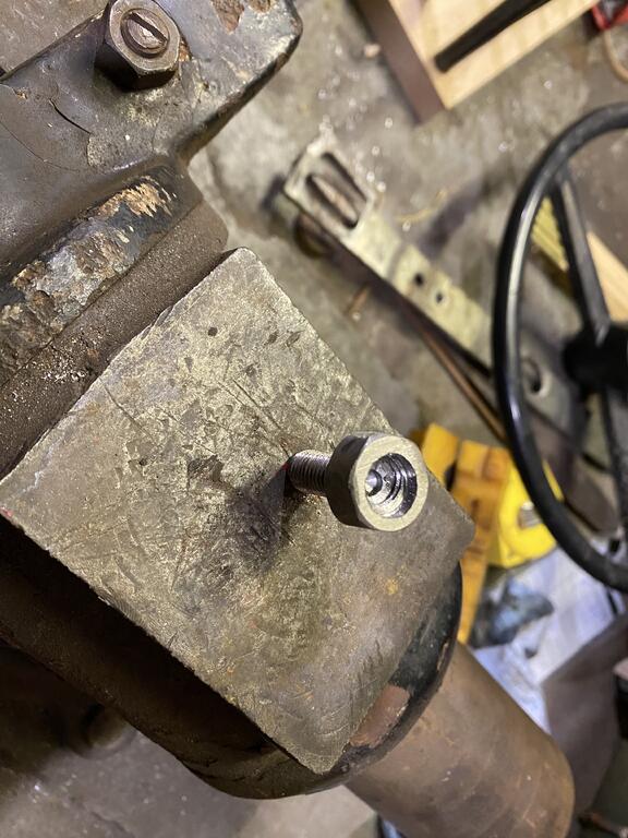

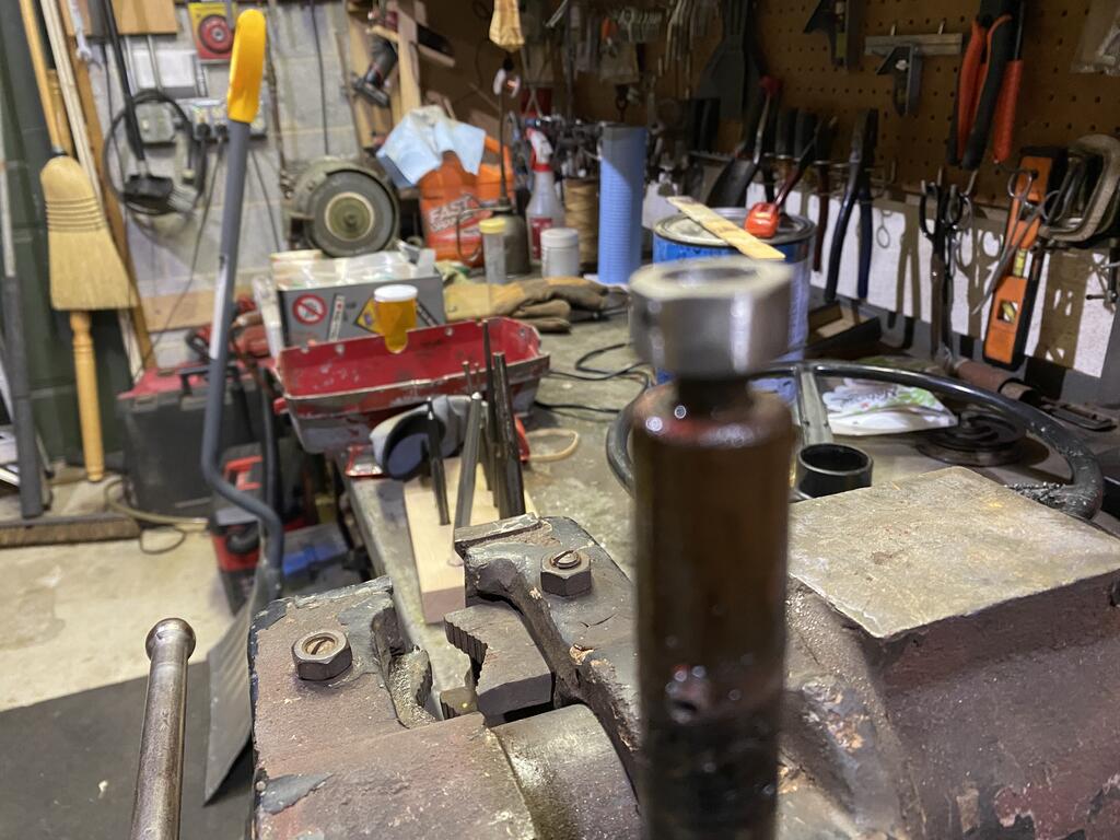

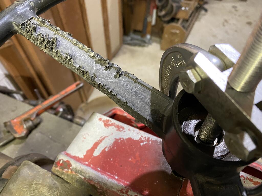

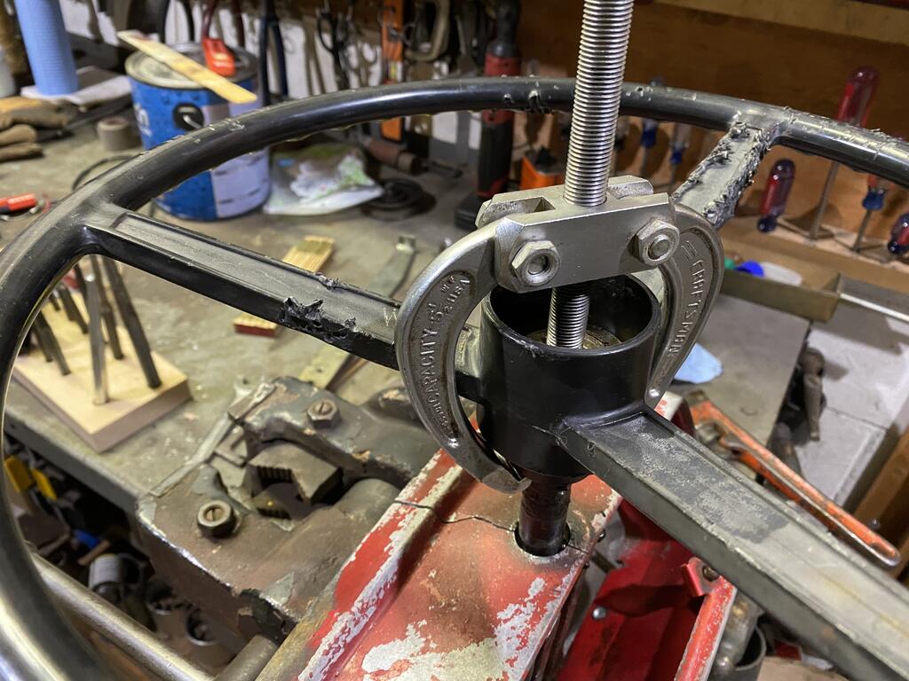

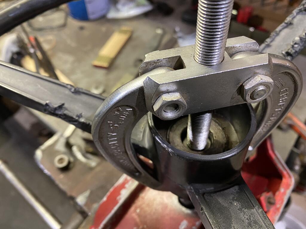

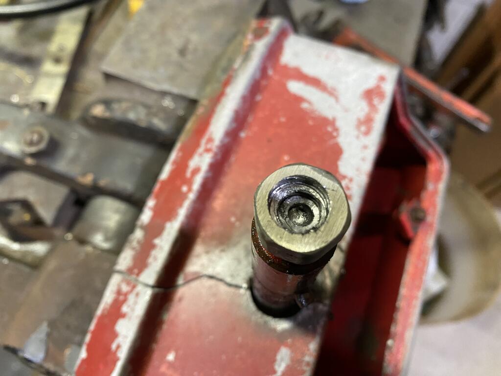

Well the steering wheel got another few applications of Kroil while I modified a bolt to thread into the steering shaft. My 2 arm puller has a 1/2” fine thread shaft with a short area of 7/16” at the tip that’s not threaded and a small ‘nipple’ in the center of that. I centered a 7/16” hole in the top if a 3/8”x1-1/4” bolt, that had a oversized hex head which I rounded off to fit inside the steering wheel center. Then a 9/32” hole centered in that depression to accept the tip of the puller. See the pictures. After threading the modified bolt into the shaft and Another liberal dose of Kroil and I started cranking. It was getting pretty hard to turn the puller shaft when It let out aloud sound and broke free. Wish I’d have thought of this idea before cracking the dash.
