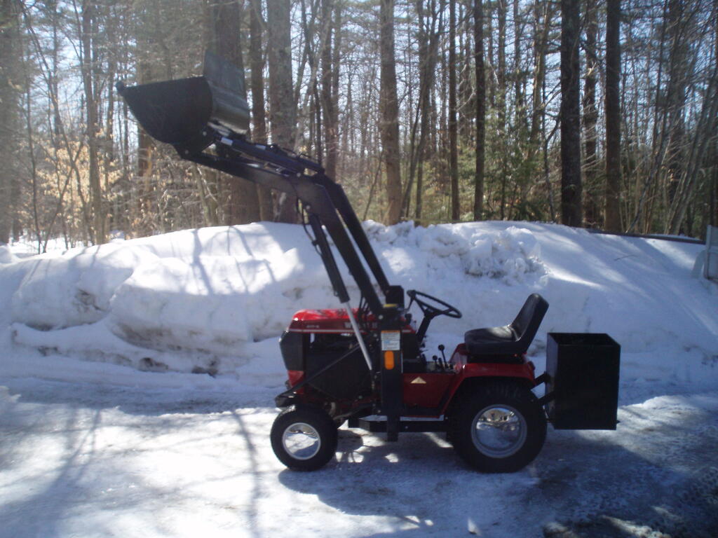

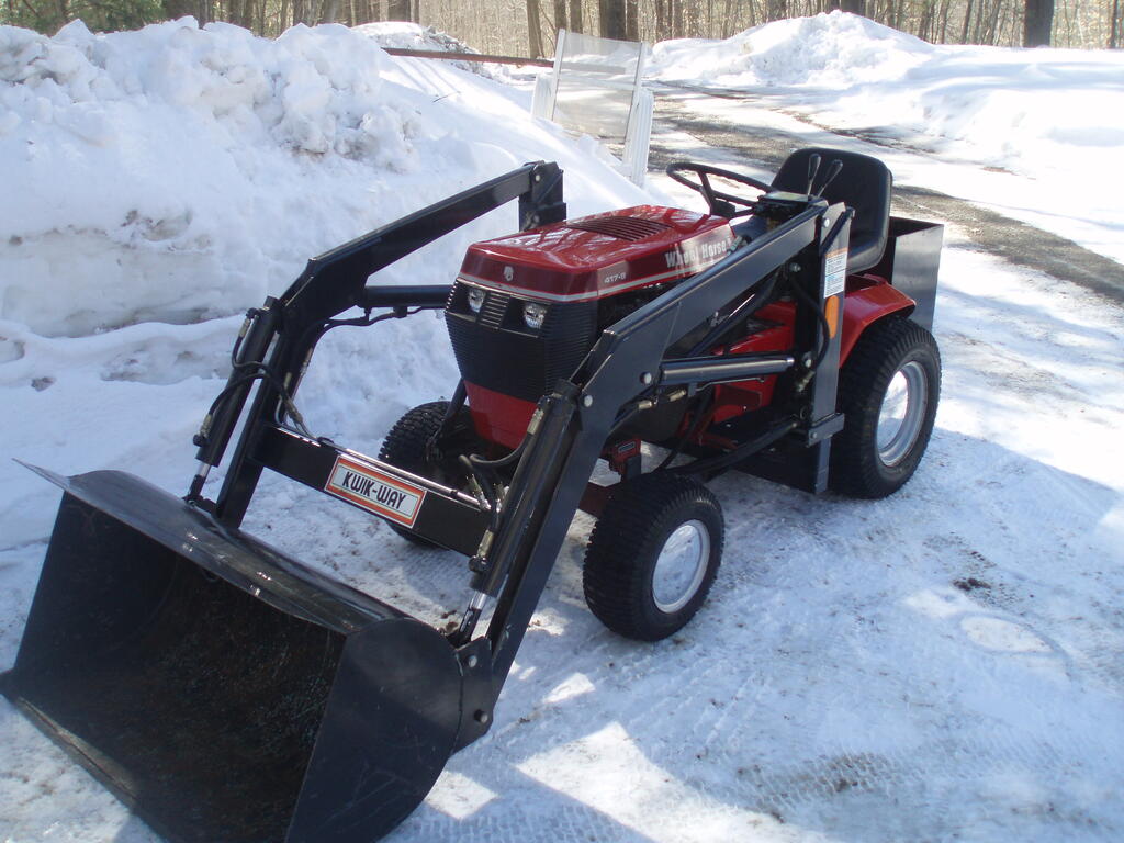

JCM 11,415 #2 Posted December 29, 2024 C- 195 , 520, 417, 418 would work. Weight box would also be a requirement. Still not much would match a true sub compact tractor. IMHO 4 1 Share this post Link to post Share on other sites

JCM 11,415 #5 Posted December 29, 2024 54 minutes ago, Donavon1 said: You got more snow than us That is an older picture. Only have had roughly 4'' of the white stuff this Winter which is fine with me. The only WH tractor that performed half way decent IMO was the 91 520 with forward swept axle AND gear reduction steering. The 400 series , not so well in the steering department with a load. 2 Share this post Link to post Share on other sites

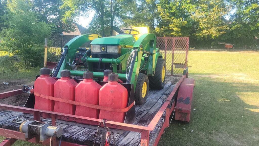

RED-Z06 2,720 #20 Posted December 29, 2024 I use a Deere 425 for my loader, id love to use a WH but, power steering is an absolute must..and very few models had that, i also prefer to use the tractor hydraulics instead of an external pump/resevoir/spool valve. The tractor is about 1100lbs, 26x12x12 tires loaded are about another 300, 3pt/bracket 4 weights another 320lbs. Loader is about 300lbs. 75lbs on each rear wheel..it tips the scales with an operator around 2500lbs, it picks up 500lbs with the hydro shimmed to 1200psi, very stable if you can keep the bucket pin height around 4ft or under. I can lift small riders, i lift generators and move them around. I dug a hole and buried my neighbors German Shepherd about 3ft down, you're limited on depth so you have to ramp down into the hole, ive dug a hole deep enough that the operators head cant be seen, that took a couple hours. So they definitely can be very handy, you have to keep in mind that lifting 500lbs at break out height isnt any indication of what it can lift at higher levels, the higher you go, the less leverage the rams have, and always keep the bucket as low as possible. 1 1 Share this post Link to post Share on other sites
