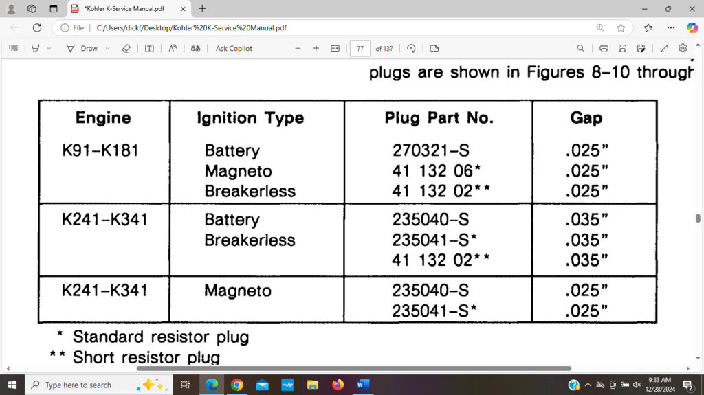

953 nut 68,507 #3 Posted December 28, 2024 Kohler manual should show 0.035 for Battery ignition and 0.025 for Magneto ignition systems. This chart is for single cylinder engines but holds true for twins as well. 2 2 Share this post Link to post Share on other sites
