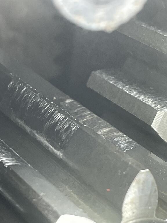

Maynardb 19 #1 Posted December 22, 2024 (edited) I’m rebuilding a 5003/5010 trans and the final drive set are quite scored up but no missing teeth. Do you think I can still use them ? Also, since parts for these are limited, will a uni-drive ( 2 piece case) final gear set work in an earlier 3 piece case? thx Edited December 22, 2024 by Maynardb Picture 1 Share this post Link to post Share on other sites

kpinnc 17,267 #5 Posted December 23, 2024 (edited) 7 hours ago, Maynardb said: quite scored up but no missing teeth. Do you think I can still use them ? Heck those look fine to me. I have seen (and used) far worse with no issues. The tranny on my 701 looks so bad by comparison that I may have to replace several gears. I’ve honestly been a little afraid to even start on it until later, but I assure you that some gears will look far worse than yours. Edited December 23, 2024 by kpinnc 1 1 1 Share this post Link to post Share on other sites
oliver2-44 11,256 #6 Posted December 23, 2024 For a show and neighborhood cruiser those gears will be excellent. I've got a rebuilt 5010 with gears that look a lot worse. take a file or sand paper wrapped around a piece of flat steel and gently take any high burrs of the teeth. But don't try to file them smooth, just remove LITTLE high spots. 3 3 Share this post Link to post Share on other sites
squonk 45,590 #7 Posted December 23, 2024 (edited) The worse thing those gears would cause would be noise. Especially if you swap pulleys around to go faster than what they were intended to. Edited December 23, 2024 by squonk 1 Share this post Link to post Share on other sites
stevasaurus 23,619 #8 Posted December 23, 2024 Those gears are fine. Concerning wear and noise, when you put your 90w oil back in, add about 1/2 qt of Lucus Oil Treatment. It is like adding some STP only better. The trans will take about 1 1/2qt of 90w. Fill until oil starts to come out the fill plug on the left side, close and then add the 1/2qt of Lucus. 3 1 Share this post Link to post Share on other sites
Maynardb 19 #9 Posted December 23, 2024 Thx for the responses. I’ll try using them. 1 Share this post Link to post Share on other sites
