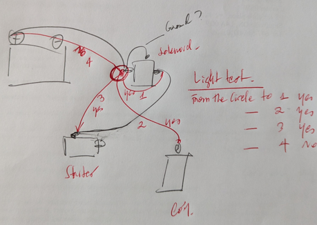

Phan 68 #6 Posted December 21, 2024 Thanks to all! Just an undate - I retested the lights (photo attached). The terminal light clip was attached to the solenoid (picture) and touched to the following as these orders: 1) the other side of solenoid, light yes 2) the coil, light yes, 3) the starter, light yes, 4) the + terminal battery, light no (but I noticed a small fire) I also notcied that I had been a weak/brief an electicshok when I touched to the tractor - why? I was scared about this. Please help! Regading cleanning and tightening the eclectical connections / grounds, I will follow through. For the PTO, it was disengaged. I have no seat swicth (it has been disconnected since I had it). As for the clutch switch, I am not sure, but mine is an C160 H. Share this post Link to post Share on other sites
gwest_ca-(File Mod) 12,416 #7 Posted December 21, 2024 Somewhere on the transmission controls there will be a switch that closes when the transmission is in the neutral position allowing the starter to operate. This neural switch along with the pto switch in the pto off position completes the circuit for the starter. The small wire at the solenoid gets power and a clunk when the electro magnet closes on the large solenoid terminals - power to starter motor. When testing with a light connect the clip on the wire to a known good ground - battery (-) is good. Then probe with the tester to check for power. Share this post Link to post Share on other sites

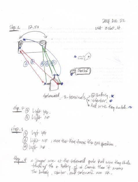

Phan 68 #16 Posted December 22, 2024 Hello - an update. I follow him posted on Youtube. Here I found out: Step-1: Check battery, I got 12.5 v Step-2: Use a light test for the following: a) + battery to the solenoid pole + battery, light YES b) – battery to the solenoid pole starter, light NO c) – battery to the solenoid pole + battery, light YES d) – battery to the solenoid pole red wire key switch, light NO, when turning the key on, light NO Step-3: Jumper wire bypass from the solenoid pole red wire key switch by touching at + battery, crank YES (when the key switch is the OFF position). This is to verify that the battery, stater, and solenoid are good. Note-1: Using a small wire did not crank. Note-2: It would not start because the key is the off position and the system is ground, but rather to verity purpose. However, I am not sure waht is the next step I should do. I checked the safety switch at the brake pedal, NO any rusts and free moving. I checked the PTO interlock, NO rusts and free moving. How I know that the key swicht is ok? Share this post Link to post Share on other sites

Razorback 1,370 #18 Posted January 2, 2025 (edited) I'm going to add a link to a post I made a few years ago when I first got my C160 and could not get it to start reliably. My culprit involved the safety switch behind the PTO lever...... too much gap between the button in the switch and the wiper that was supposed to make contact..... Edited January 2, 2025 by Razorback Share this post Link to post Share on other sites
