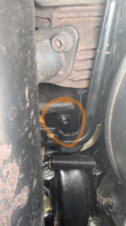

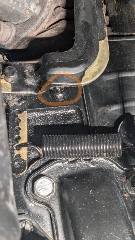

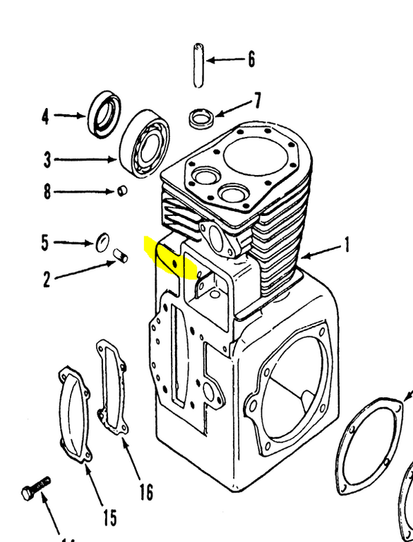

Alrashid2 476 #15 Posted January 2, 2025 (edited) Hey guys, update. Used the black RTV to seal the camshaft cover. Cured 24 hours and ran the tractor for 20 min around the property - no leaks! However, now I see a ton of oil leaking from above the camshaft cover, from this random screw here - anyone know what this screw does? Can I take it out and seal it too? Took a few photos of the front of the engine and also pointed to the screw location on a parts diagram, though I'm not seeing the screw itself listed or described anywhere... Thanks guys Edited January 2, 2025 by Alrashid2 Share this post Link to post Share on other sites
rmaynard 17,612 #16 Posted January 2, 2025 My opinion is that you do not need RTV on the gasket. If you have oil coming from places where it should not, look to see if you assembled the reed valve correctly in the crankcase ventilation system (behind that cover you put RTV on). A reed valve installed backwards will cause crankcase pressure to build and oil will be force out anywhere it can. Governor shaft is usually the first place you will see it. Share this post Link to post Share on other sites
