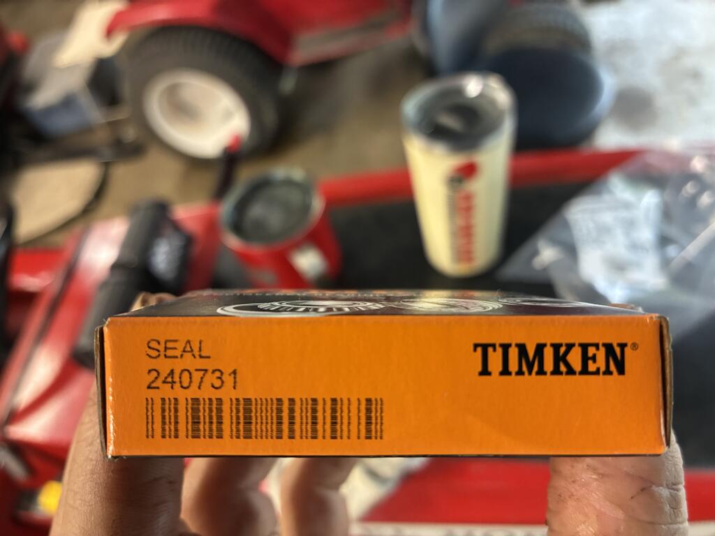

SylvanLakeWH 32,921 #12 Posted October 1 (edited) Another 100863 option: Perfect fit. Edited October 1 by SylvanLakeWH 1 Share this post Link to post Share on other sites
