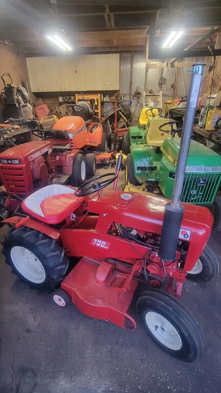

Lee1977 7,782 #2 Posted December 18, 2024 600 x12 can be found in R1 rear tractor type and 400x8 in Deestone triribs. I have Deestone 400x8 triribs on a couple of my tractors. 1 Share this post Link to post Share on other sites

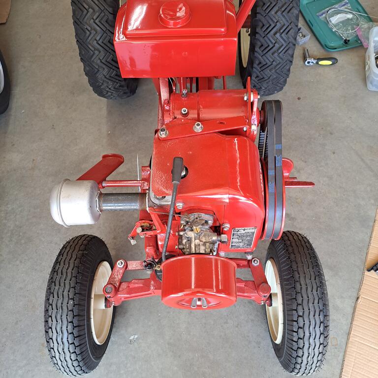

RED-Z06 2,720 #3 Posted December 18, 2024 I did 6x12 Firestones and 4.80x8 Deestones up front, real nice fitment. 2 Share this post Link to post Share on other sites

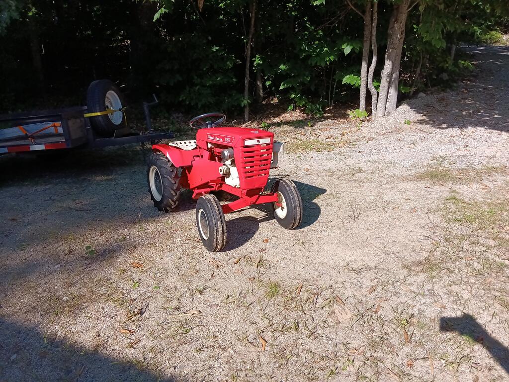

ebinmaine 80,749 #4 Posted December 18, 2024 This is Trina's 657 Pony. She used Carlisle 6/12 rear AGs and Deestone fronts. 2 Share this post Link to post Share on other sites
