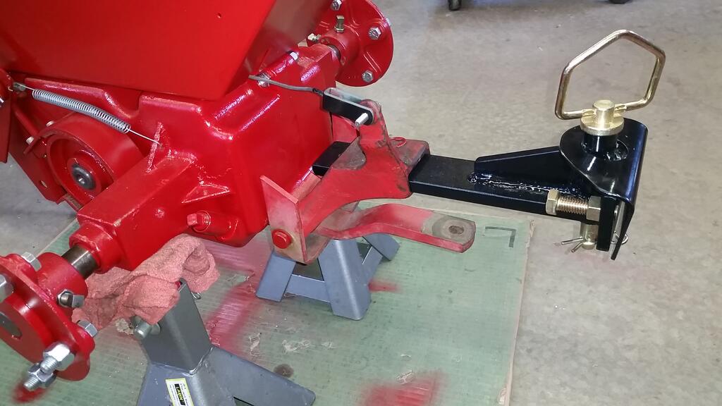

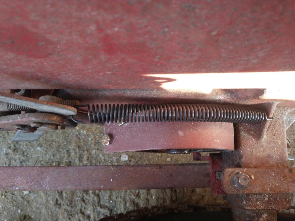

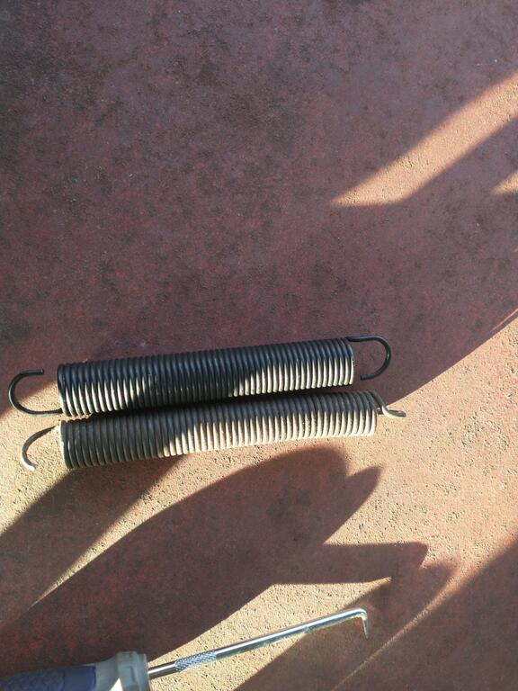

ebinmaine 77,498 #1 Posted December 18, 2024 As per request of @953 nut here's a couple part numbers and pics of the clutch springs we use. For Trina's mid 60s tractors I ordered clutch/brake pedal springs from McMaster Carr. These should fit most 3 and 6 speed tractors with a SINGLE pedal. https://www.mcmaster.com/#3114T112 Extension Springs with Hook Ends Black-Oxide Music-Wire Steel, 4.5" Long, 0.625" OD These are just a touch stronger than the stainless steel ones I've found recommended. New one on top. The one that I use for all my TWO PEDAL tractors from 1968 up is the standard Toro part number 108035. 3 2 2 Share this post Link to post Share on other sites

WHX?? 55,183 #3 Posted December 18, 2024 Little tip for the restorers here ... Slide a piece of clear 1/2 tubing over the spring to protect new ... or old paint on the brake band. Protects the spring too. Thought I had a pic. Found these springs in the drawers at a hardware store. Not quite as strong as EB's but works well. 3 Share this post Link to post Share on other sites
