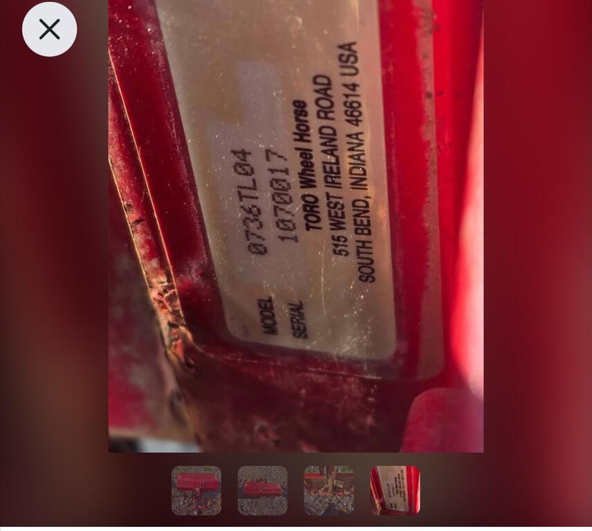

gwest_ca-(File Mod) 12,557 #2 Posted December 17, 2024 This parts list shows what was included with the tiller. Share this post Link to post Share on other sites

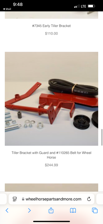

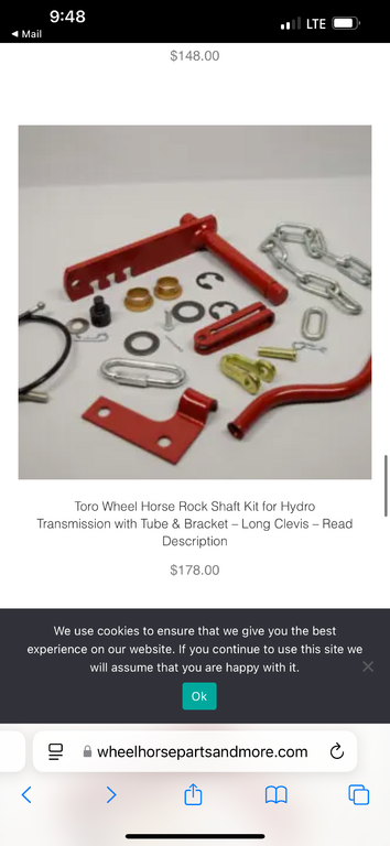

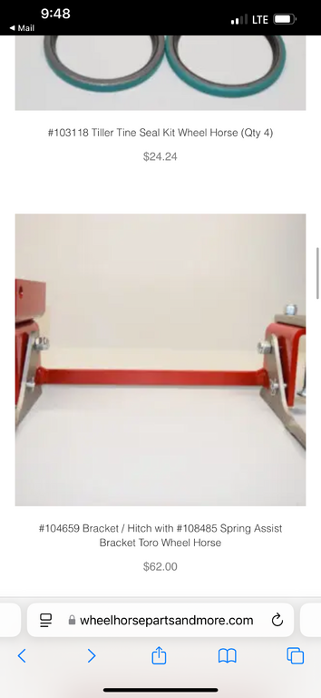

WHX?? 58,388 #3 Posted December 17, 2024 For a 520 you will need the rear rockshaft kit, the mid-mount assembly and a axle bracket. They can all be had from Parts n more but your looking at a pretty substantial investment. Pretty much a deal breaker for me unless the tiller is less than 100 and the tines better be in good shape. An option would be to scrounge used parts but hit n miss. Share this post Link to post Share on other sites
gretle_2.0 41 #4 Posted December 17, 2024 Just now, WHX?? said: For a 520 you will need the rear rockshaft kit, the mid-mount assembly and an axle bracket. They can all be had from Parts n more but your looking at a pretty substantial investment. Pretty much a deal breaker for me unless the tiller is less than 100 and the tines better be in good shape. An option would be to scrounge used parts but hit n miss. Yeah the tiller is for sale for $100 and tines look in decent shape too. 1 Share this post Link to post Share on other sites
WHX?? 58,388 #5 Posted December 17, 2024 Go to https://wheelhorsepartsandmore.com/ and add up the items I listed. The axle bracket can be had cheaper elswhere and you may get blind outhouse lucky and find the parts on fleabay or such. For 100 the tines are worth that for someone who might need replacement donor tines. Share this post Link to post Share on other sites
gretle_2.0 41 #6 Posted December 17, 2024 Just now, WHX?? said: Go to https://wheelhorsepartsandmore.com/ and add up the items I listed. The axle bracket can be had cheaper elswhere and you may get blind outhouse lucky and find the parts on fleabay or such. For 100 the tines are worth that for someone who might need replacement donor tines. Oh okay yeah just added everything up for those parts and it’s $485. More than I was expecting. Guess I’ll wait until I find a complete tiller then. Share this post Link to post Share on other sites
WHX?? 58,388 #7 Posted December 17, 2024 2 minutes ago, gretle_2.0 said: it’s $485 Yeah that's about what I came up with and that's without shipping, Well it wouldn't hurt to give Lowell a call and see if he can do a package deal. He's pretty good that way. It bums me out that there is a tractor running around out there with your parts on it yet which are good for nothing without the tiller. Another idea is to put on your detective cap and try and back track POs for the parts. Might be far fetched but ??? I feel for ya as I bought a deuce snow blower and was in the sane predicament. Guys here helped me out immensely to put it together. 1 Share this post Link to post Share on other sites

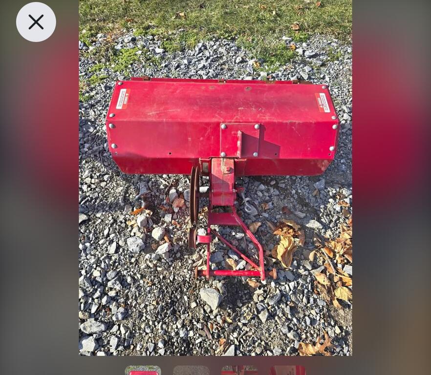

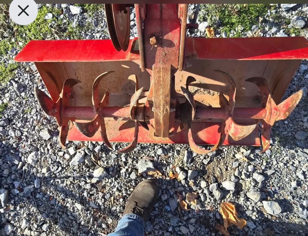

clueless 3,440 #18 Posted December 18, 2024 I think before you decide to not buy the tiller, it would help us better to determine if it's worth $100 we need a couple of photos of the working side. You said the tines were in decent shape, if that's true it's worth $100 at least down here. I've bought just the tiller a couple of time over the year down here and over time found the rest of the stuff in good shape on this site, ebay and other sites for far less than $400 and that counting shipping. I understand why the guys here are saying it's probably not worth it, because they, like you live in the land of plenty, and since you do, those parts can be found used for a decent price. I couple of photos of the tines would help a lot, the outside of the car looks in good shape, we just need to see what's under the hood. 1 Share this post Link to post Share on other sites
gretle_2.0 41 #19 Posted December 19, 2024 (edited) 21 hours ago, clueless said: I think before you decide to not buy the tiller, it would help us better to determine if it's worth $100 we need a couple of photos of the working side. You said the tines were in decent shape, if that's true it's worth $100 at least down here. I've bought just the tiller a couple of time over the year down here and over time found the rest of the stuff in good shape on this site, ebay and other sites for far less than $400 and that counting shipping. I understand why the guys here are saying it's probably not worth it, because they, like you live in the land of plenty, and since you do, those parts can be found used for a decent price. I couple of photos of the tines would help a lot, the outside of the car looks in good shape, we just need to see what's under the hood. Now looking at it the tine look pretty worn. So probably not worth it then. Edited December 19, 2024 by gretle_2.0 Share this post Link to post Share on other sites
lynnmor 9,081 #20 Posted December 19, 2024 57 minutes ago, gretle_2.0 said: Now looking at it the tine look pretty worn. So probably not worth it then. Yes, they are worn but when new they appear to be half worn out. Share this post Link to post Share on other sites
clueless 3,440 #21 Posted December 20, 2024 12 hours ago, gretle_2.0 said: Now looking at it the tine look pretty worn. So probably not worth it then. Yep their worn but still very usable, the rest of it looks about like the tines, a bit road hard but definitely not road hard and put up wet. Depending on the type soil you have those tine will work, down here in our sandy soil it works just fine. If you have harder soil and even some rock mixed in you would have to make a few more passes with the first about an 2 inches deep and lowering it a bit each past till you get to about 3.5 to 4 inch. I'm not trying to tell you it's worth it to you, you do you but the tiller is worth $100. Share this post Link to post Share on other sites
