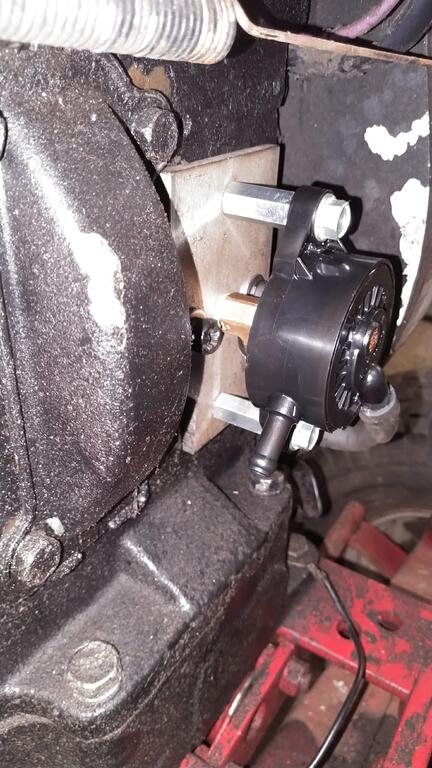

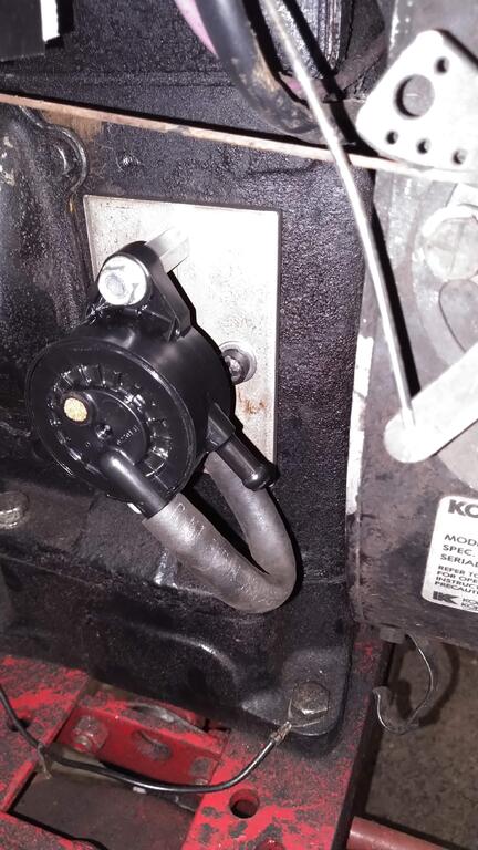

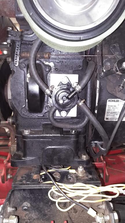

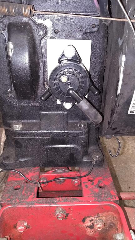

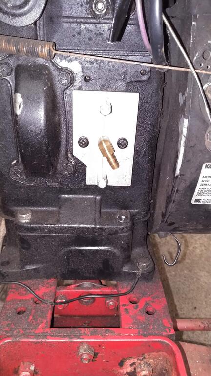

Bill D 2,992 #32 Posted February 15, 2025 22 minutes ago, Pete D said: I've been running my '73 which seems weak. It just occurred to me that when I replaced my fuel line, it ran down from the tank to a petcock & filter, then directly to the carb. Hmmm. Sounds like an electric pump may be in my near future plans. To be confirmed tomorrow. Or you could do something like this. This is a vacuum pulse pump adapted to a Kohler single. If you go this route use a genuine Briggs, Kawasaki or Kohler pump. They are made in Japan. Much better quality. 1 1 Share this post Link to post Share on other sites
