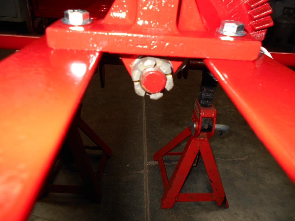

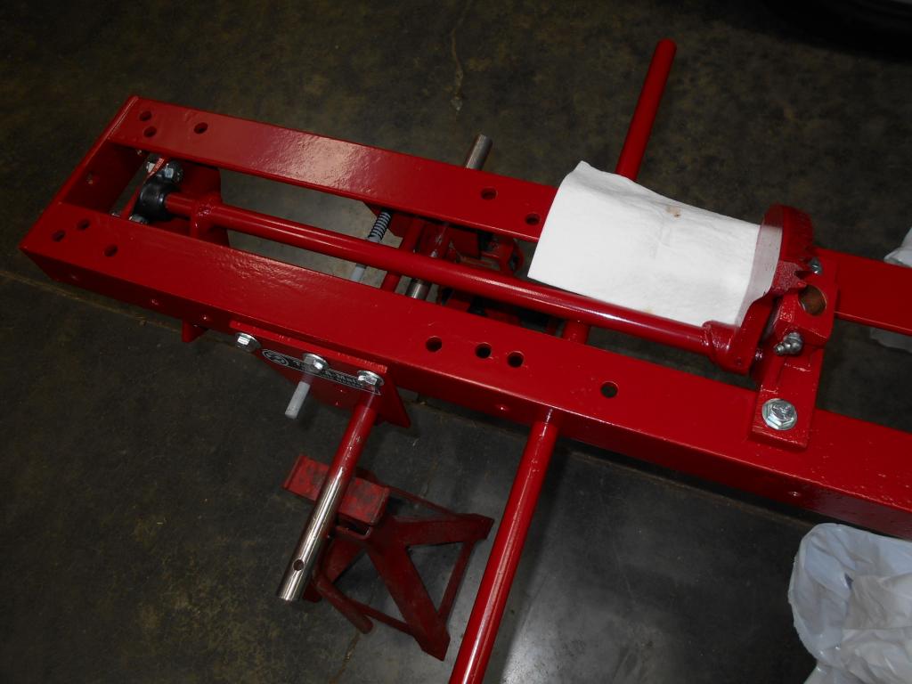

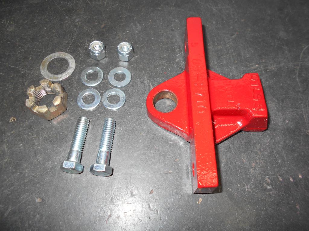

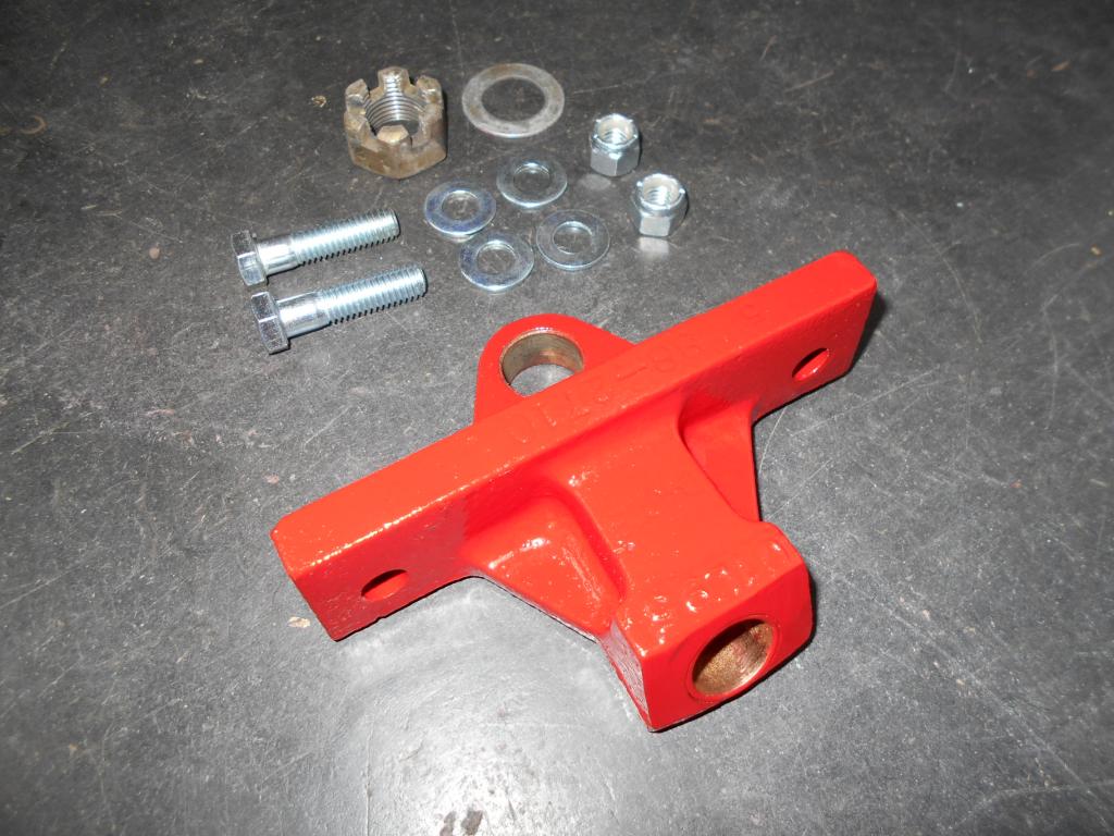

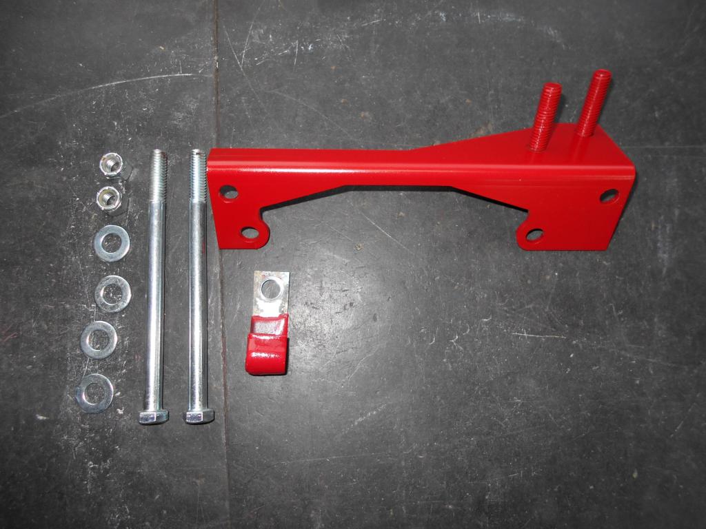

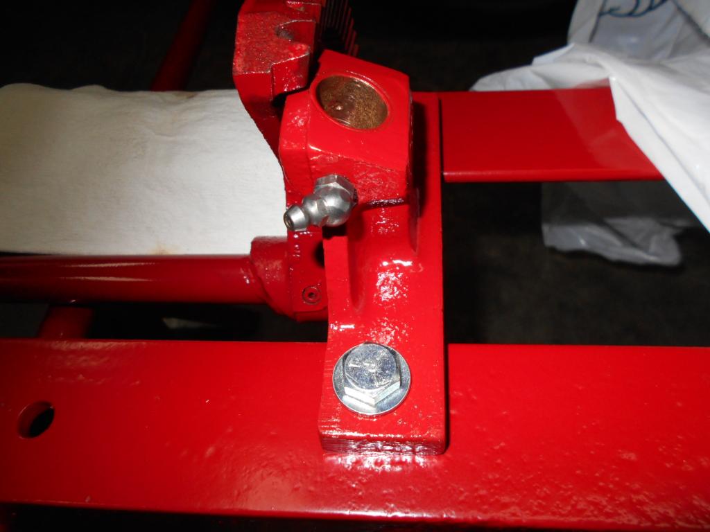

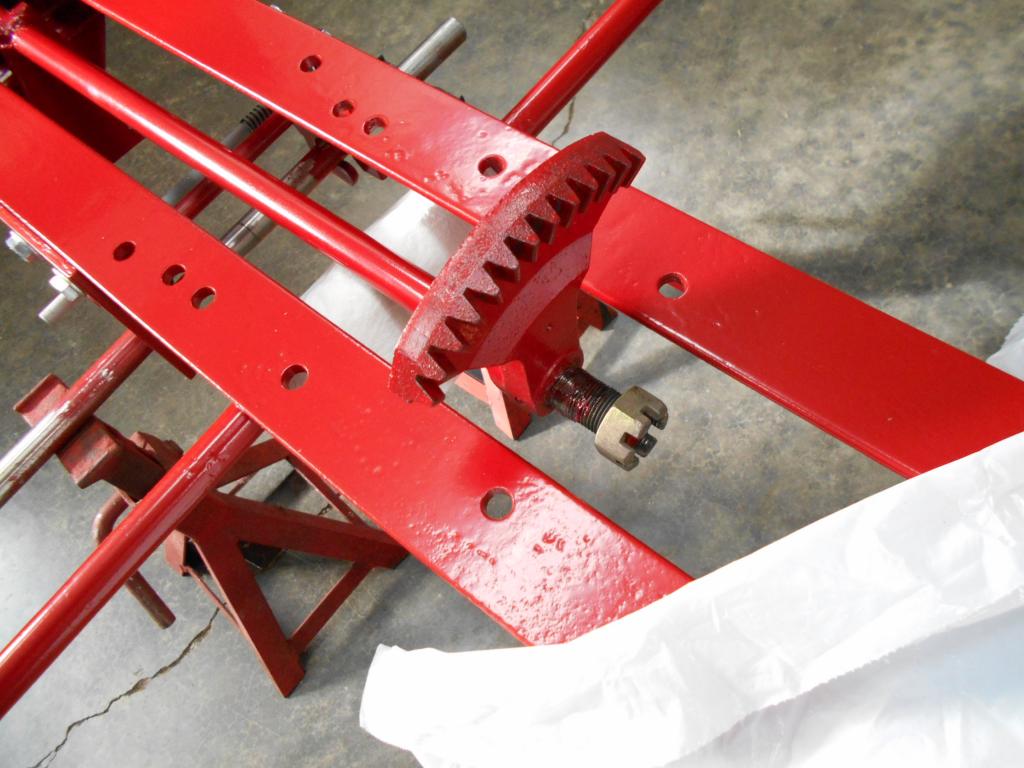

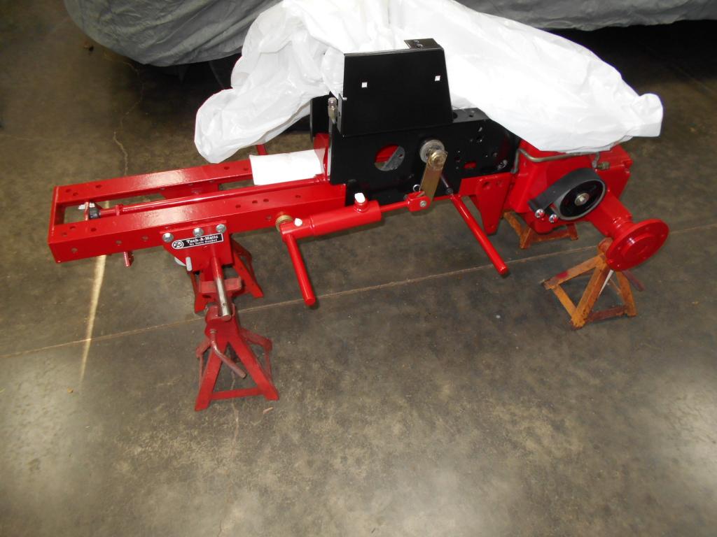

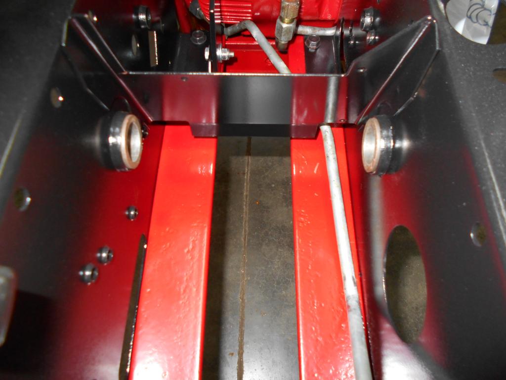

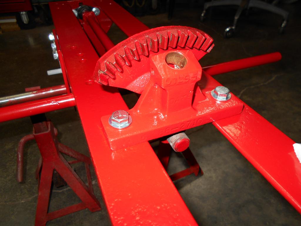

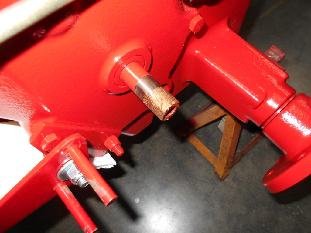

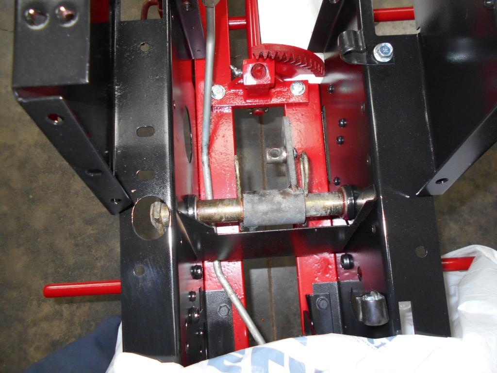

cleat 9,441 #127 Posted November 21, 2025 Lower steering shaft support block ready to install. Block has new bronze bushings installed top and bottom. Bolts are 1-1/2" long and fit perfect even though parts manual calls for 1-3/4". Lower steering shaft showing slotted nut. Nut removed from lower steering shaft then shaft greased where it slides into block. Block slid onto lower steering shaft then bolted to frame. Bolts torqued to 30 ft/lb. Grease fitting installed. Never seize applied to shaft threads then washer and nut loosely installed. Overview of steering assembly as installed. 2 4 Share this post Link to post Share on other sites

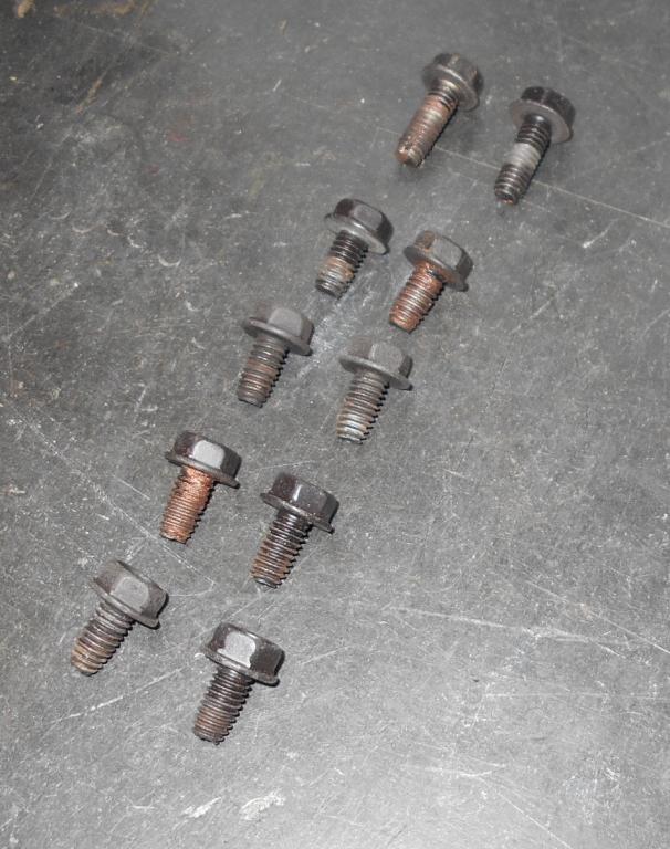

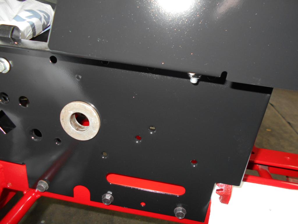

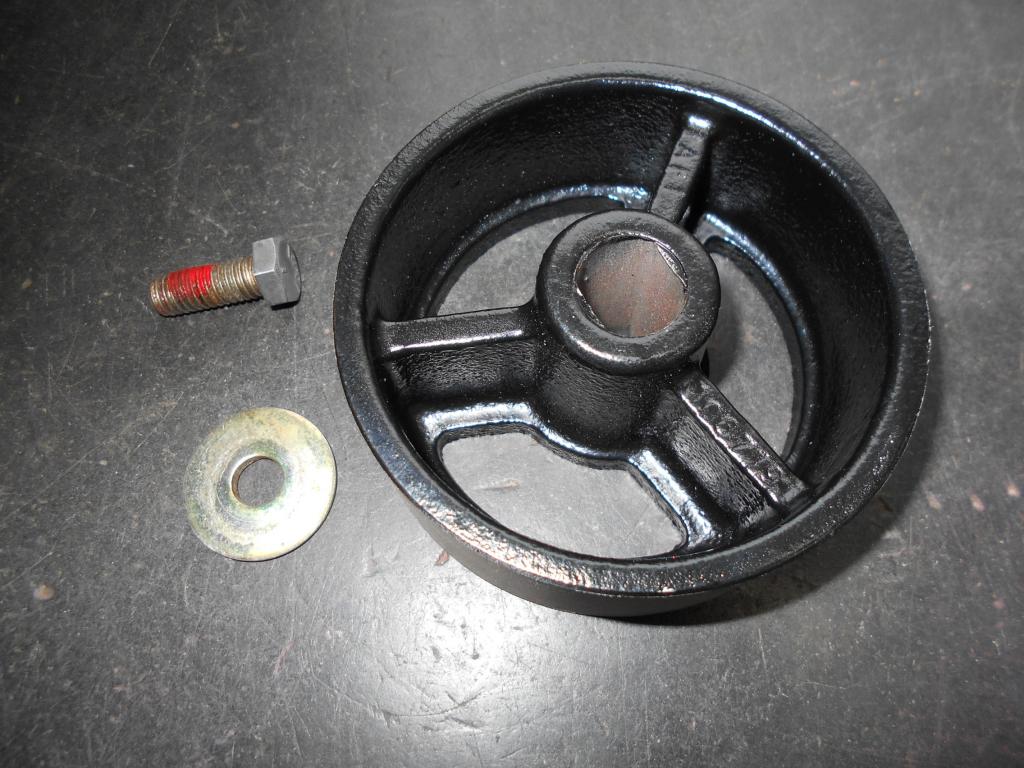

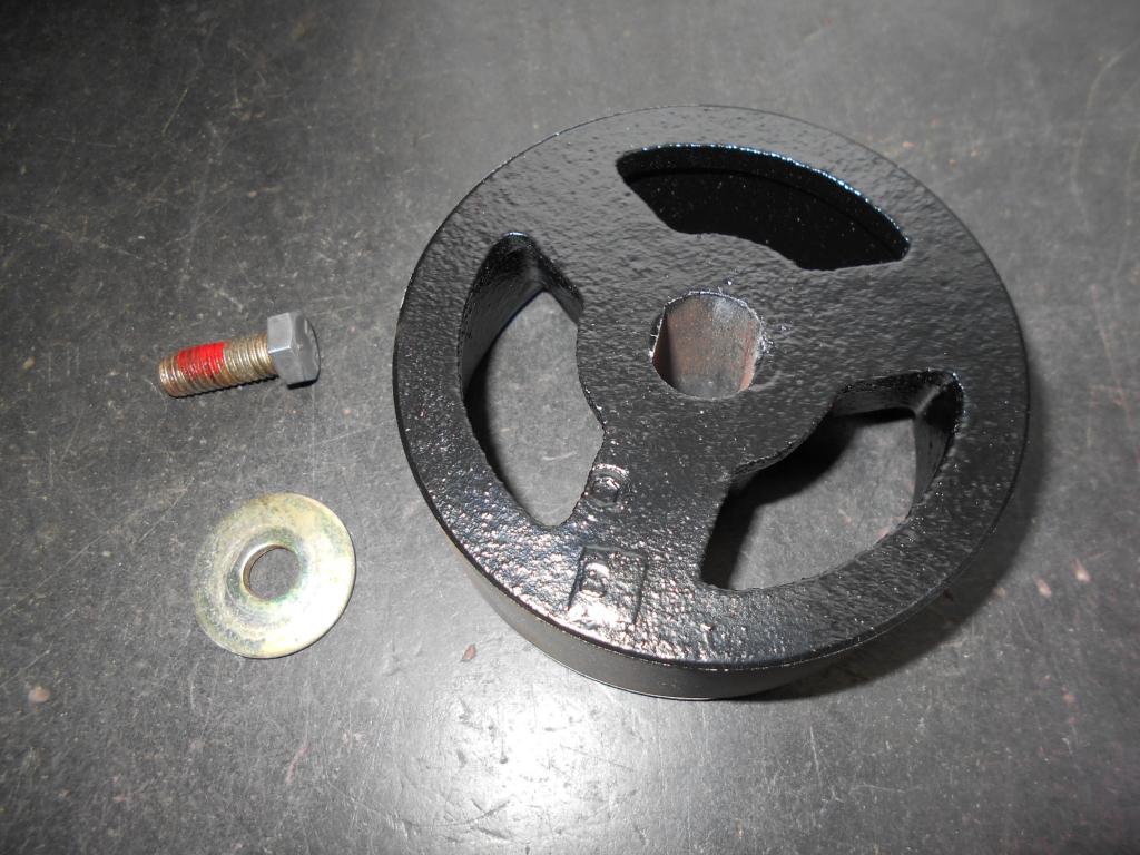

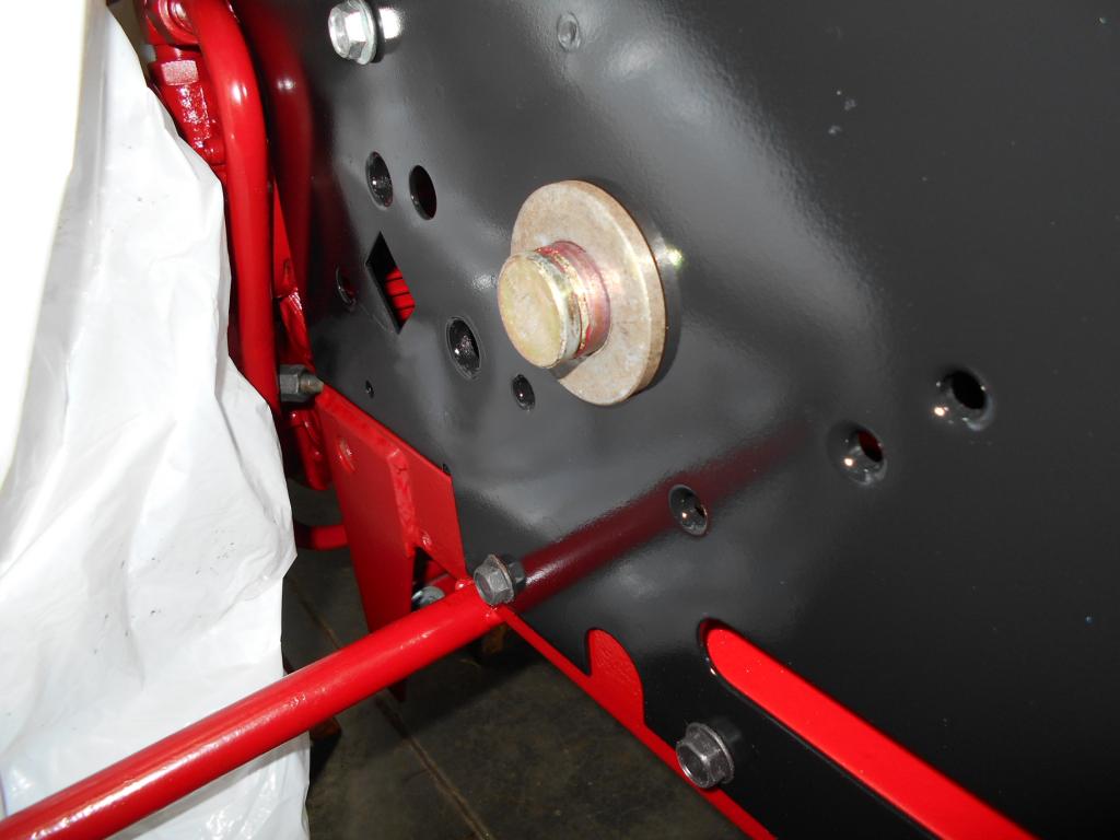

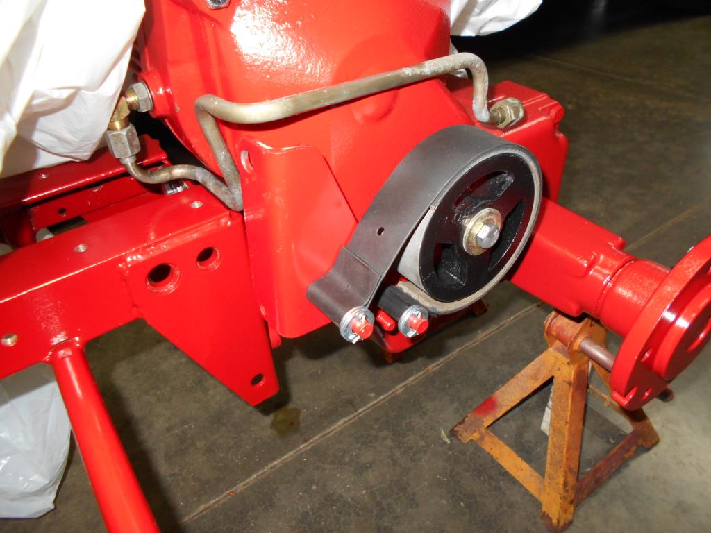

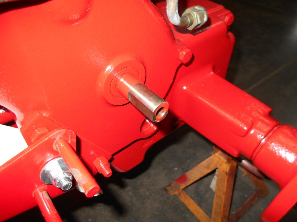

cleat 9,441 #136 Posted November 23, 2025 Brake drum shaft ready for drum. Light coat of never seize applied so drum will come off easier next time. Brake drum and hardware ready to be installed. This OEM but used bolt has some form of thread locker on it. Drum installed and bolt tightened. 5 Share this post Link to post Share on other sites

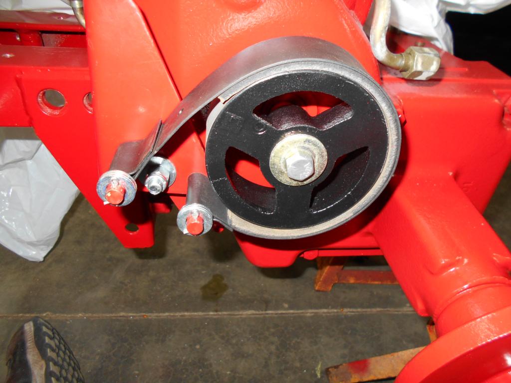

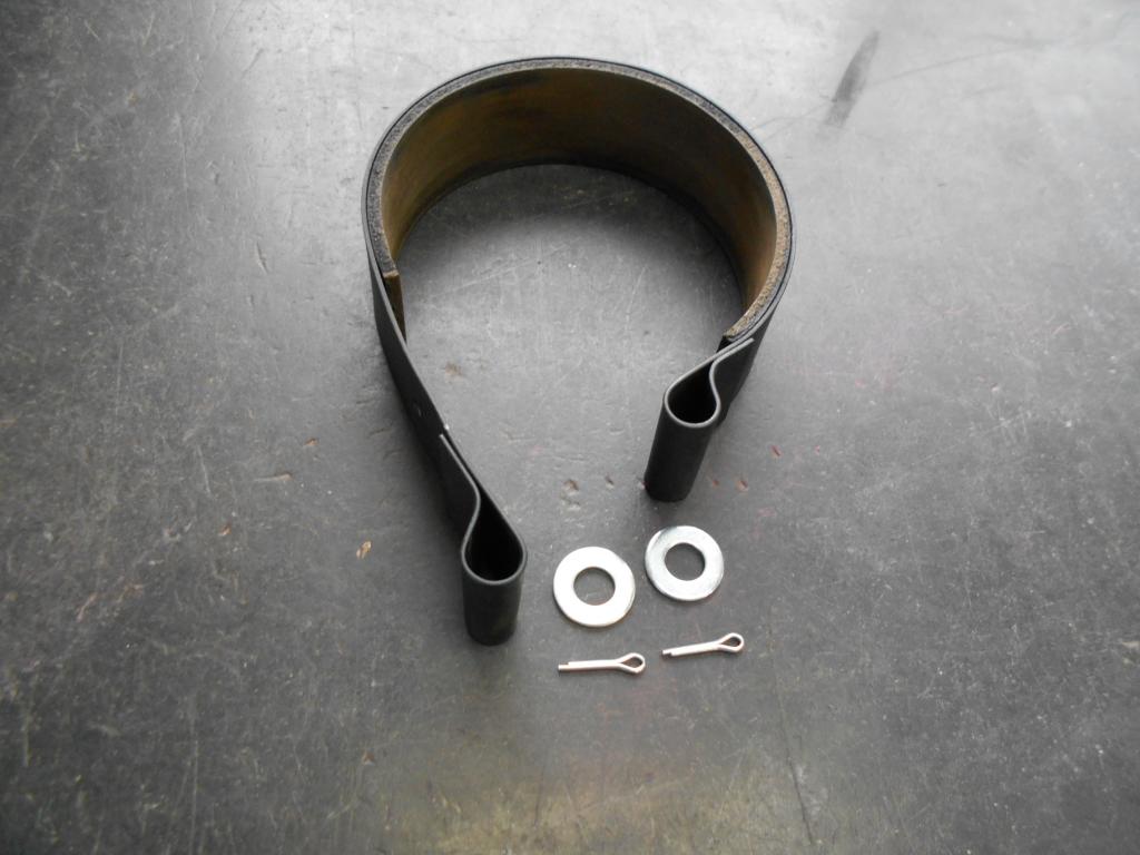

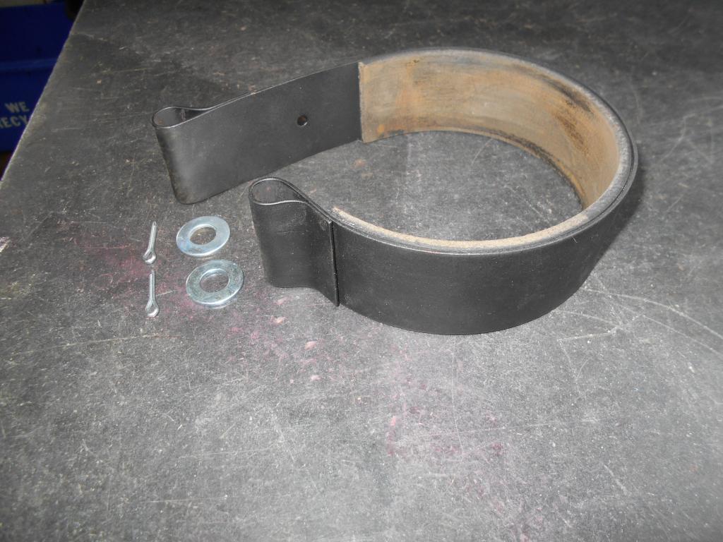

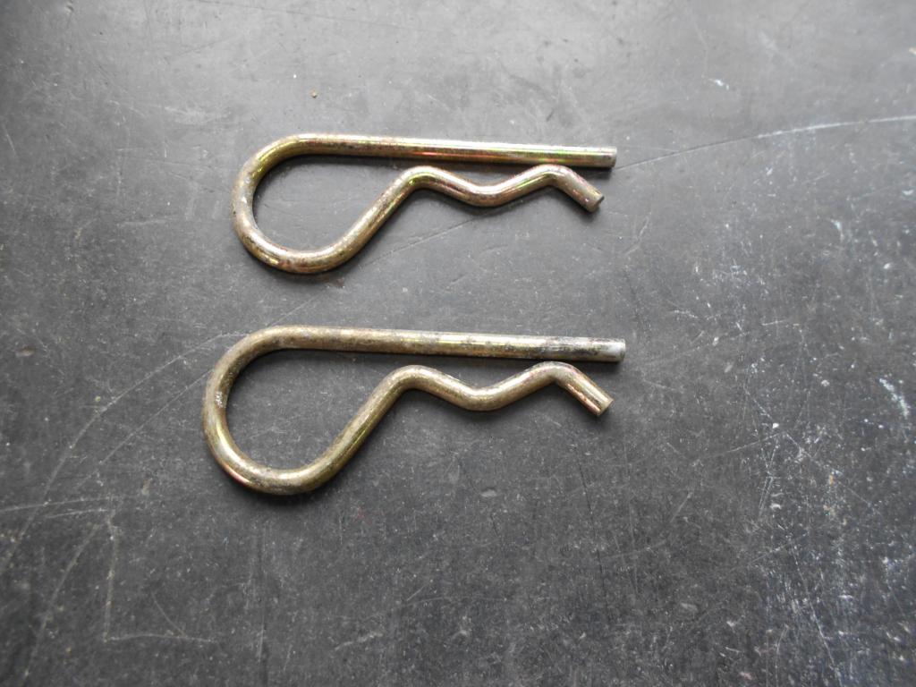

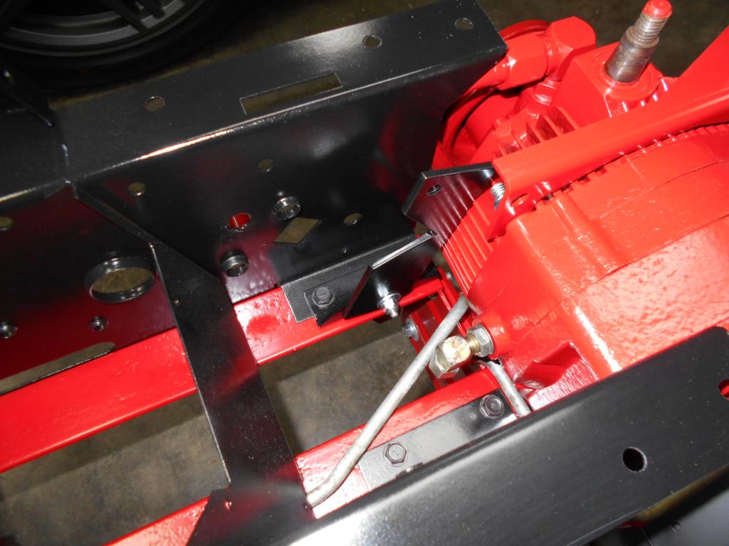

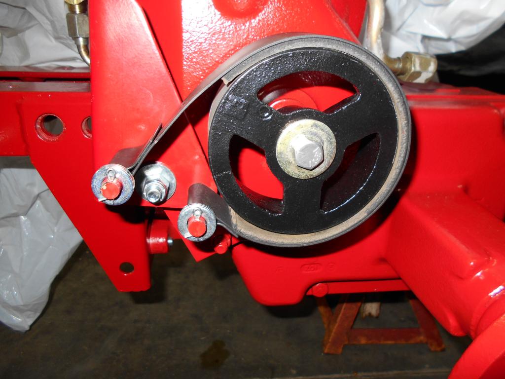

cleat 9,441 #137 Posted November 23, 2025 Brake band ready to be installed. Brake band installed. Note that I used extra washers to hold band in more securely but there is still a bit of play to ensure free movement. 6 1 Share this post Link to post Share on other sites

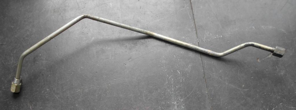

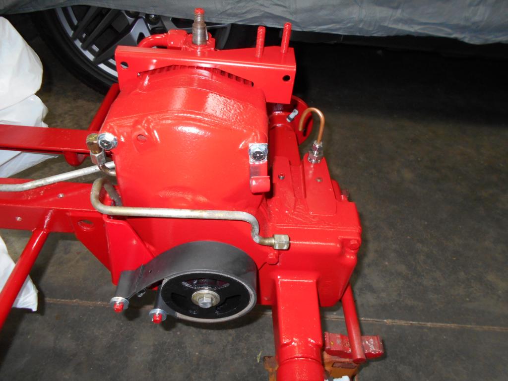

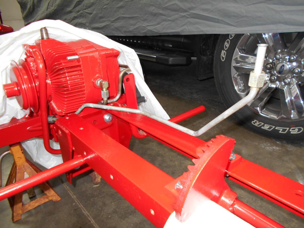

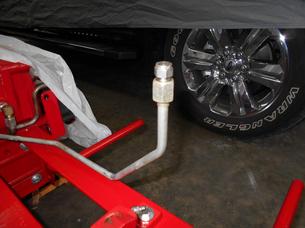

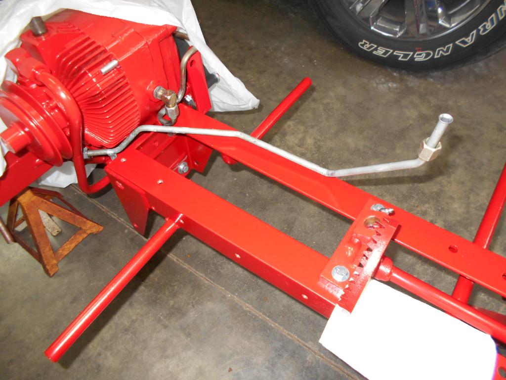

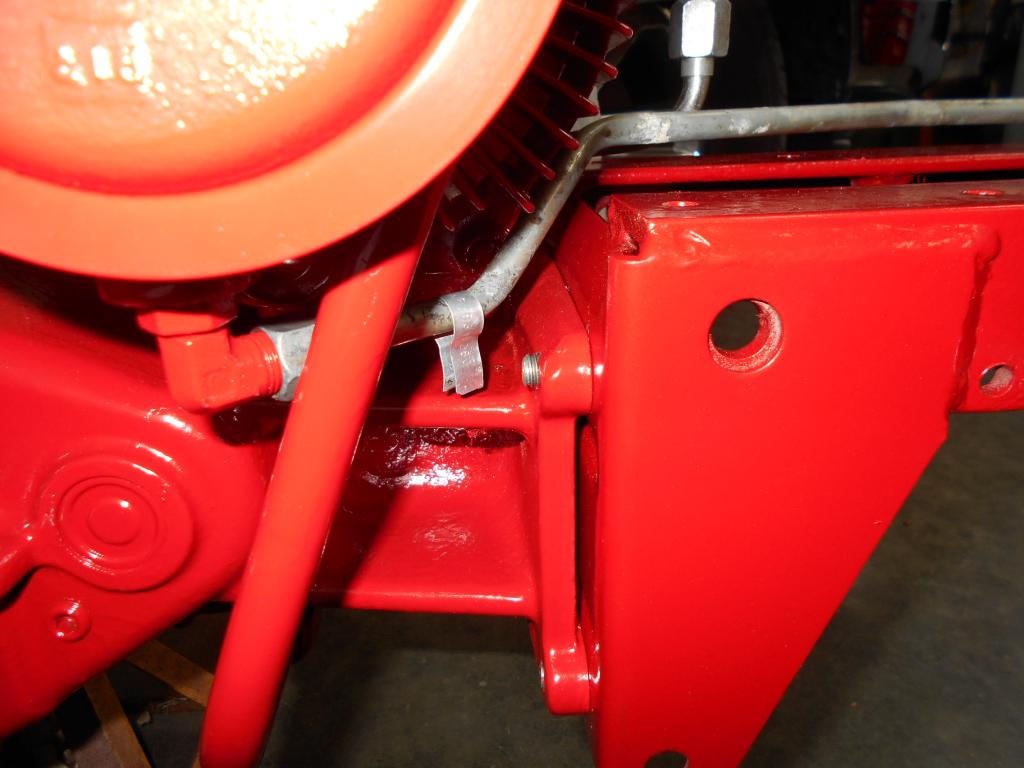

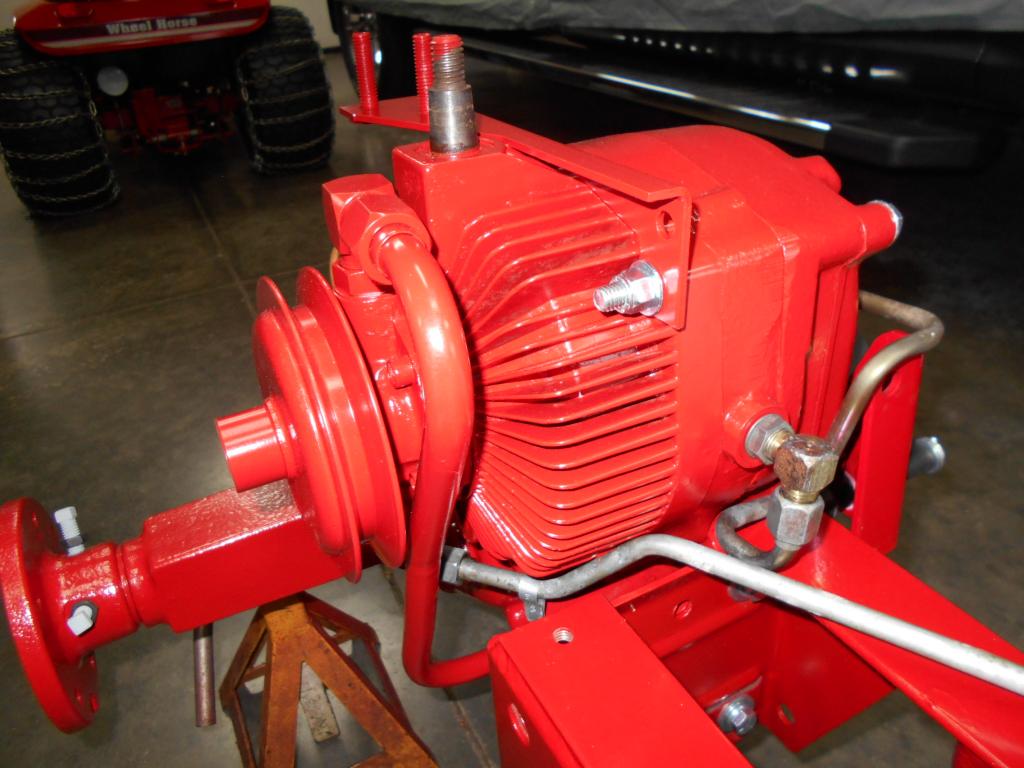

cleat 9,441 #138 Posted November 23, 2025 Hydraulic supply line from pump to valve ready to be installed. Hydraulic supply line from pump to valve installed and nut tightened finger tight. Hydraulic supply line from pump to valve temporary plug installed. 4 1 Share this post Link to post Share on other sites

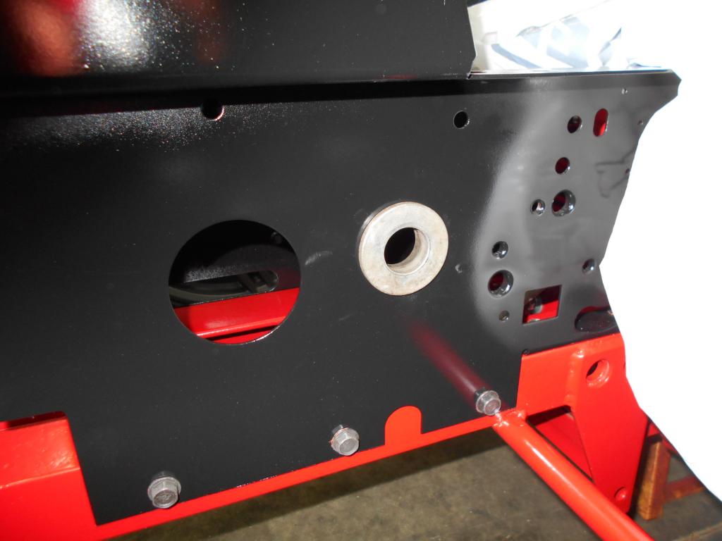

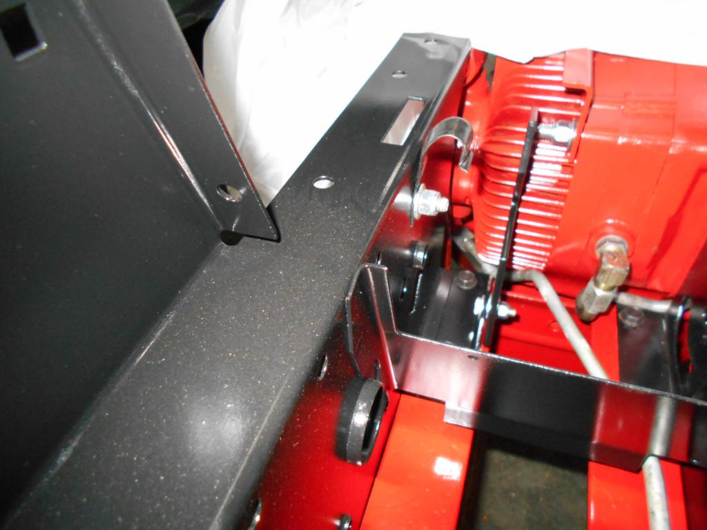

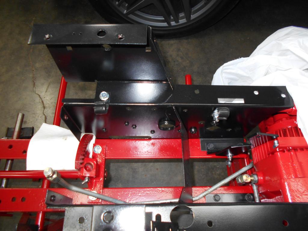

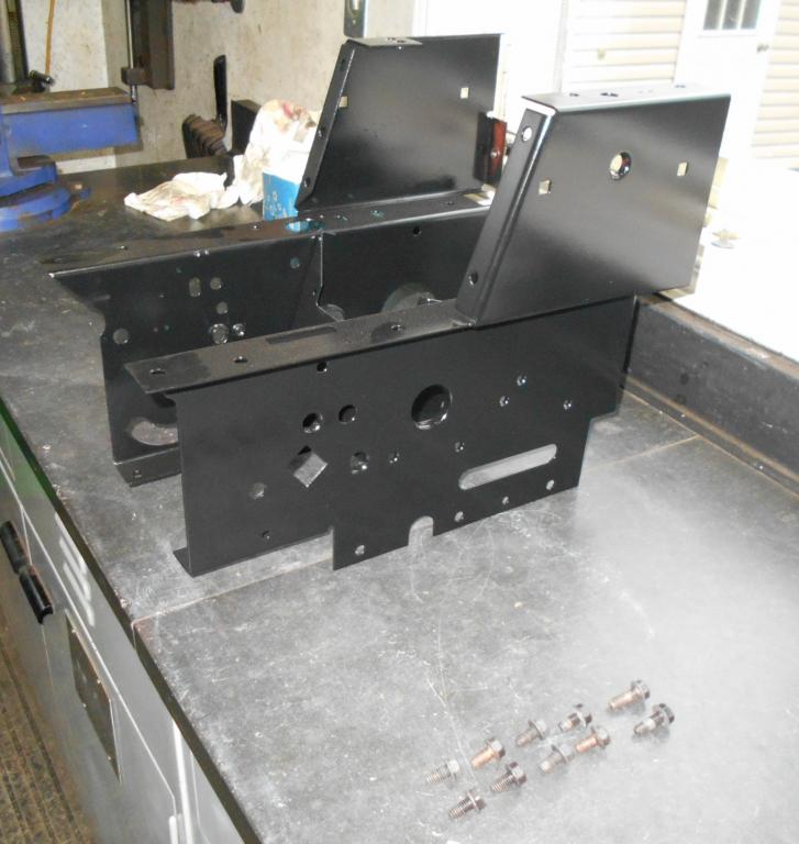

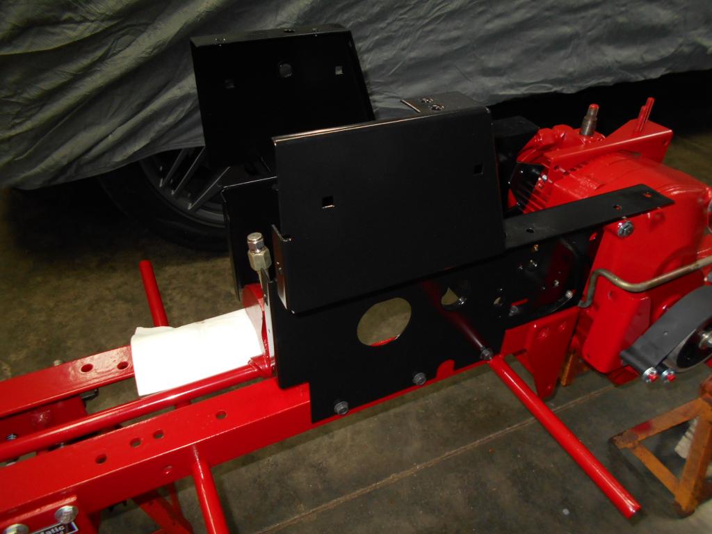

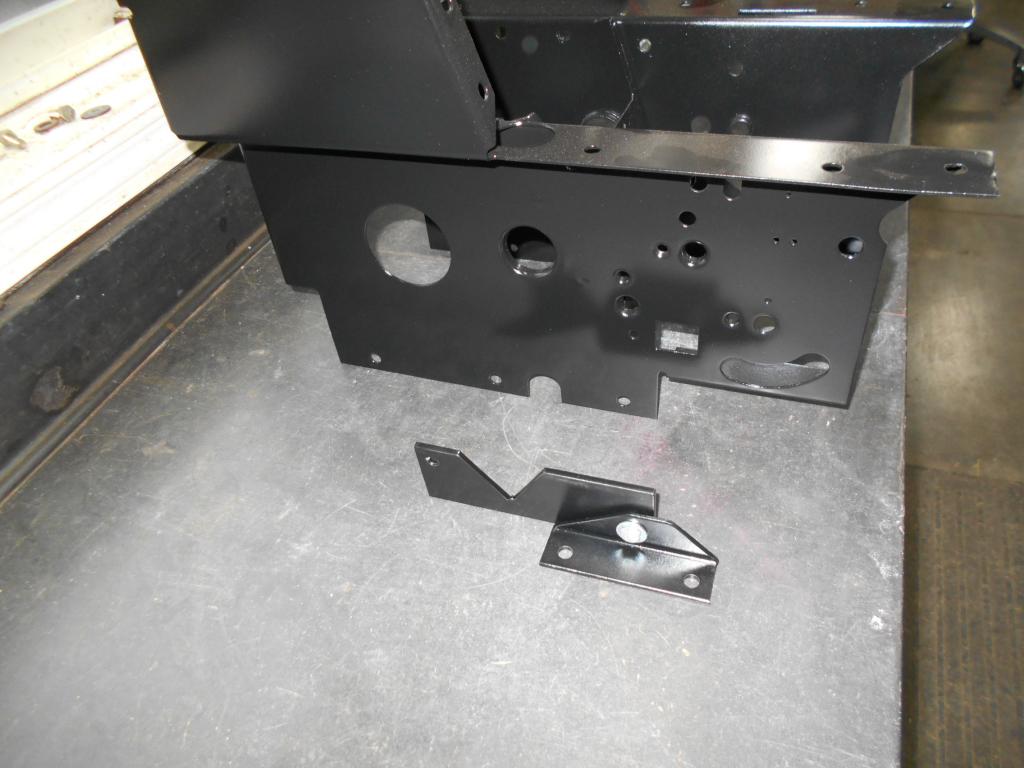

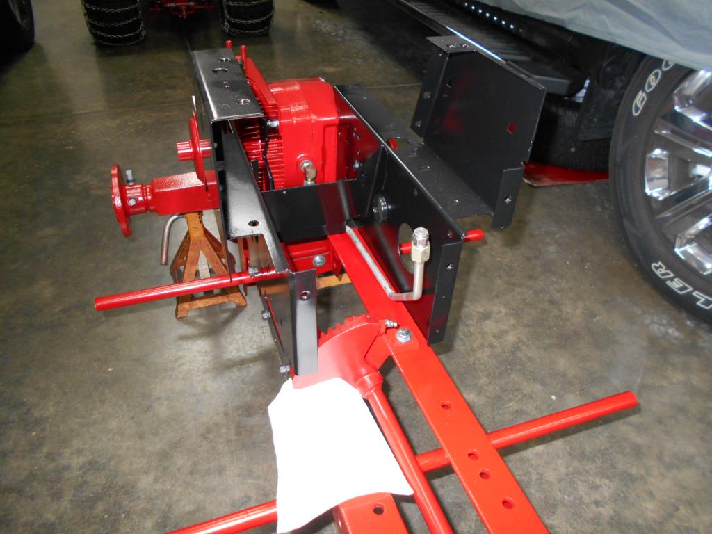

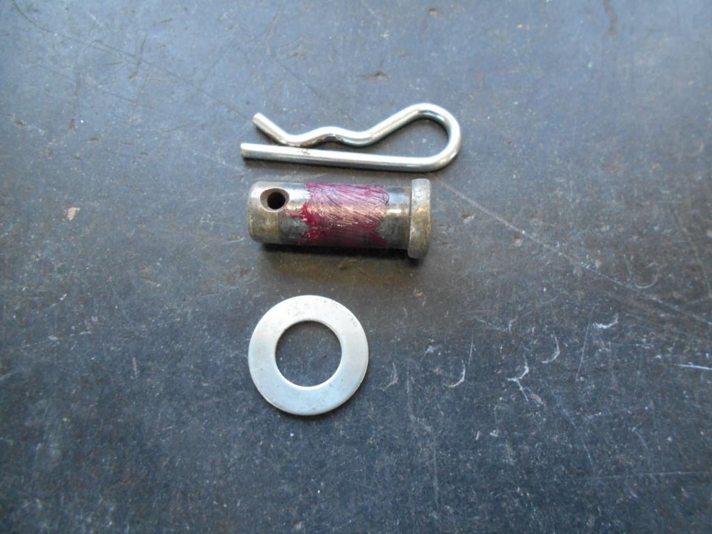

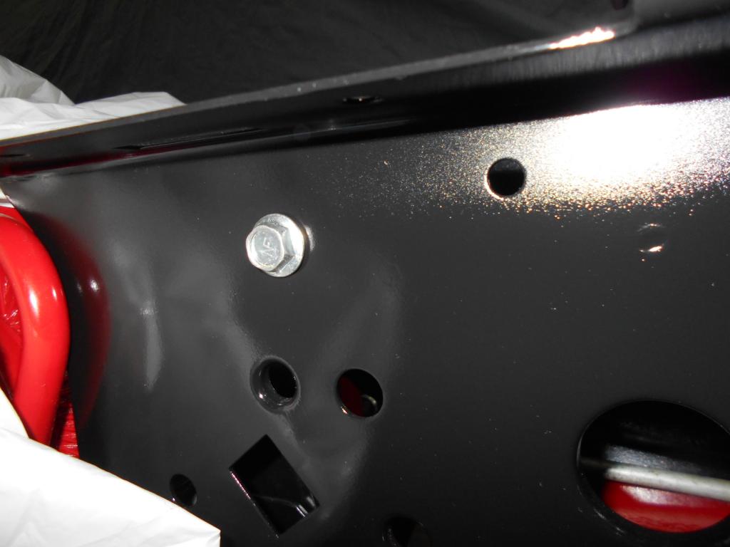

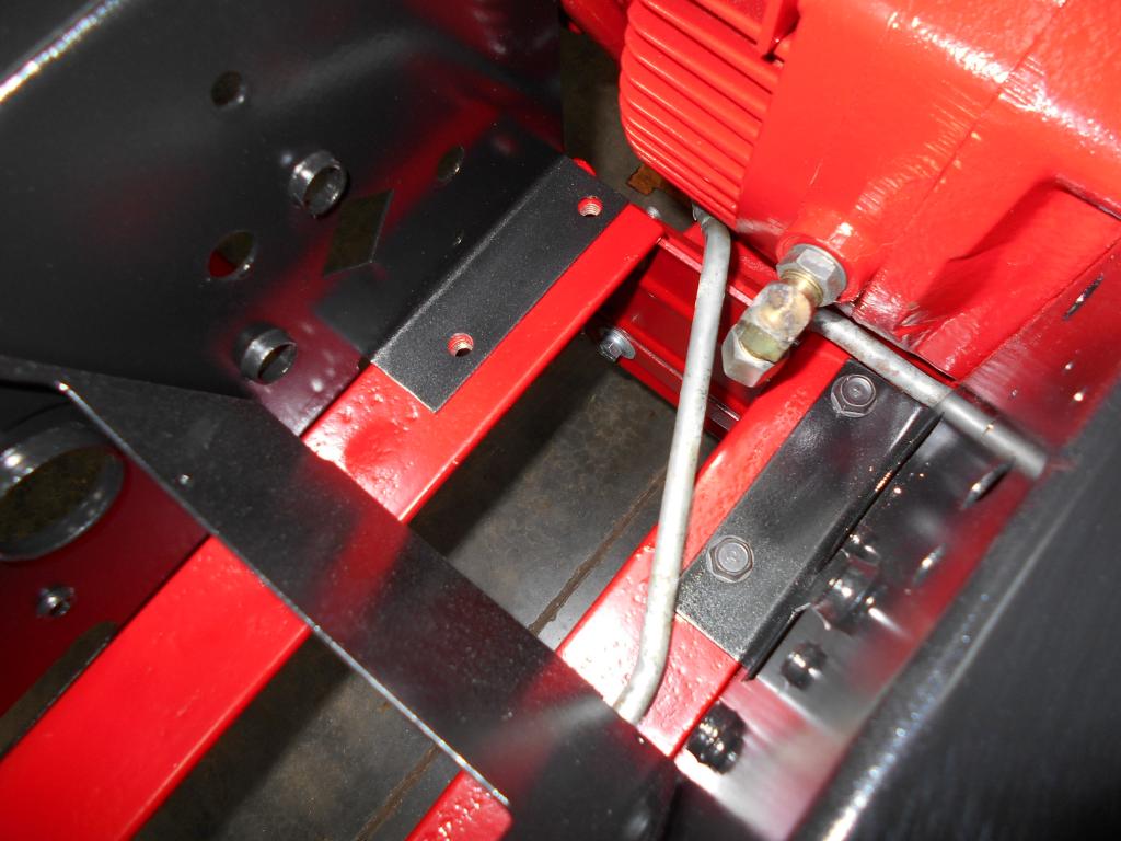

cleat 9,441 #144 Posted November 26, 2025 (edited) Hoodstand ready to be installed. Hoodstand bolts ready. I ended up just using 10 of the shorter bolts, the longer ones were not needed. Hoodstand and foot control auto-center lever ready to be installed. Hoodstand sat into position on frame and two front lower bolts screwed in to hold it in position. All the lower side bolts screwed in finger tight then the top left bolts were screwed in finger tight. This will properly align the hoodstand. The foot control auto-center lever is now ready to be installed. Picture shows slightly longer bolts (7/8") but these were not required so I used the same length bolts as in the rest of the hoodstand (5/8"). Foot control auto-center lever installed. All 10 hoodstand mounting bolts including the ones in the foot control auto-center lever torqued to 17 ft/lb. The 1/4" pivot bolt in the foot control auto-center lever is just tightened enough to not have any side to side play but must pivot freely. Edited November 26, 2025 by cleat 4 2 Share this post Link to post Share on other sites

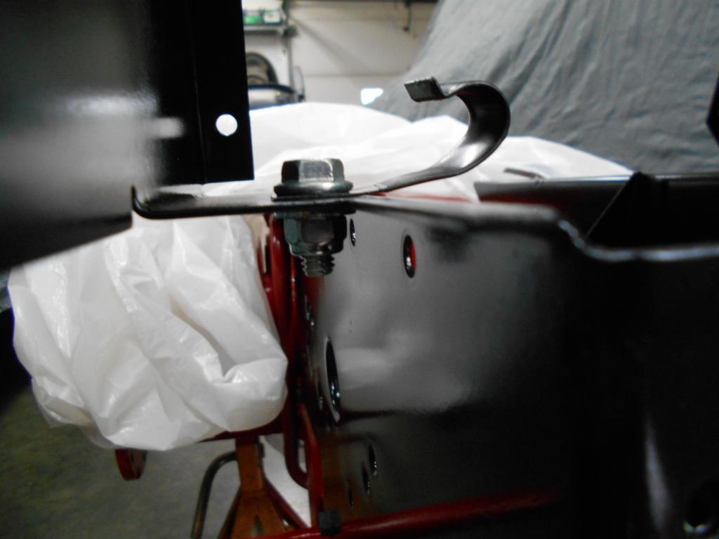

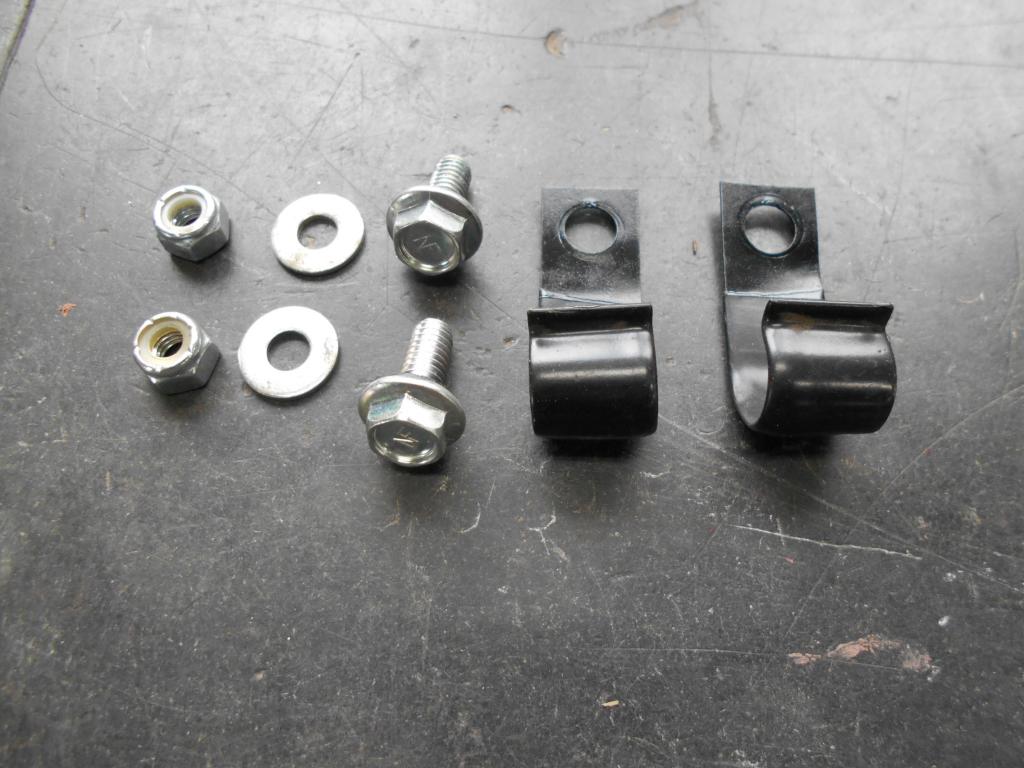

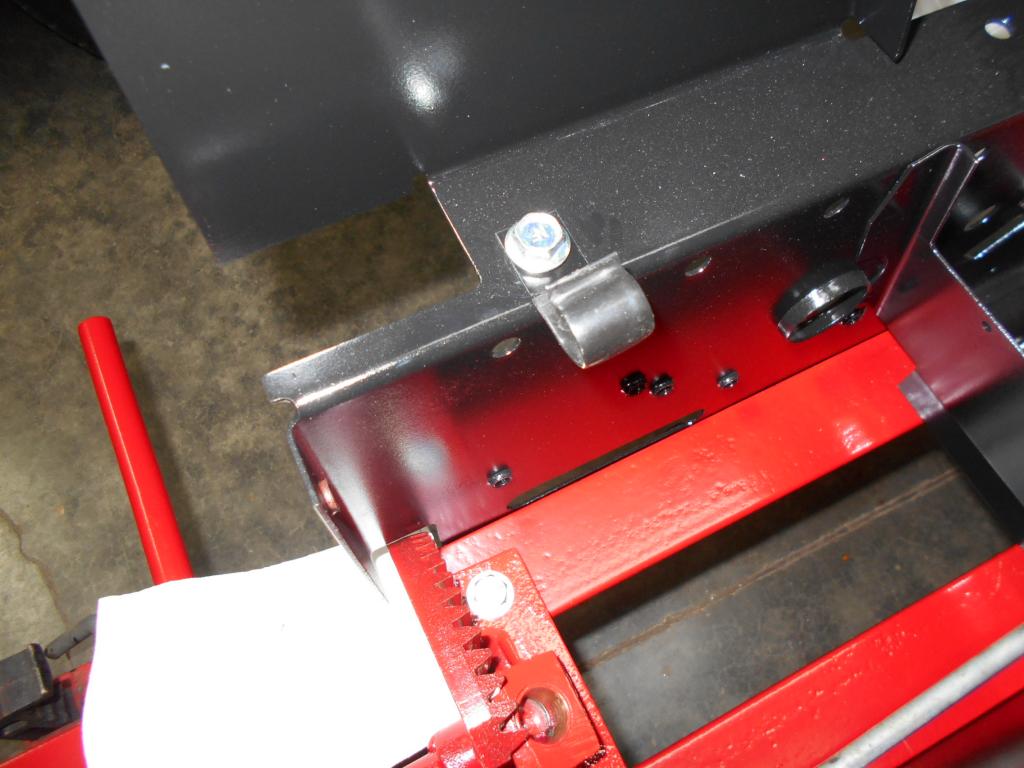

cleat 9,441 #147 Posted November 27, 2025 Wire clips ready to install onto hoodstand. Front wire clip installed on hoodstand. Rear wire clip installed on hoodstand. Both wire clips installed on hoodstand. 4 Share this post Link to post Share on other sites

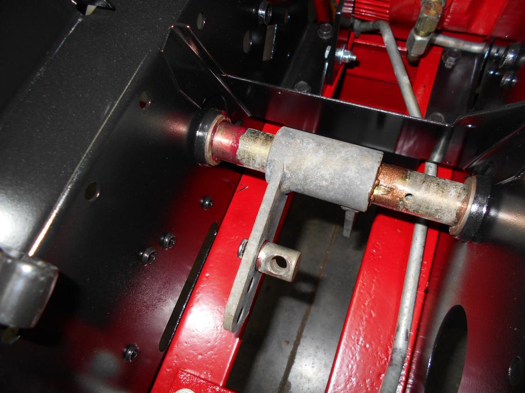

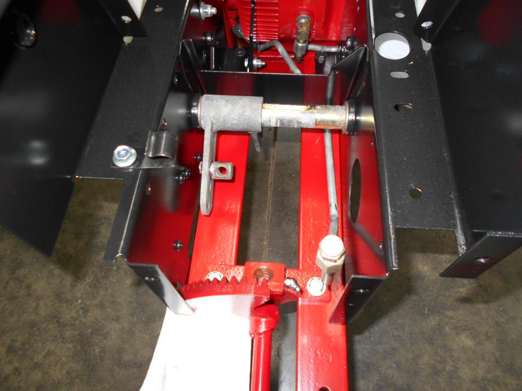

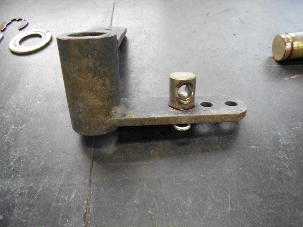

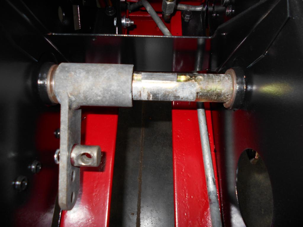

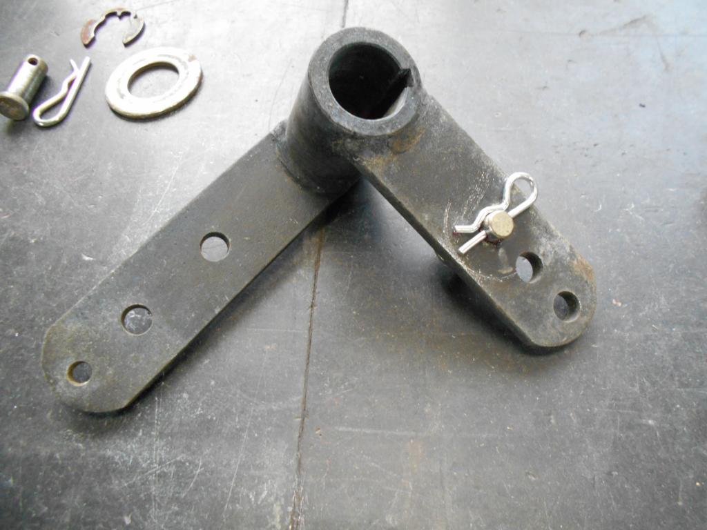

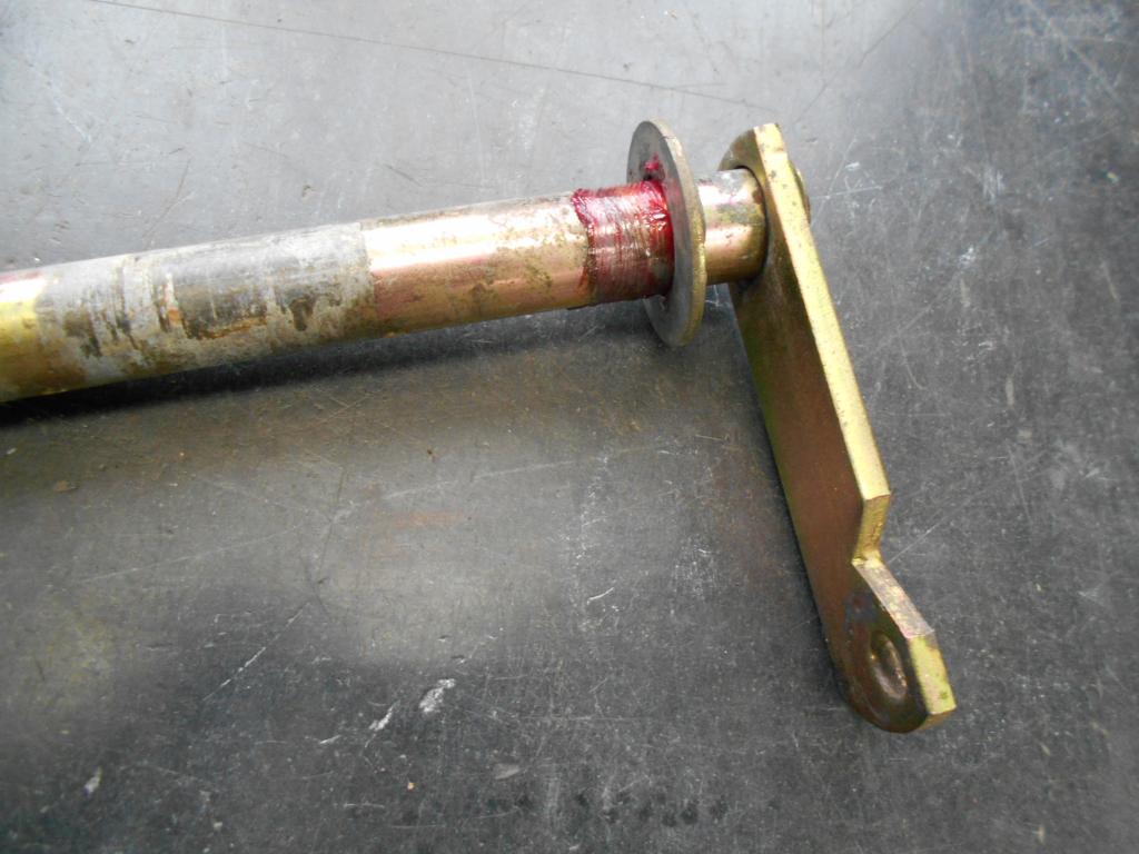

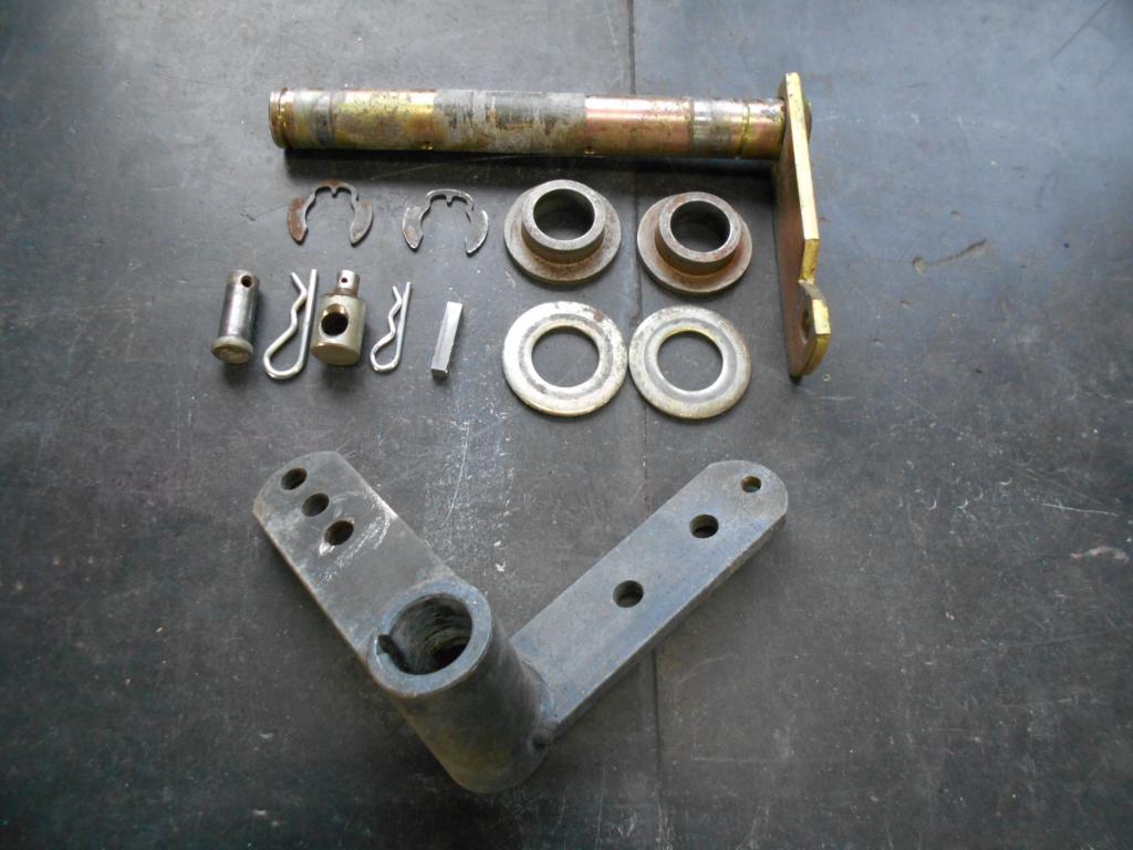

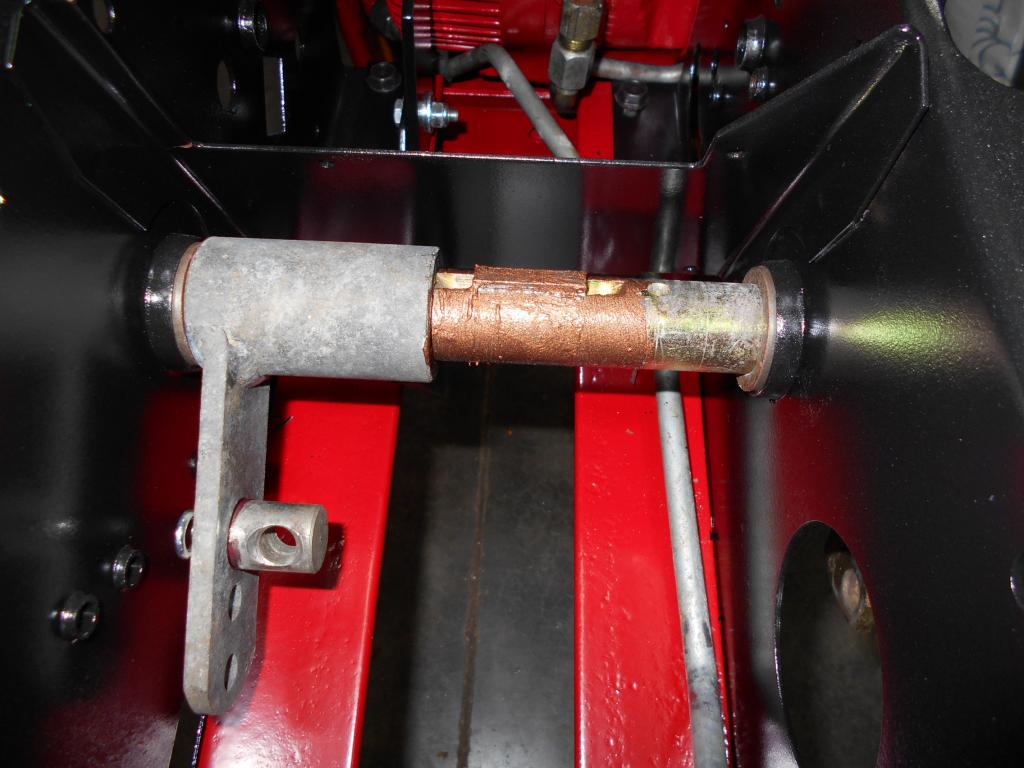

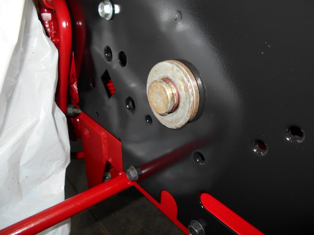

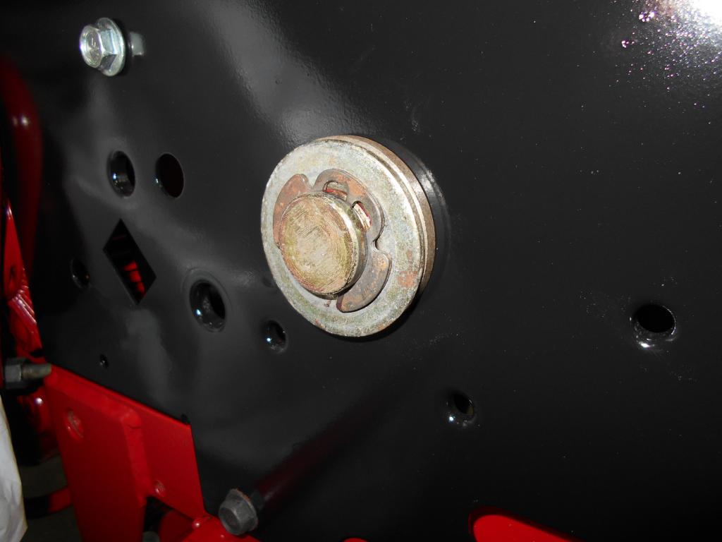

cleat 9,441 #149 Posted November 28, 2025 Lift lever and bellcrank assembly ready to be installed. Lift lever bushings installed into hoodstand. They needed to be lightly tapped into place as they are a tight fit. Make sure they are fully installed and sit flat. Trunnion greased where it will slide into the bellcrank. Trunnion slid into bellcrank and clip installed onto trunnion. Clip and washer slid onto left side of lift lever. Lift lever was greased where it will slide into left side bushing. Lift lever slid through left bushing and bellcrank. Lift lever slid part way through right side bushing. Key installed and firmly tapped into place onto lift lever. Lift lever coated in never seize where the bellcrank will sit (between the two holes in the lift lever). Bellcrank slid onto lift lever after aligning key to keyway cut into bellcrank. Lift lever greased where it will slide into right side bushing. Lift lever fully slid into place. Right side lift lever washer and clip installed. Bellcrank retaining clips ready to be installed. A little never seize was applied where the retaining clip will be installed into the lift lever. Left side retaining clip installed then the bellcrank slid over until it is tight to the clip. At this point the right side clip was inserted. I then cleaned up and extra grease and never seize for a cleaner look and called this job complete. 4 1 Share this post Link to post Share on other sites

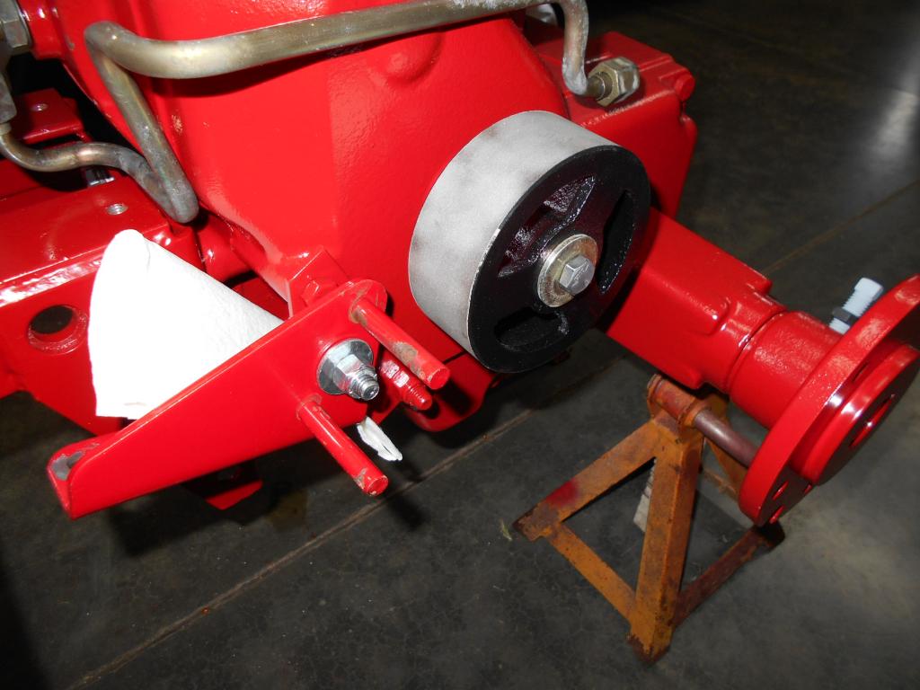

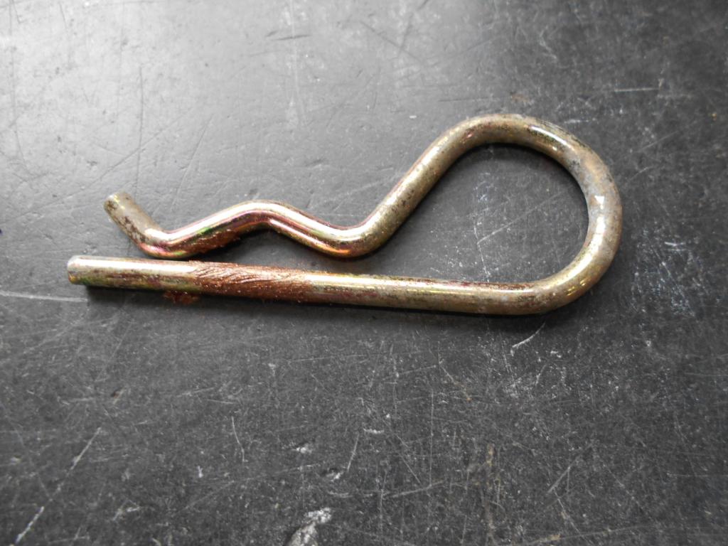

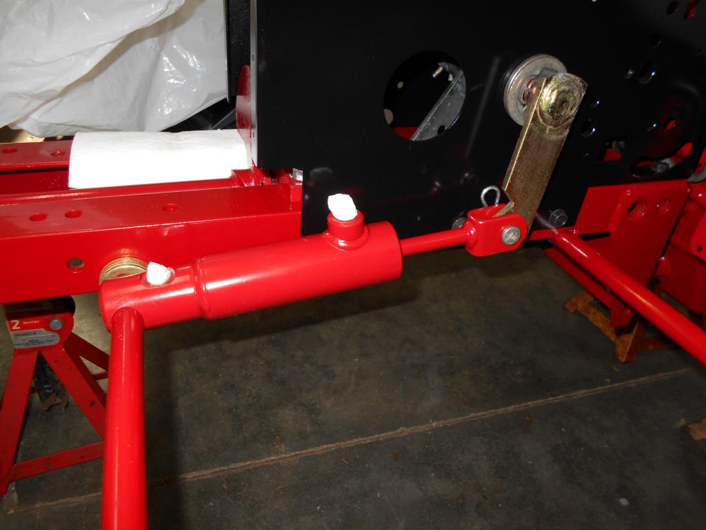

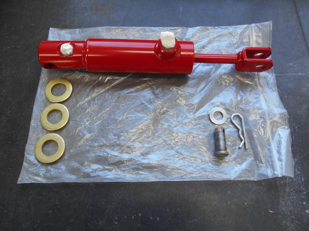

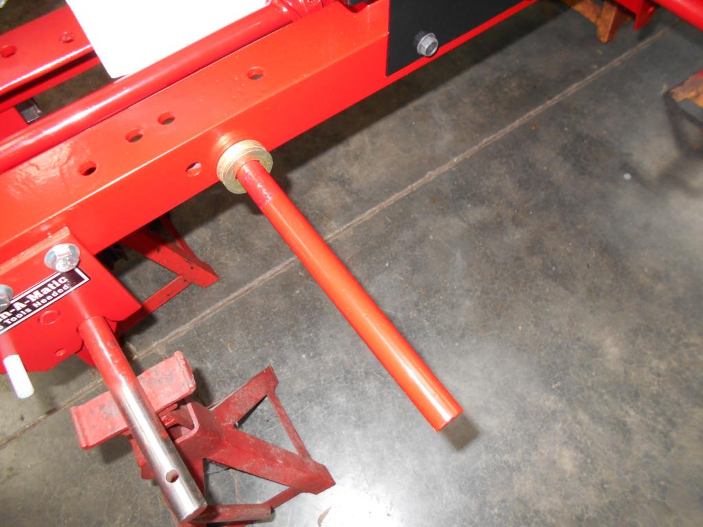

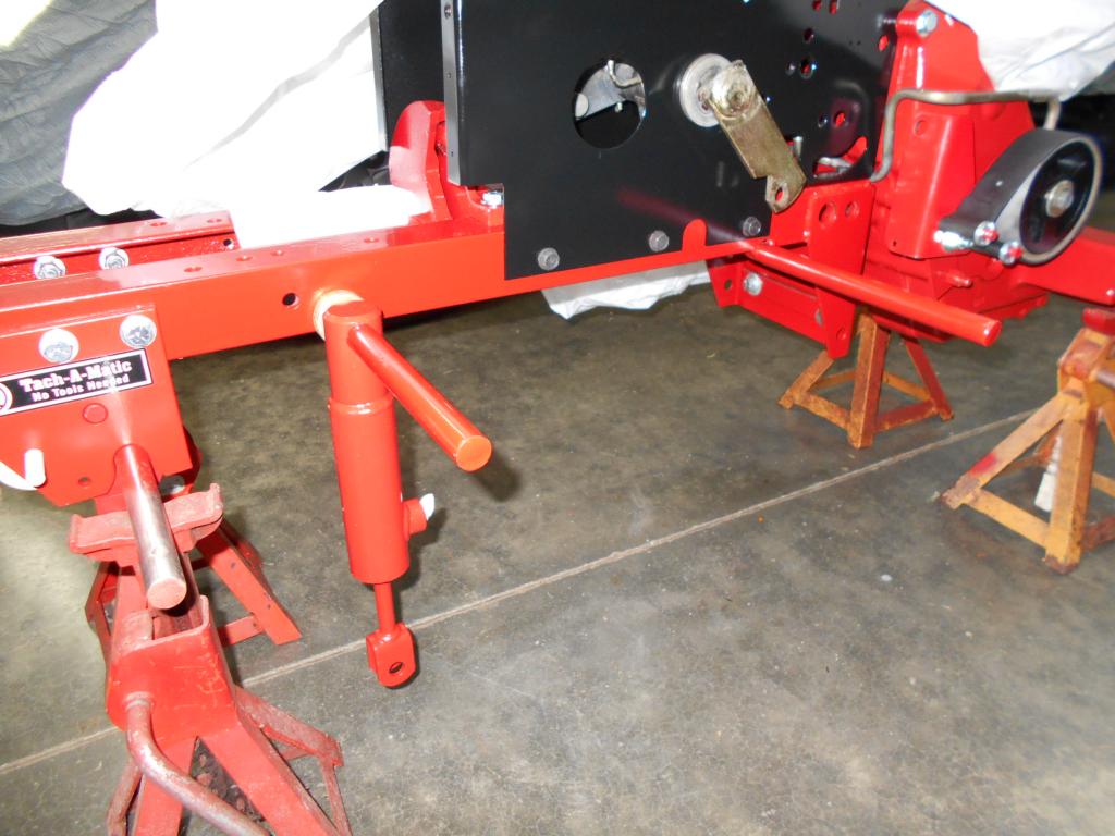

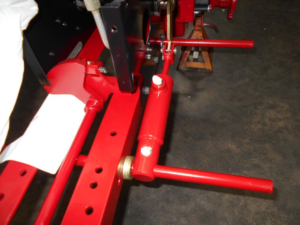

cleat 9,441 #150 Posted November 29, 2025 Hydraulic cylinder ready to be installed. This frame was missing the spacer so I am just stacking 3 thick washers instead. Tractor ready and waiting for the hydraulic cylinder. Spacer washers slid on and the shaft is greased where the cylinder will sit. Hydraulic cylinder slid onto shaft. Hydraulic cylinder pin greased and ready to be installed. Hydraulic cylinder pin installed. Overview as of today. 3 4 Share this post Link to post Share on other sites
