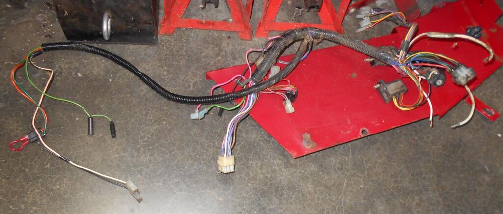

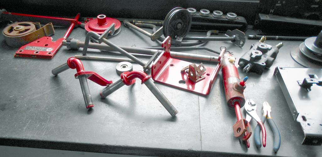

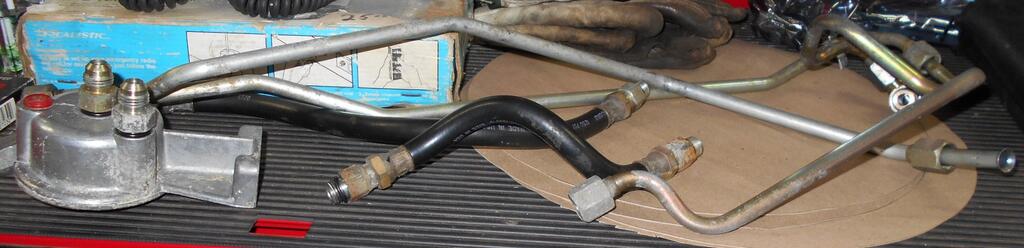

cleat 9,441 #27 Posted August 23, 2025 Tractor lost some more parts. Some of the parts cleaned and sitting on the bench. Hydraulic tubes and hoses cleaned up. Front wheels cleaned up. The other side unfortunately does not look as good. Wire harness as pulled. I got a few little parts bead blasted. 6 Share this post Link to post Share on other sites

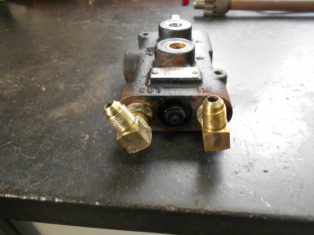

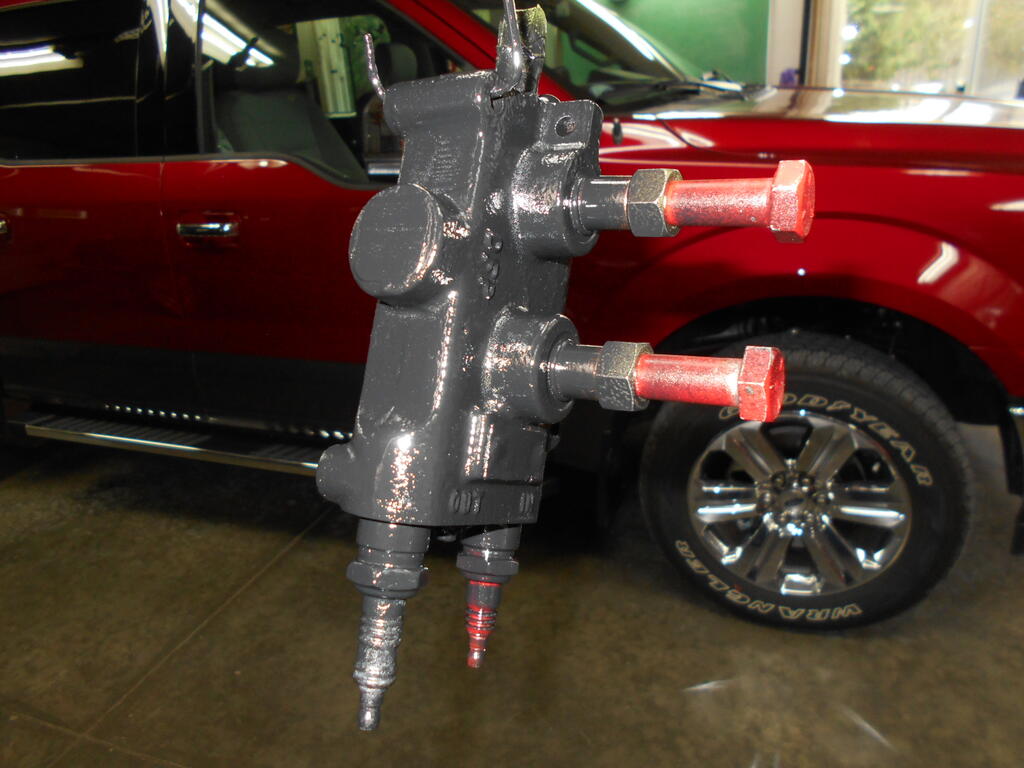

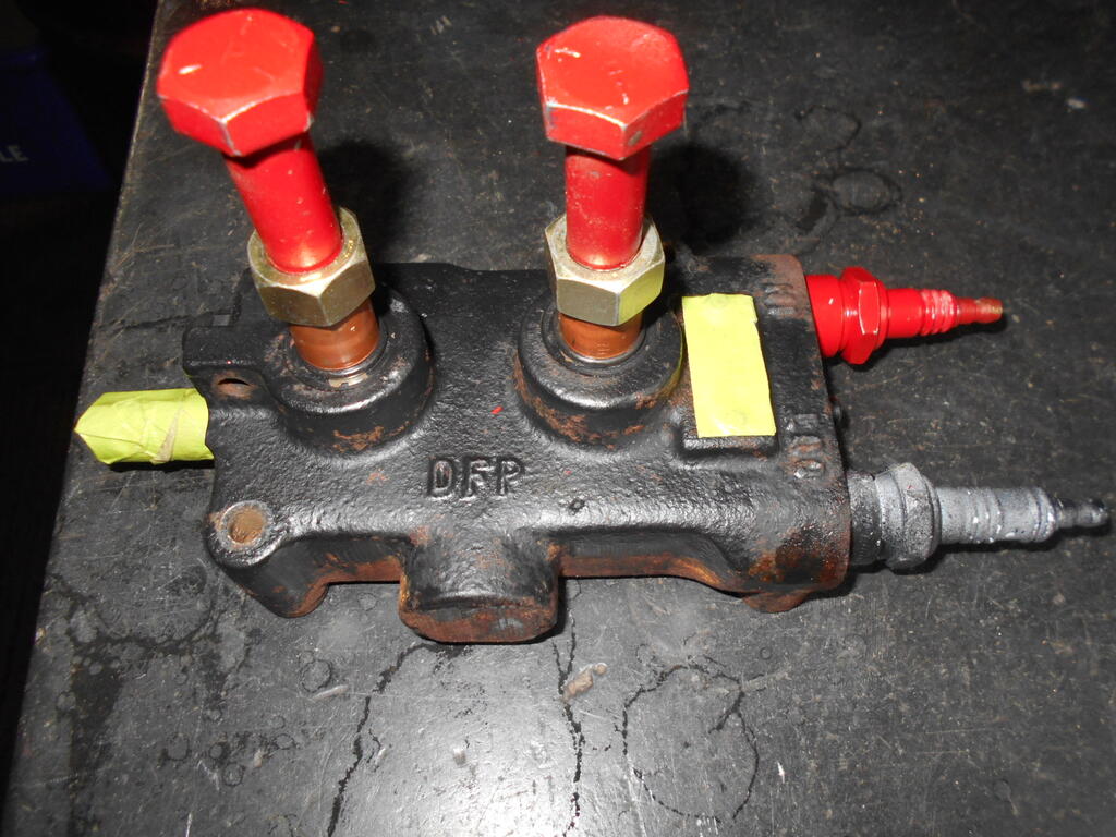

cleat 9,441 #28 Posted August 24, 2025 Hydraulic valve cleaned up. Here are the fittings as found showing correct angles. Valve has new Viton #111 O rings installed and all port openings are sealed off. Valve will be painted soon. 5 Share this post Link to post Share on other sites

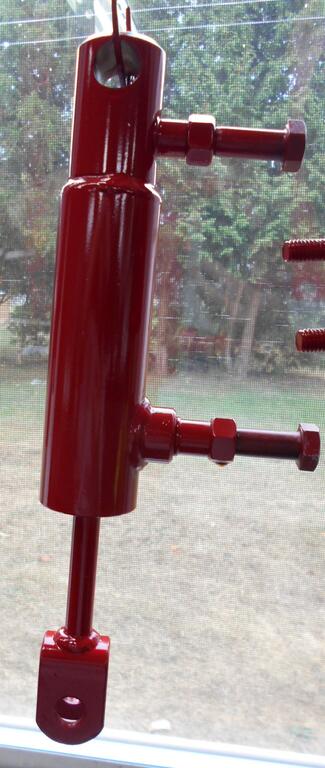

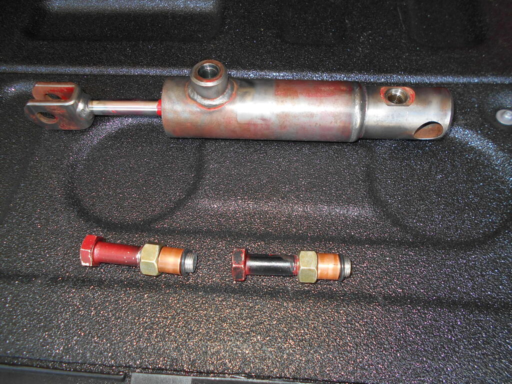

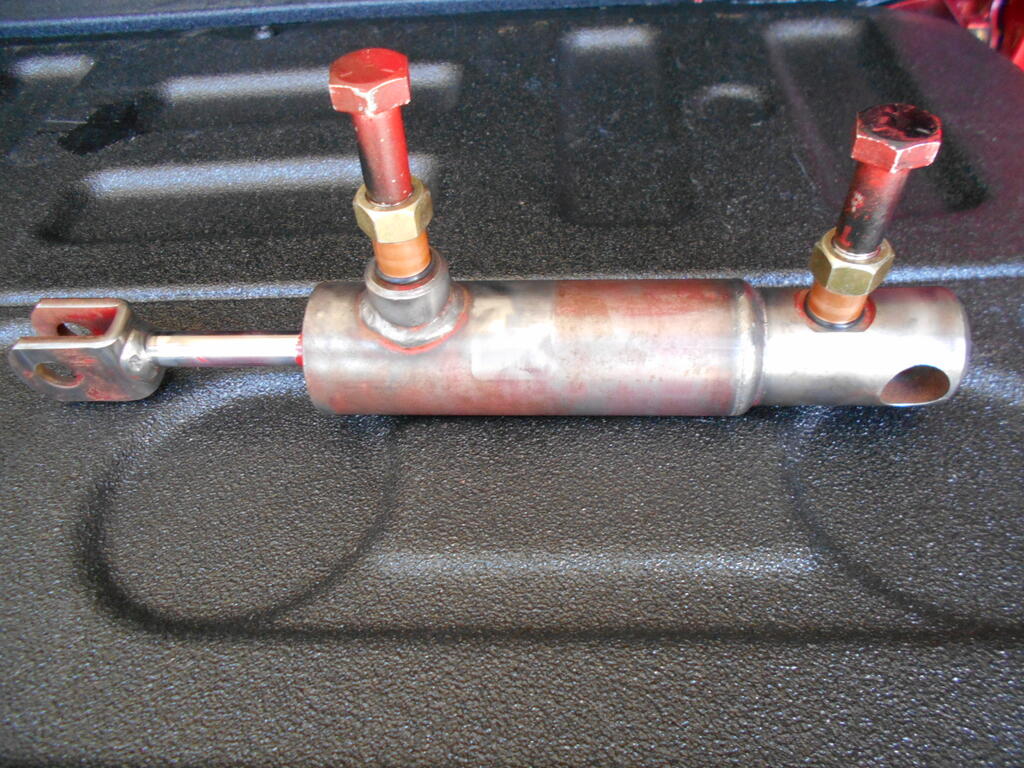

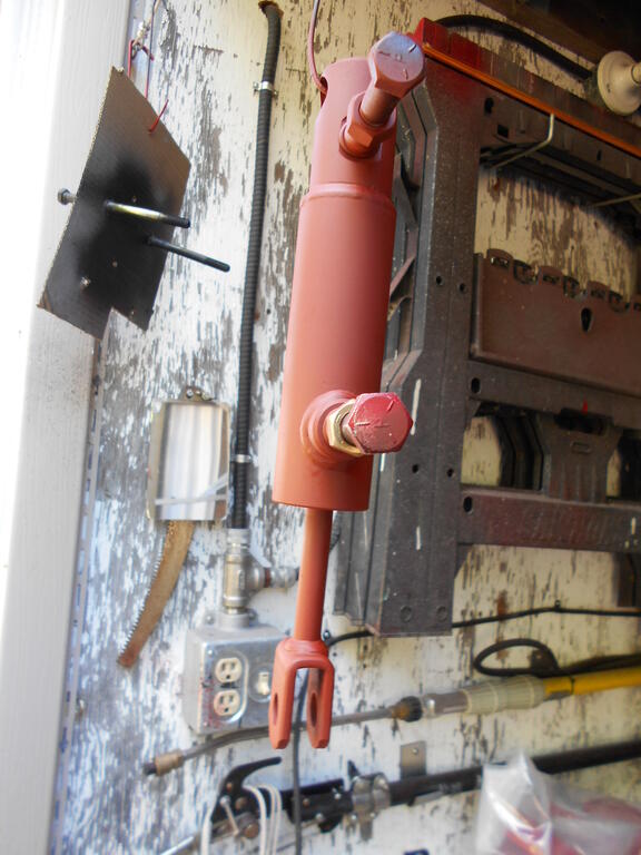

cleat 9,441 #29 Posted August 25, 2025 Hydraulic cylinder cleaned and sanded. You can see the bolts, nuts, spacers, and O rings used to plug the ports (same setup used on the valve). Cylinder primed. Hydro cam plate bracket bead blasted and primed. Tie rods with ball tightened a bit using a hydraulic press then bead blasted and primed. 5 Share this post Link to post Share on other sites

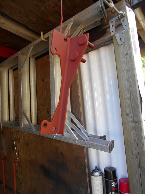

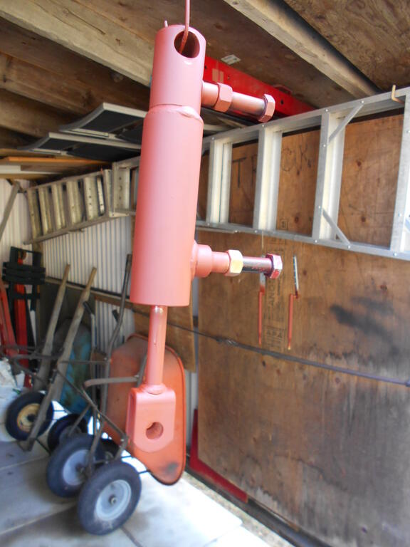

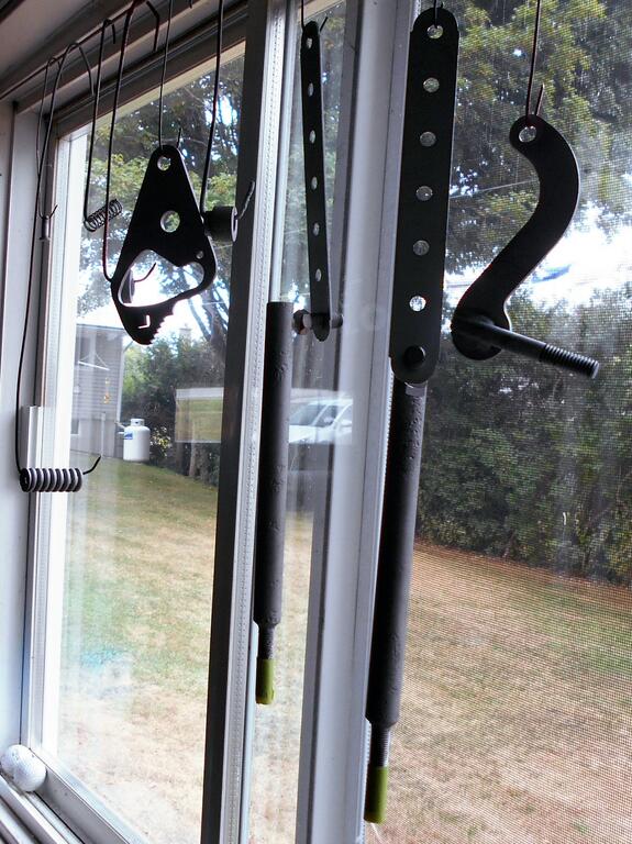

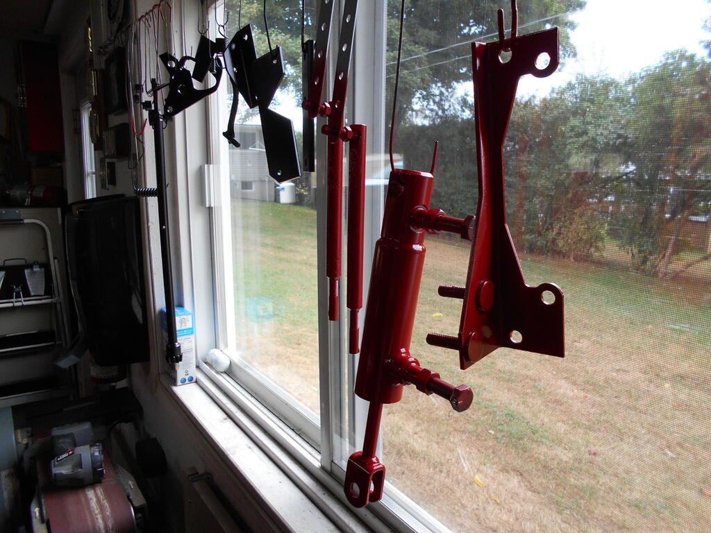

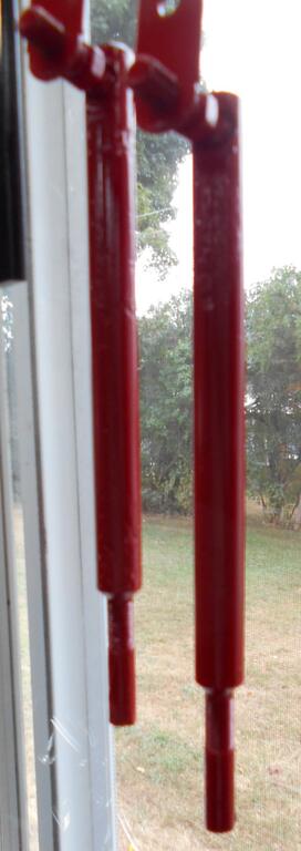

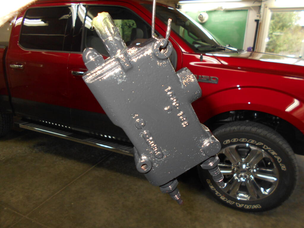

cleat 9,441 #32 Posted August 26, 2025 Some painted parts drying in the window. Cylinder painted Tie rods painted. Cam plate bracket painted. Valve painted. 6 2 Share this post Link to post Share on other sites

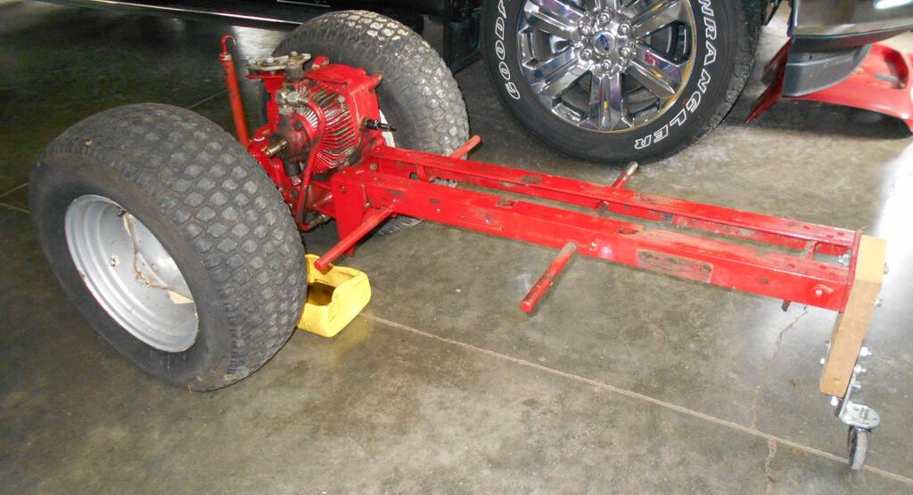

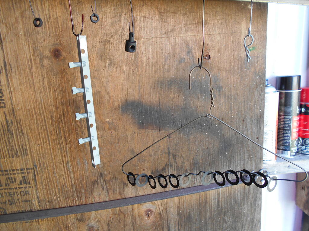

cleat 9,441 #41 Posted August 29, 2025 Dughter is moved into her college residence. This is all that is left of my poor tractor now. A bunch of little parts have been painted, bagged and boxed. Hub set screws and jamb nuts, PTO rod trunnion and clip, steering shim washers bead blasted and painted. PTO rod and hoop bead blasted and one coat of paint applied. 7 Share this post Link to post Share on other sites

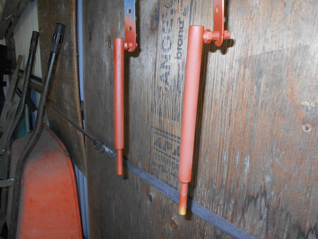

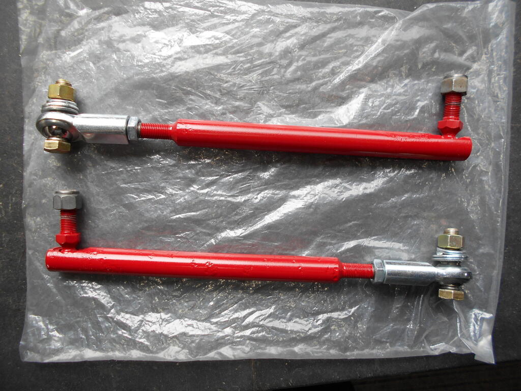

cleat 9,441 #42 Posted August 30, 2025 Not much happening right now. It's cloudy and spitting rain. There is a car show just up the road and I am hoping to take a car up to display. I did get the tie rods ready. I know I may need longer bolts but otherwise ready to be bolted on. 8 Share this post Link to post Share on other sites

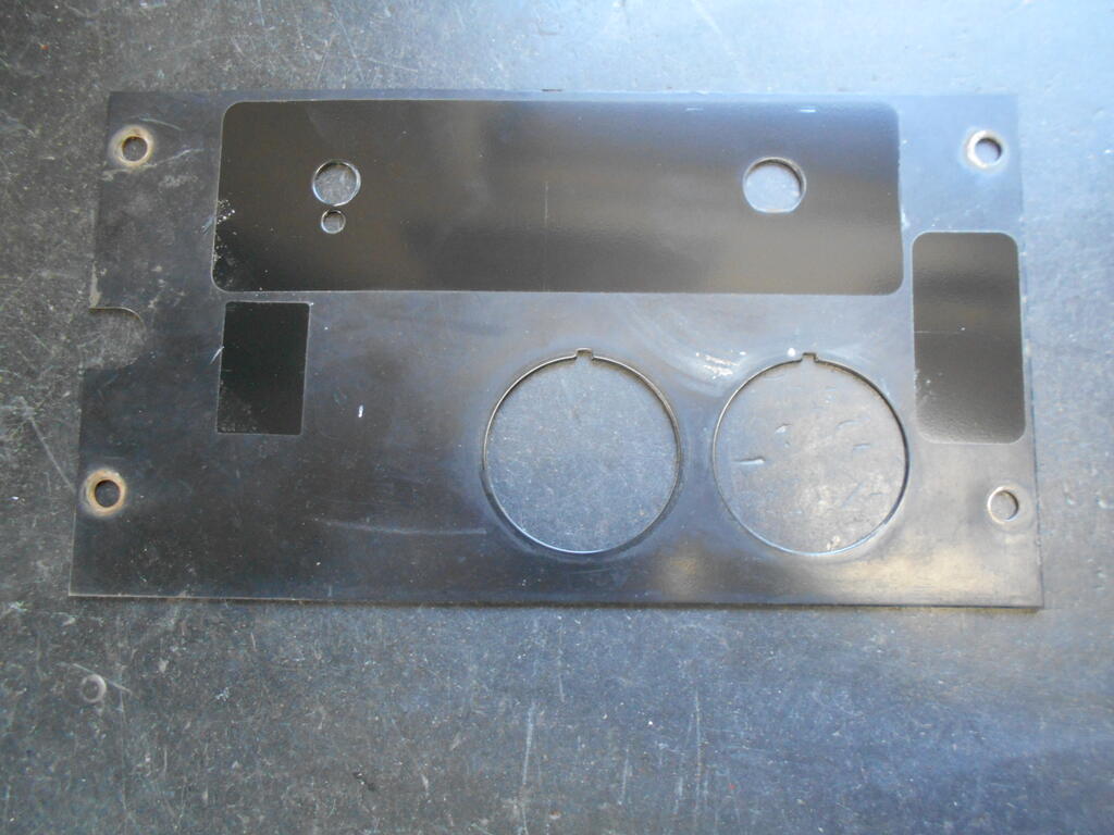

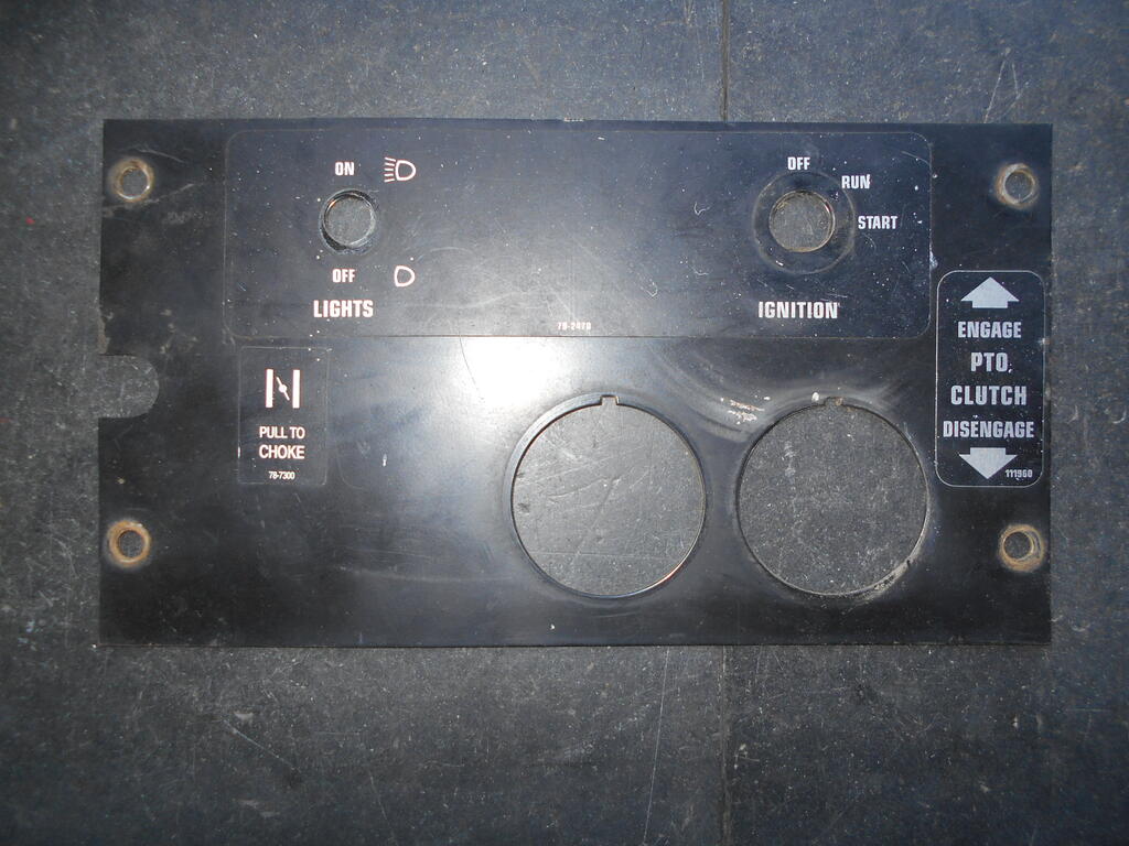

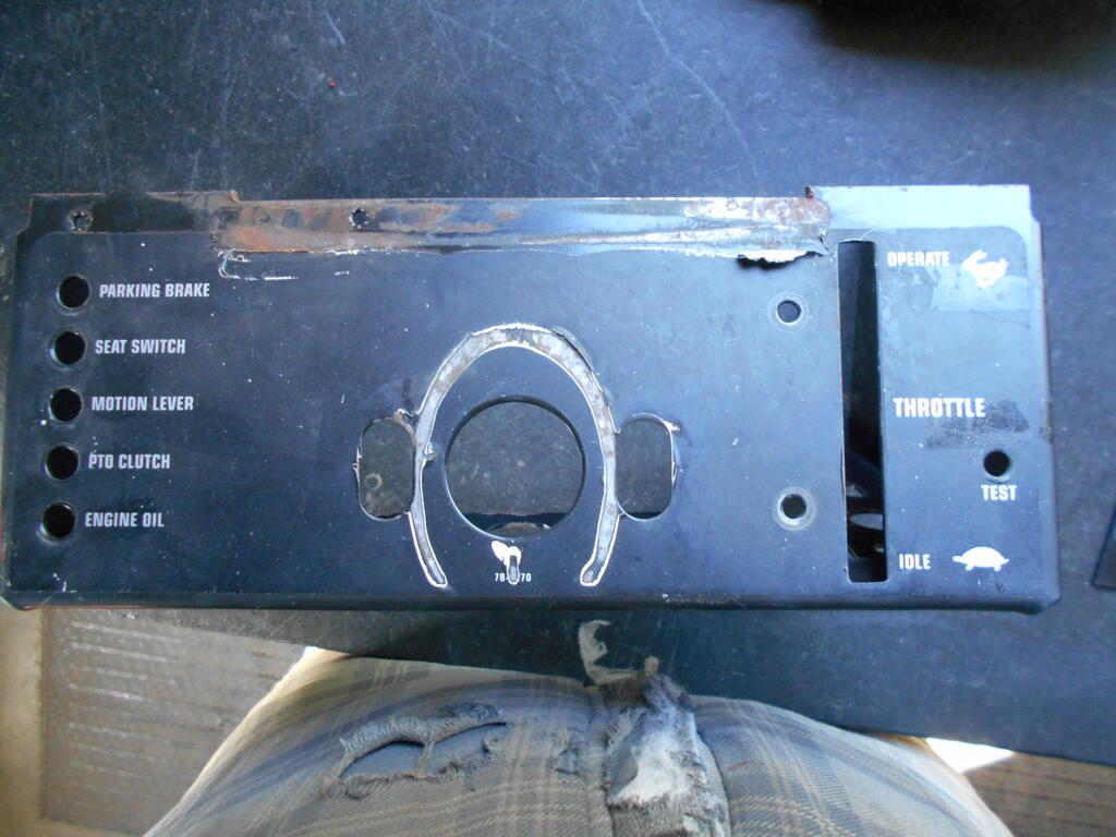

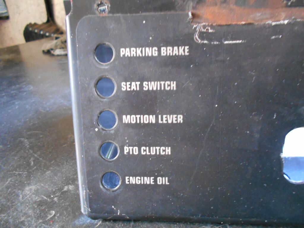

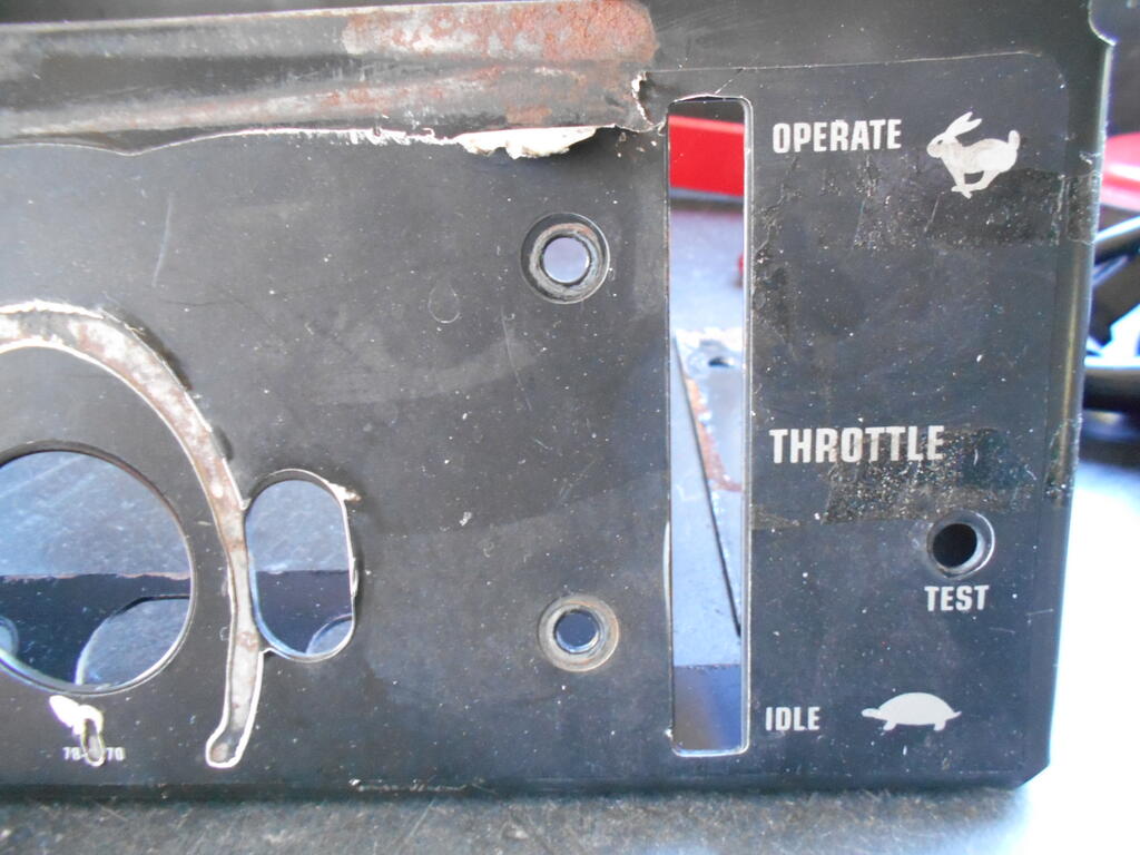

cleat 9,441 #43 Posted August 31, 2025 Console decal as found. Console decal removed. Hood stand plate decals as found. Hood stand plate decals removed. Foot rest spare that I had left over from the GT1600 rebuild as found. Foot rest grip pad removed. 4 Share this post Link to post Share on other sites

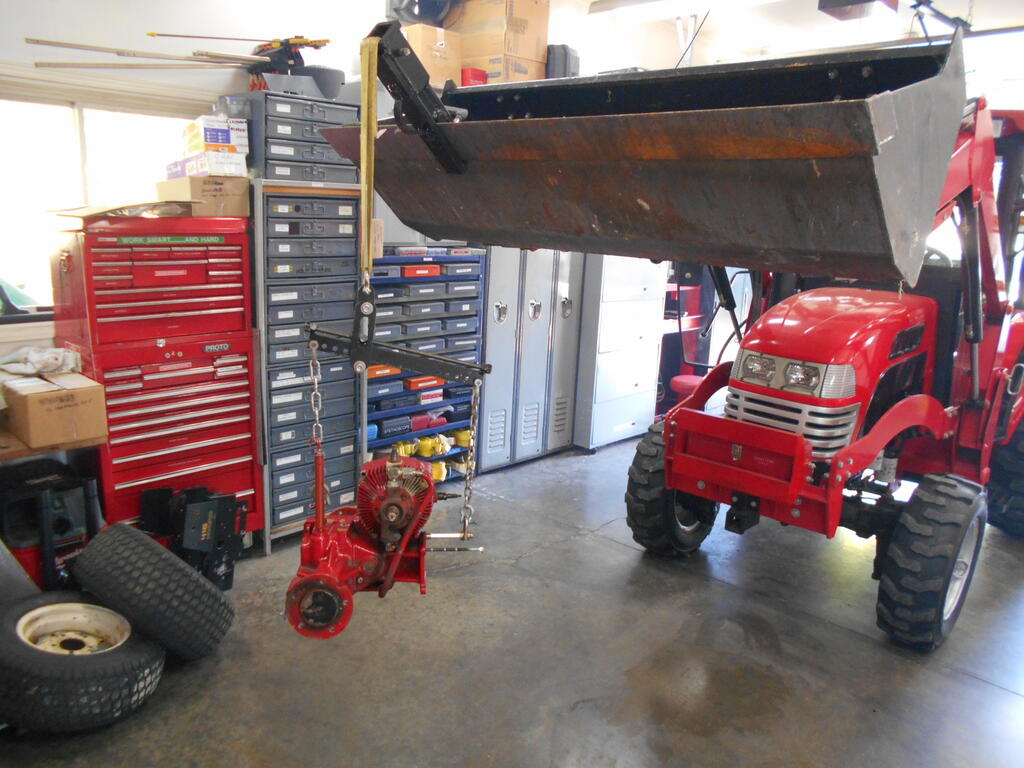

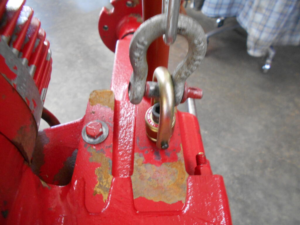

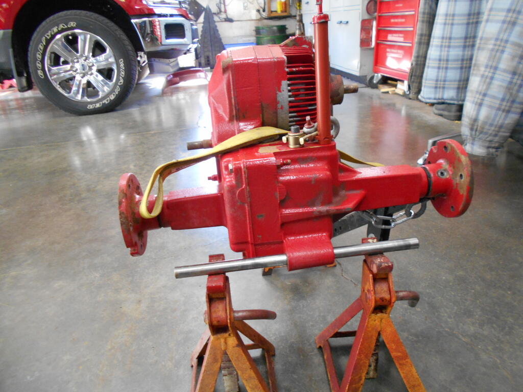

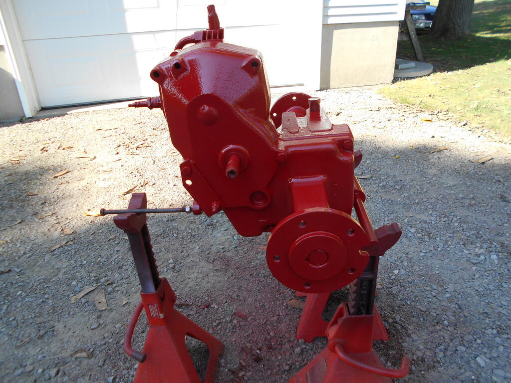

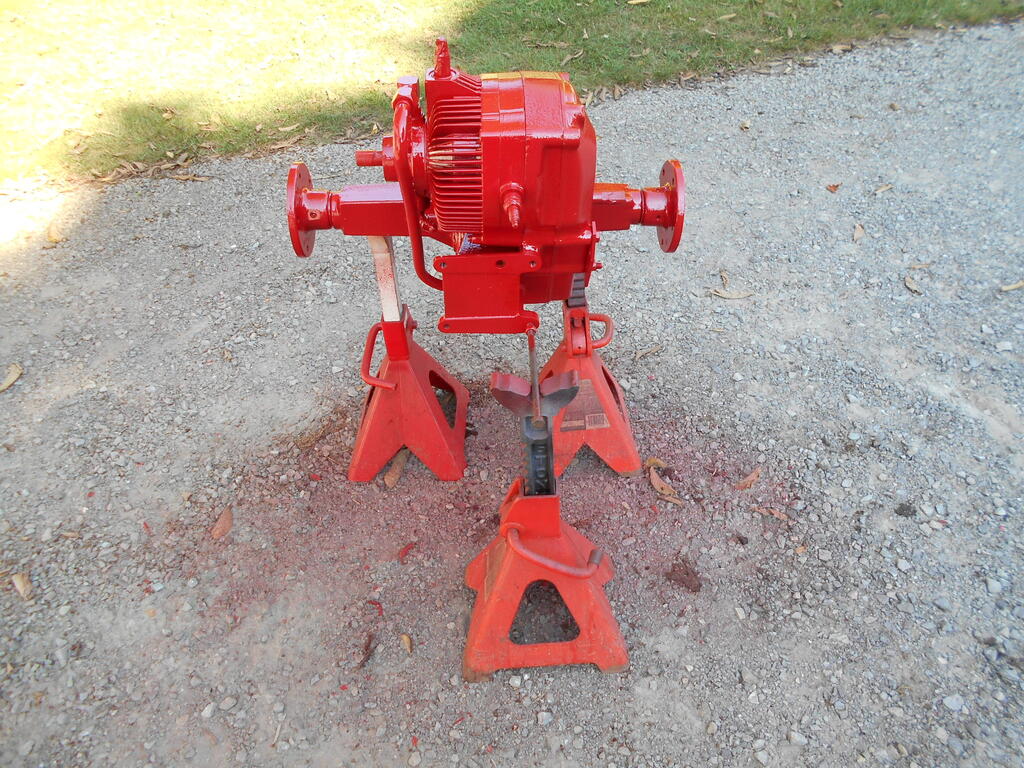

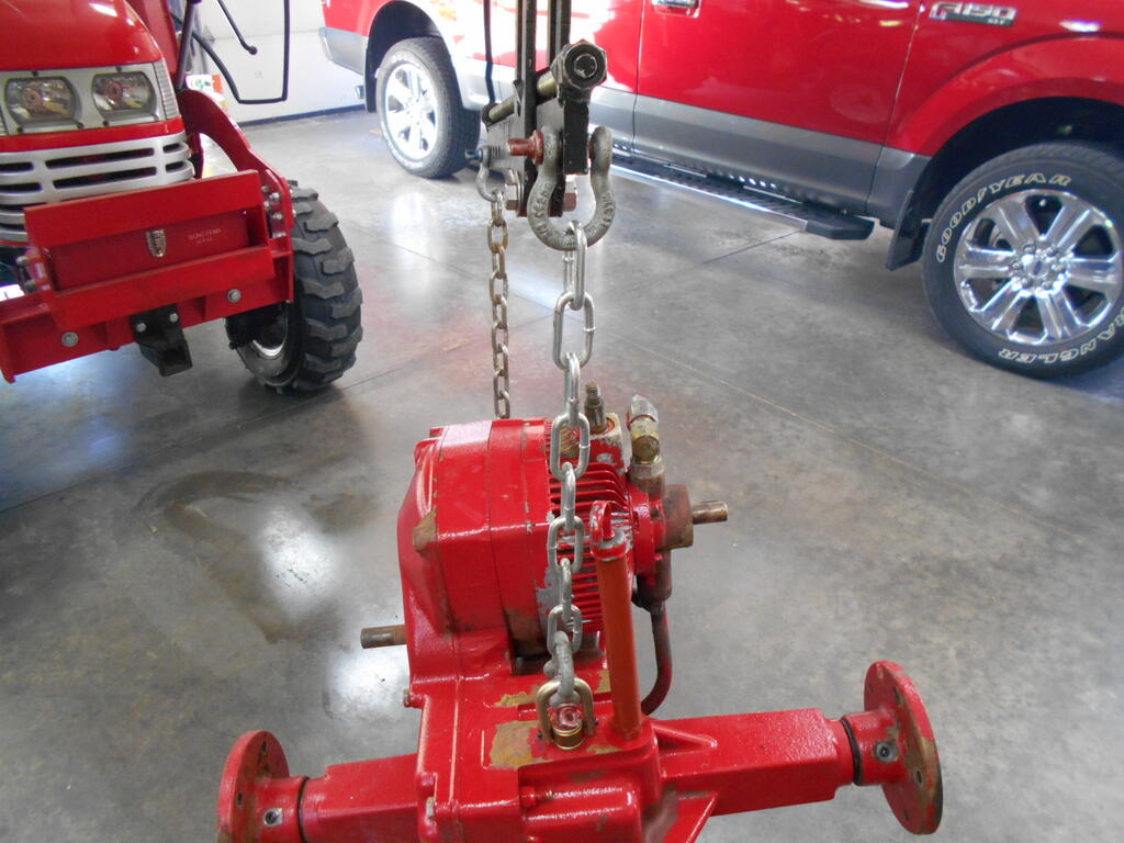

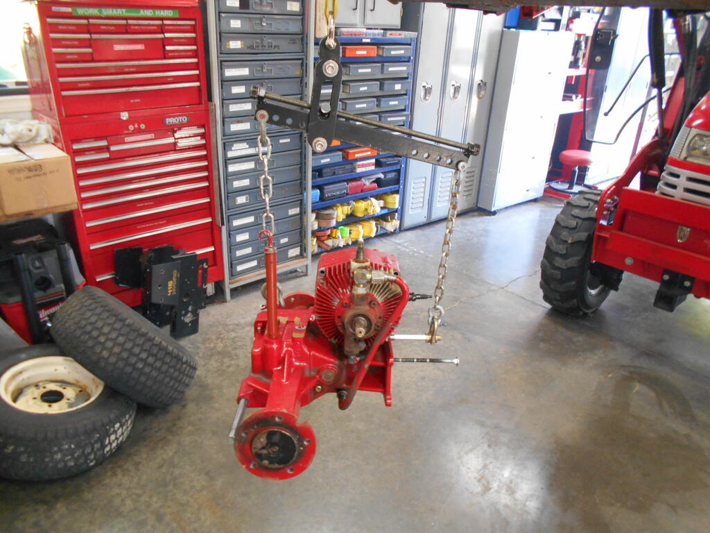

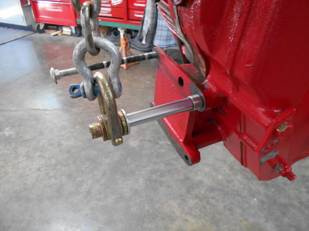

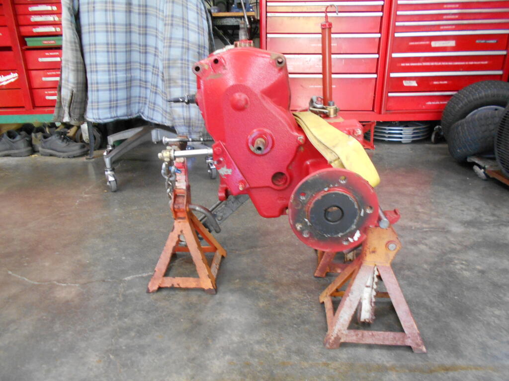

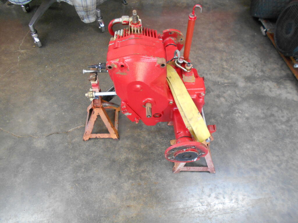

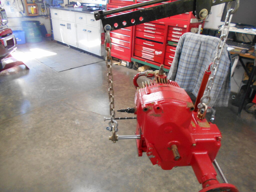

cleat 9,441 #44 Posted August 31, 2025 Hydro lifted up using swivel 3/8" eyebolts, clevises, chains, slings, and an engine leveler. Hydro sat on three jack stands using a 3/4" bar through the rear hitch mount and a long 3/8" bolt threaded into a mounting boss. Hydro will be moved outside likely tomorrow or the next day for final cleanup and paint. 3 1 Share this post Link to post Share on other sites

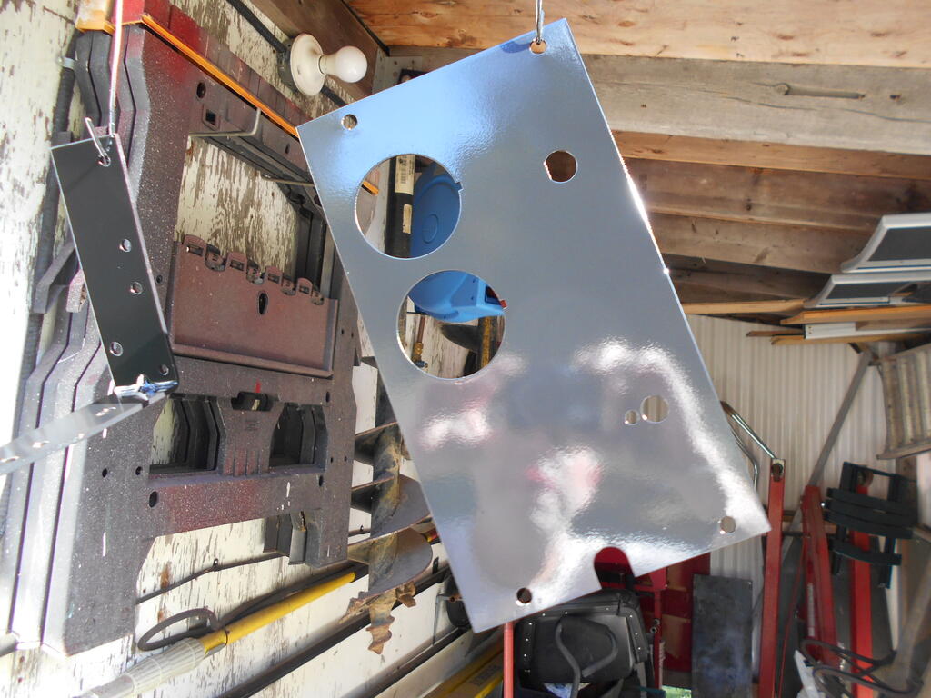

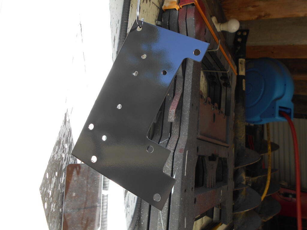

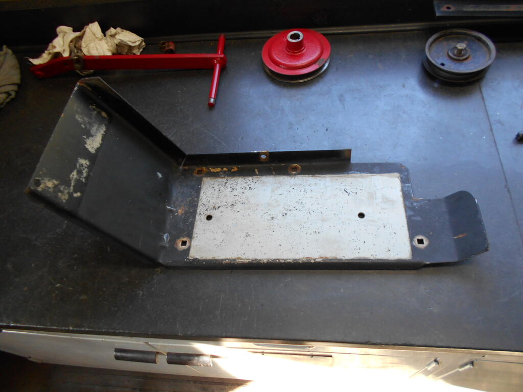

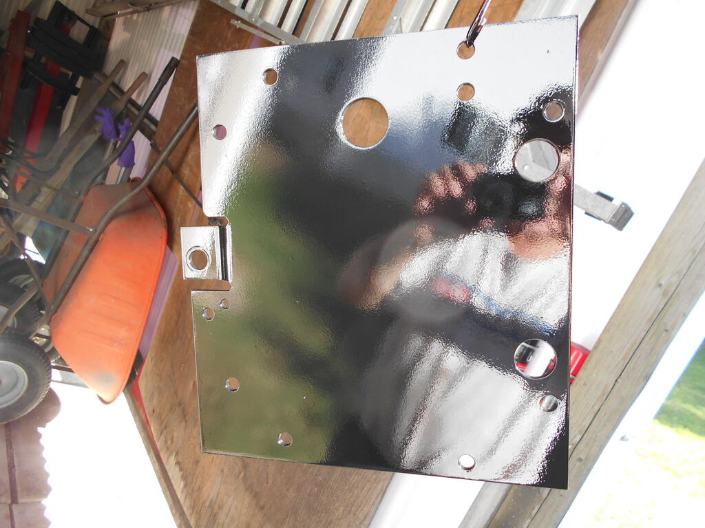

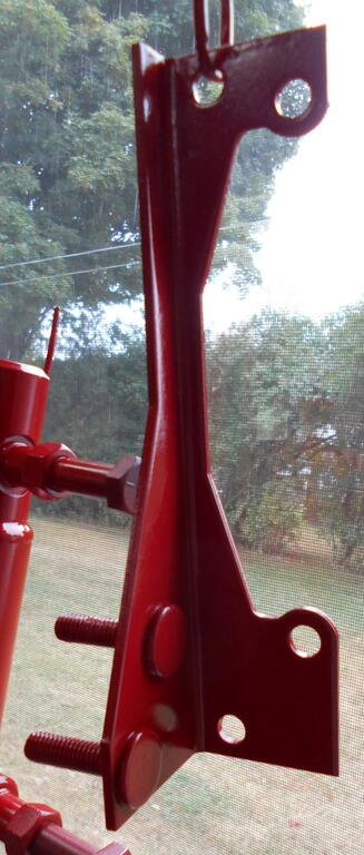

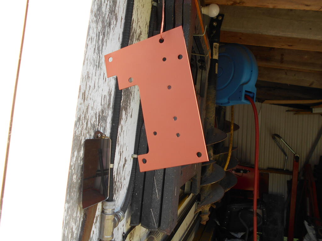

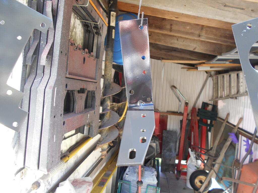

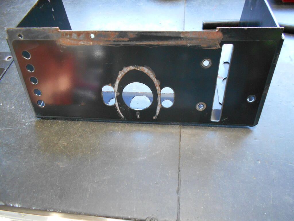

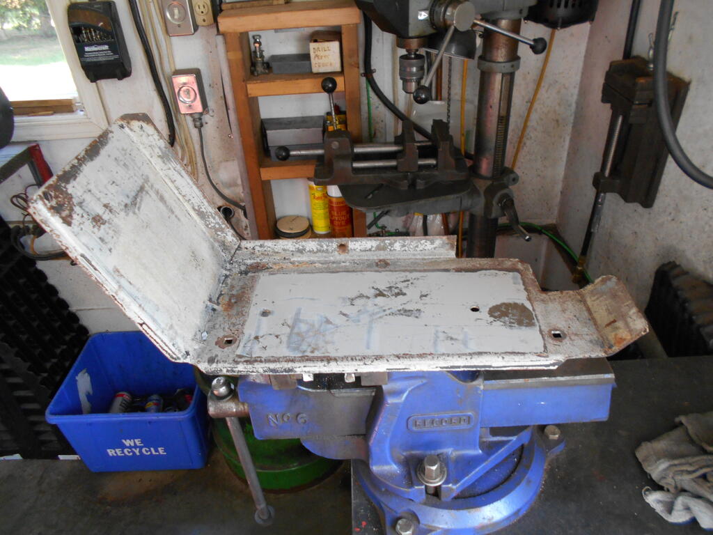

cleat 9,441 #45 Posted August 31, 2025 Belt guard bracket sanded and primed. Engine plate sanded and primed. Front plate sanded and primed. Hood stand plate sanded and primed. Foot rest chemically stripped and washed. 4 Share this post Link to post Share on other sites

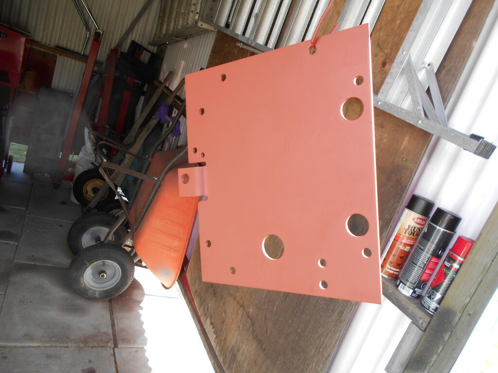

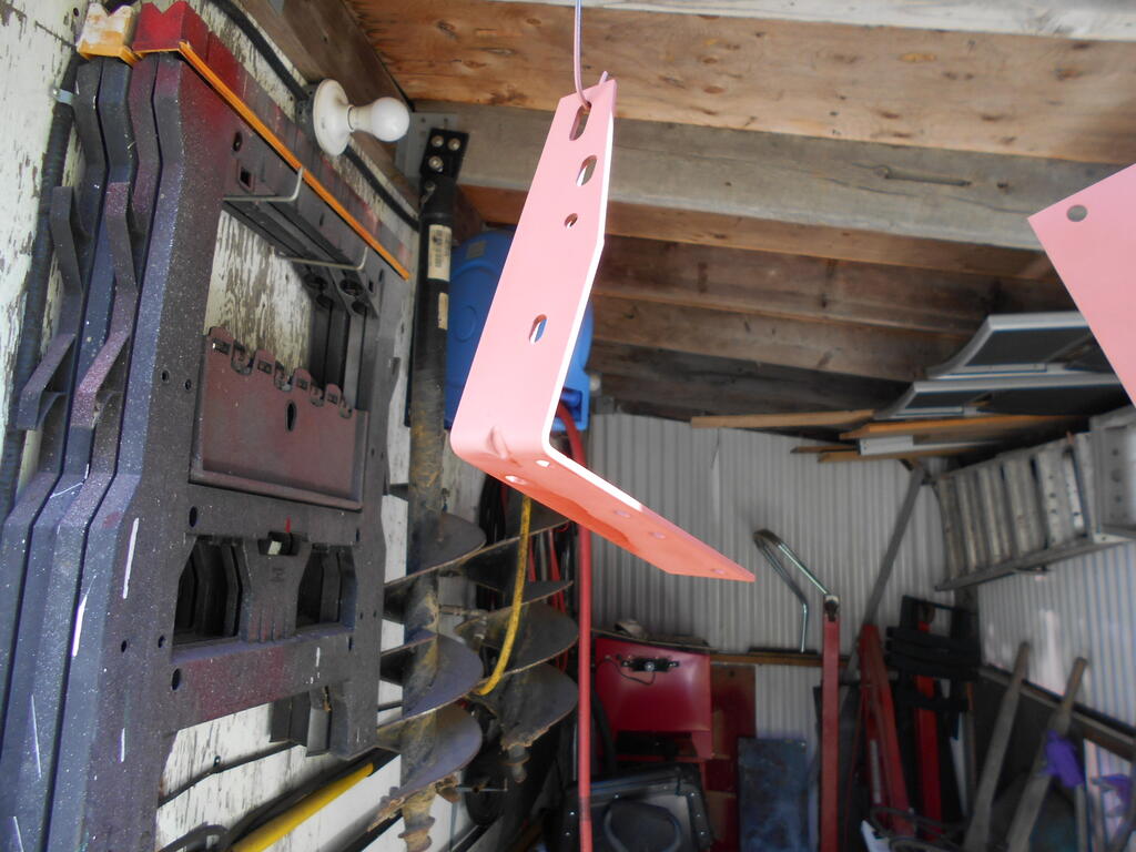

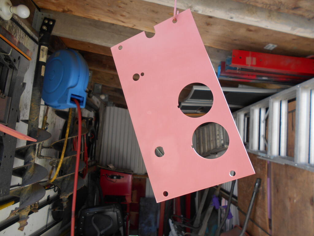

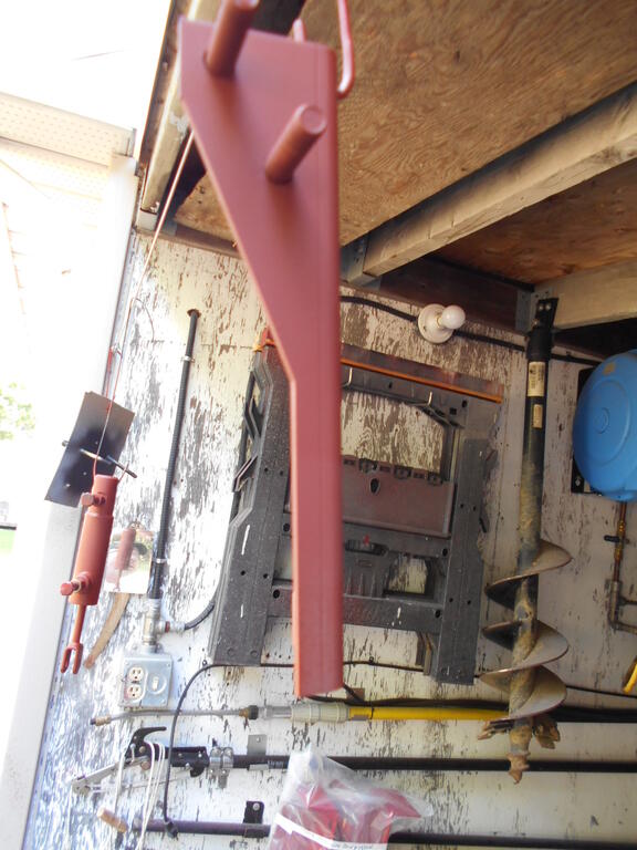

cleat 9,441 #46 Posted August 31, 2025 Belt guard bracket painted. Engine plate painted. Front plate painted. Hood stand plate painted. 4 Share this post Link to post Share on other sites

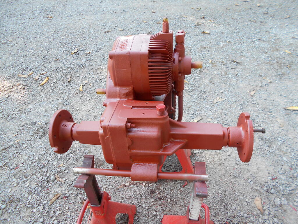

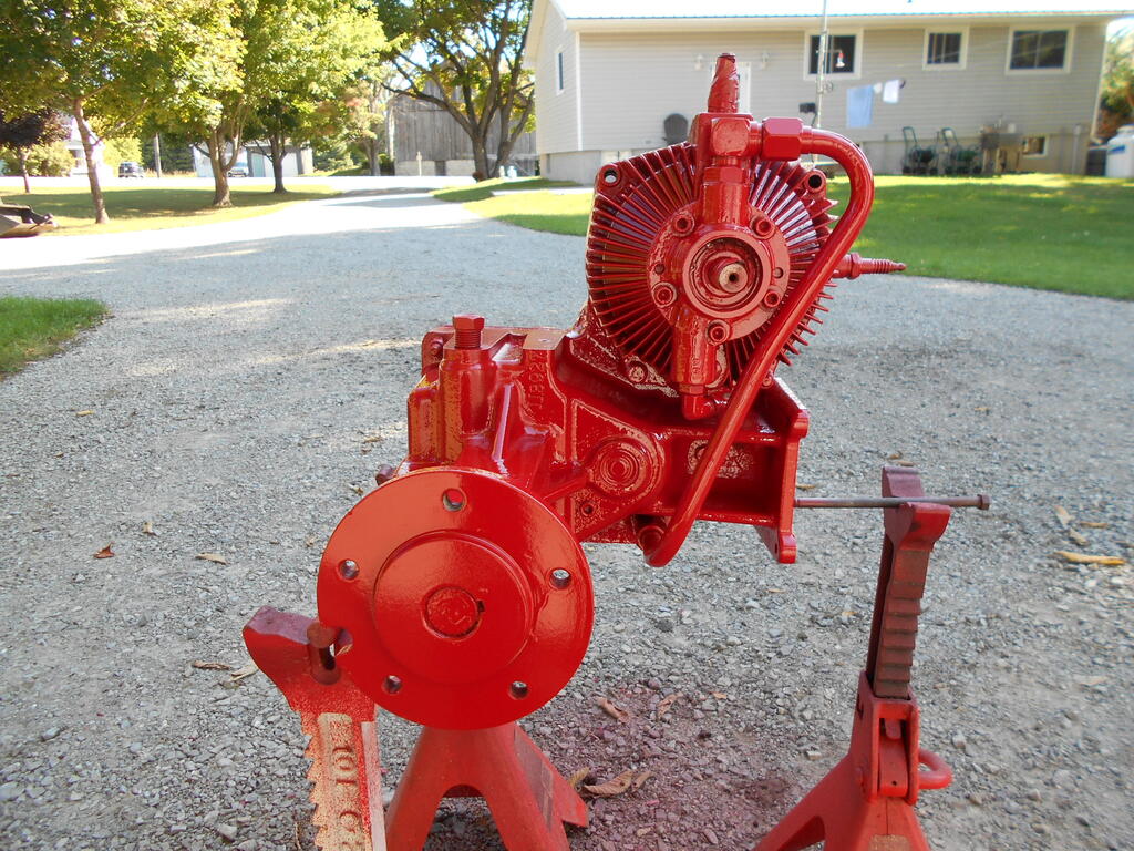

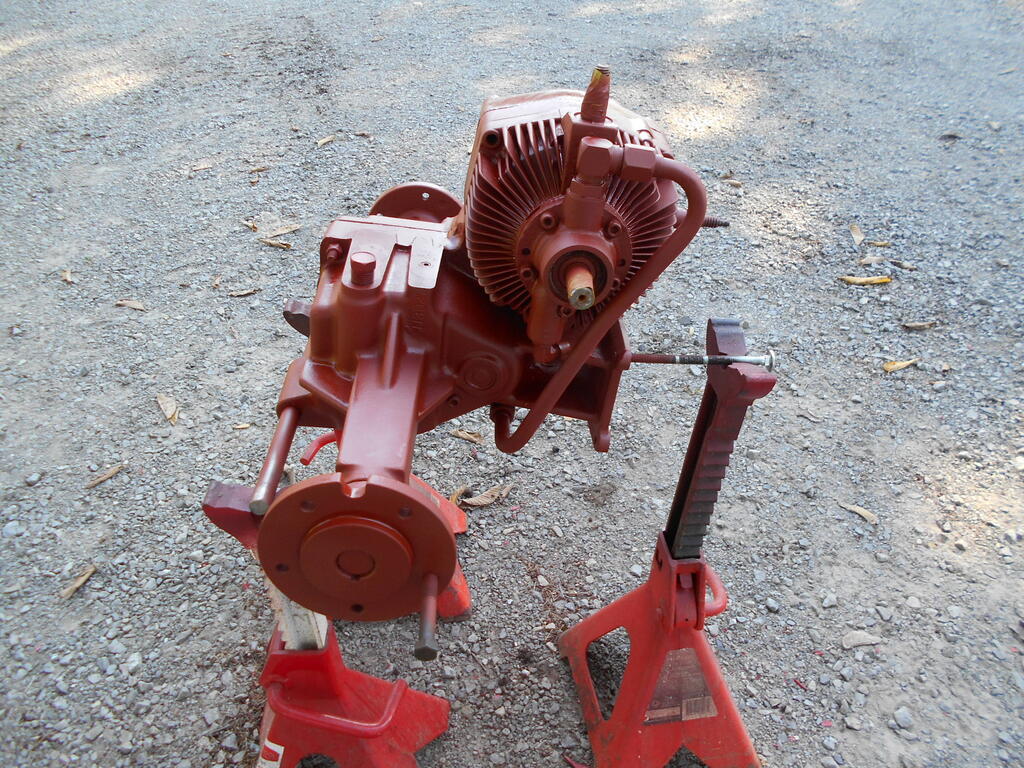

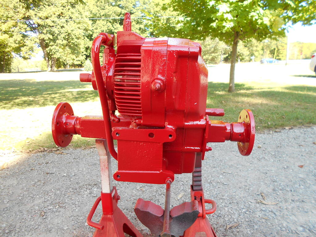

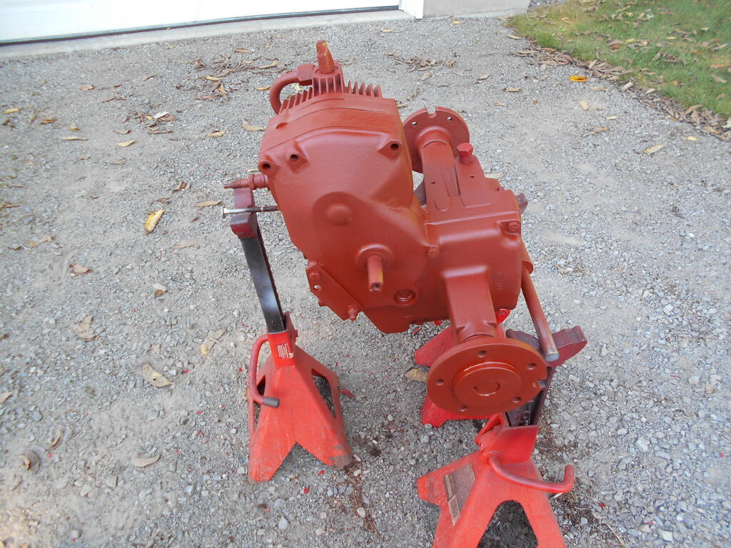

cleat 9,441 #47 Posted September 1, 2025 Hydro wire brushed, sanded, and final degreasing done. Primer applied (it is still wet, that is why it looks shiny). 7 Share this post Link to post Share on other sites

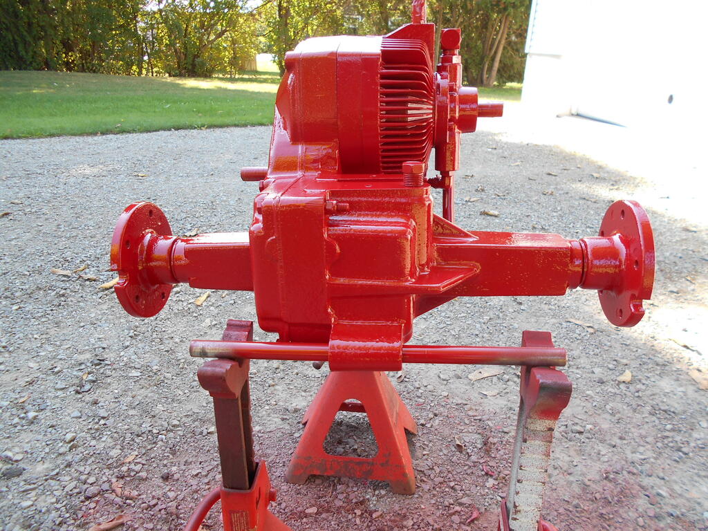

cleat 9,441 #48 Posted September 1, 2025 Hydro rear end now has two coats if IH red. 2 3 Share this post Link to post Share on other sites

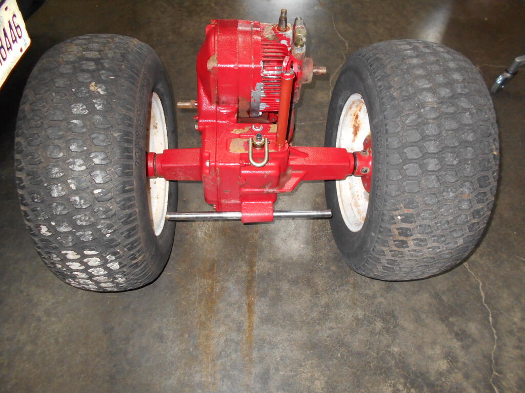

ebinmaine 81,273 #49 Posted September 1, 2025 Wheels seals are ok? Other transmission gaskets or seals getting done? Share this post Link to post Share on other sites
cleat 9,441 #50 Posted September 1, 2025 There were no leaks so I left the seals as is. If one leaks later on i will replace it then. 1 1 Share this post Link to post Share on other sites
