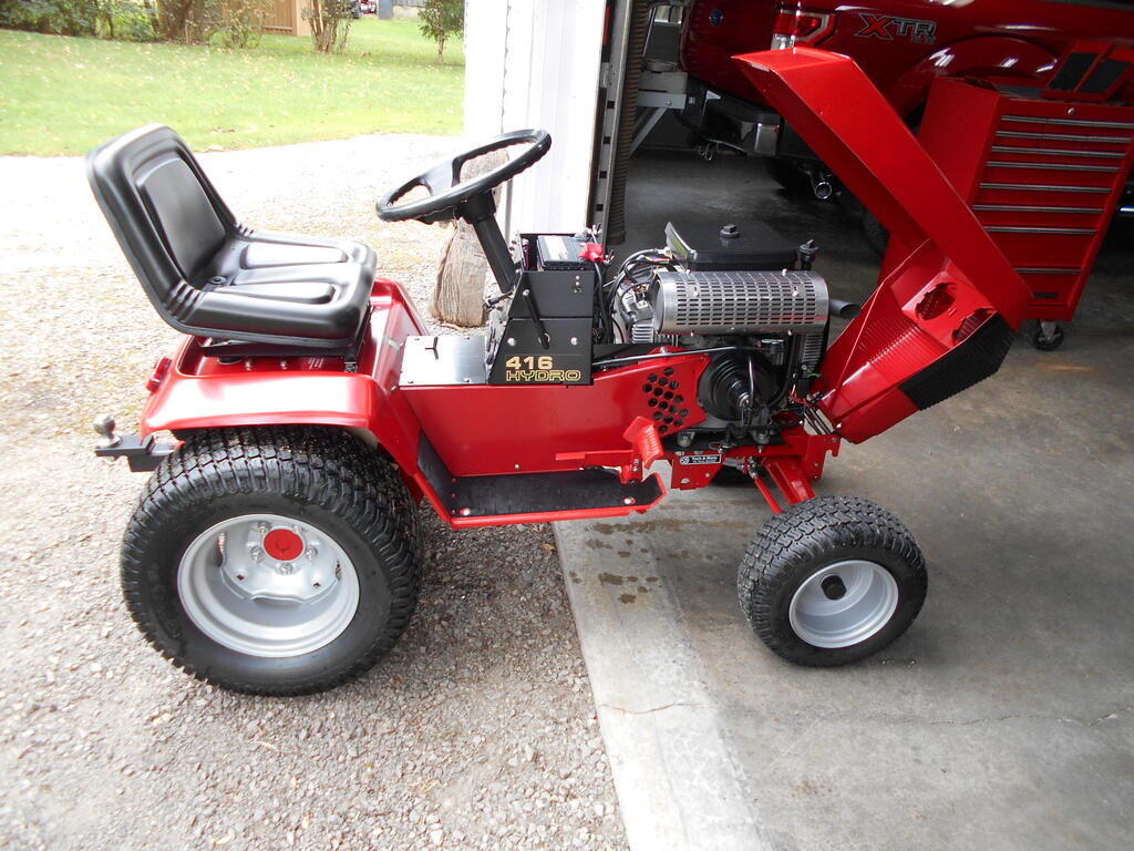

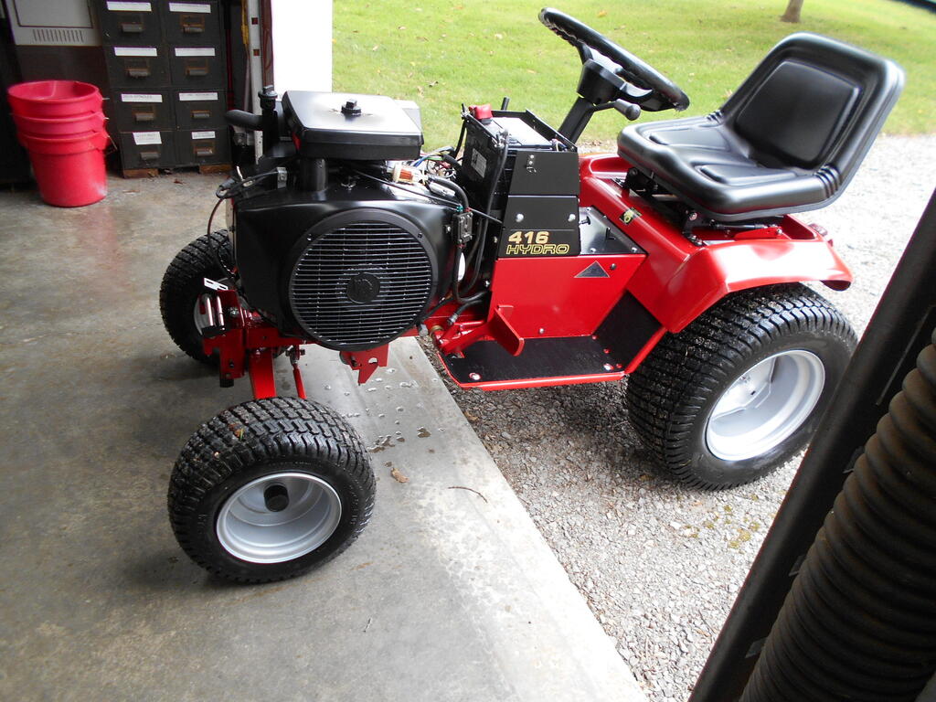

sqrlgtr 3,171 #351 Posted March 2 On 2/6/2026 at 10:11 AM, cleat said: 416 Anniversary complete except for final setup of carb and hydro, and hood which will be completed next summer. Wife took this picture. She laughed at me taking my shoes off to sit on the tractor. She's not the only one 1 Share this post Link to post Share on other sites

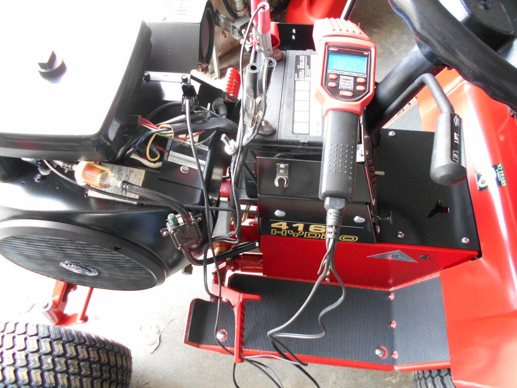

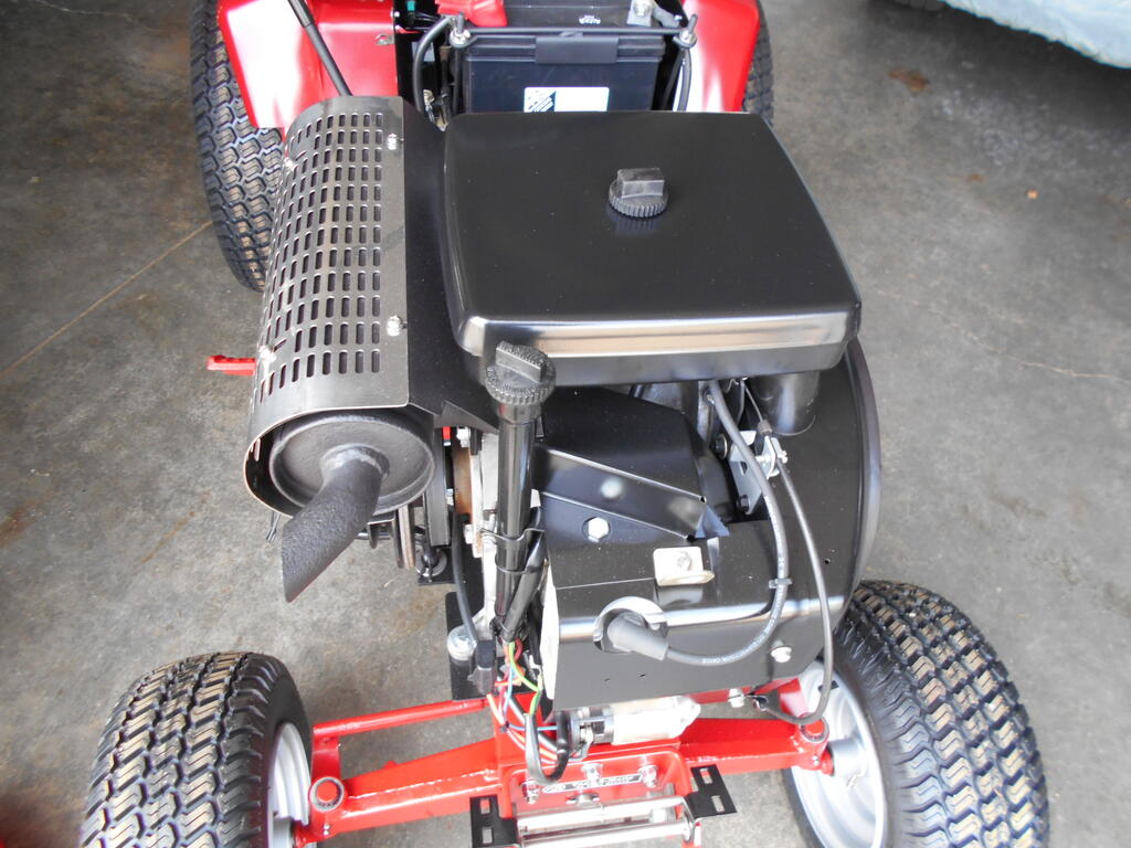

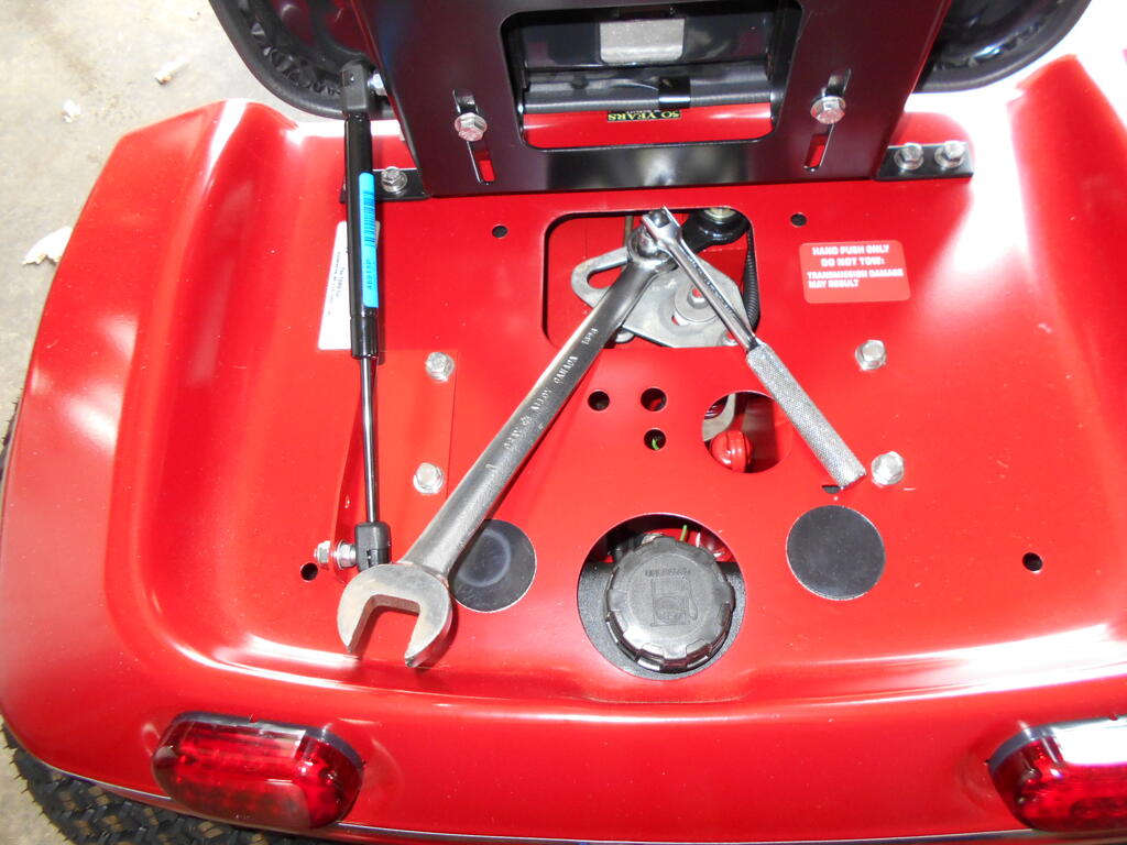

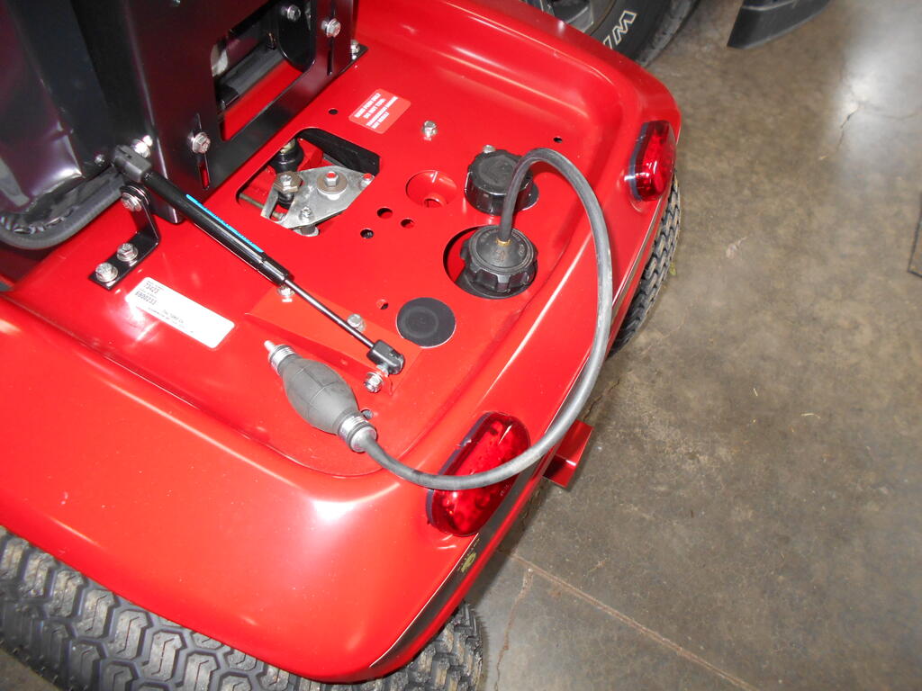

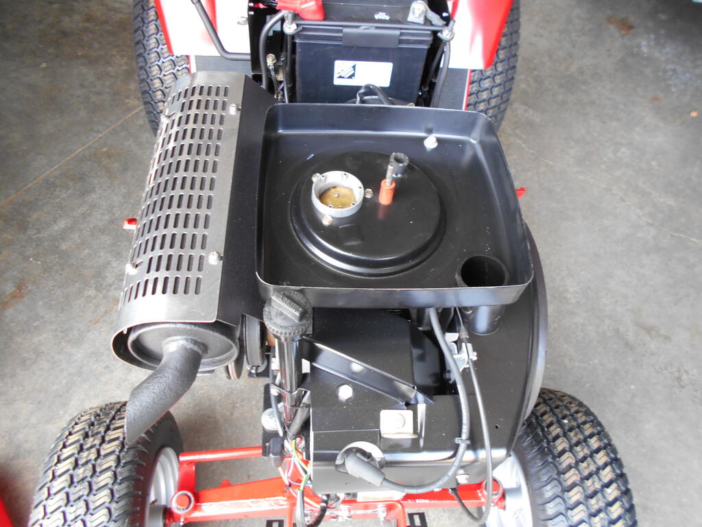

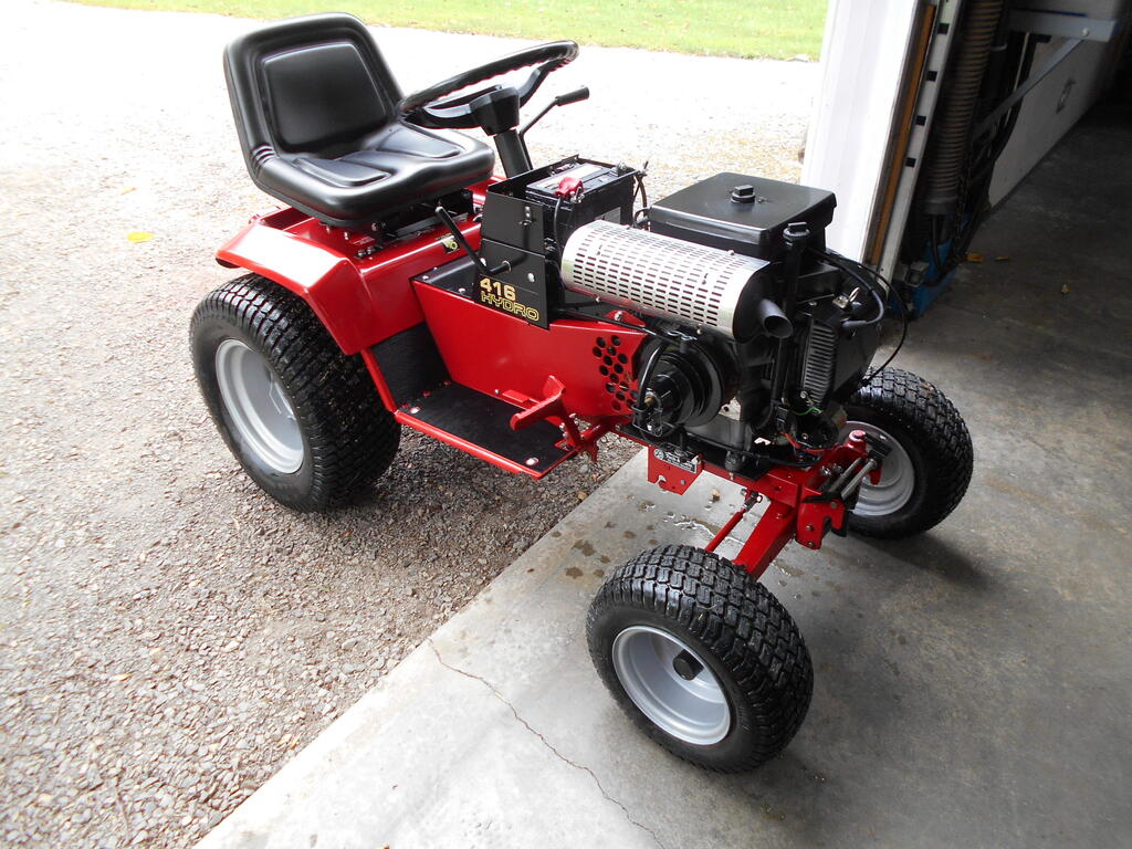

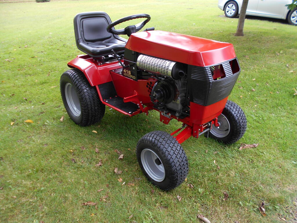

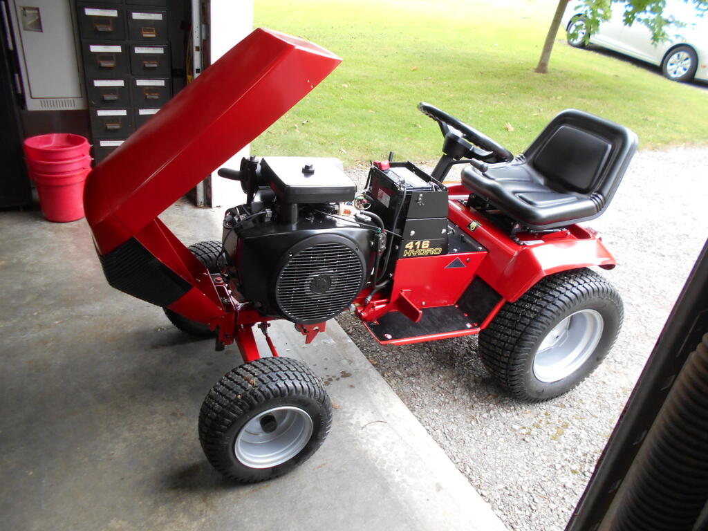

cleat 8,994 #352 Posted March 30 It finally warmed up enough to get the tractor started. Some fresh non-ethanol fuel was added to the fuel tank I pumped some air into the fuel tank with a hand pump to fill fuel line and prime the carb. Rear of tractor was jacked up so it would not take off on me since hydro neutral has not yet been set. Engine started virtually immediately. I let it run for a while to warm up and verify it was running well. Air cleaner housing installed. Air cleaner element and cover installed. Air cleaner cover installed. Idle speed base and governed set as per manual. Hydro neutral set as per manual. Tractor rear was then set on the ground and I was finally able to take it for it's maiden drive. It drives perfectly. Here is the manual I use to set the idle and hydro. Wheel horse service manual.pdf 1 11 Share this post Link to post Share on other sites
c-series don 12,045 #353 Posted March 31 As expected, it came out looking better than new! I think I speak for everyone when I say that we are already looking forward to your next project!👍🏻 3 1 Share this post Link to post Share on other sites

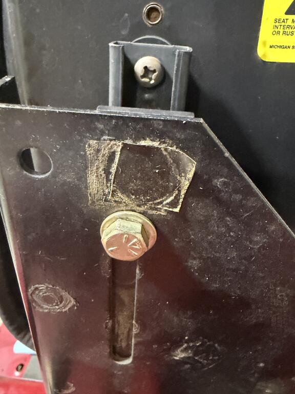

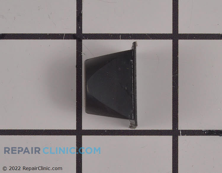

eric8 8 #359 Posted June 13 (edited) I took a closer look today once home from work and found some “witness marks” from where the OEM bumpers were placed. Just aft of the rear seat tray bolts. Attached is photos of the OE bumpers just for reference. I’m normally a stickler for keeping things factory pure, but this is one case when I think your through bolt with a donut bumper is far superior edit: I’m referencing my 93 520h’s factory setup. I realize this post was about a 416, so they may have been different Edited June 14 by eric8 1 Share this post Link to post Share on other sites
eric8 8 #360 Posted June 13 OE stick on bumper side view Share this post Link to post Share on other sites
