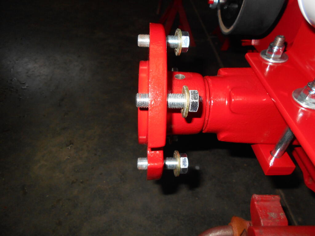

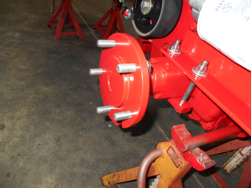

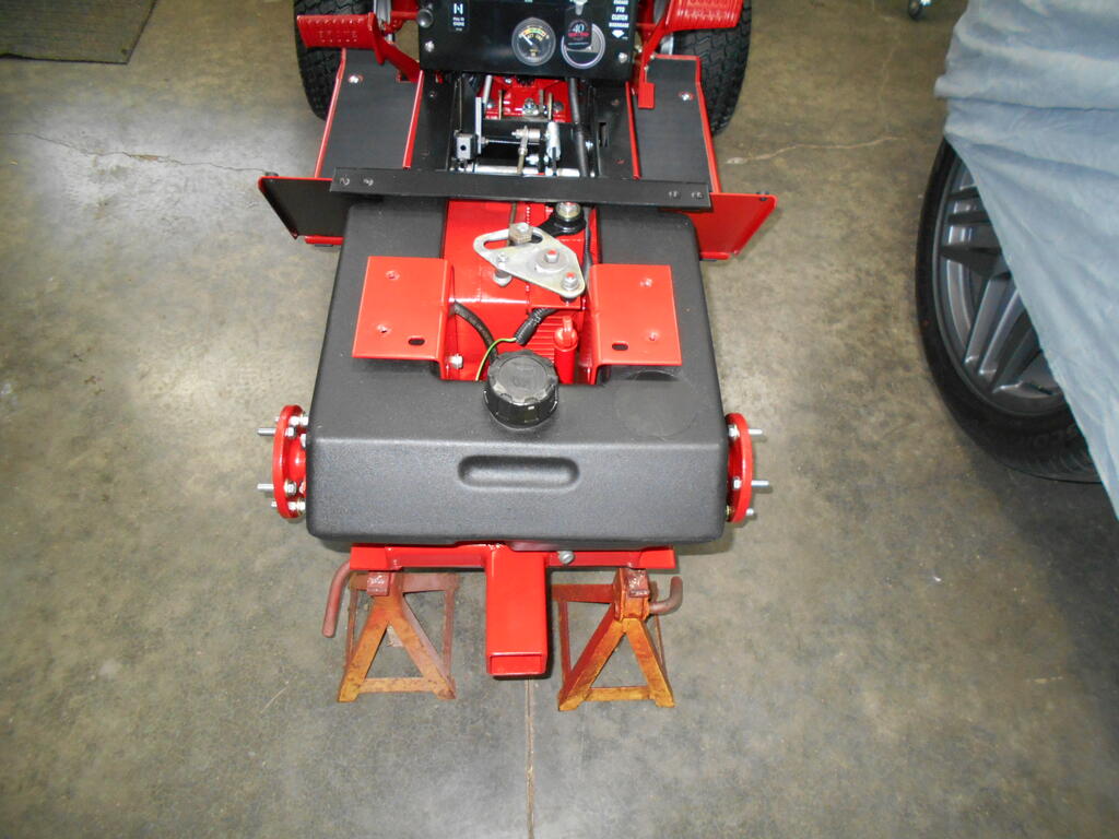

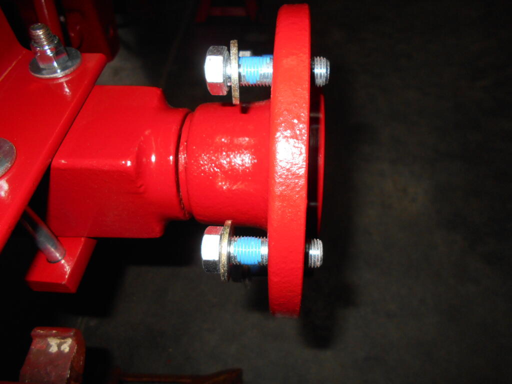

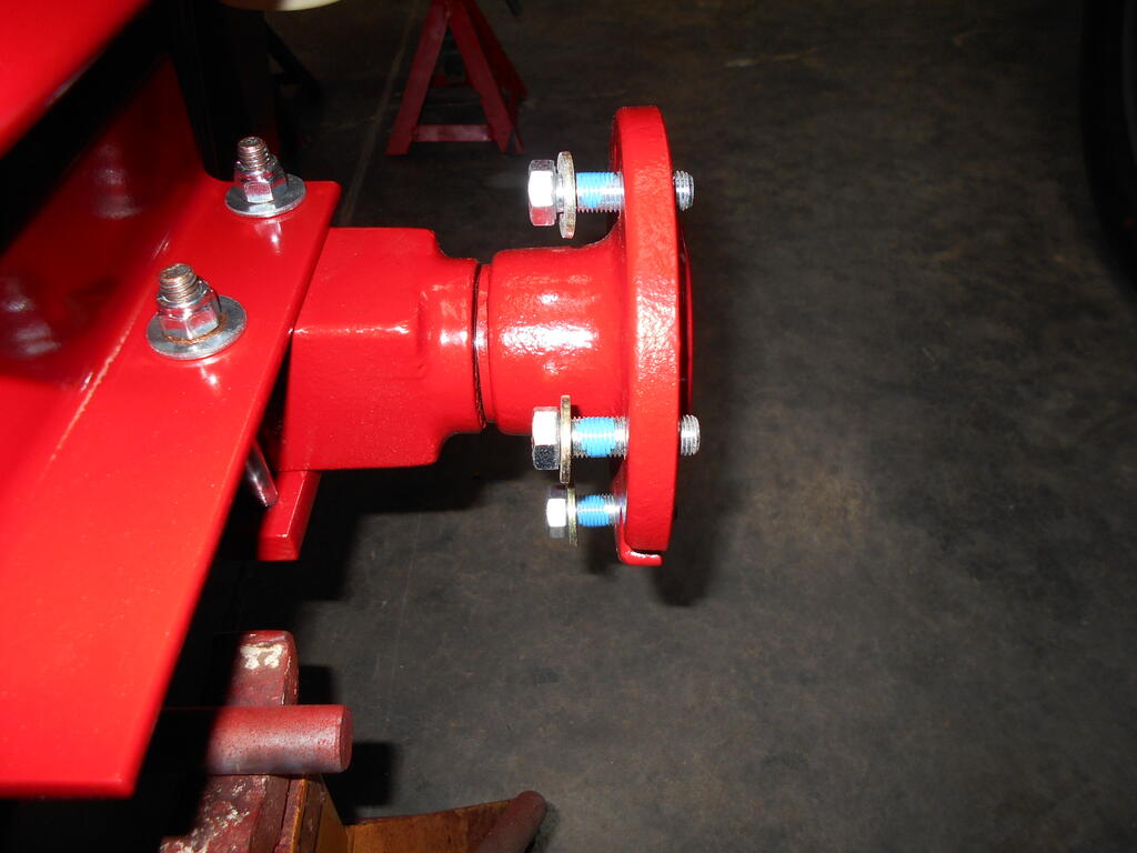

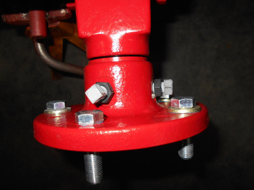

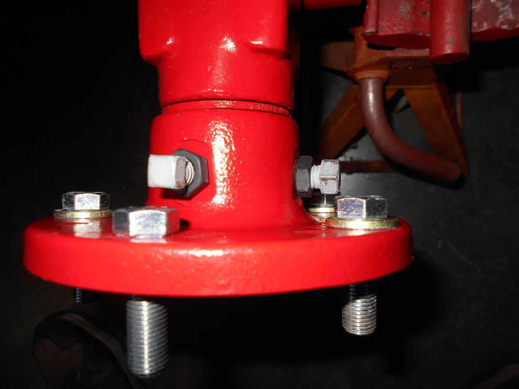

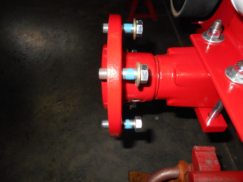

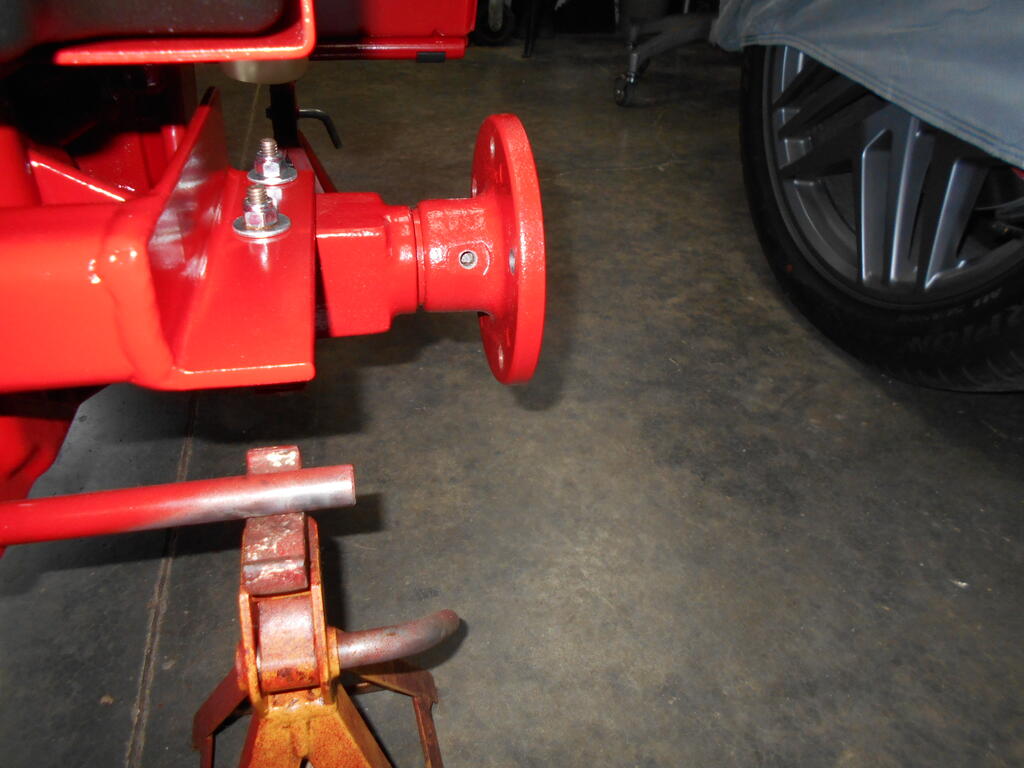

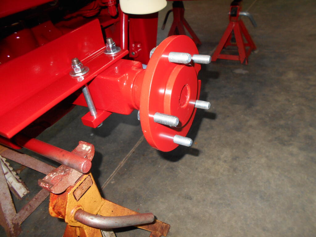

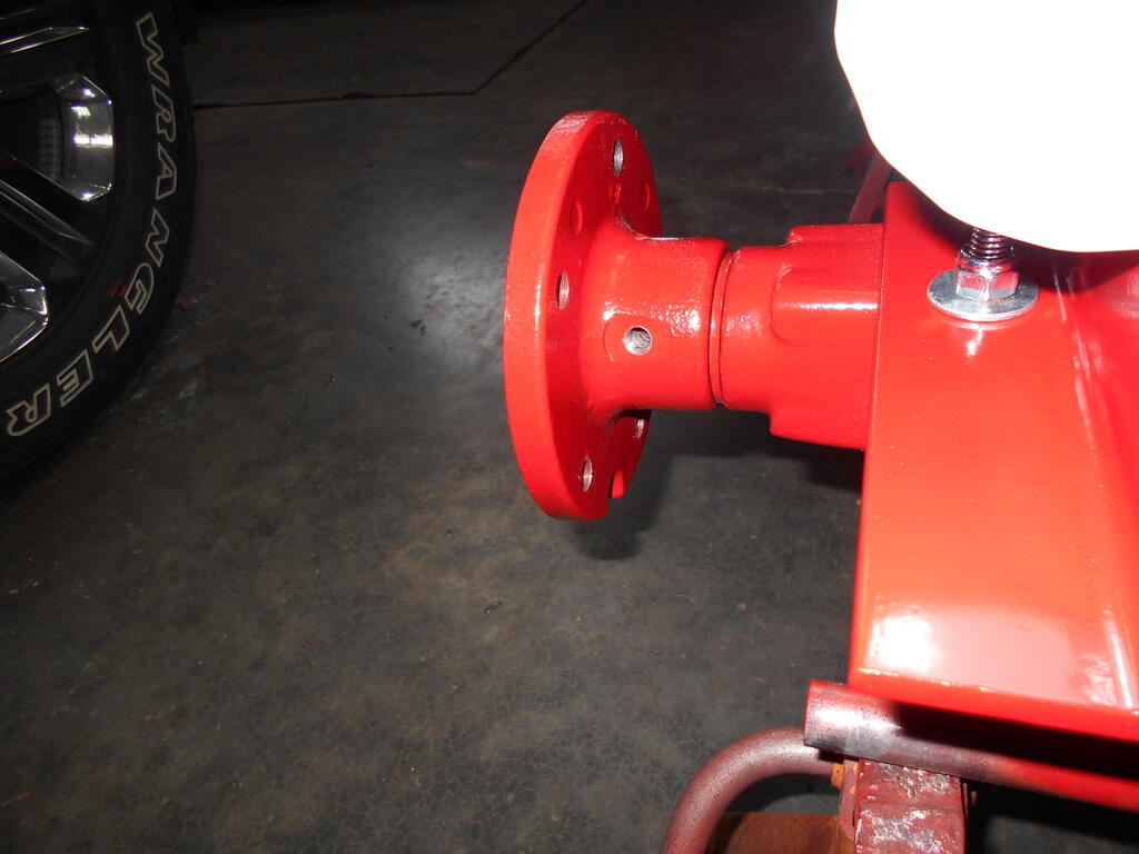

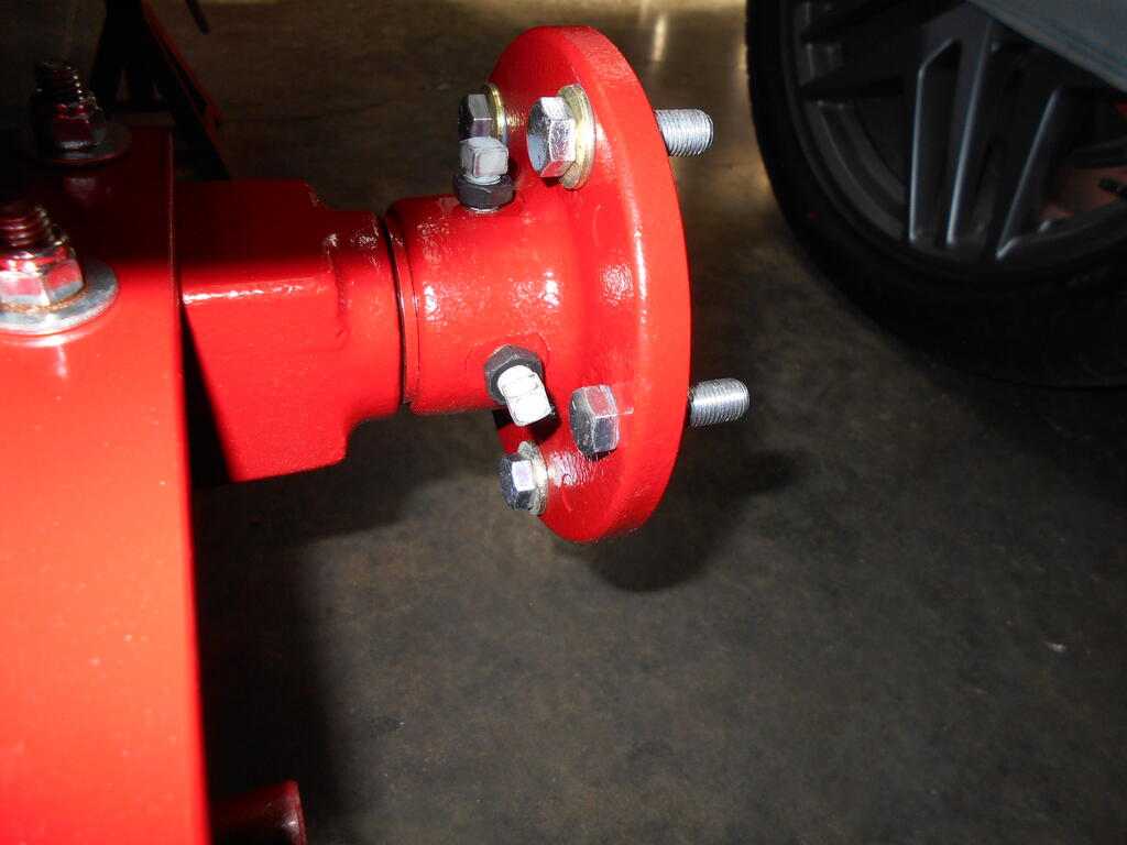

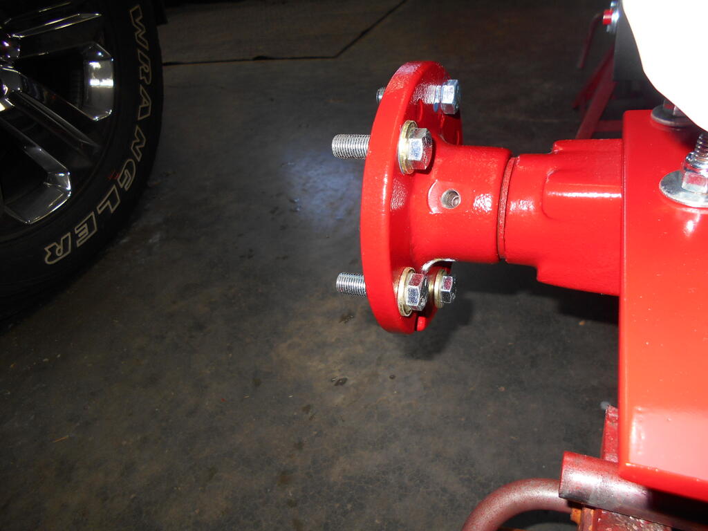

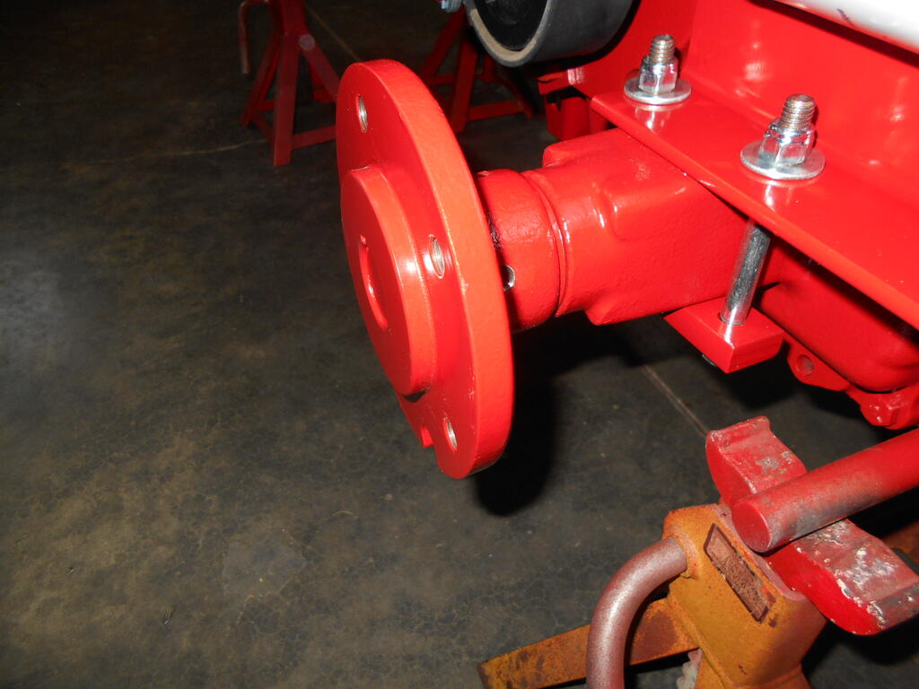

cleat 9,441 #302 Posted January 23 Wheel stud bolts 7/16 x 1- 1/2 20 NF ready to install. I use washers for all but two studs. Blue loctite will be used to retain bolts in position. Left hub ready for bolts to be installed. Bolt holes have been cleaned out with a 7/16 NF tap and blown clear. Right hub ready for bolts to be installed. Note the bub set screw and a wheel bolt line up in this one place on each hub. The bolt without a washer gets installed here. This is for clearance so the hub set screw can be properly torqued later on. Wheel stud bolts partly installed. Loctite applied to all bolts. Left wheel stud bolts screwed in and tightened. Right wheel stud bolts screwed in and tightened. This is how I tightened the wheel stud bolts. I did not torque them, just pulled them tight. 5 Share this post Link to post Share on other sites

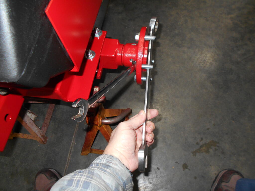

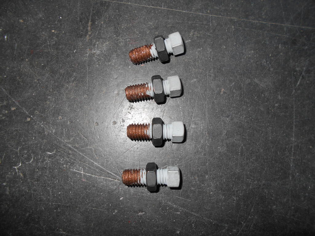

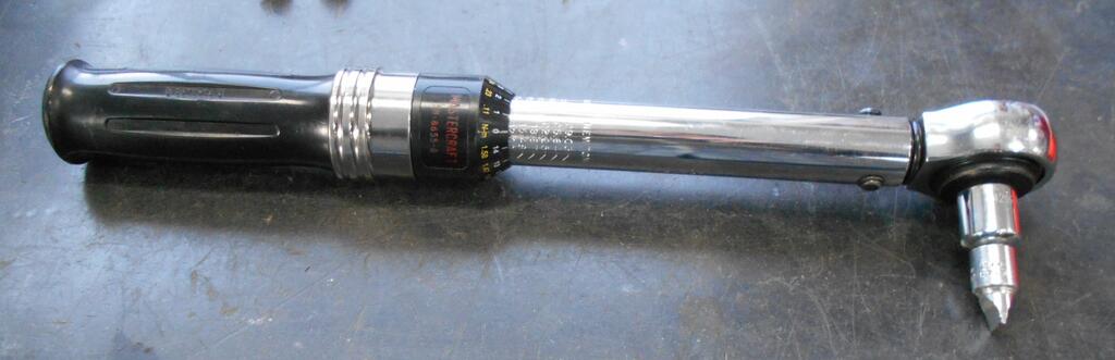

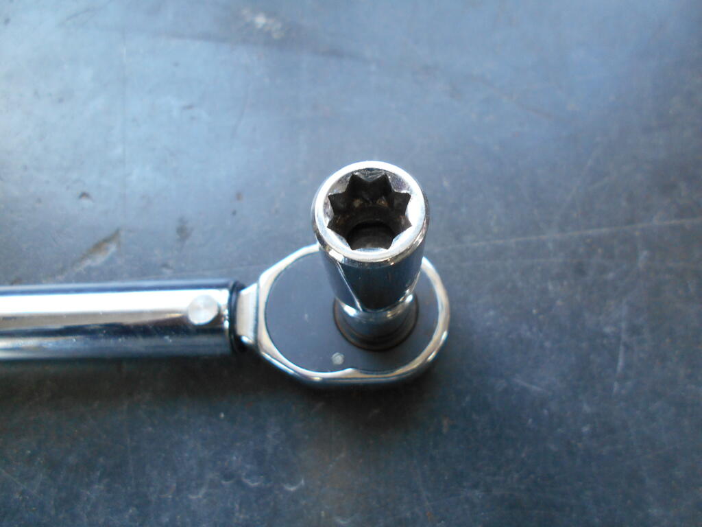

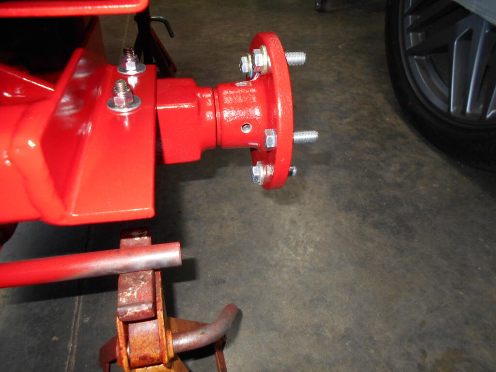

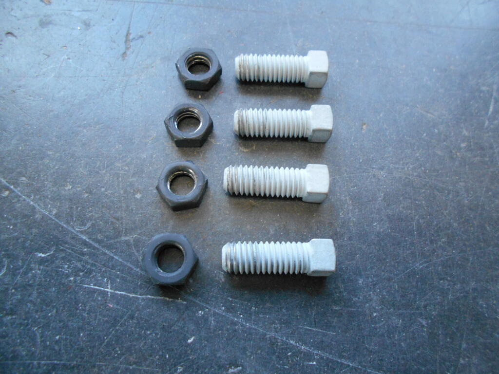

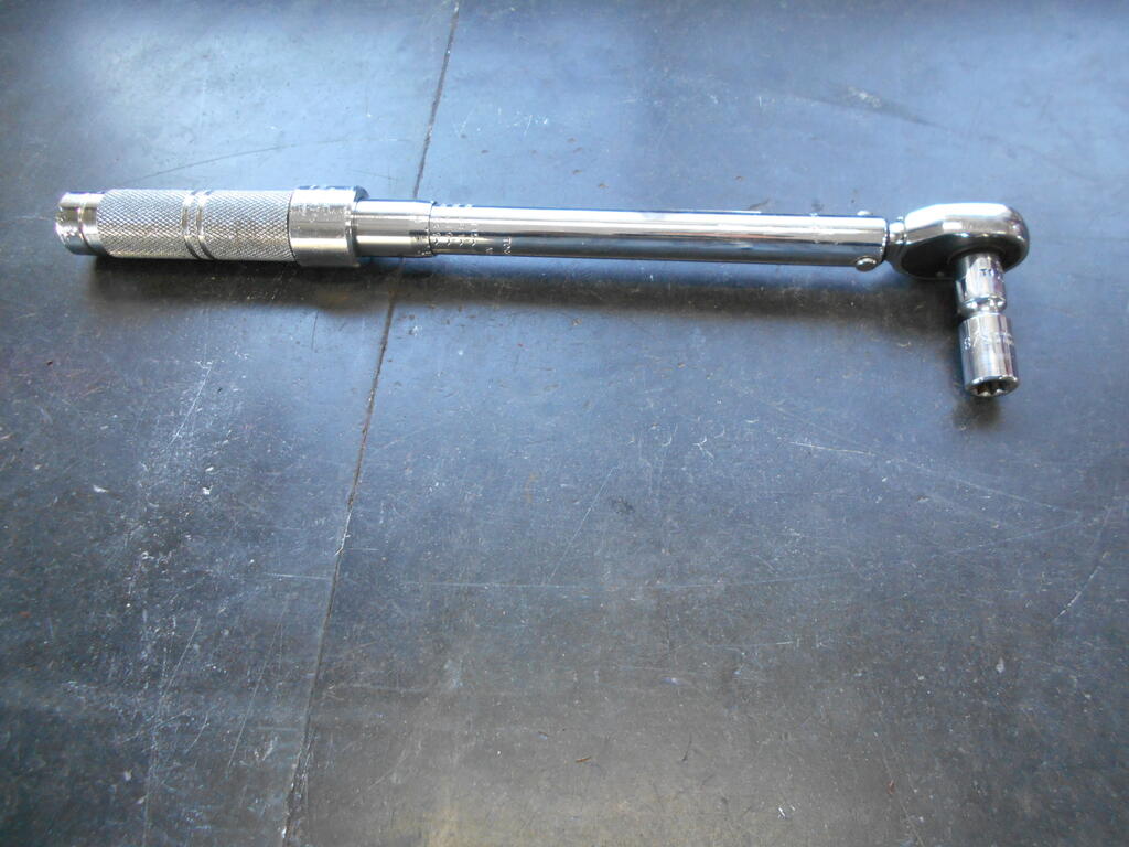

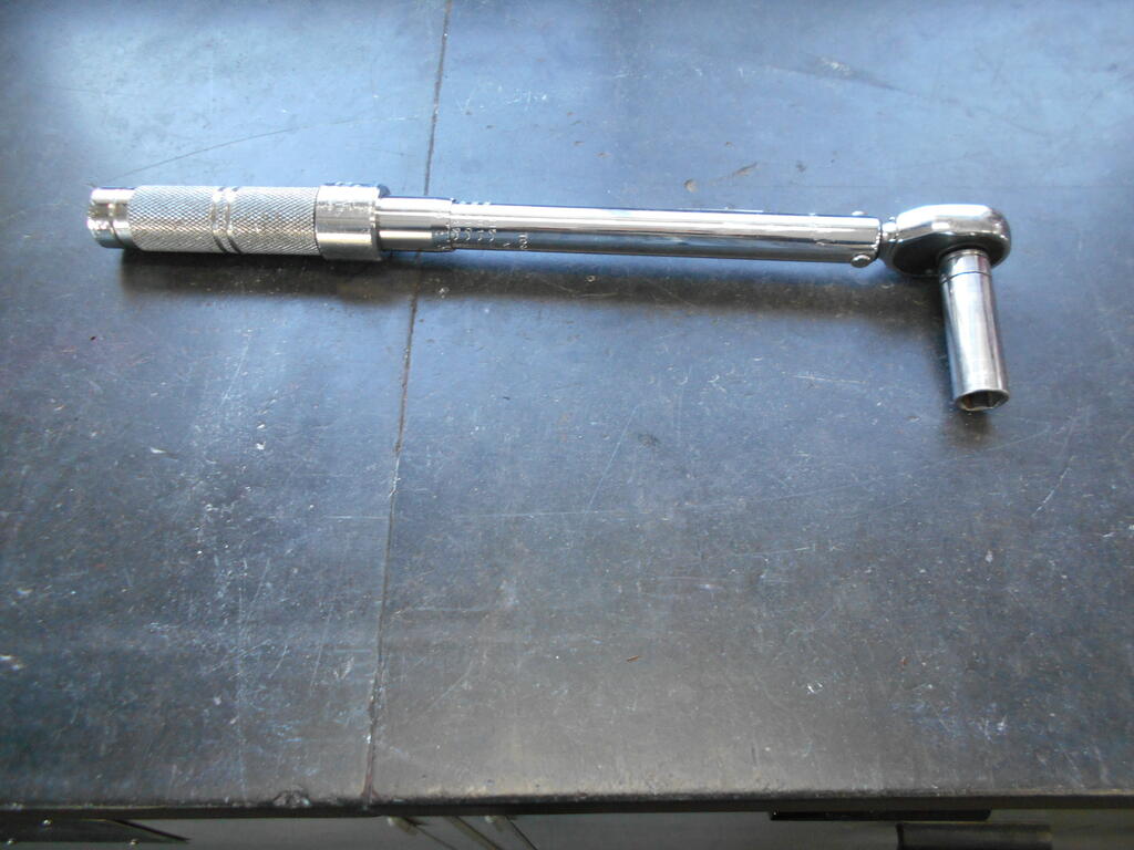

cleat 9,441 #303 Posted January 23 Hub set screws and jamb nuts ready to install. Hub set screws jamb nuts screwed on and never seize applied. Hub set screws installed finger tight making sure jamb nuts remain loose and not contacting hub. Hub set screws torqued to 30 ft/lb. Again, make sure jamb nuts are loose and not contacting hub or the set screw may not actually be contacting the axle. Hub set screw jamb nuts torqued to 17 ft/lb. 3-8 inch 8 point socket used to torque hub set screws. 8 point socket on set screw showing clearance to wheel stud bolt head. You can see why a washer was not placed under this bolt. Torque wrench and 3-8 inch 8 point socket and short extension used to torque hub set screws to 30 ft/lb. Torque wrench and deep 9-16 socket used to torque hub jamb nuts to 17 ft/lb. 6 Share this post Link to post Share on other sites

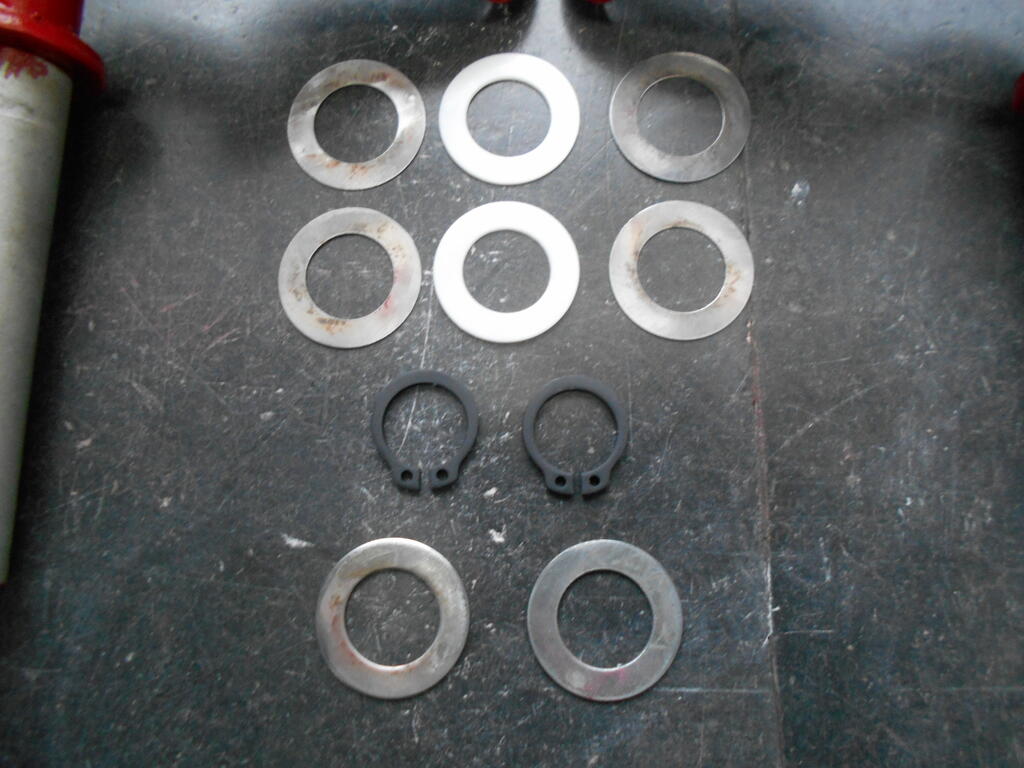

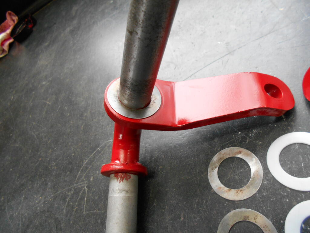

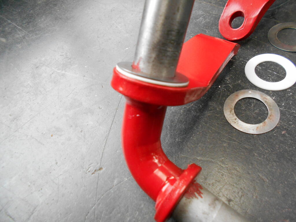

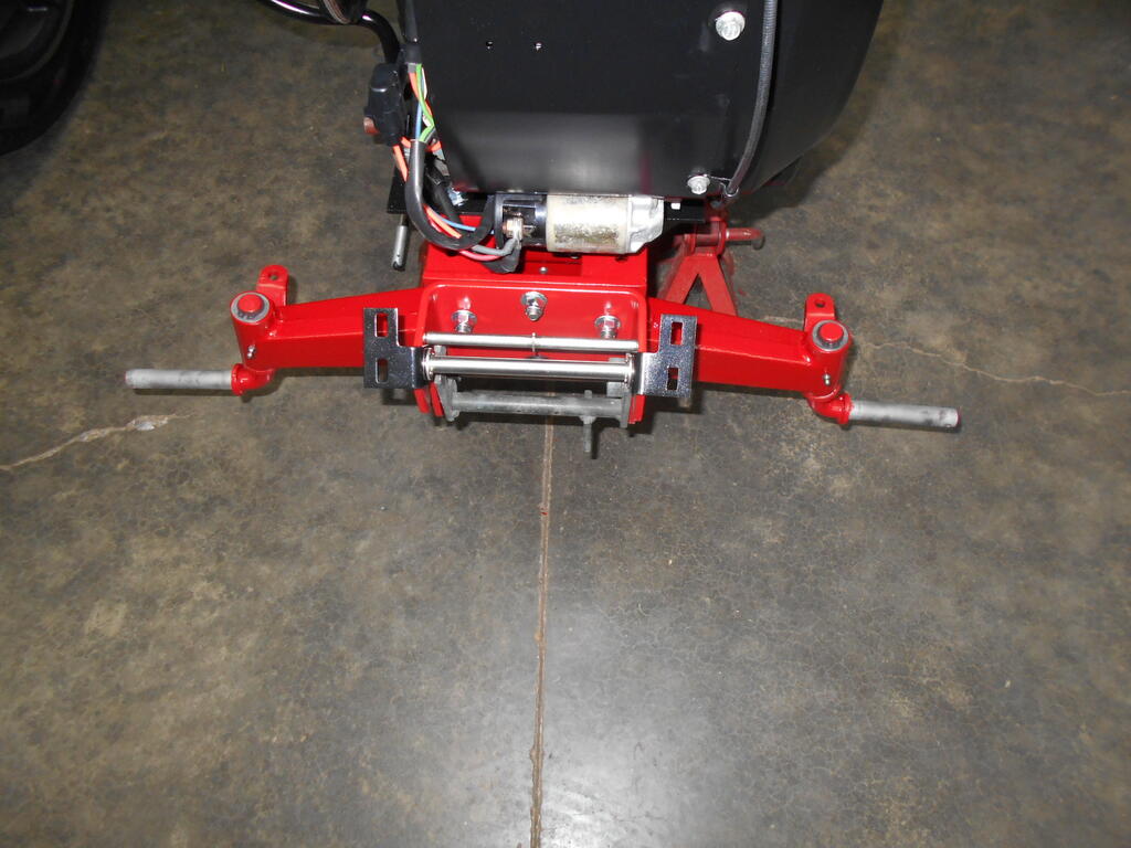

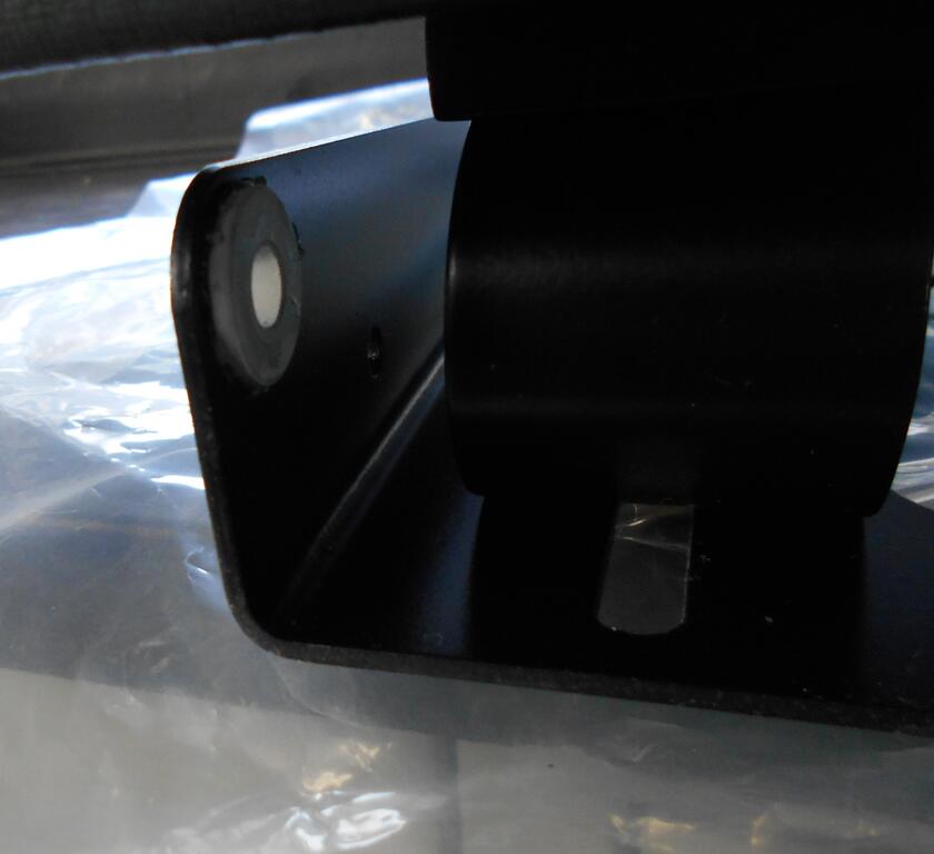

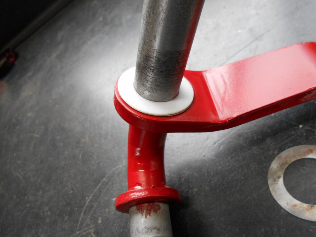

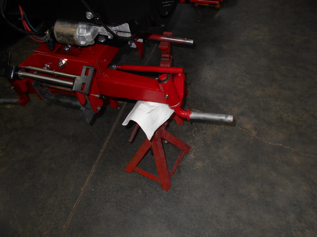

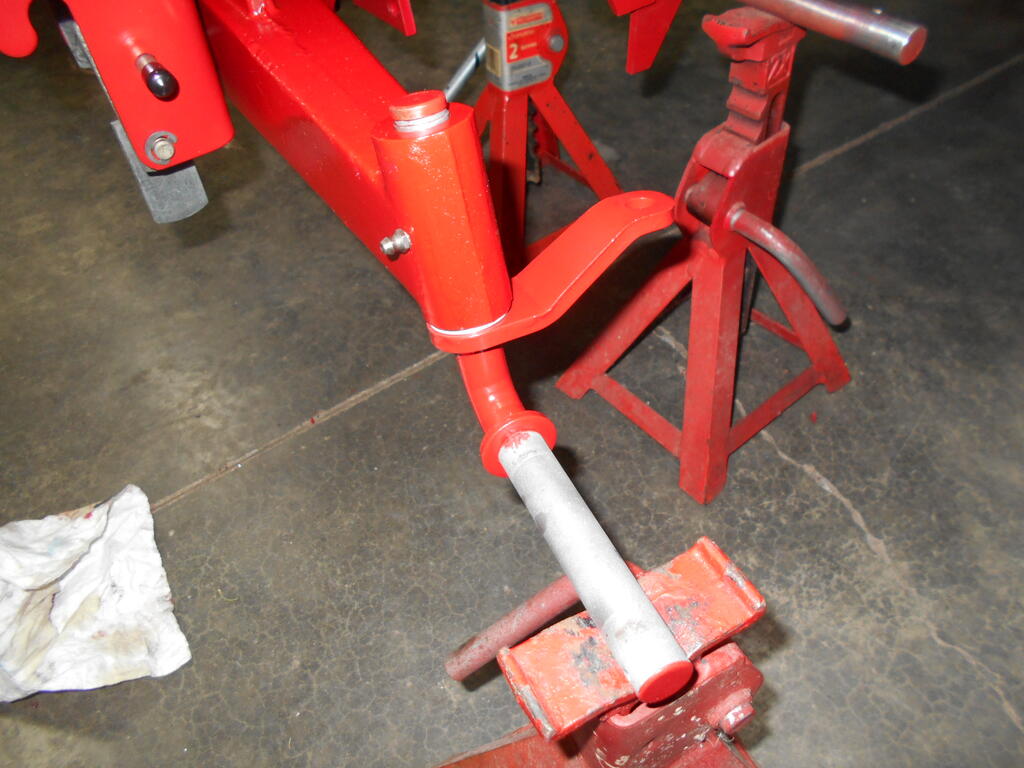

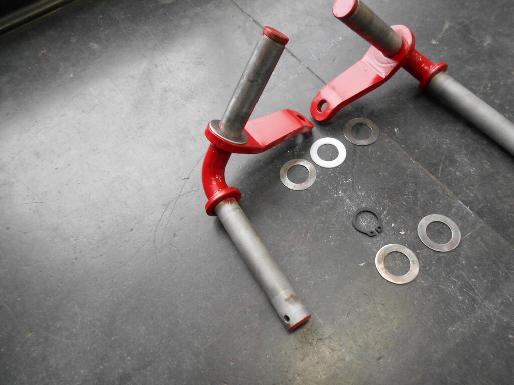

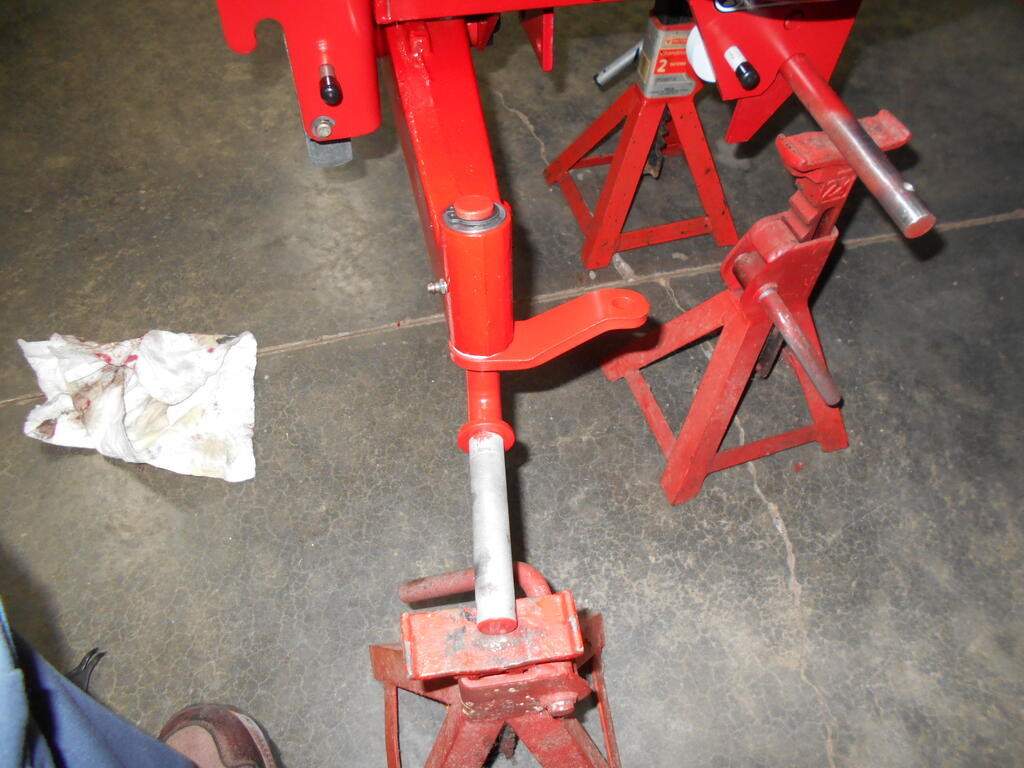

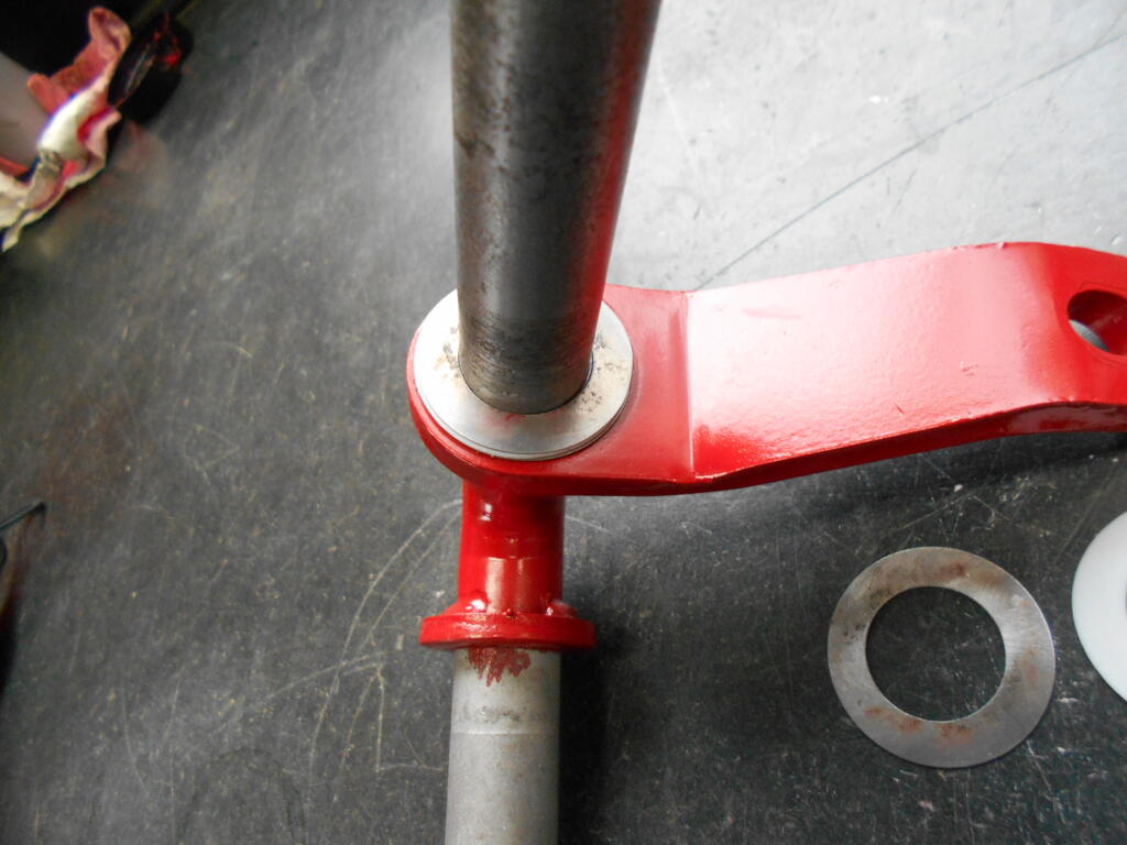

cleat 9,441 #304 Posted January 25 Spindles and washers ready to install. Spindle washers and retaining rings ready to install. At the top you see 4 0.01" thin shim washers and 2 1/32" teflon washers Then you see the retaining rings and 2 thicker shim washers (I forgot to measure the thickness of these). Thin shim washer slid onto spindle. Teflon washer slid onto spindle. Second shim washer slid onto spindle. Stack of shim and teflon washers. This will be the thrust bearing to make steering easier. Spindle ready to install into front axle. Spindle lightly greased then installed into front axle. Top thicker shim washer slid onto spindle (you use whatever thickness is required to eliminate excess vertical play once retaining ring is installed). Retaining ring installed onto spindle. Spindle installed. Spindle installed onto other side exactly the same way. Spindles installed. 5 Share this post Link to post Share on other sites
lynnmor 9,081 #305 Posted January 25 (edited) 2 hours ago, cleat said: Top thicker shim washer slid onto spindle (you use whatever thickness is required to eliminate excess vertical play once retaining ring is installed). Retaining ring installed onto spindle. Not enough space to use a needle thrust bearing? Edited January 25 by lynnmor 1 Share this post Link to post Share on other sites
WHX?? 58,387 #306 Posted January 25 (edited) Why this route and not 520 style bearings? I would have also considered the bronze oil lite washers. Edited January 25 by WHX?? 1 Share this post Link to post Share on other sites
cleat 9,441 #307 Posted January 25 I went this route because I had everything here already. A needle bearing would have to be very thin like 1/32" to fit without modification. Once I get to test drive this machine then I will know how it steers. 2 1 Share this post Link to post Share on other sites

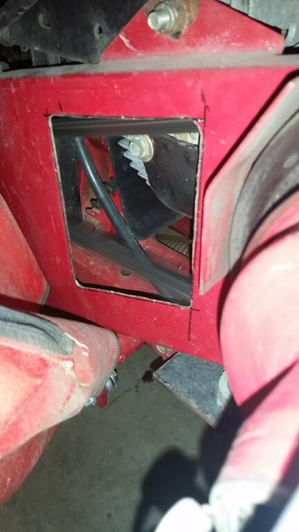

WHX?? 58,387 #308 Posted January 25 On 1/22/2026 at 8:05 AM, cleat said: I punched some ventilation holes with an electrical knockout punch. I have a spare belt cover and knock outs may try this for the 520 FEL. I have just cut out a section with intent to put hardware cloth on but never did. 1 Share this post Link to post Share on other sites

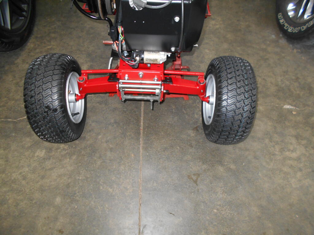

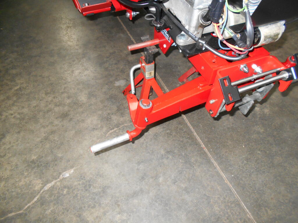

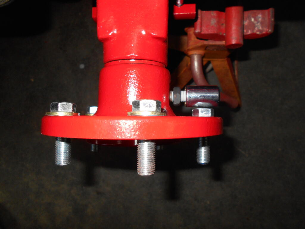

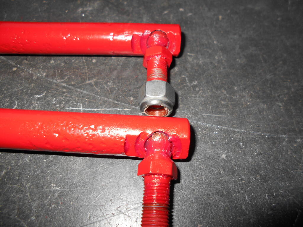

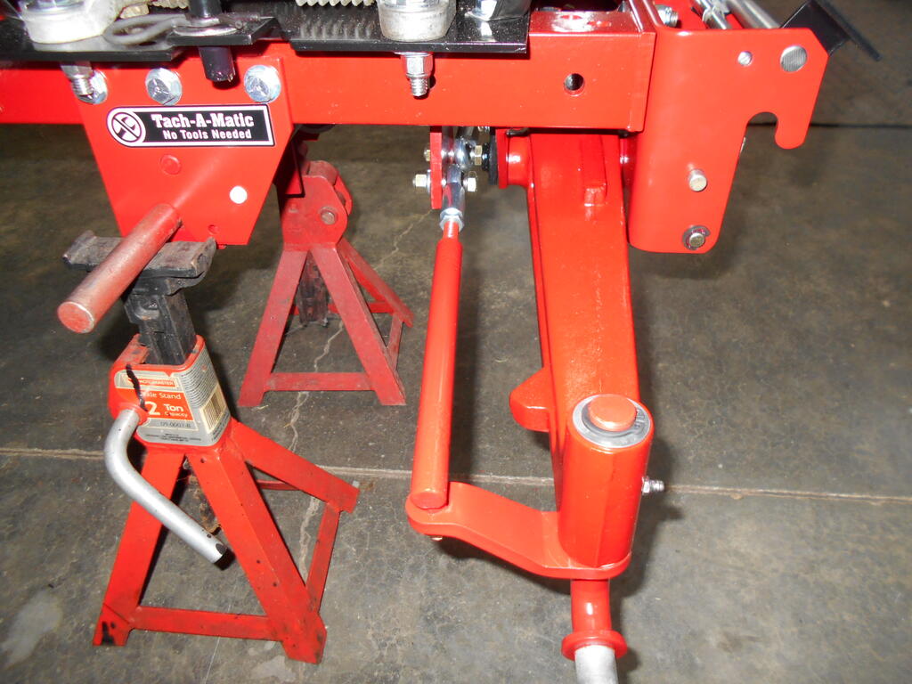

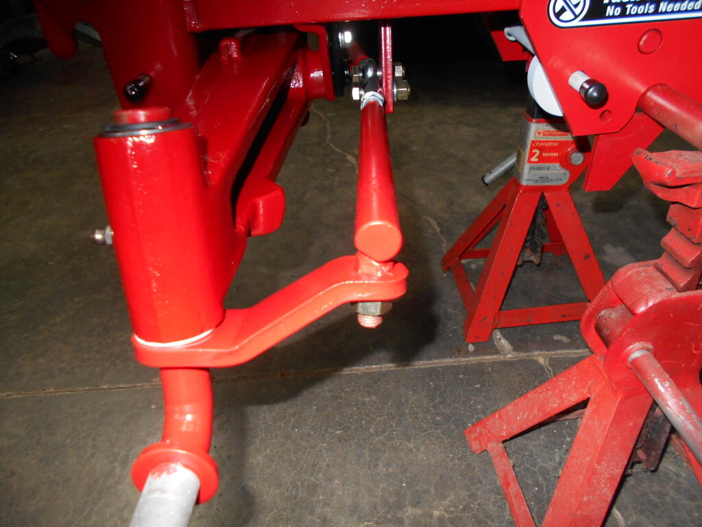

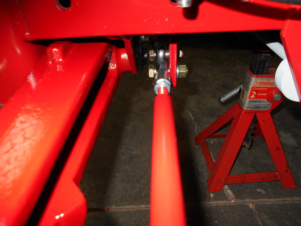

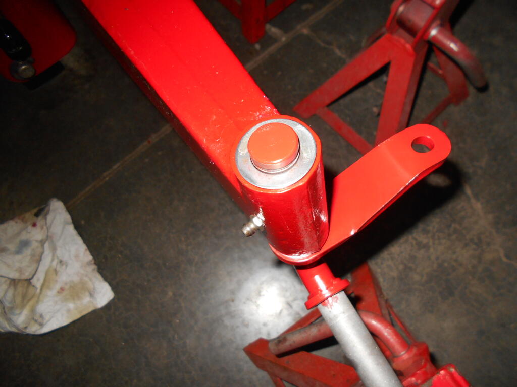

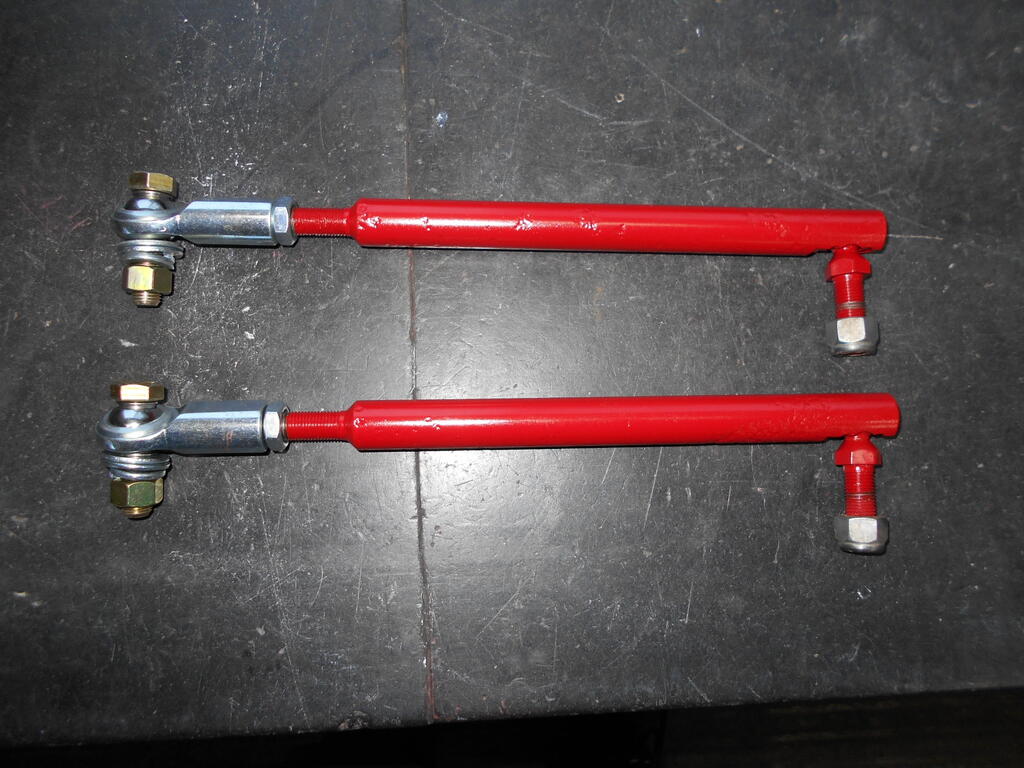

cleat 9,441 #309 Posted January 26 Tie rods ready to be installed. Outer ends stock with new Heim inner joints. Tie rod outer ends greased. I worked it in as much as possible. Tie rods installed. I used non-locking nuts for now on the outer end until final alignment is done. Inner tie rod ends are held tight using lock washers for now at least. Greased spindles and axle pivot. Now out to plow or blow snow. 5 1 Share this post Link to post Share on other sites

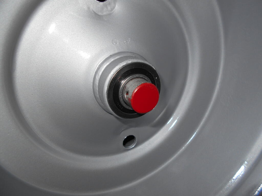

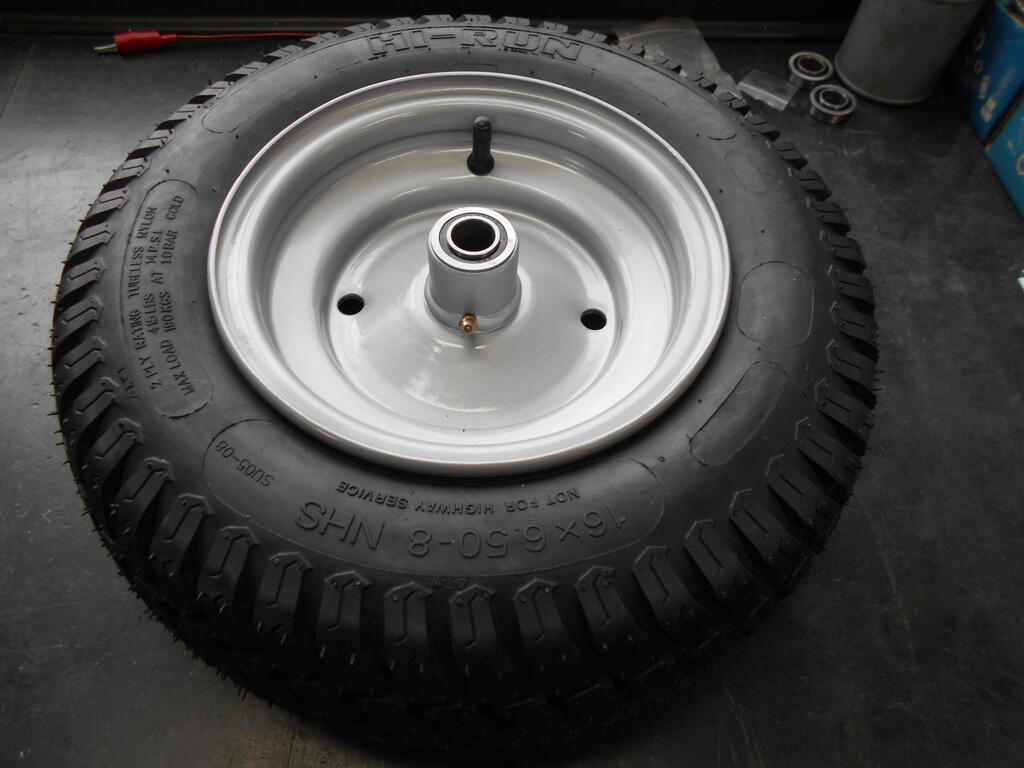

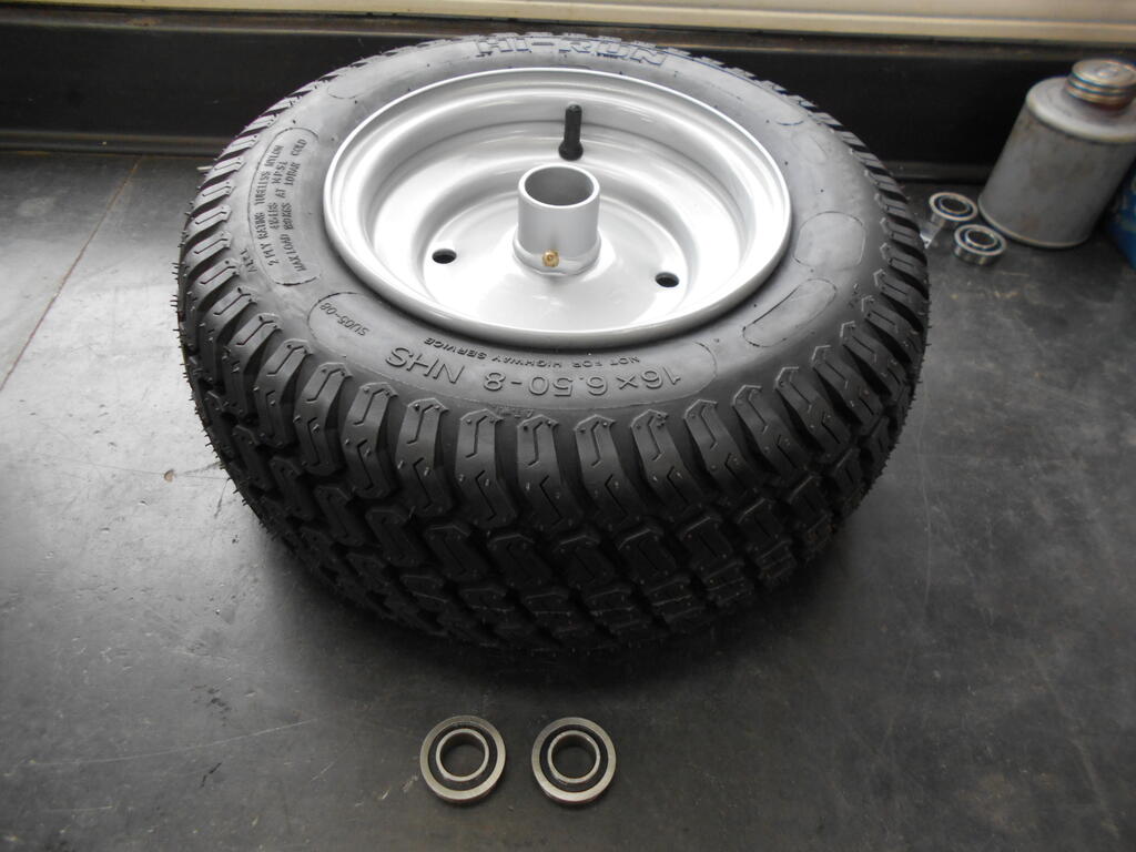

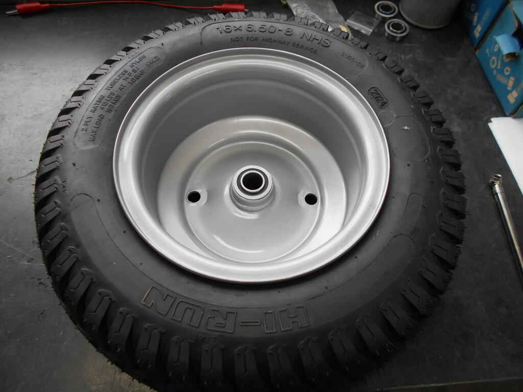

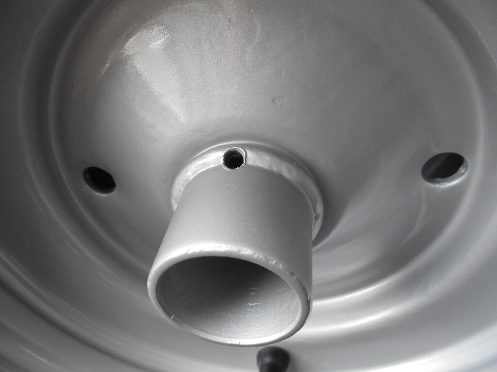

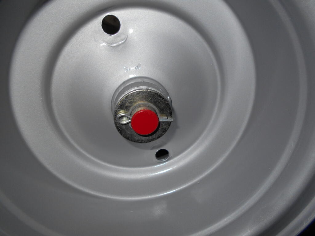

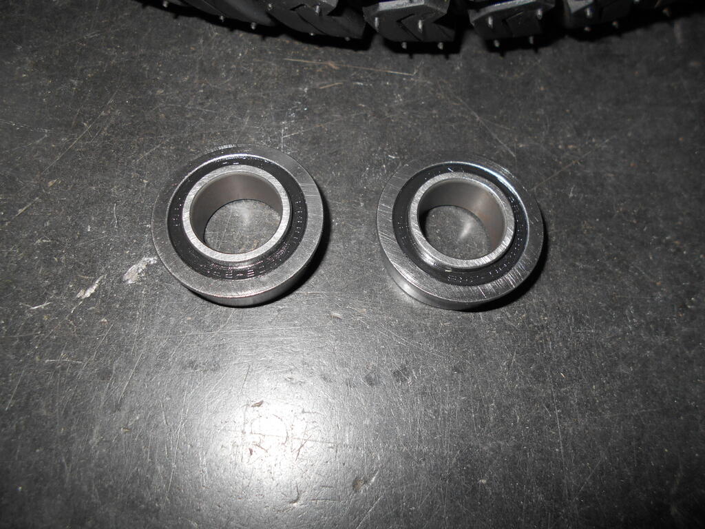

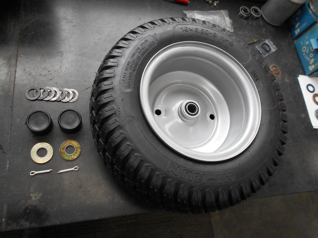

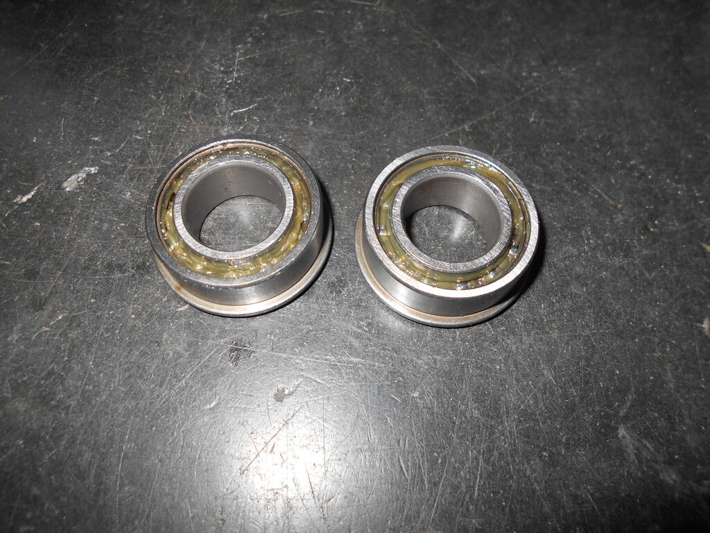

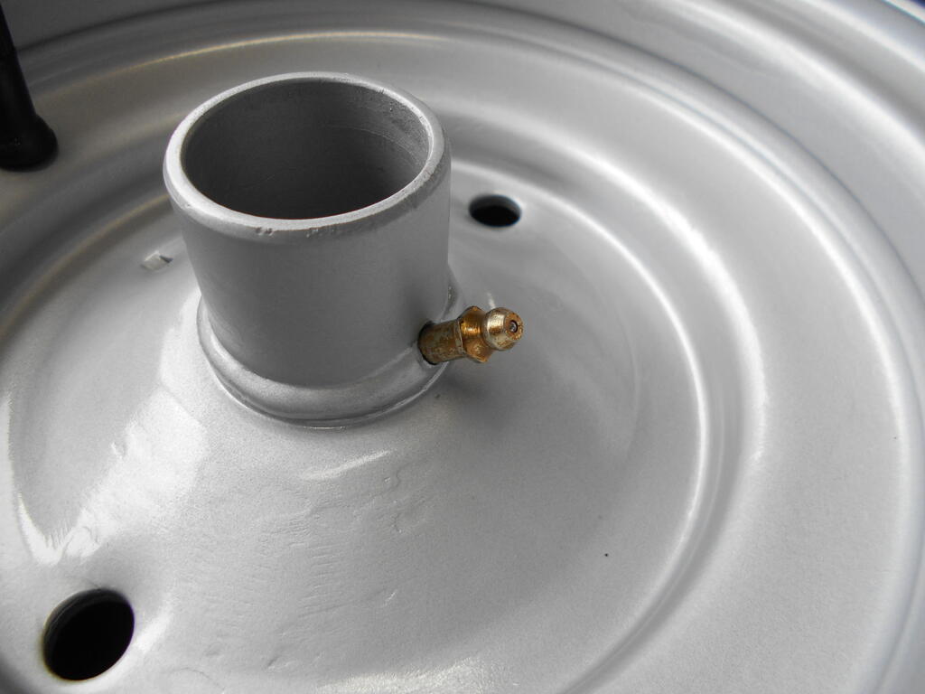

cleat 9,441 #310 Posted January 27 Grease fittings ready to be installed into front wheels. These are longer than I would like but they are what I have on hand. The regular length ones are too short to be screwed in properly. Front wheel ready for grease fitting to be installed. Front wheel grease fitting installed. Front wheel bearings ready to be installed. Front wheel bearings used. Front wheel bearings inner seals removed. They actually had more grease in them than I expected. Front wheel bearings ready to be pressed in. I used a 1-1/8" socket to press on the outer race so any chance of bearing damage is eliminated. Front wheel bearings installed. 4 1 Share this post Link to post Share on other sites

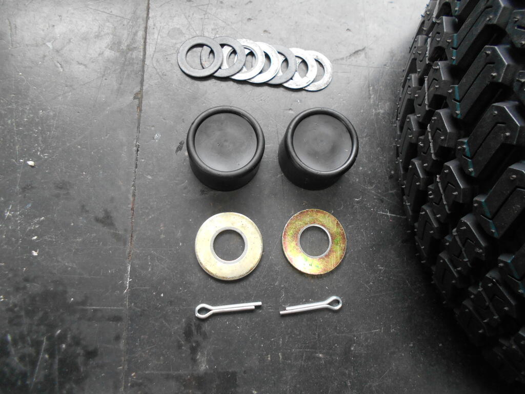

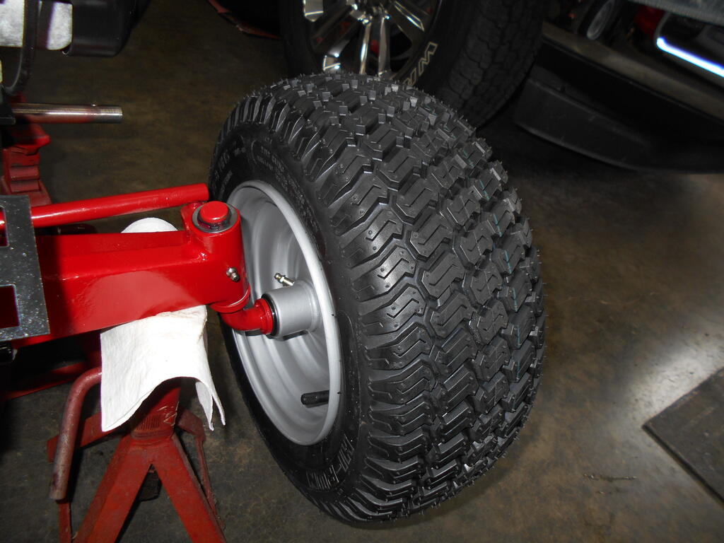

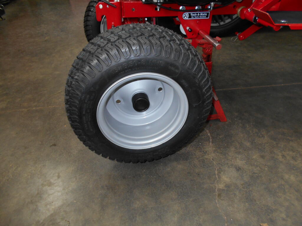

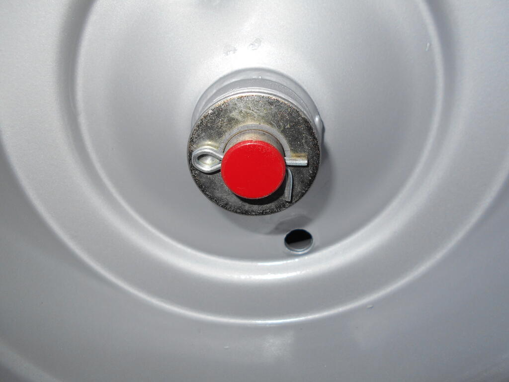

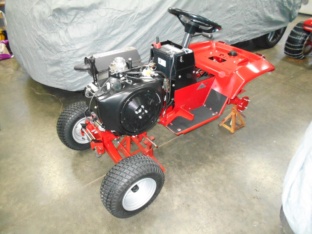

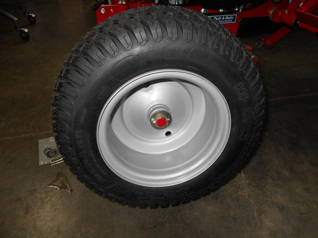

cleat 9,441 #311 Posted January 27 Front wheels ready to be installed. Front wheel shim washers hubcap washers cotter pins and hubcaps ready to be installed. Front axle tilted up so wheel slides onto spindle easier. Front wheel slid onto spindle. Shim washers then hub cap washer slid on and cotter pin slid in to find proper shim washers required. This is trial and error with the shim washers I had on hand until I found the right combination that allows the cotter pin to be inserted but eliminated excess play. I then removed the cotter pin and all washers. Front wheel removed from spindle and shim washers then slid onto the spindle. Front wheel slid back on and hub cap washer and cotter pin installed. Cotter pin slid in nicely without forcing it but no in and out free play was found. Cotter pin then bent to hold it in place. Front wheel is installed. Hub cap will be installed after greasing front wheel. Process repeated for the other side. Both front wheels now installed. Tractor as of today. 5 1 Share this post Link to post Share on other sites
cleat 9,441 #312 Posted January 27 (edited) Front wheel greased then the hub cap was installed. Edited January 27 by cleat 6 Share this post Link to post Share on other sites

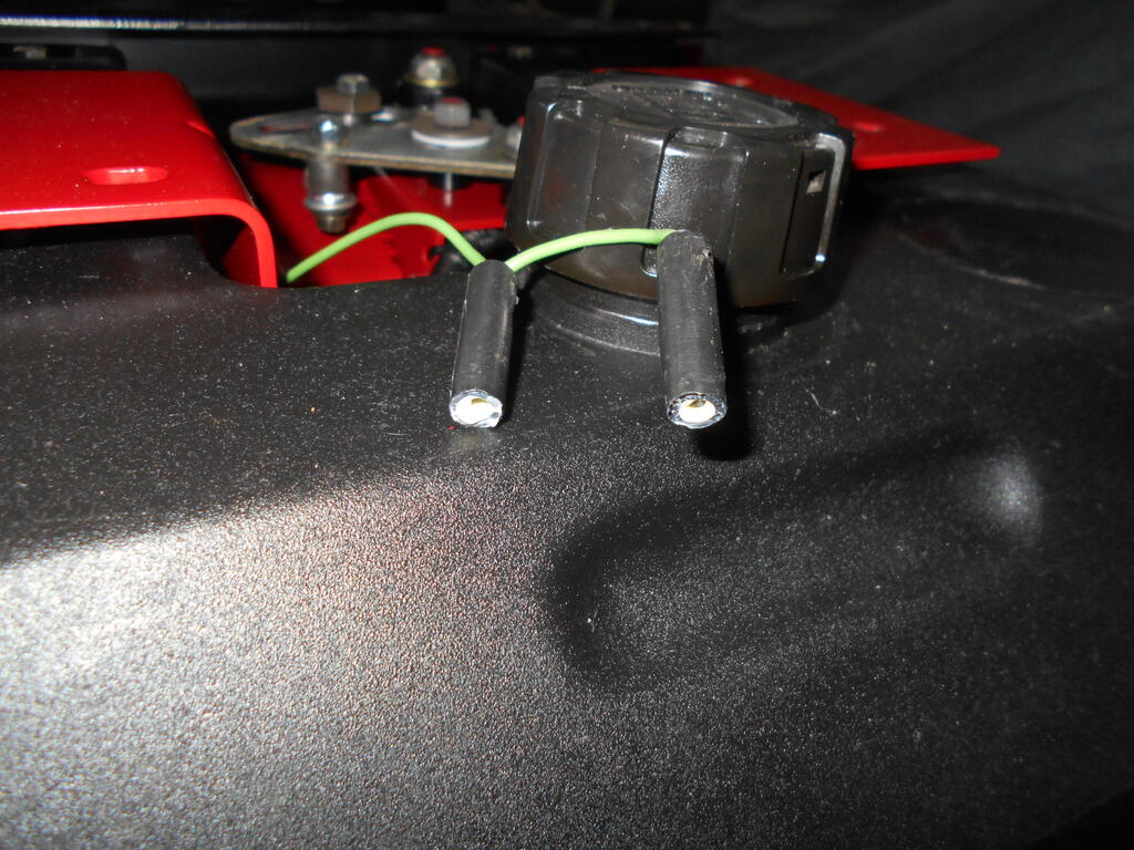

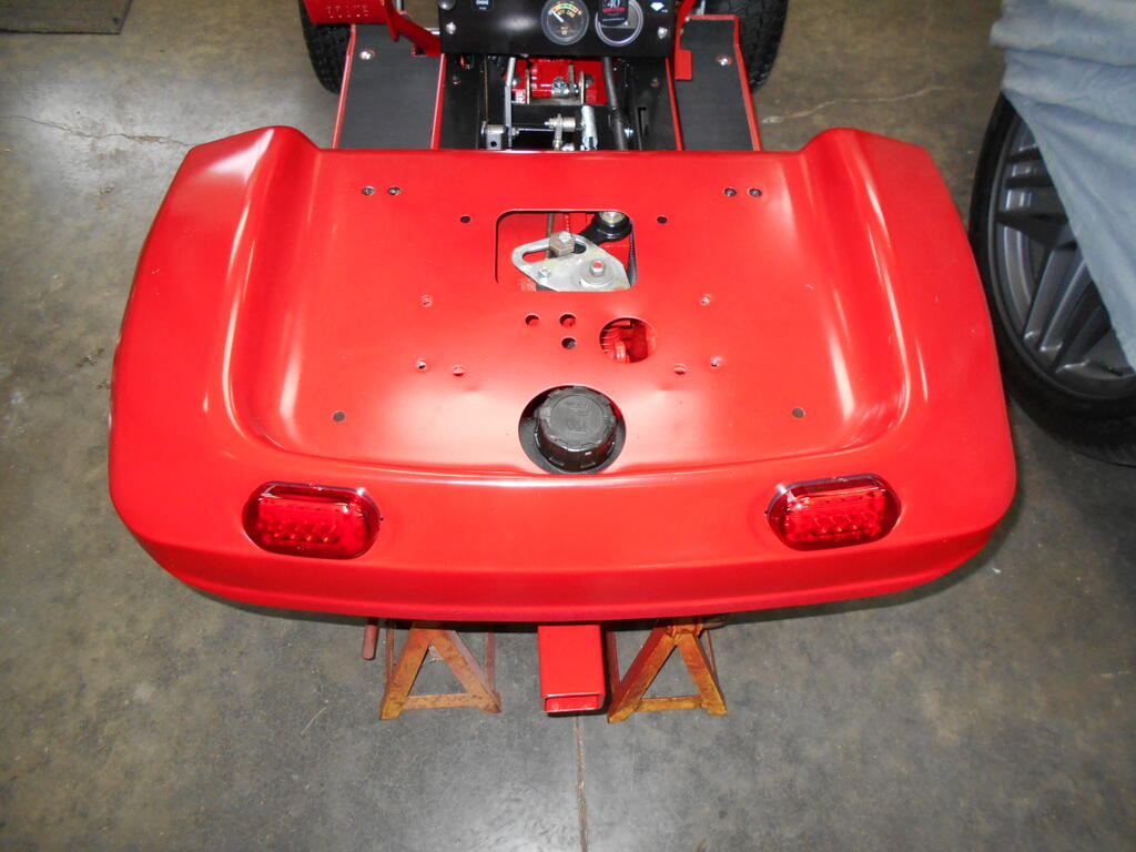

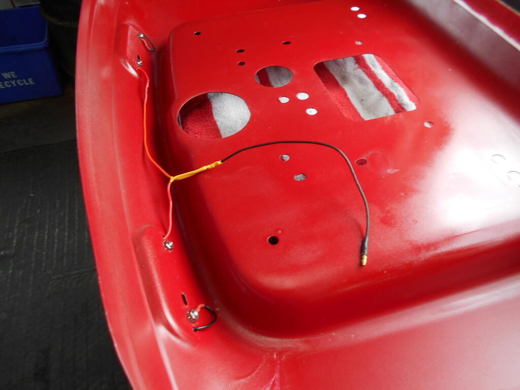

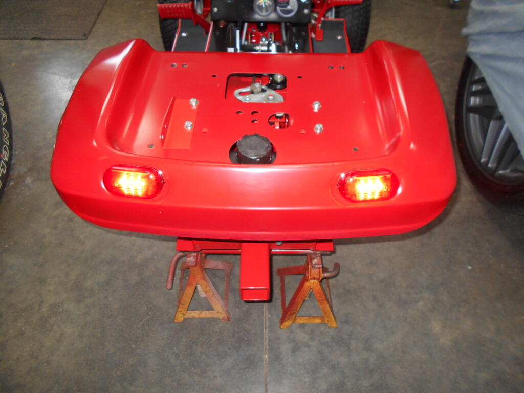

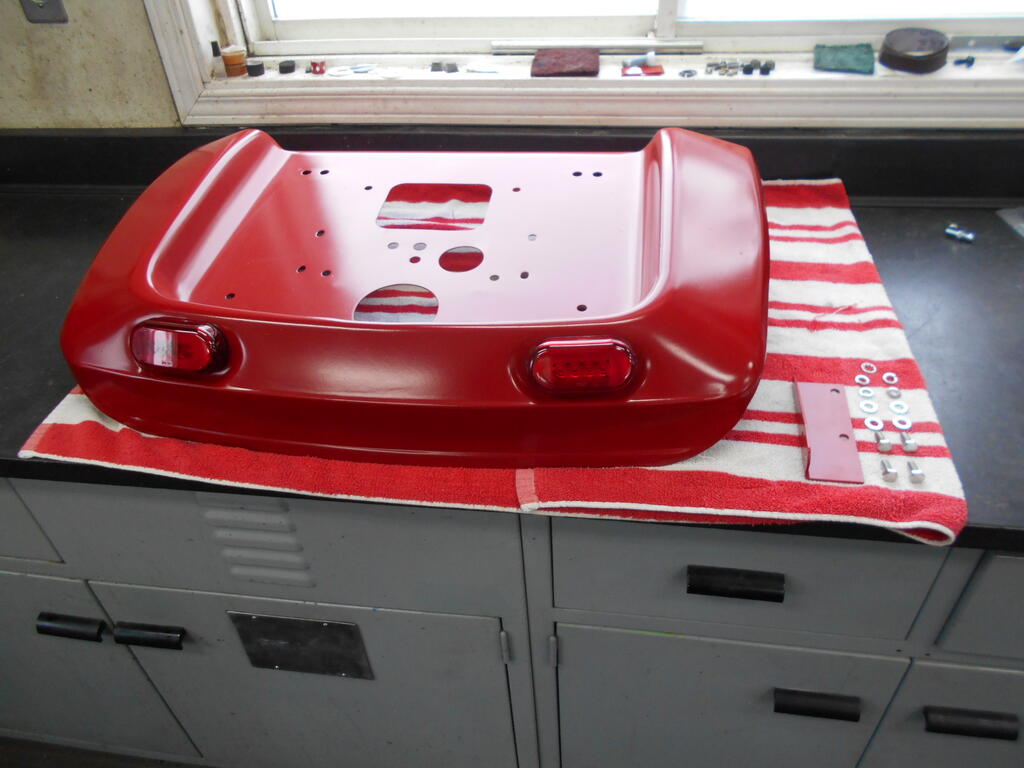

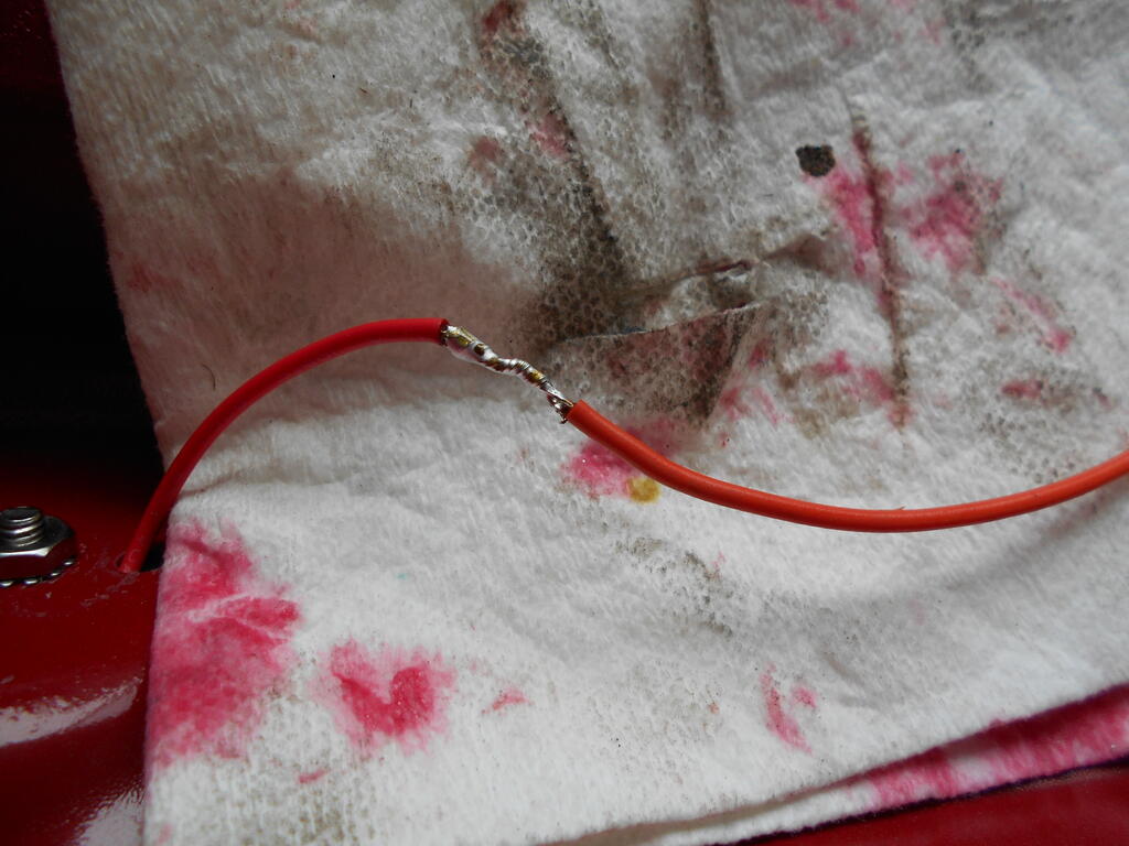

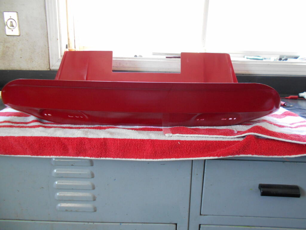

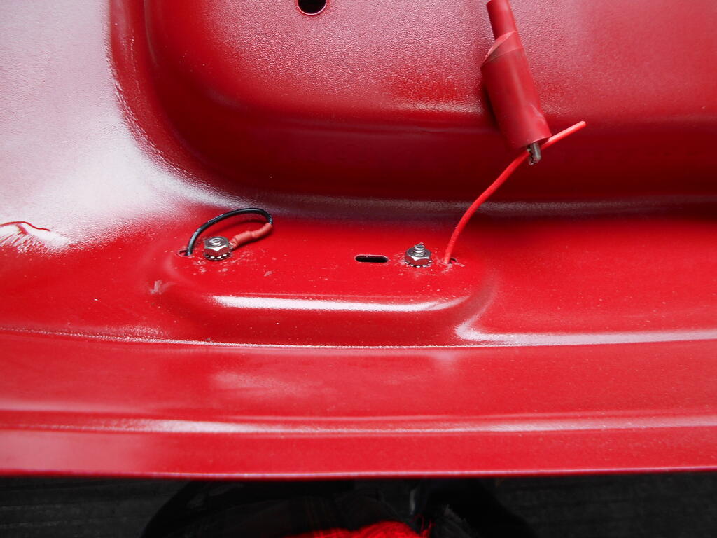

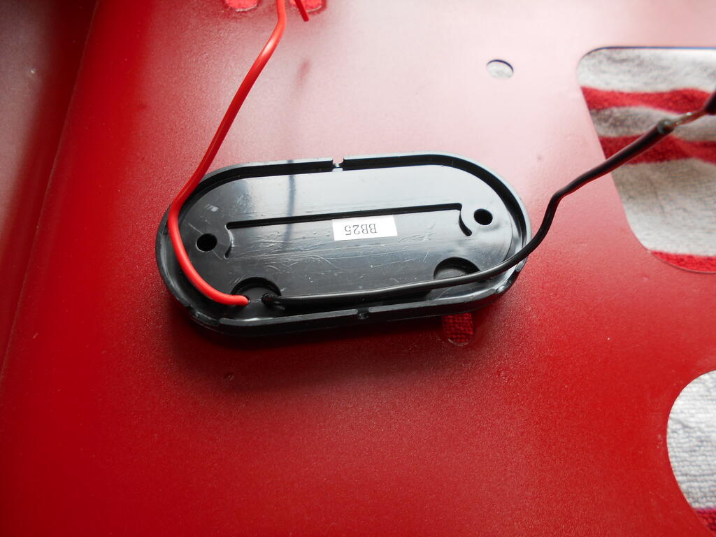

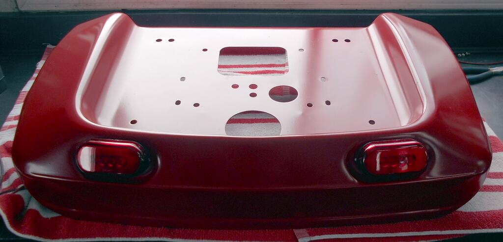

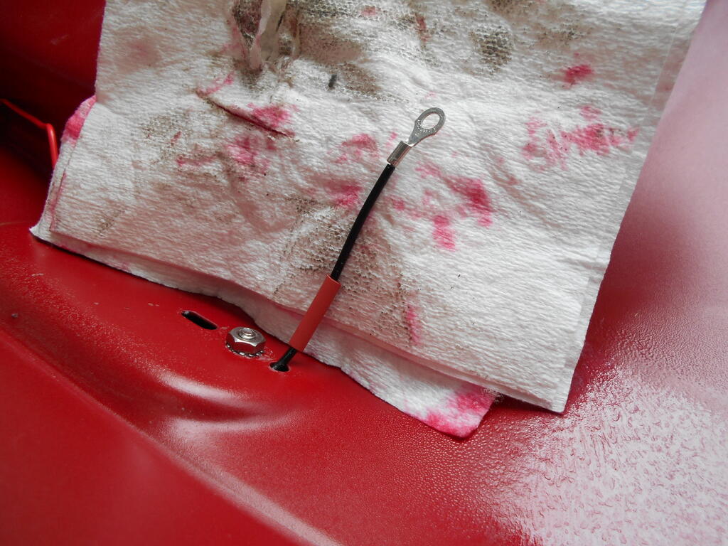

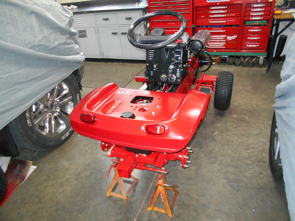

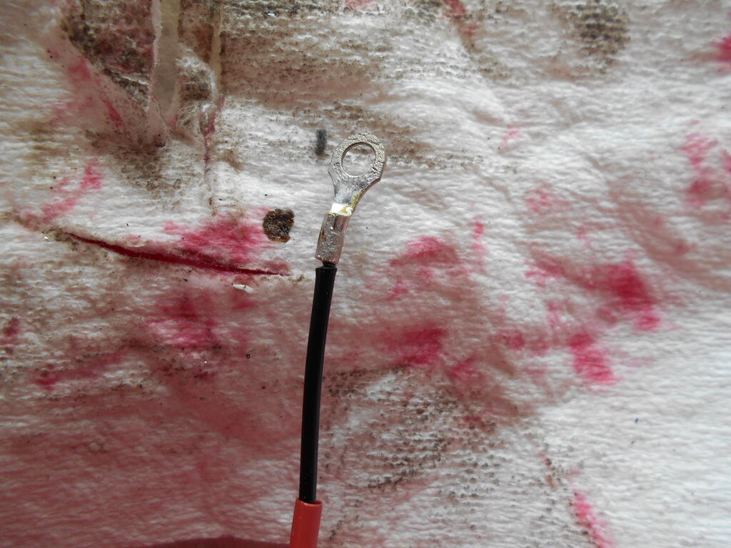

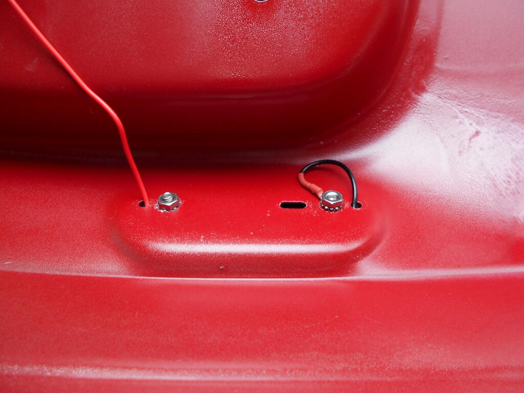

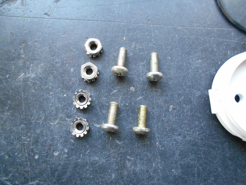

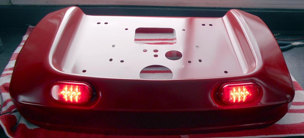

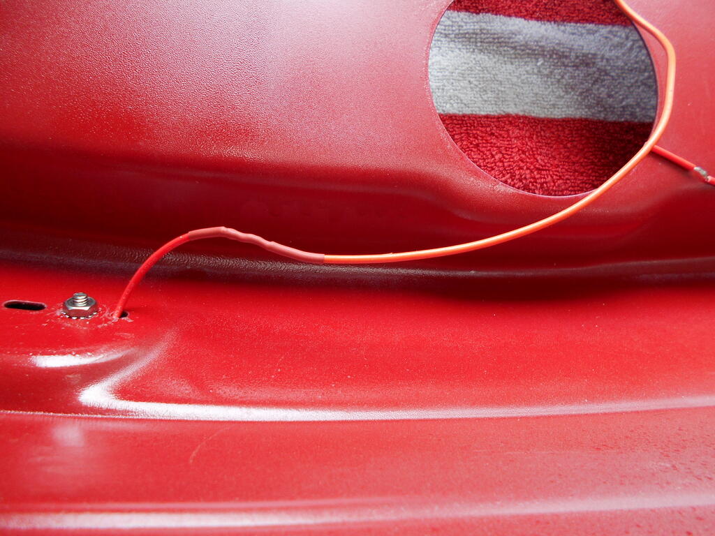

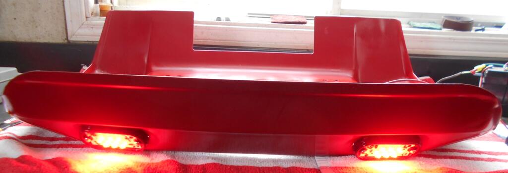

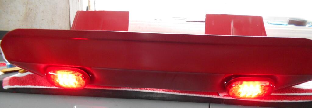

cleat 9,441 #313 Posted January 28 LED tail light ready to be installed. Cover has been removed for assembly. LED tail light showing how wires had to be routed. Wires will pass through the outside set of holes in the fender. Tail light hardware ready to install. Fender ready for tail lights to be installed. Tail lights loosely bolted to fender with wire out through the outside holes in the fender. Tail light ready for ground lug to be soldered on. Tail light ground lug soldered on. Tail light ground lugs heat shrink installed then they were bolted on. All four tail light screws tightened. Tail light wire soldered then heat shrink installed. Tail light wires soldered together and wire installed that plugs into tractor wire harness. Heat shrink installed. Tail lights powered up using a test battery. Tail lights covers installed. 3 3 Share this post Link to post Share on other sites

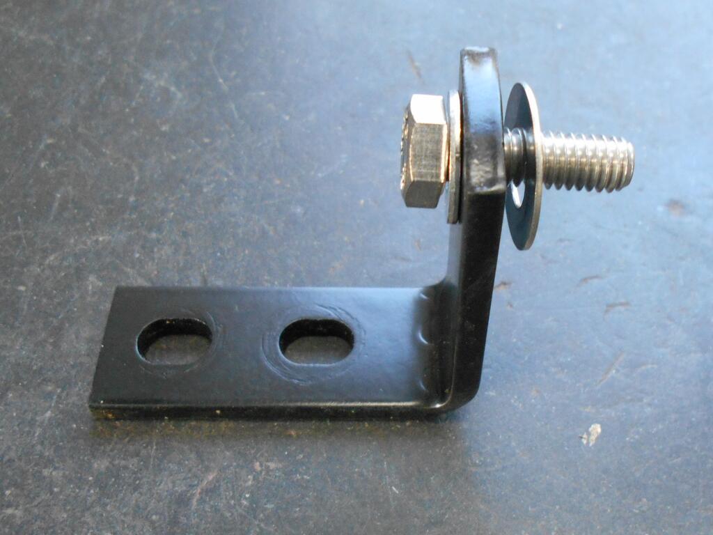

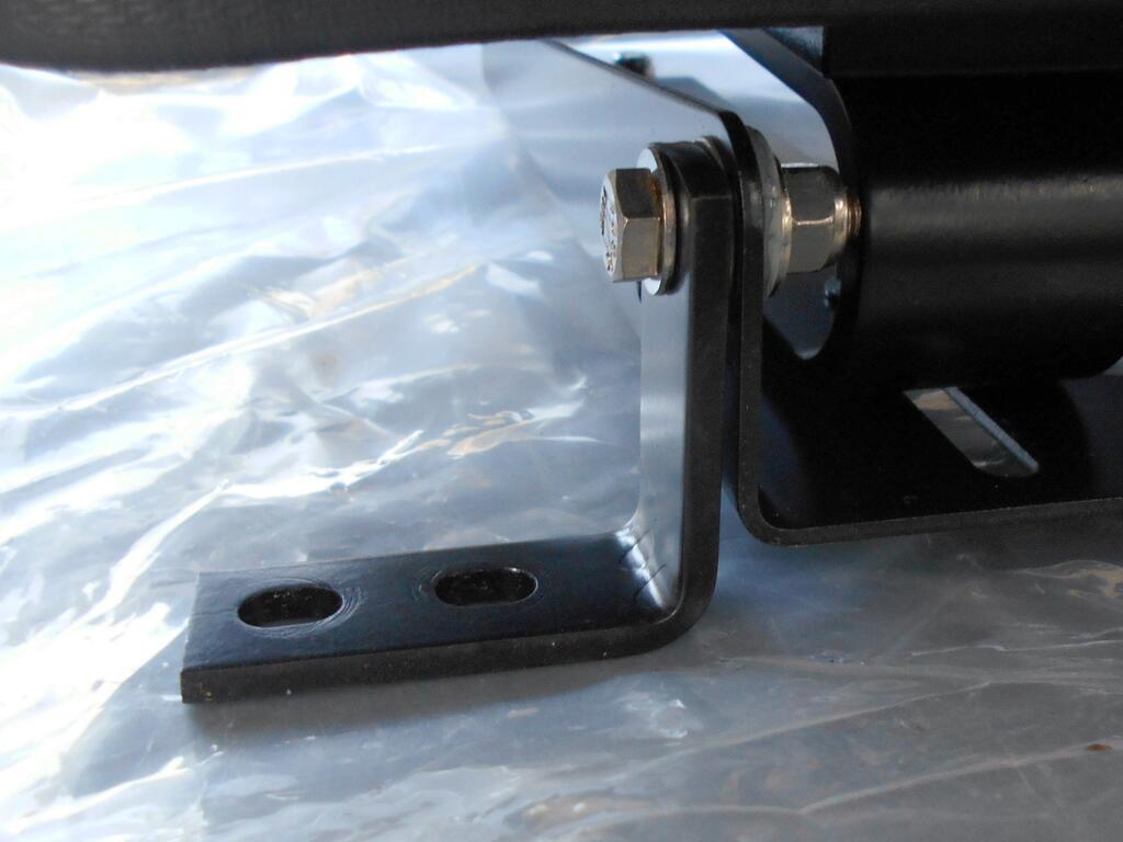

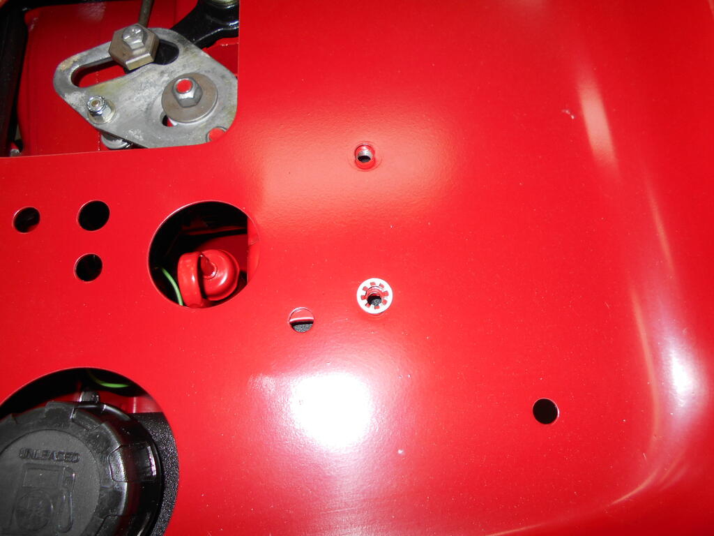

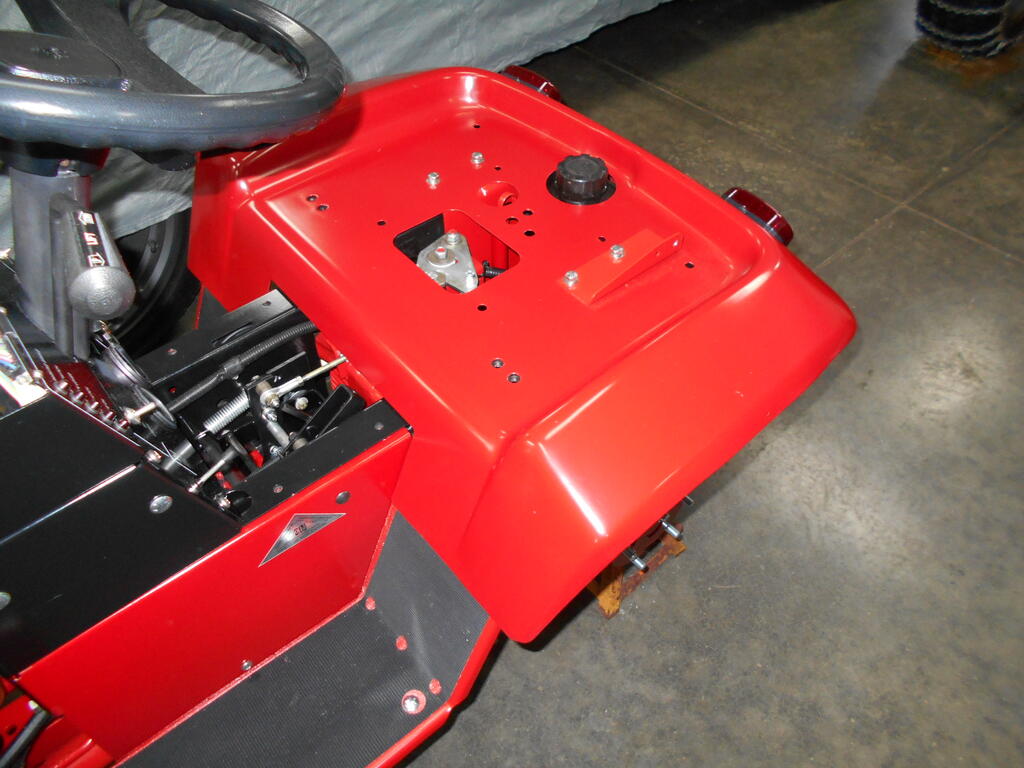

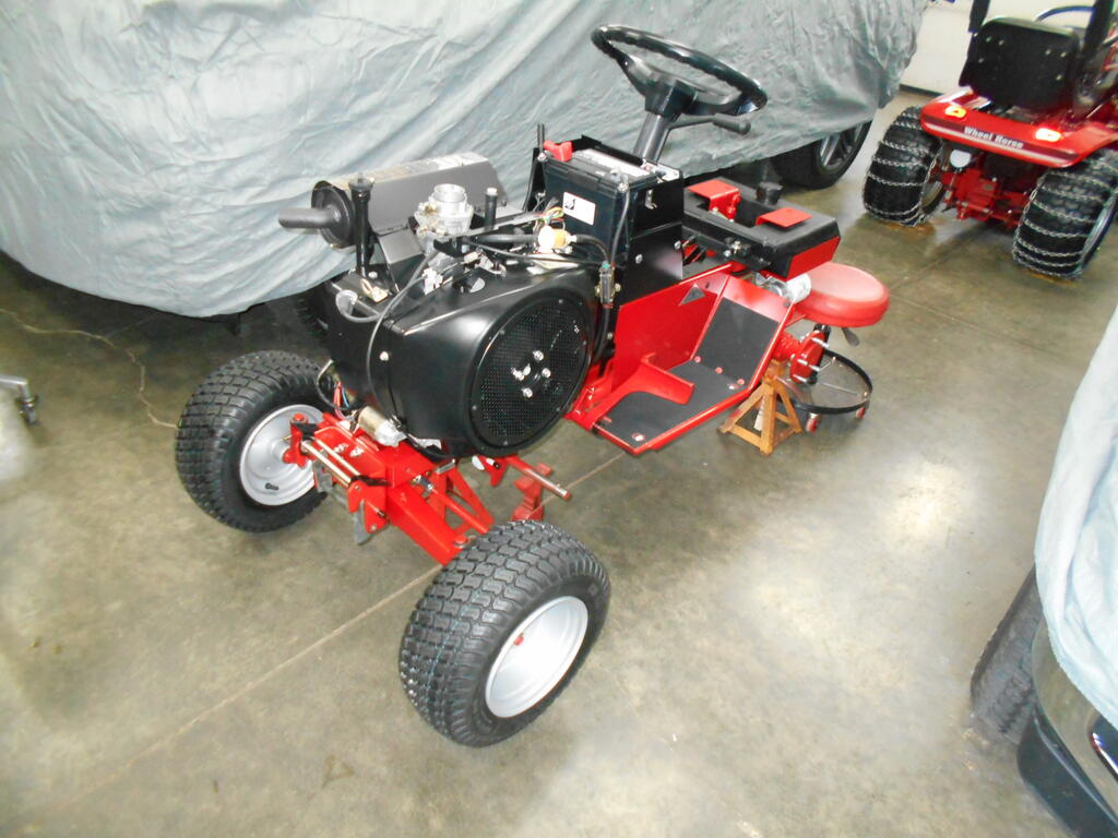

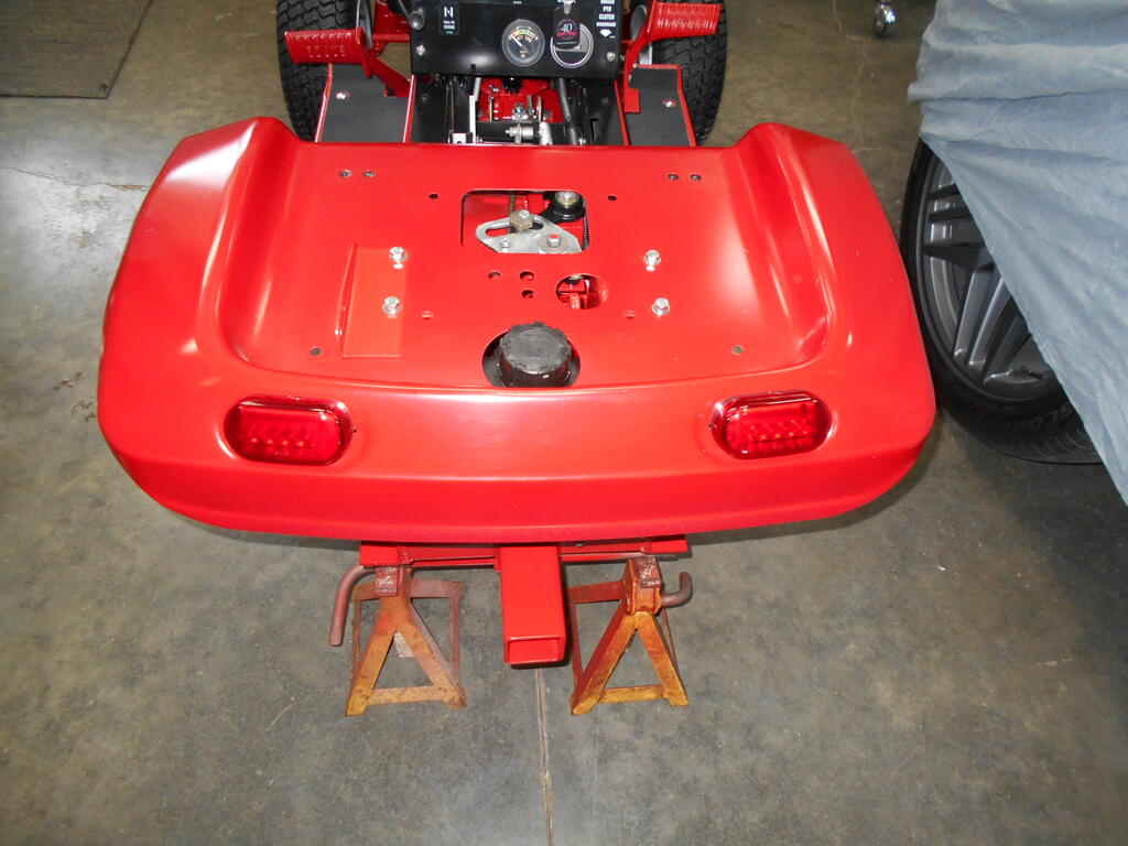

cleat 9,441 #314 Posted January 29 Fender ready to be installed. Fender hardware and seat gas lift bracket ready to be installed. Tractor ready for fender to be installed. Tail light connectors greased. Tail lights plugged in and fender sat in place ensuring no wires are pinched. Seat gas lift bracket loosely installed so fender can still be moved around. Electric tooth washer sat in place to ensure good ground for tail lights. All fender bolts loosely installed. Fender then properly aligned so the seat mount bolt holes and fuel fill locations are lined up. Fender bolts torqued to 120 in/lb. Fender installed. Fender installed tail lights turned on. 7 1 Share this post Link to post Share on other sites

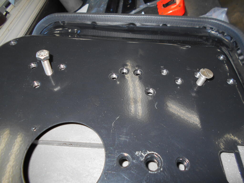

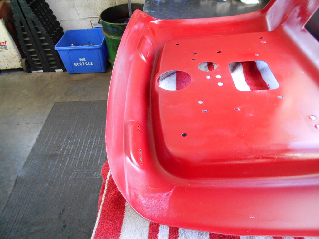

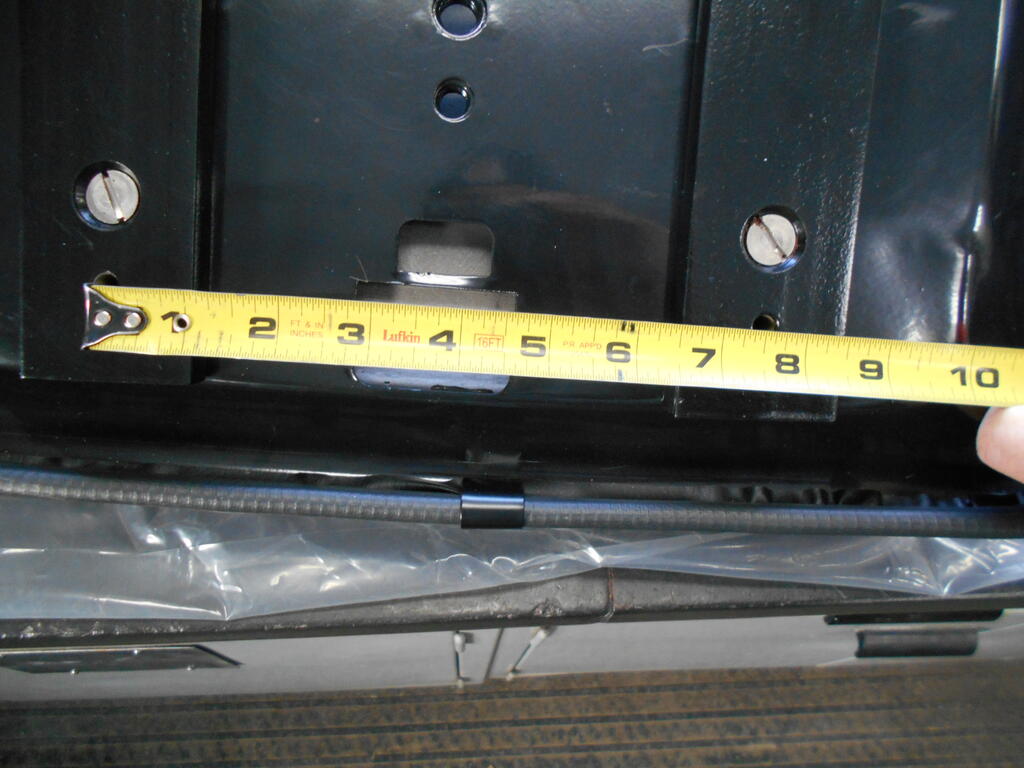

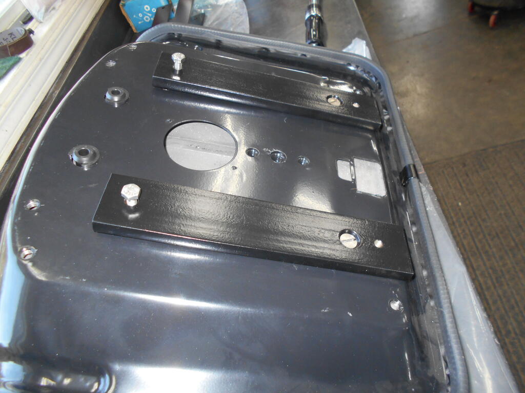

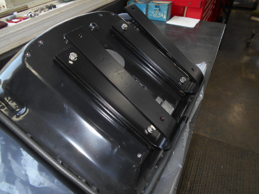

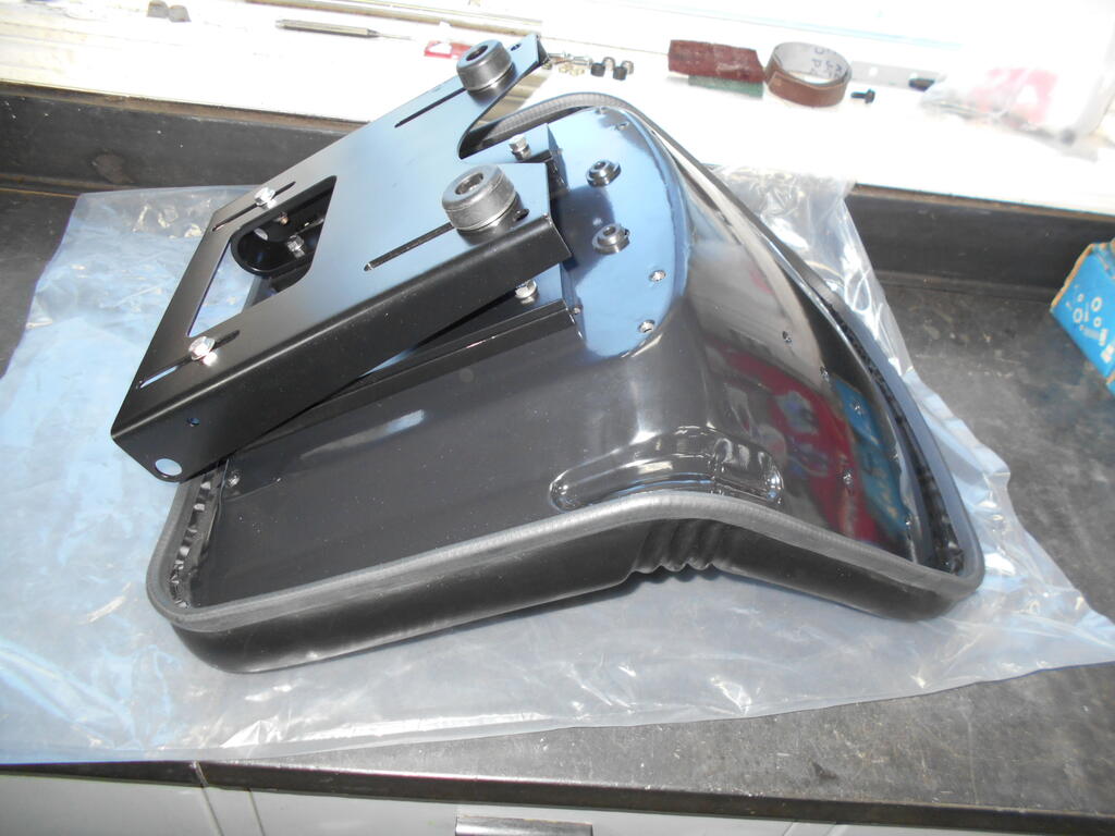

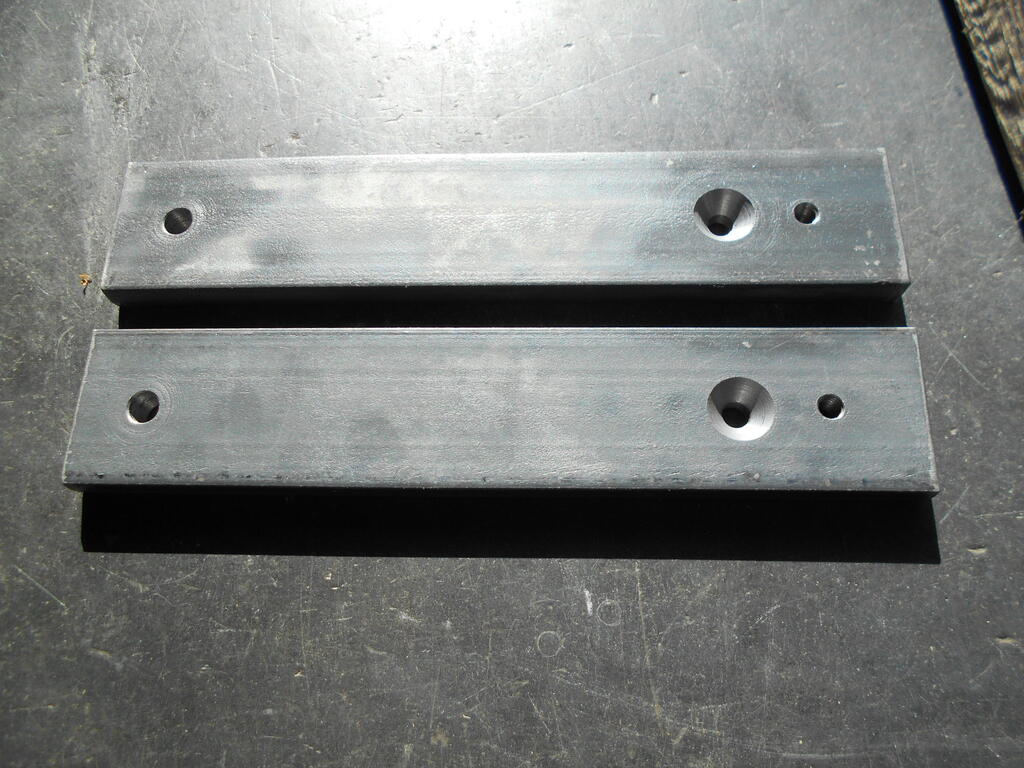

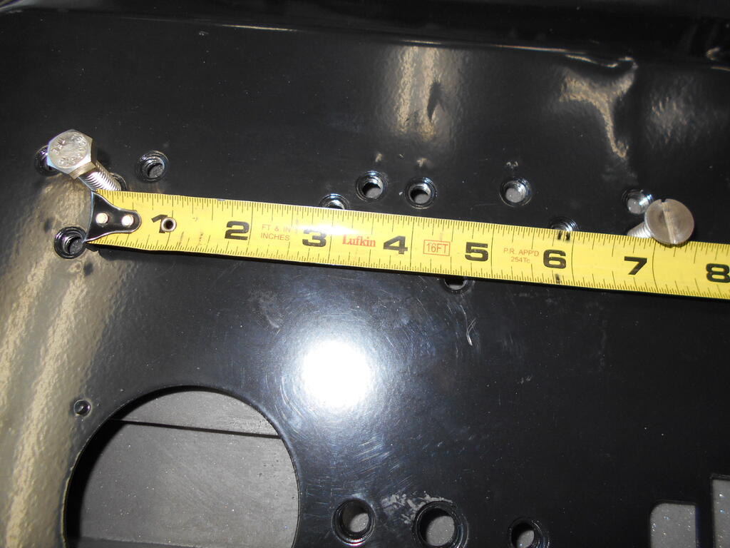

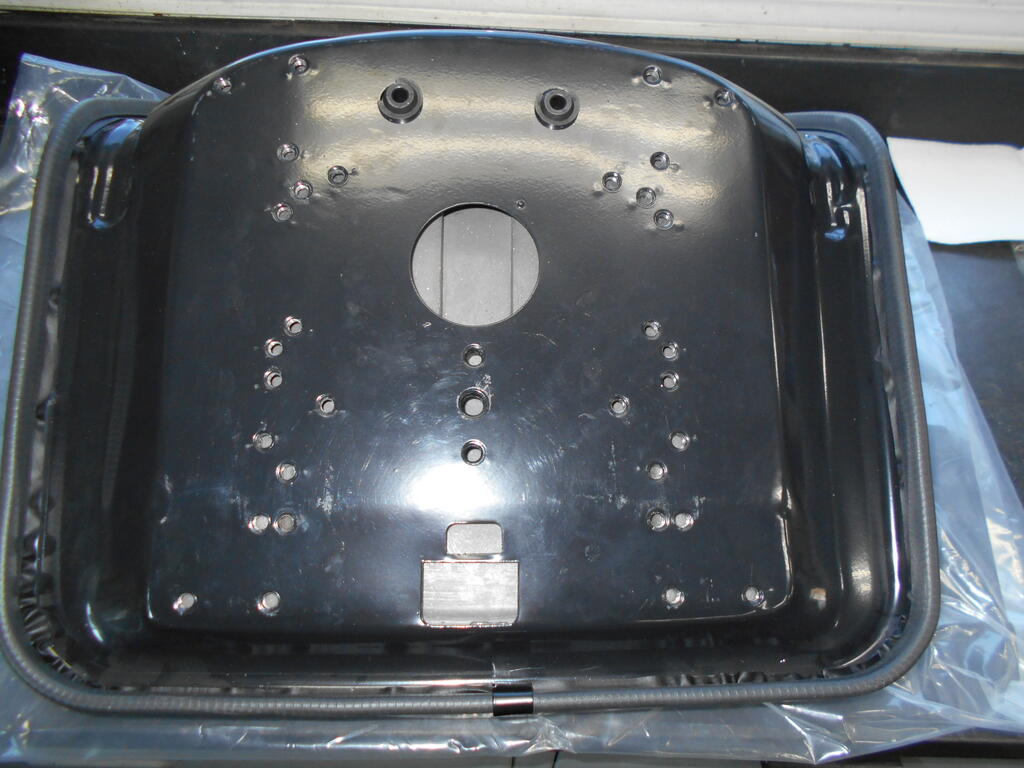

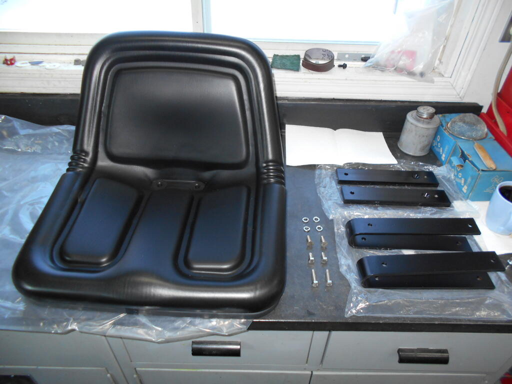

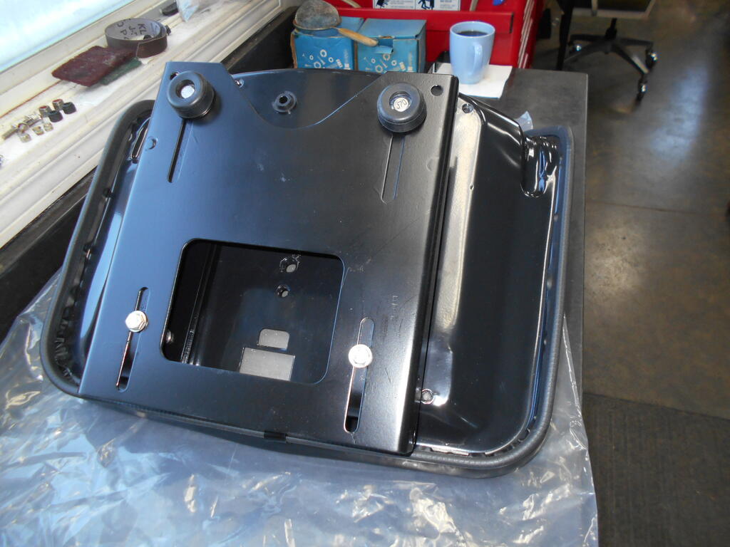

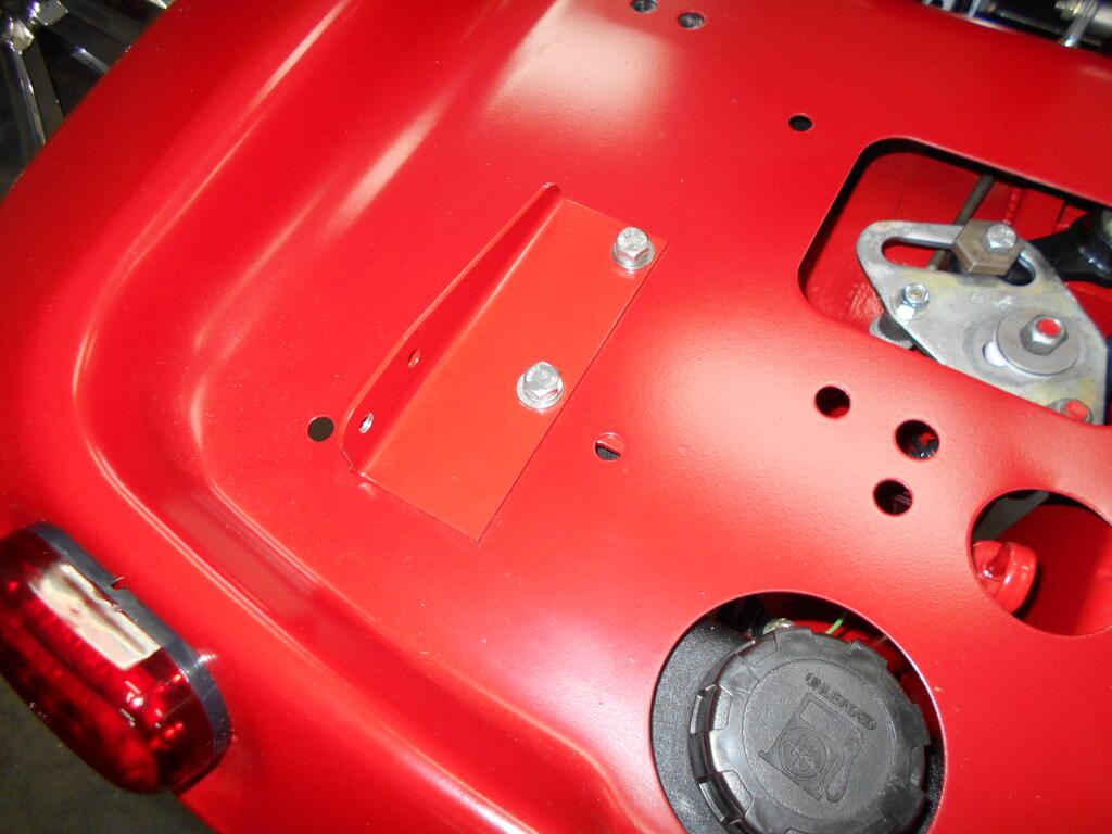

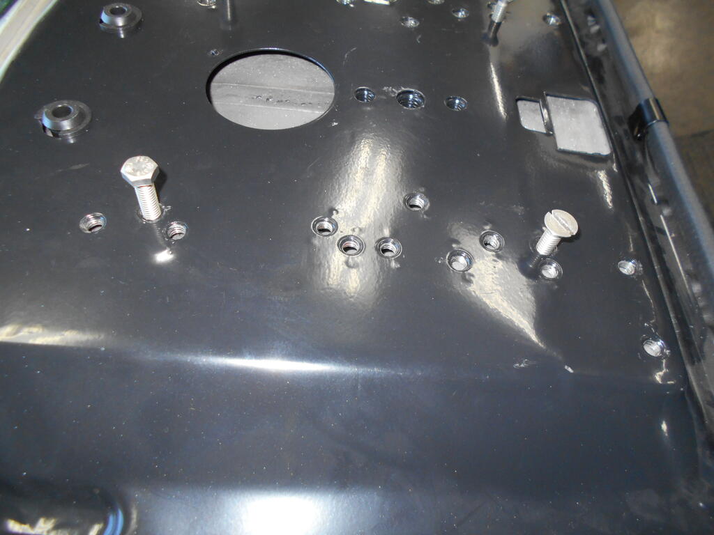

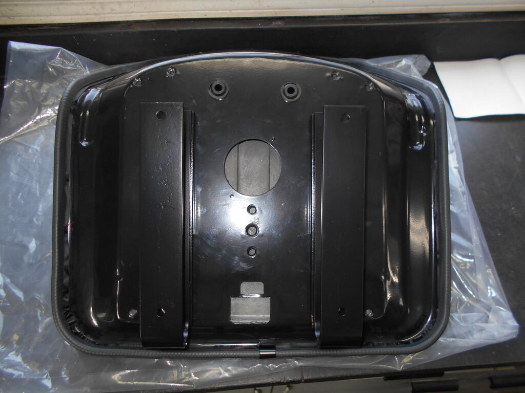

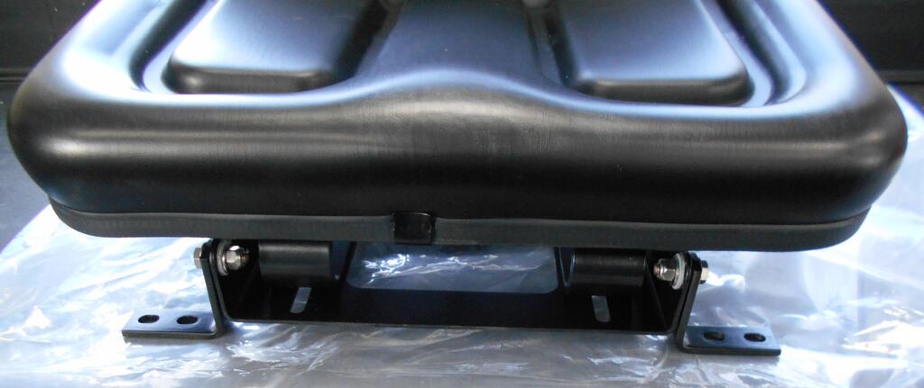

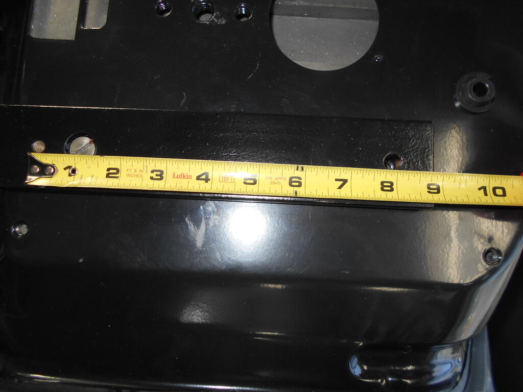

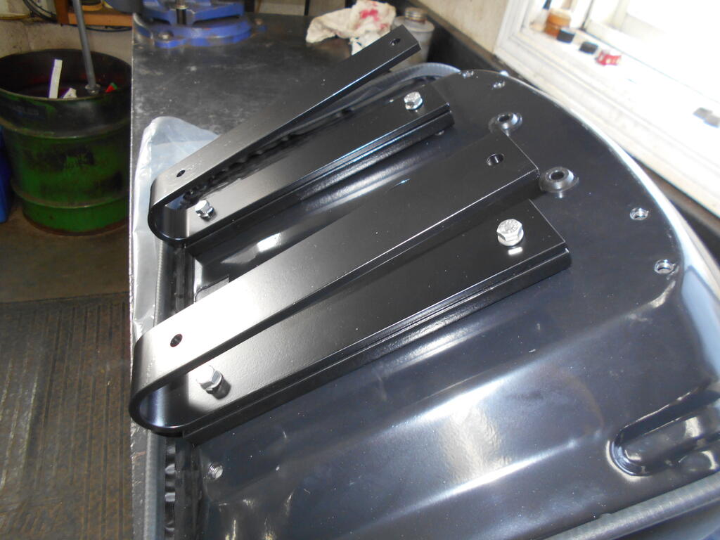

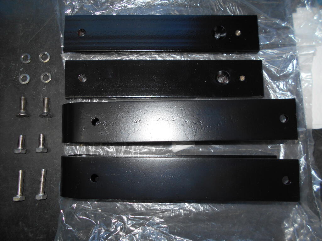

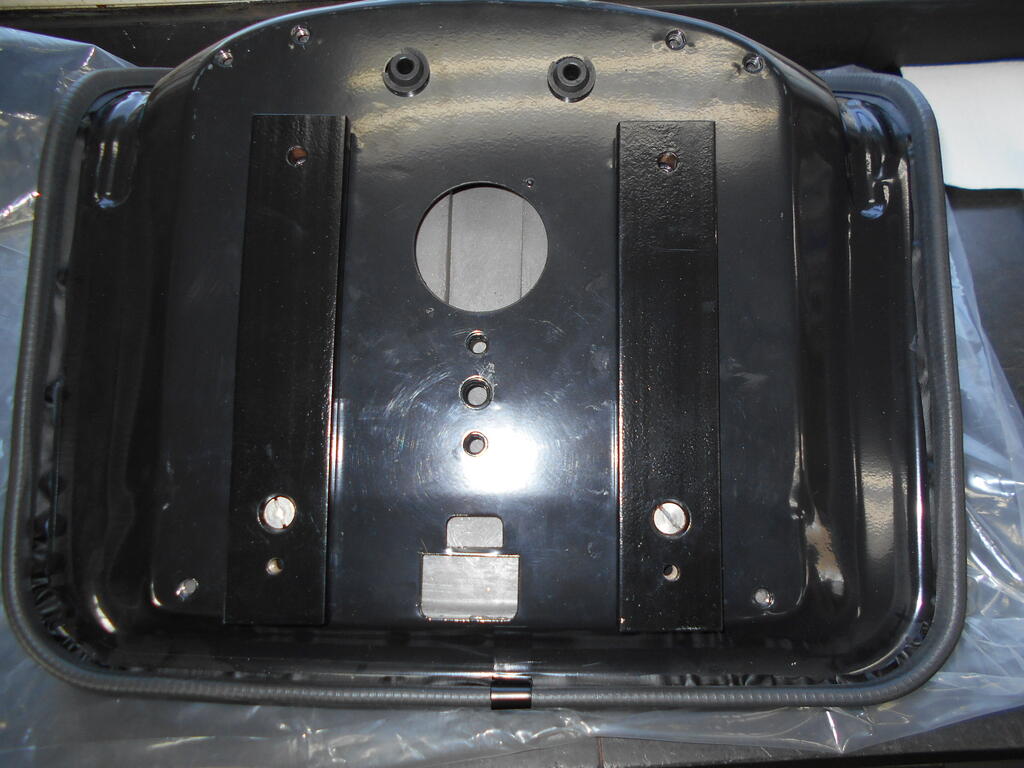

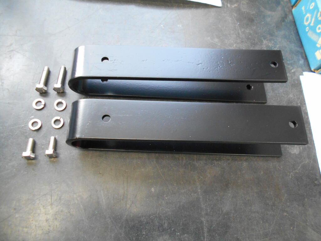

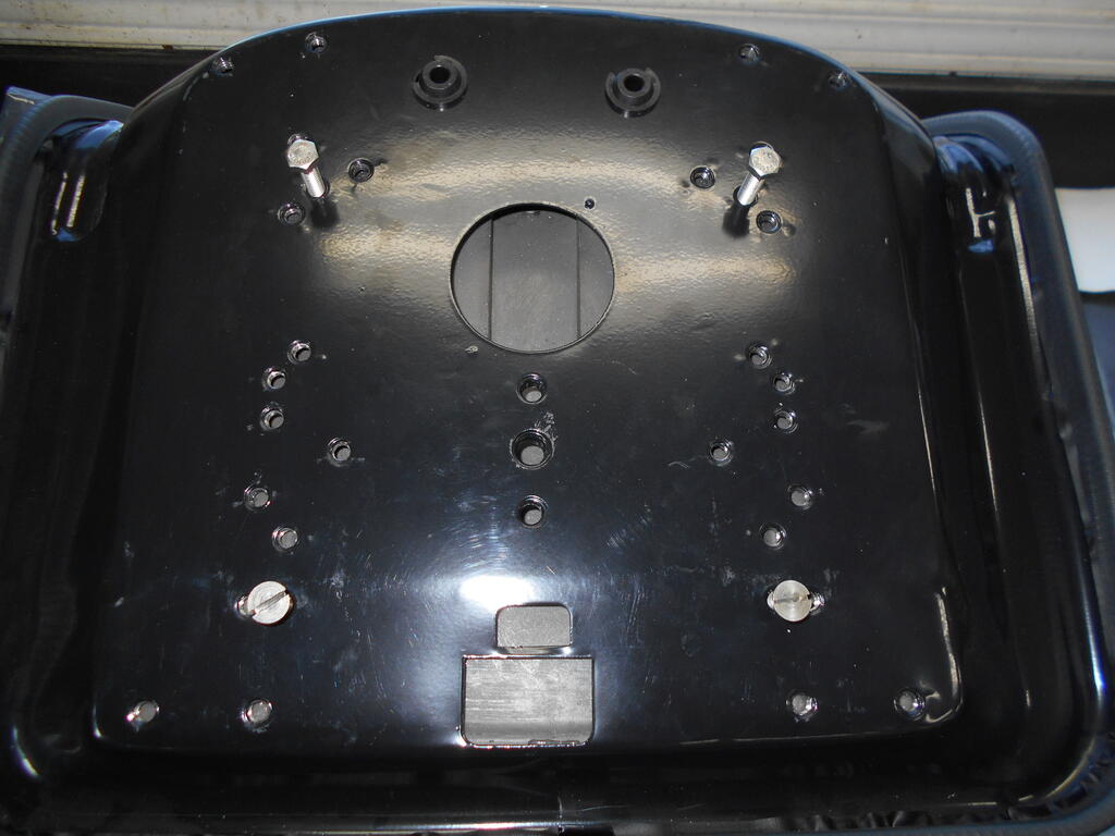

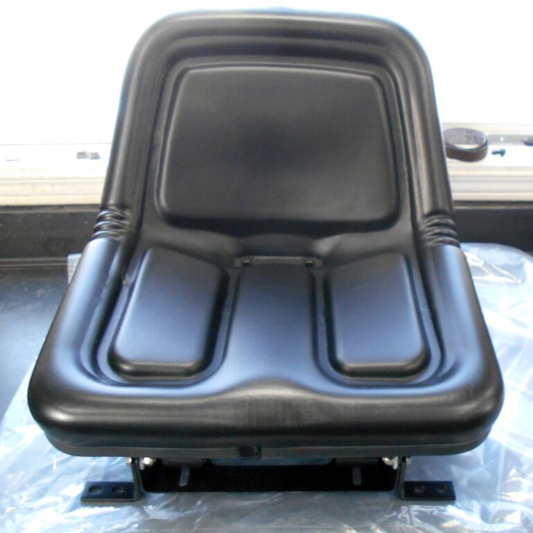

cleat 9,441 #315 Posted January 30 (edited) Seat adapter plates that I made up in order to use the seat that I bought. Here are the plans for the seat adapter plates. seat adaptor plate.pdf Seat, adapter plates, and seat springs ready to assemble. Seat adapter plates and seat springs ready to assemble. Seat bottom showing many mounting points. None the exactly correct 7-1/2" x 8" Closest available is 7-1/2" x 7" Springs have 8 inch bolt spacing. Seat adapter plates loosely installed with upper bolts temporarily installed for alignment. Seat adapter plate flat head screws torqued to 120 in/lb then alignment bolts removed. Torque wrench used to torque flat head screws. With the seat adapter plates we now have the proper 7-1/2" wide by 8" deep mounting points required. Edited January 30 by cleat 2 Share this post Link to post Share on other sites

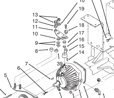

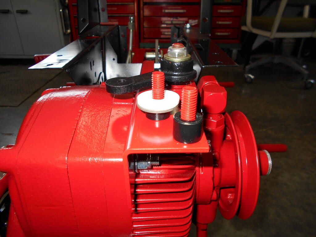

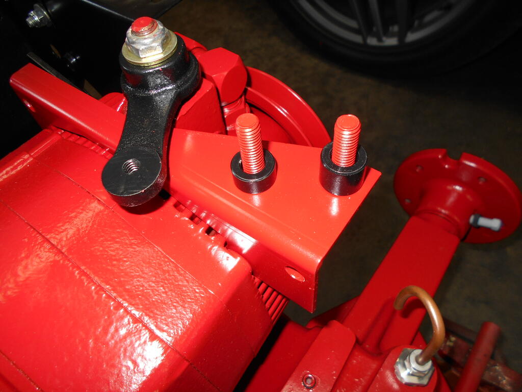

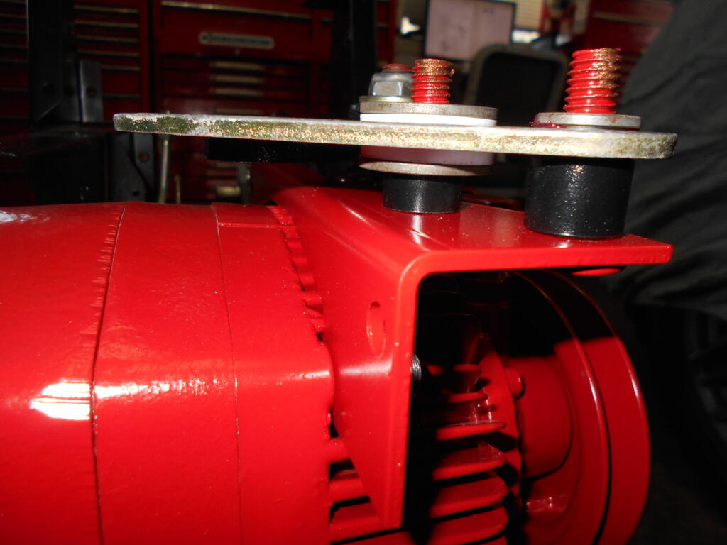

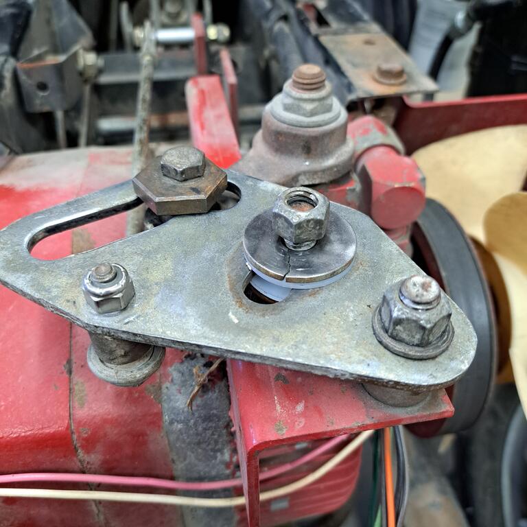

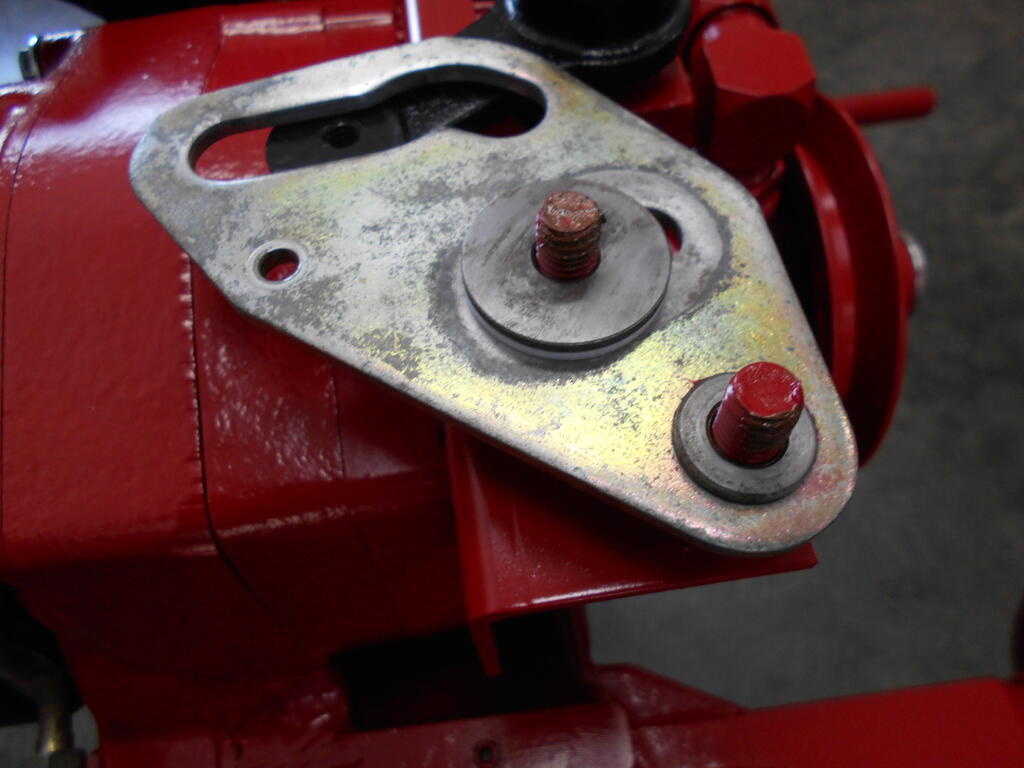

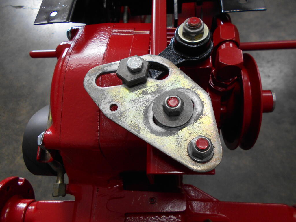

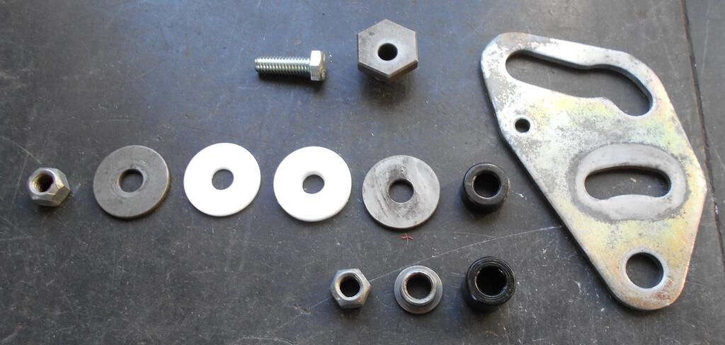

WHX?? 58,387 #316 Posted January 30 (edited) Hate to interrupt this beautiful thread here Cleat but do you have info or pics of how that cam plate is assembled on the hydro? Specifically the tension & friction washers the IPL calls out for? Items 9 & 10. They are missing from the one I am working on. My current plan is to use sandwiched nylon washers and appropriate standard washers. Edited January 30 by WHX?? Share this post Link to post Share on other sites
cleat 9,441 #317 Posted January 30 7 minutes ago, WHX?? said: Hate to interrupt this beautiful thread here Cleat but do you have info or pics of how that cam plate is assembled on the hydro? Specifically the tension & friction washers the IPL calls out for? Items 9 & 10. They are missing from the one I am working on. My current plan is to use sandwiched nylon washers and appropriate standard washers. Are you converting to foot control or keeping the motion control as stock ? Share this post Link to post Share on other sites

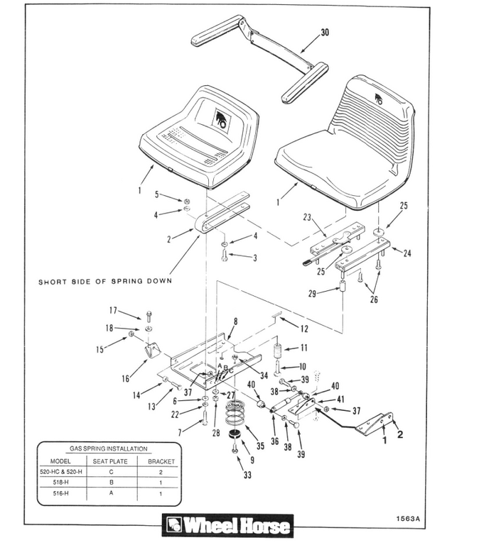

cleat 9,441 #318 Posted January 30 Springs ready to install to seat. Parts manual calls for the seat springs to be installed short side down so therefor the long side is to be on the seat side. Springs loosely installed short side down to seat as per manual. 4 Share this post Link to post Share on other sites
WHX?? 58,387 #319 Posted January 30 17 minutes ago, cleat said: Are you converting to foot control It has a Matt's pedal kit. It has a not going fully into reverse issue which I'm sure is linkage adjustment problem but as long as it's apart I'm freshening up the cam plate hardware. 1 Share this post Link to post Share on other sites

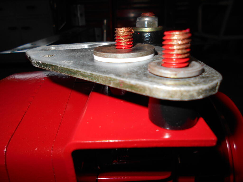

cleat 9,441 #320 Posted January 30 (edited) 12 hours ago, WHX?? said: It has a Matt's pedal kit. It has a not going fully into reverse issue which I'm sure is linkage adjustment problem but as long as it's apart I'm freshening up the cam plate hardware. Here are all the parts I use. I discard the two tension washers and add two Teflon washers instead. Here are the two spacers installed with the shorter one forward. I then slide on a friction washer and a 1/8" Teflon washer punched with a 3/8 inner hole and an outer diameter the same as the washer. Then the cam plate gets installed. Then a 1/16" Teflon washer is slid on and the other tension washer. Then the cam pivot bushing is installed and the nut tightened on that. Then the lock nut is installed on the stud where the washers are. Tighten this nut until play is removed from the cam plate but it can still pivot side to side easily with no resistance. Then you can install the eccentric cam and set that as per the manual. Edited January 31 by cleat 4 1 Share this post Link to post Share on other sites
WHX?? 58,387 #321 Posted January 30 (edited) Thank you Cleat. Pretty much what I have done but nylon washers. Will look for Teflon ones. One of what i believe to be the tension washer was cracked. Was wondering if one should use a wave or belleville washer. I belive it was a belleville that was OEM. One last question to lubricate the moving parts or not? Maybe some sort of dry graphite? I think I read in a manual no lubricant. Edited January 30 by WHX?? 2 Share this post Link to post Share on other sites
cleat 9,441 #322 Posted January 30 1 hour ago, WHX?? said: Thank you Cleat. Pretty much what I have done but nylon washers. Will look for Teflon ones. One of what i believe to be the tension washer was cracked. Was wondering if one should use a wave or belleville washer. I belive it was a belleville that was OEM. One last question to lubricate the moving parts or not? Maybe some sort of dry graphite? I think I read in a manual no lubricant. The tension washers can be eliminated with Matt's foot control as you don't want any tension whatsoever. I used Teflon because I have the material here and punch them out. Nylon would be basically the same function. No lube should be needed. 2 1 Share this post Link to post Share on other sites

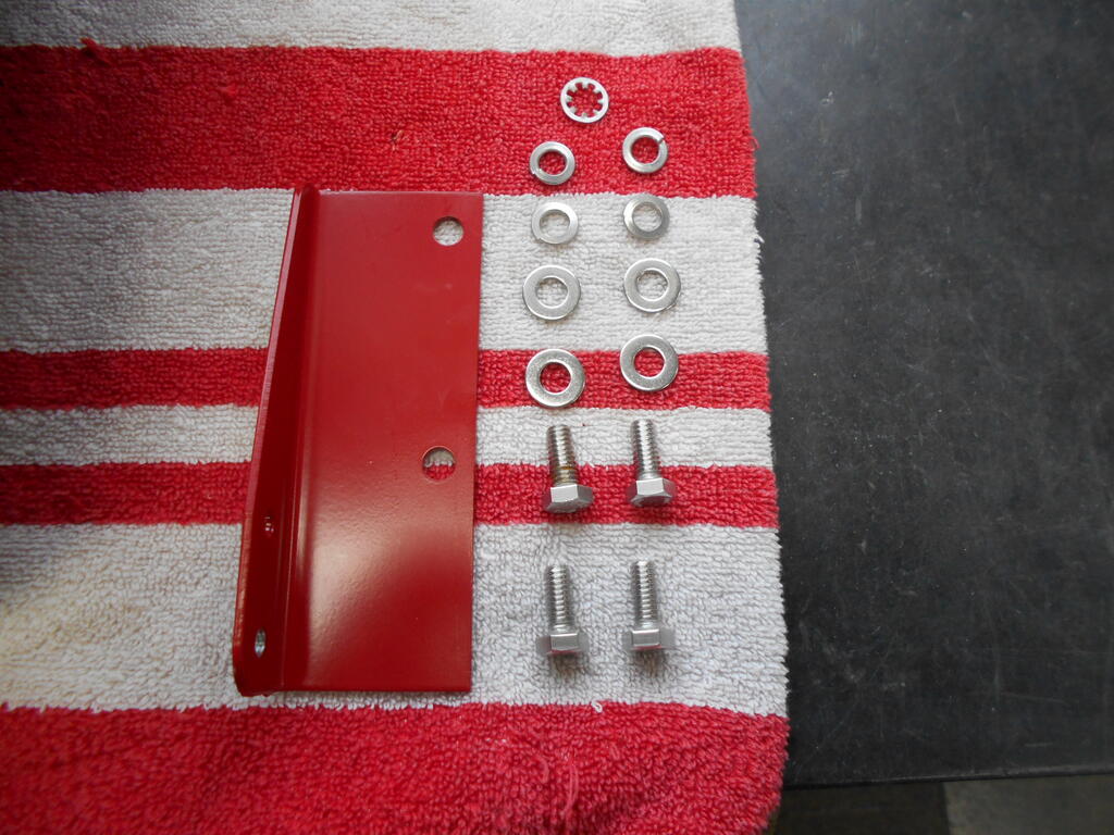

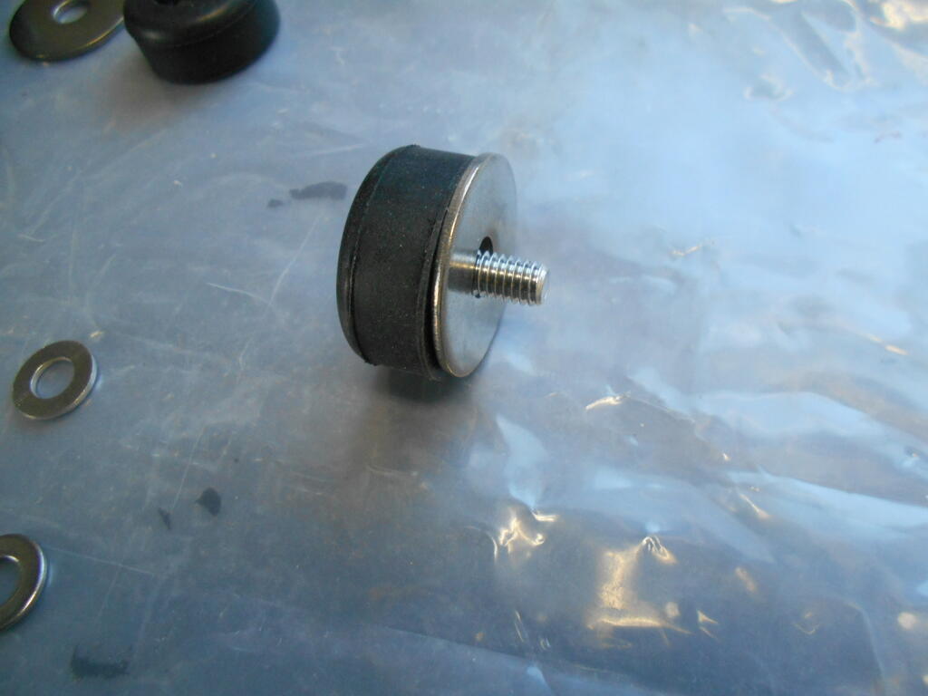

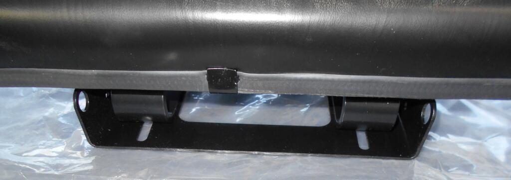

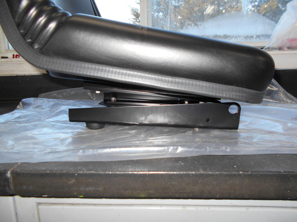

cleat 9,441 #323 Posted January 31 Seat pivot plate ready to bolt to seat assembly. Seat bumper, fender washer, and bolt ready to install. Seat pivot plate bolted to seat assembly. All 8 bolts tightened. I have the seat set to full rearward position. 3 Share this post Link to post Share on other sites

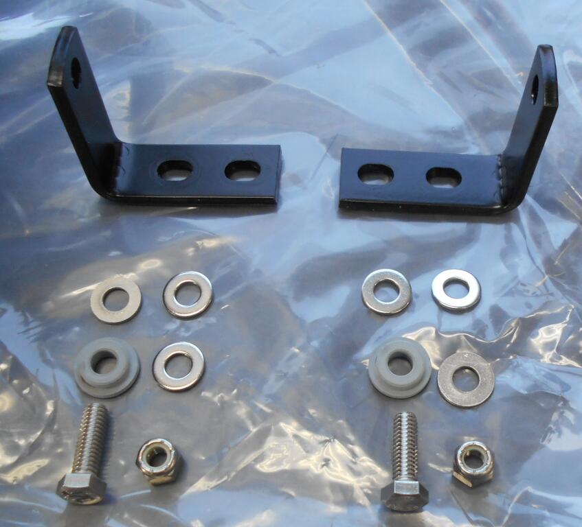

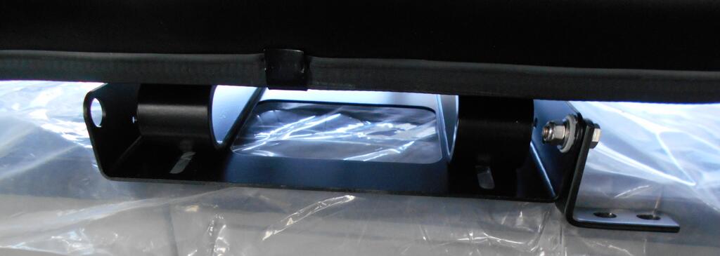

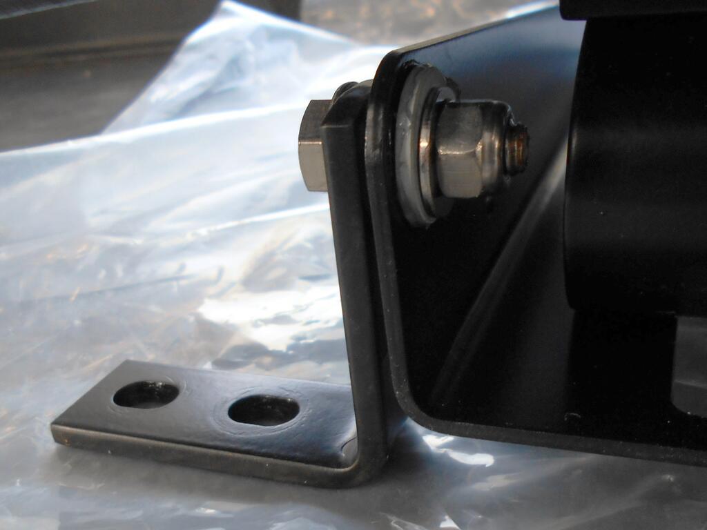

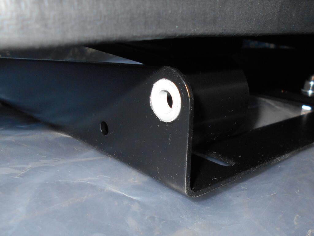

cleat 9,441 #324 Posted January 31 (edited) Seat pivot brackets and bushings ready to install. Seat pivot plate ready for pivot brackets to be installed. Seat pivot bracket with bolt and washers slid on. I add a washer to the inside to space the bracket out slightly so it does not rub on the pivot plate. Seat pivot bracket bushing greased with silicone grease and installed into pivot plate. Right seat pivot bracket and bushing installed. Left seat pivot bracket and bushing installed. Seat pivot bracket bolts torqued to 200 in/lb. Edited January 31 by cleat 6 Share this post Link to post Share on other sites

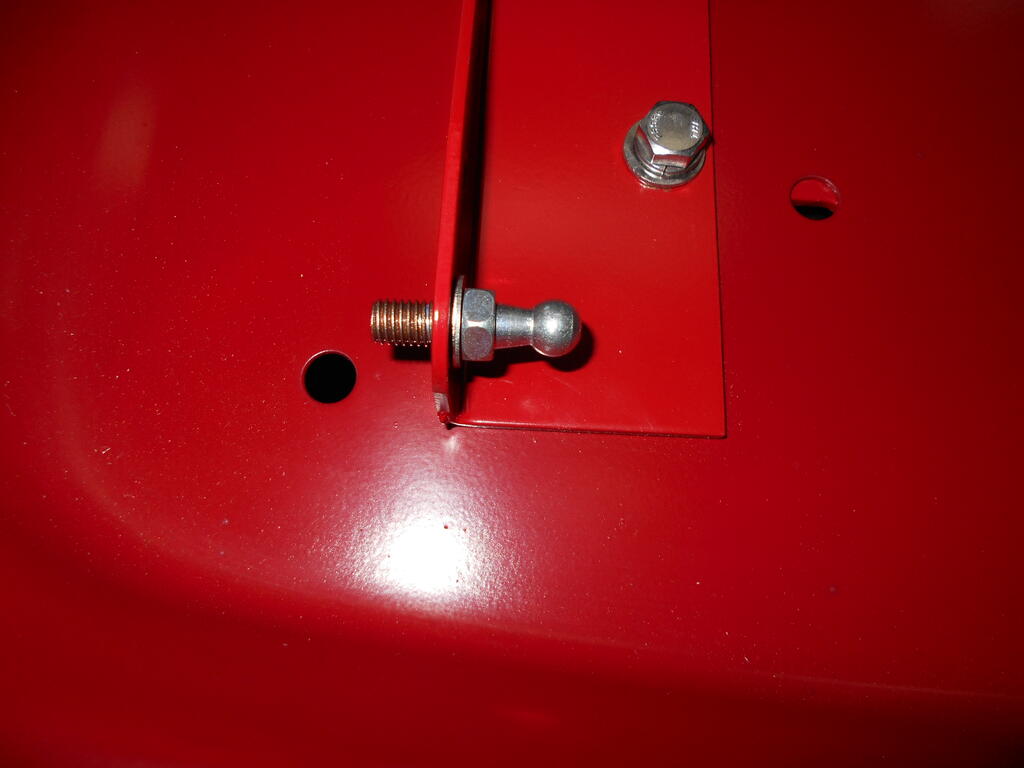

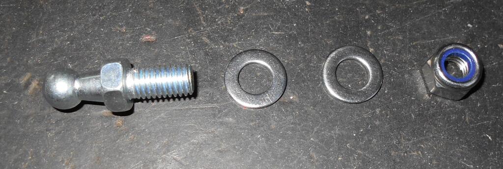

cleat 9,441 #325 Posted February 1 (edited) Seat gas lift ball ready to be installed. Tractor ready for seat gas lift ball to be installed. Seat gas lift ball screwed into bracket that was previously tapped M8 x 1.25. Lift ball tightened into bracket. Seat gas lift ball nut installed and tightened. Edited February 1 by cleat 2 Share this post Link to post Share on other sites
