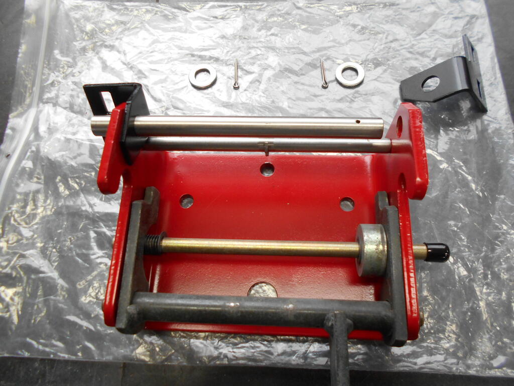

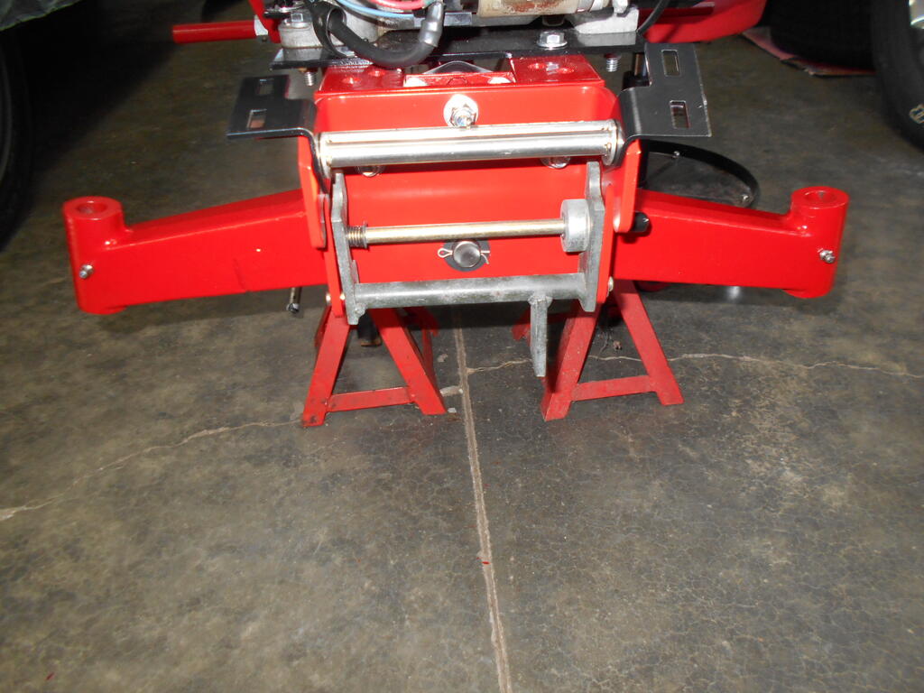

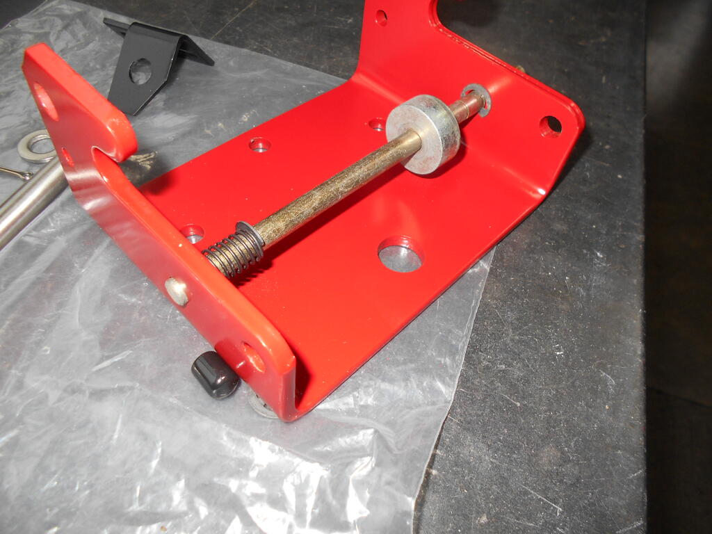

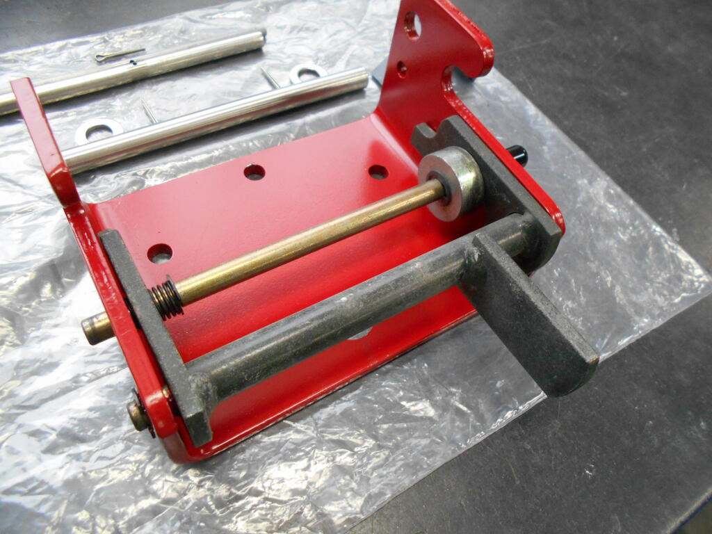

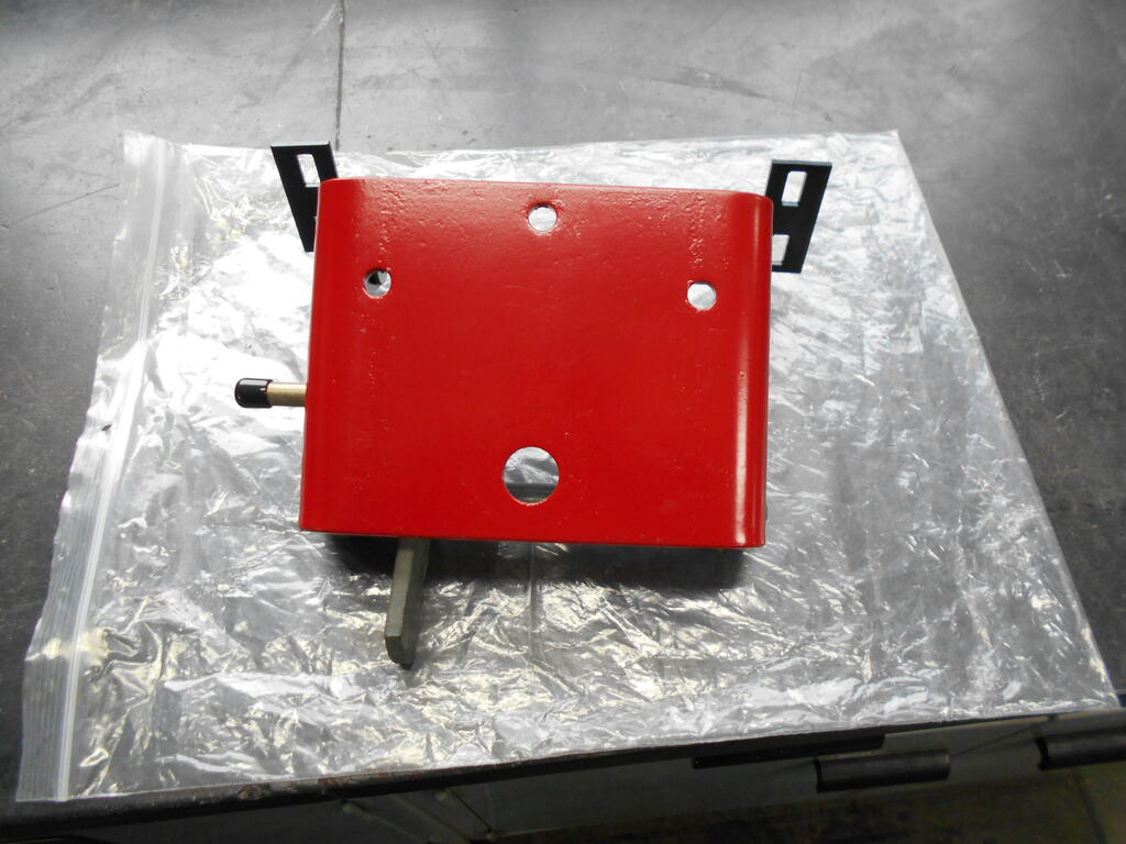

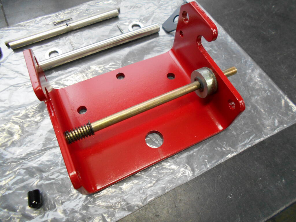

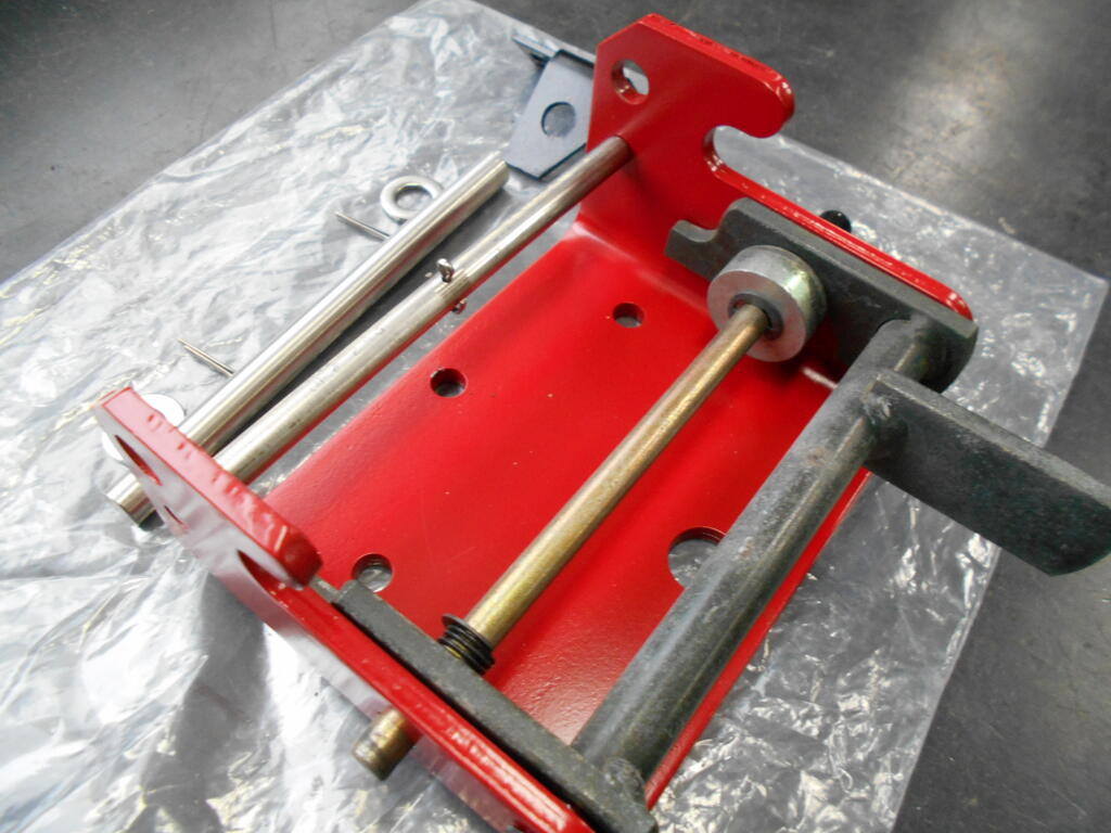

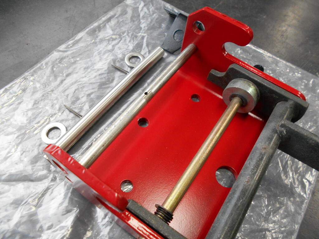

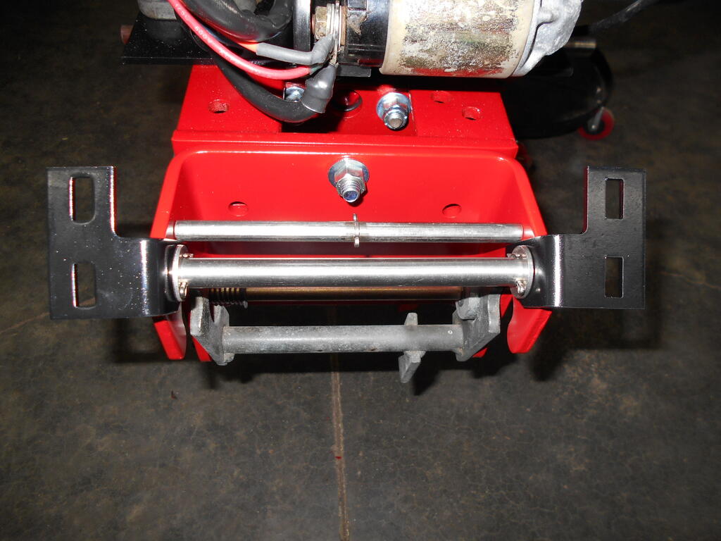

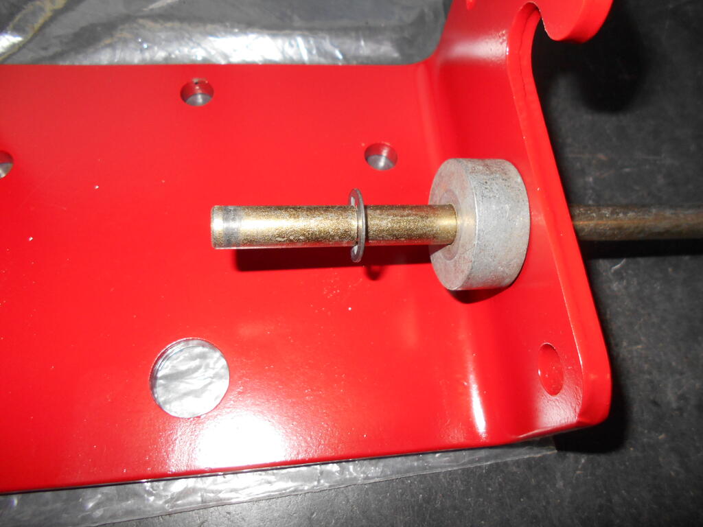

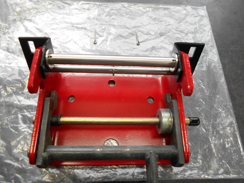

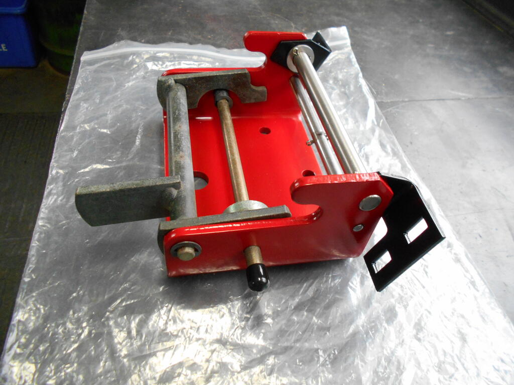

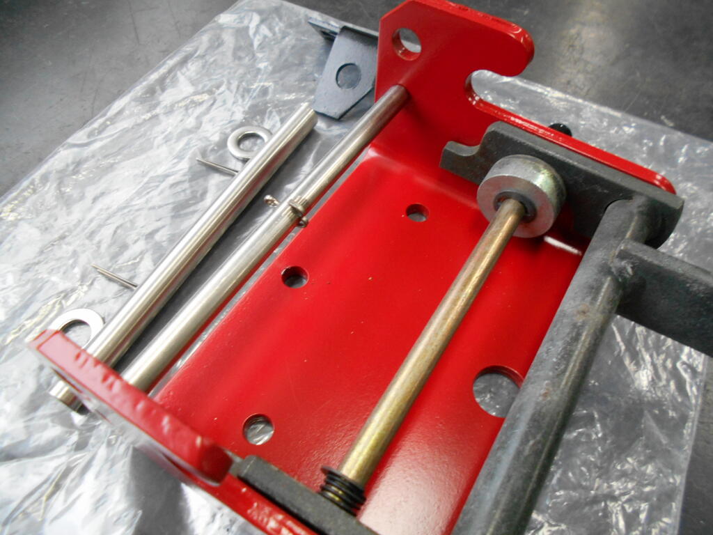

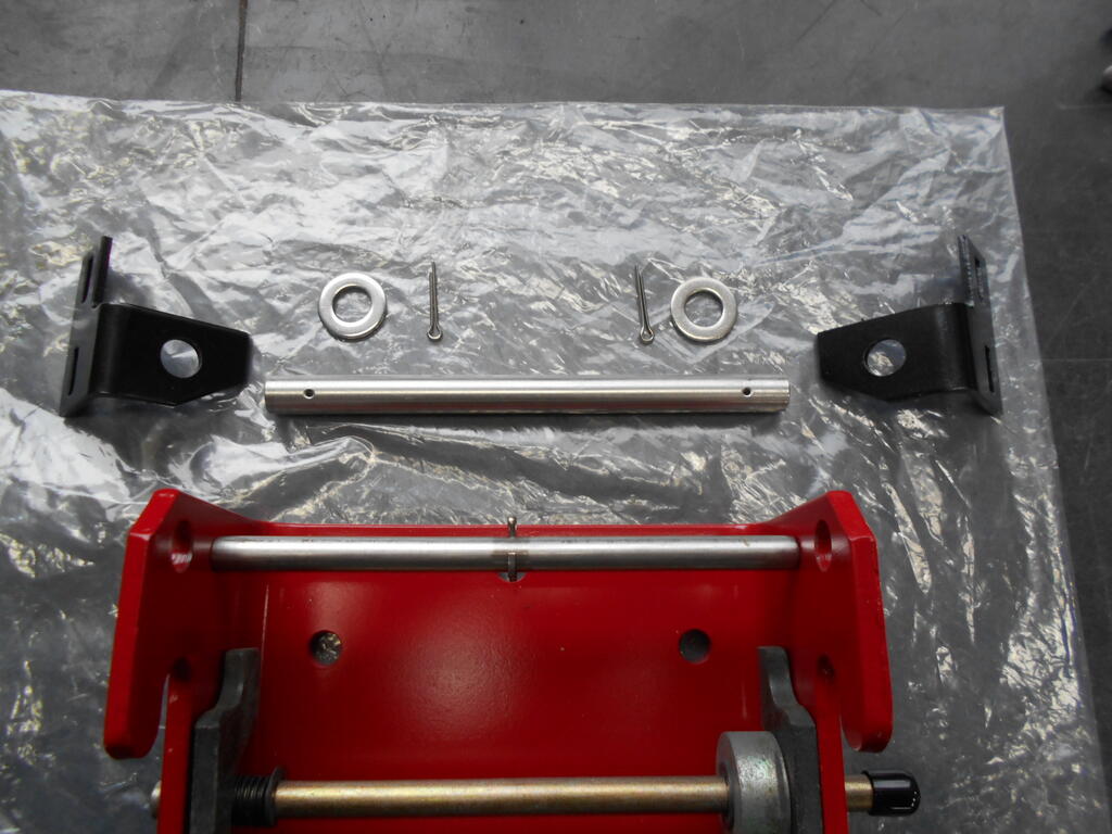

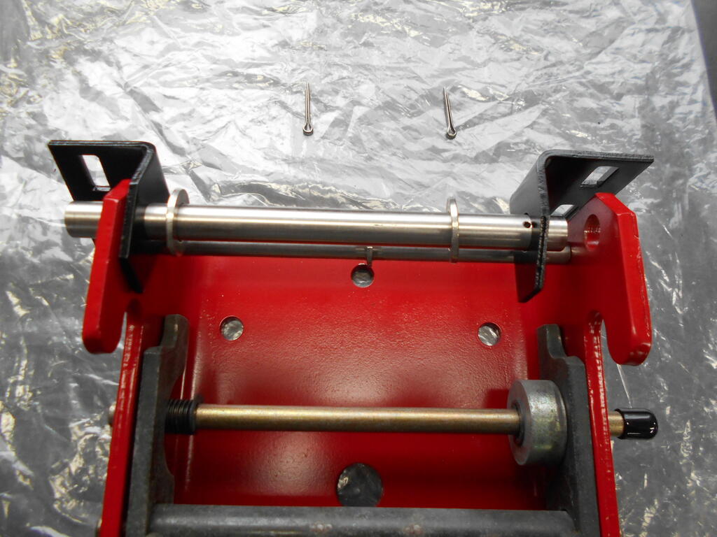

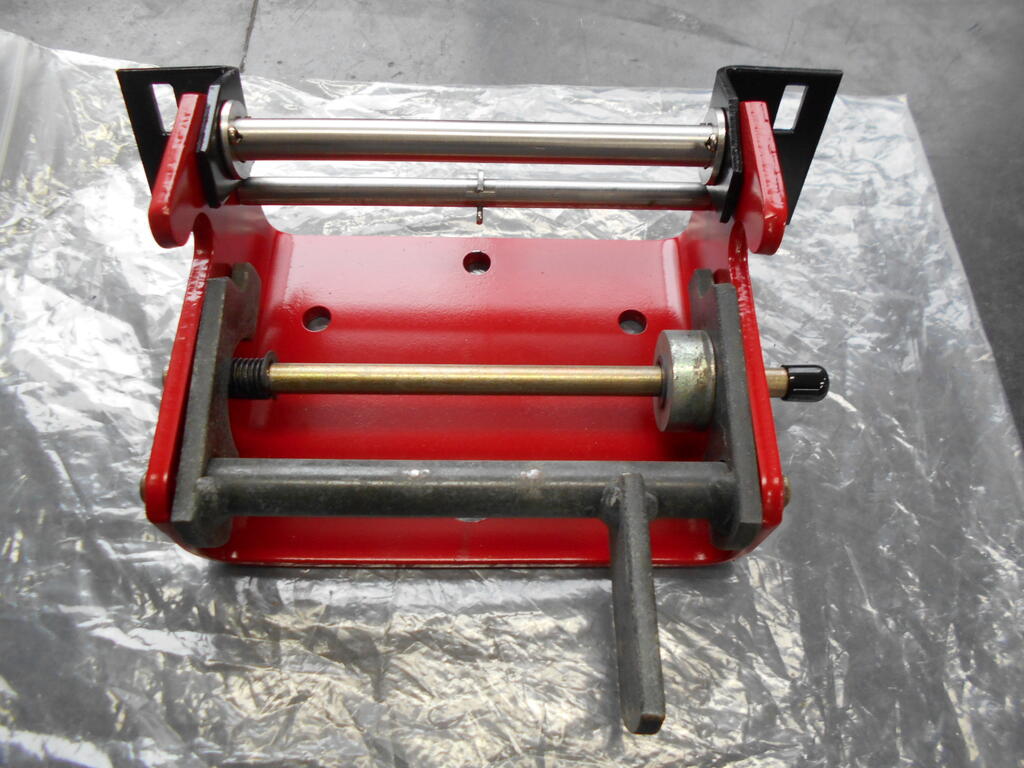

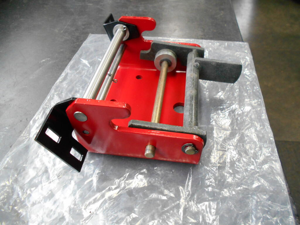

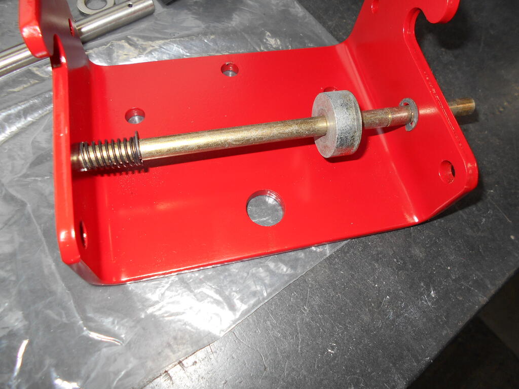

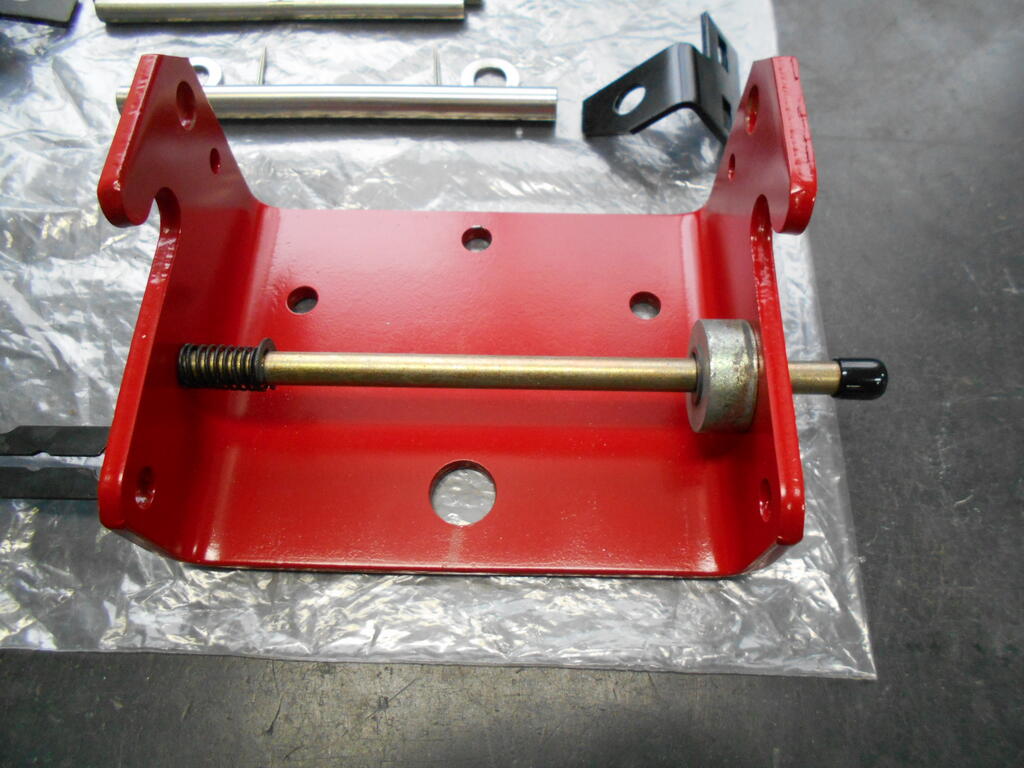

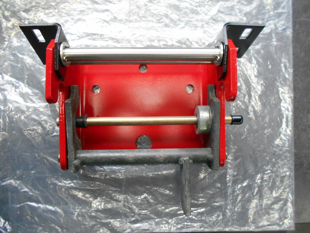

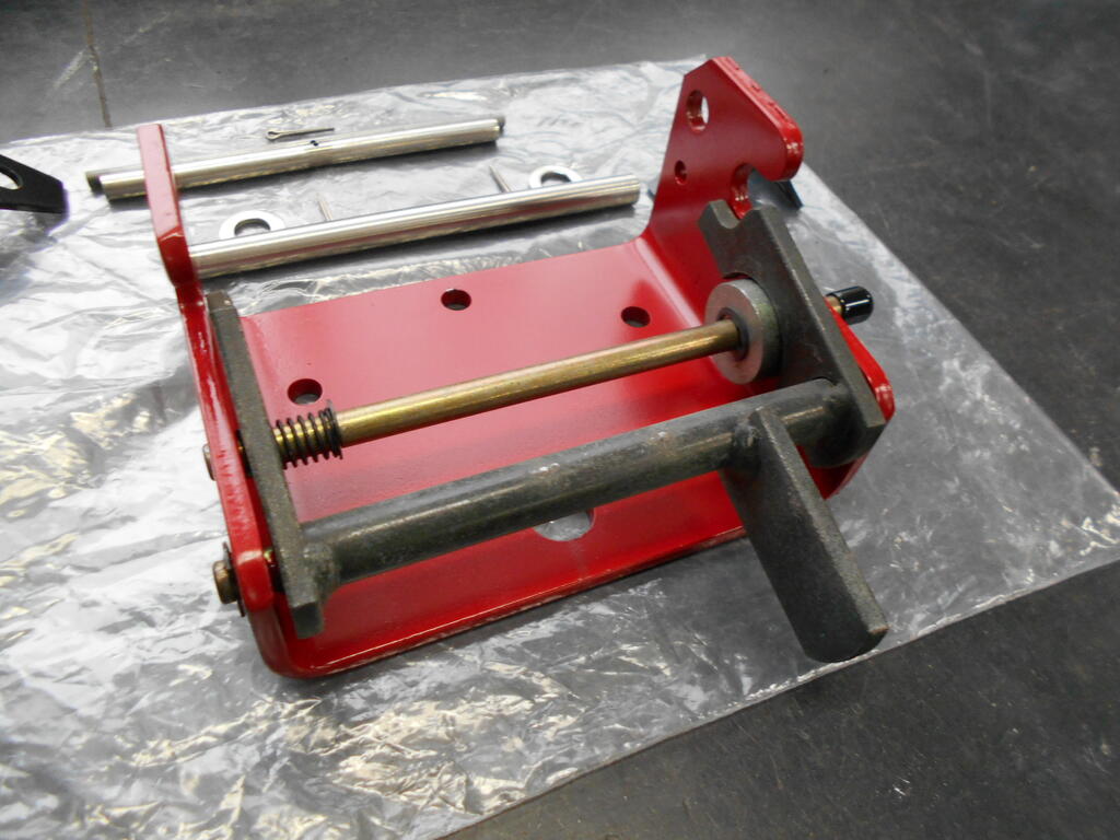

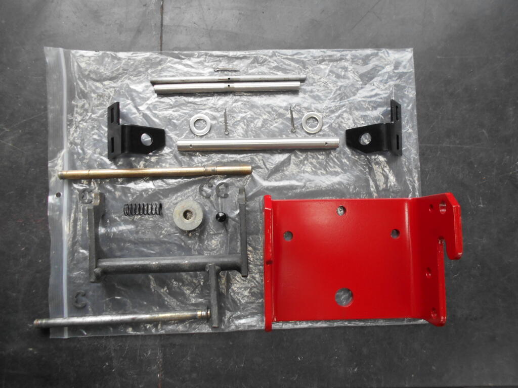

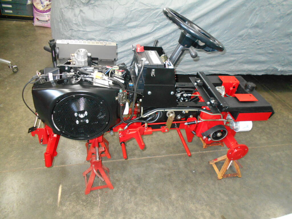

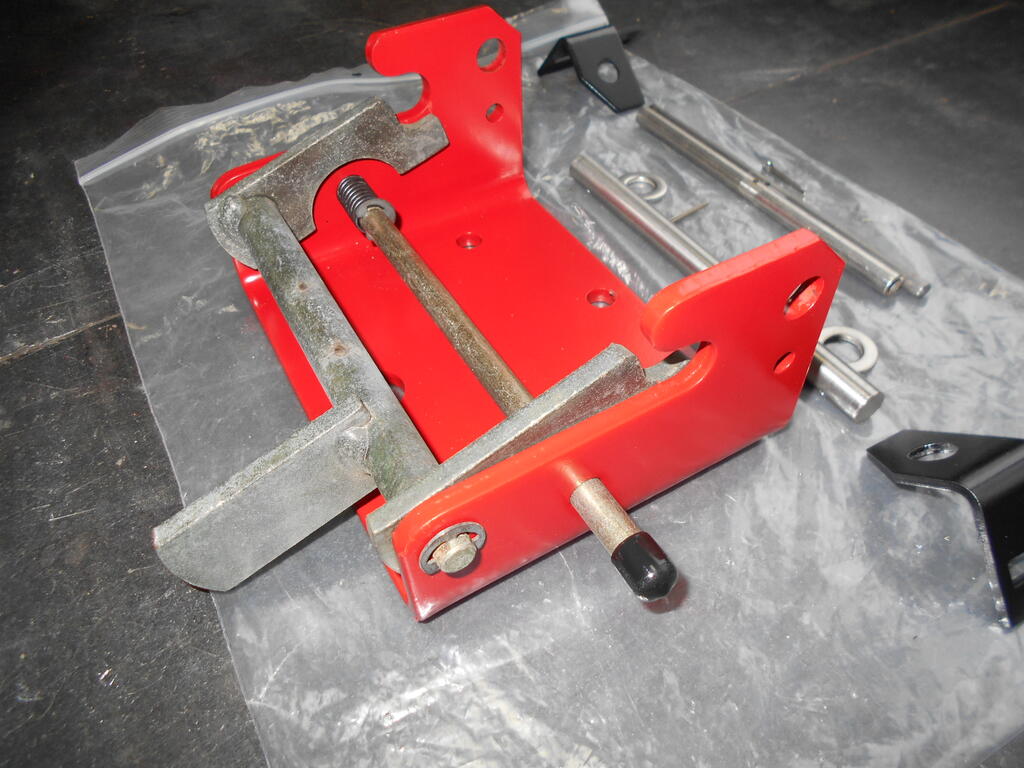

cleat 9,441 #276 Posted January 14 (edited) Front tach and hood pivot ready for assembly. Front tach lock assembly ready to install. Front tach lock and shaft partly inserted then E clip installed. Front tach lock spring slid onto shaft then shaft full inserted and E clip installed on opposite end from spring. Front tach lock slid over on shaft then the final E clip installed. Front tach lock release grip installed. Front tach latch assembly ready to install. Front tach latch pin has one E clip installed and is greased. Front tach latch pin slid into place and second E clip is installed. Latch shown in open position. Hood stop rod of my own design ready to install. I think Wheel Horse dropped the ball a bit on this design as the cotter pins get hit by the hood brackets. I use a solid 1/4" rod (you could use the original for this) slid into a piece of 3/8" tubing that has one hole drilled through to accept a cotter pin that holds everything together. Mine are all stainless steel but that is not required. Hood stop rod installed ready for cotter pin. Hood stop rod fully installed. Hood pivot assembly ready to install. There was some wear in the original rod and pivot brackets so I drilled the brackets and housing to 1/2" I then made up a 1/2" rod with holes drilled to accept cotter pins. Hood pivot shaft partly inserted and Right pivot bracket slid onto shaft. Hood pivot shaft partly inserted and both pivot brackets and washers slid onto shaft. Hood pivot shaft fully inserted and pivot brackets and washers slid into place on shaft. Hood pivot cotter pins installed. Front tach and hood pivot assembled. This is the tool I use to install the E clips. Edited January 14 by cleat 2 7 Share this post Link to post Share on other sites
ebinmaine 81,273 #277 Posted January 14 @jsoluna That post is THE definitive reference for your front tach o matic. 1 1 1 Share this post Link to post Share on other sites

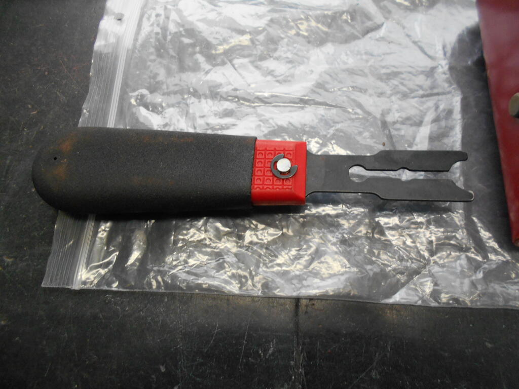

ebinmaine 81,273 #278 Posted January 14 2 hours ago, cleat said: This is the tool I use to install the E clips. Very nice. I use a combo platter of hammuh 🔨 ⚒️ screwdrivah 🪛 and call BBT. 1 4 Share this post Link to post Share on other sites
jsoluna 514 #279 Posted January 14 40 minutes ago, ebinmaine said: @jsoluna That post is THE definitive reference for your front tach o matic. No doubt. What a fantastic documentation and resource. 2 1 Share this post Link to post Share on other sites

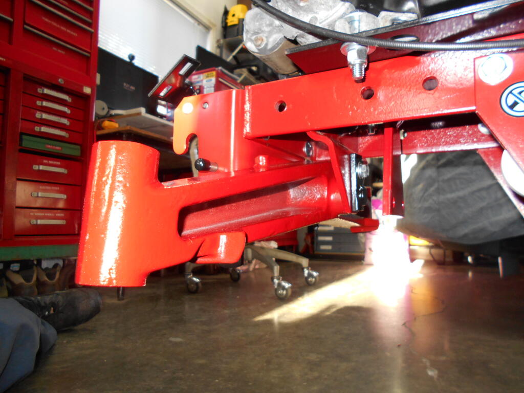

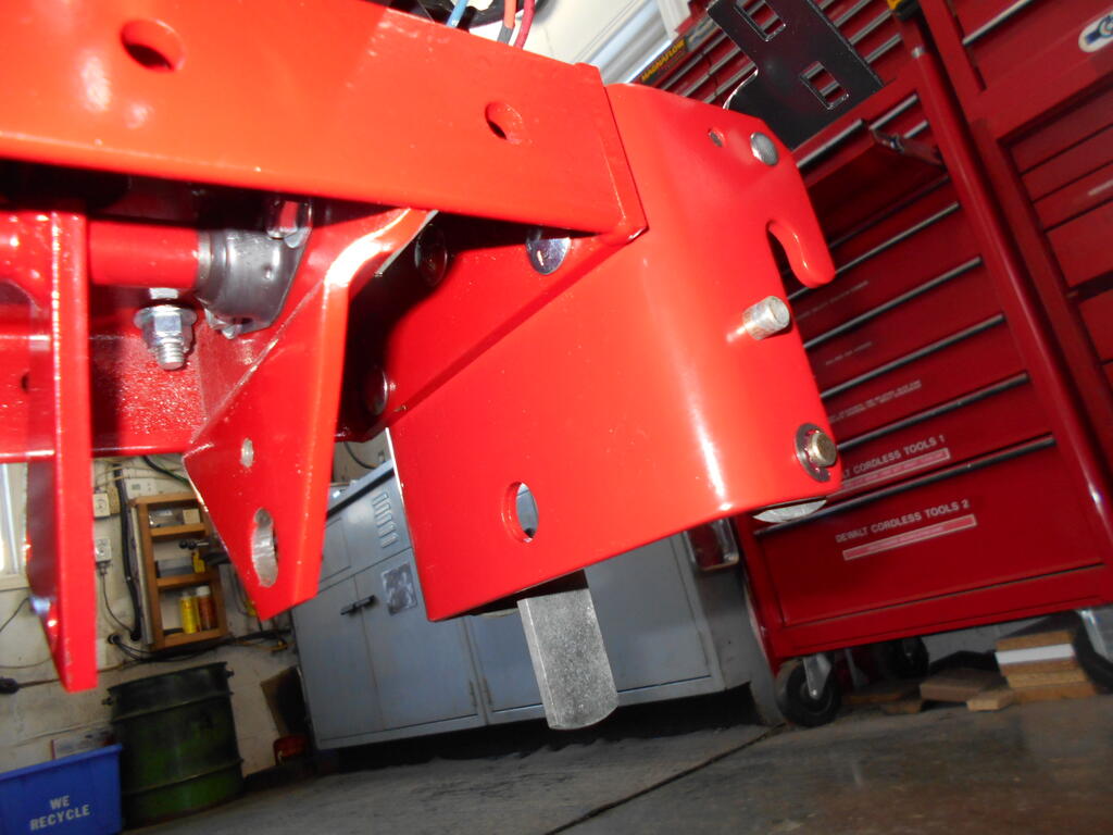

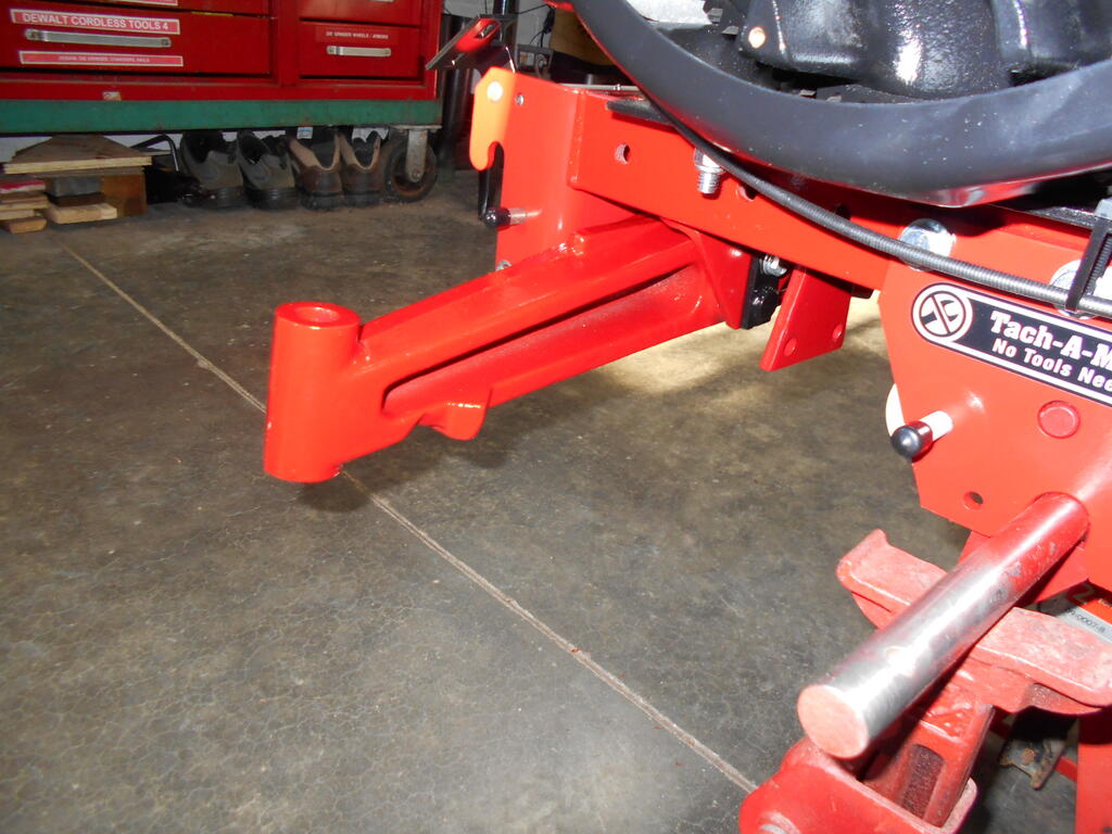

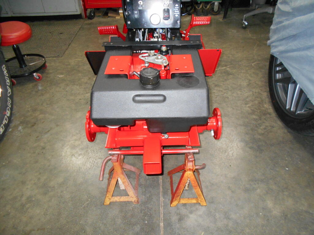

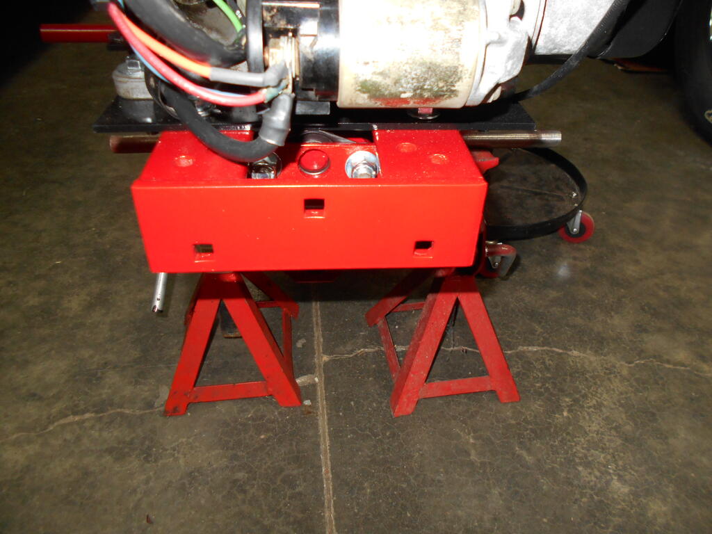

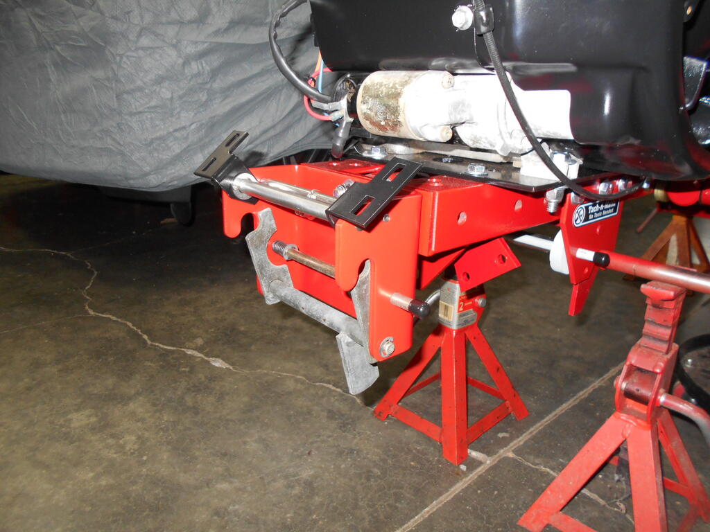

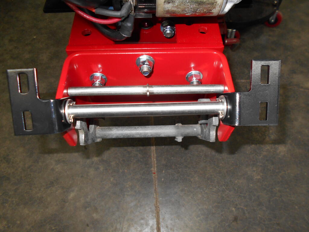

cleat 9,441 #280 Posted January 15 Front tach assembly ready to install. Tractor frame ready for front tach assembly ready to be installed. Front tach assembly loosely bolted on with regular non-locking nut just to hold it in position. Front tach assembly bolted on with nyloc nuts torqued to 30 ft/lb. Front tach installed. Crow foot socket required to torque top center bolt of front tach. The two lower bolts can be torqued with a regular socket and a short extension. 3 3 Share this post Link to post Share on other sites

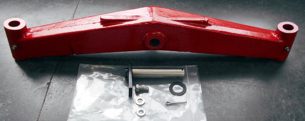

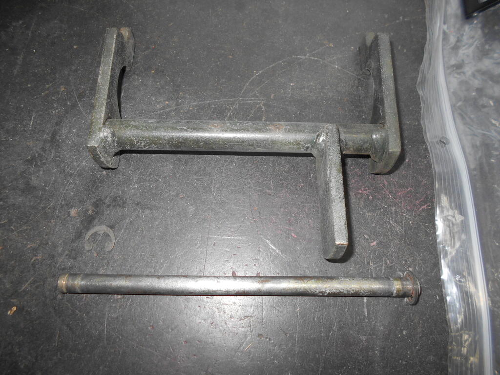

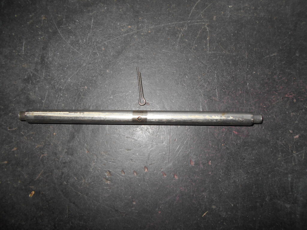

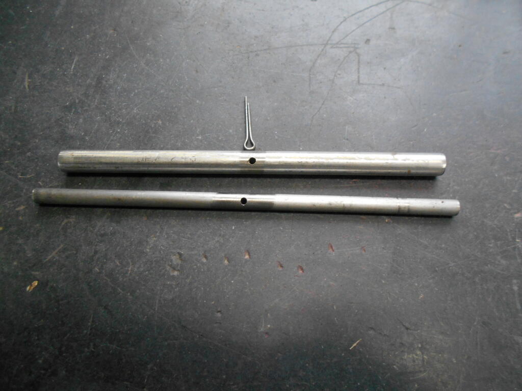

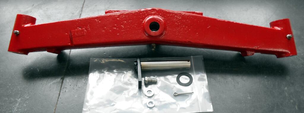

cleat 9,441 #281 Posted January 16 (edited) Front axle ready to be installed. Front axle pin ready to be installed. I made this up at my old work place and it uses a cotter pin instead of an E clip for the secondary retainer. 3/4" pin is stainless steel and the tab is carbon steel. Tractor ready for front axle to be installed. Front axle installed. Front axle pivot pin bolt installed and torqued to 17 ft/lb. Front axle pivot pin stainless cotter pin and thin shim washer installed. Tractor assembly as of today. Edited January 16 by cleat 2 5 Share this post Link to post Share on other sites

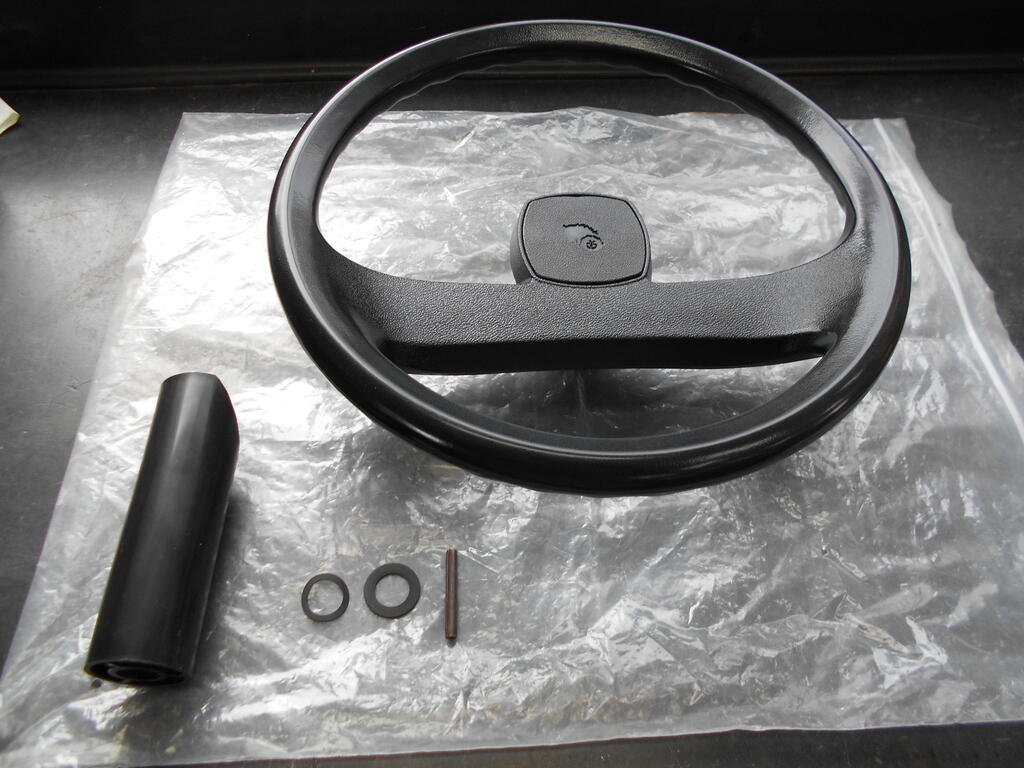

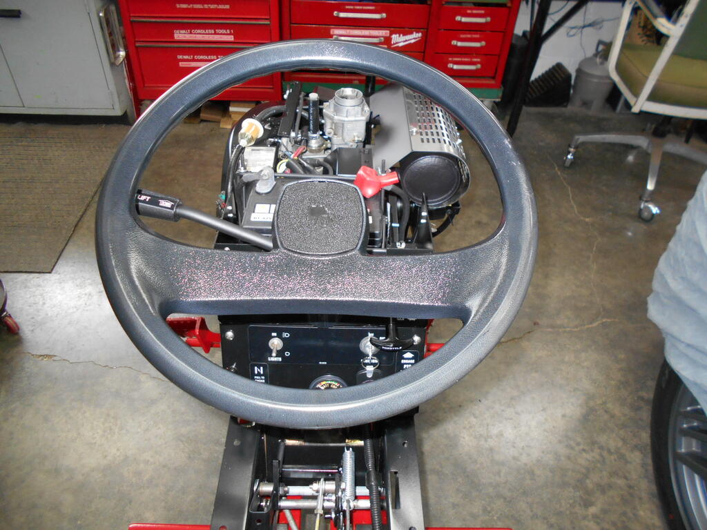

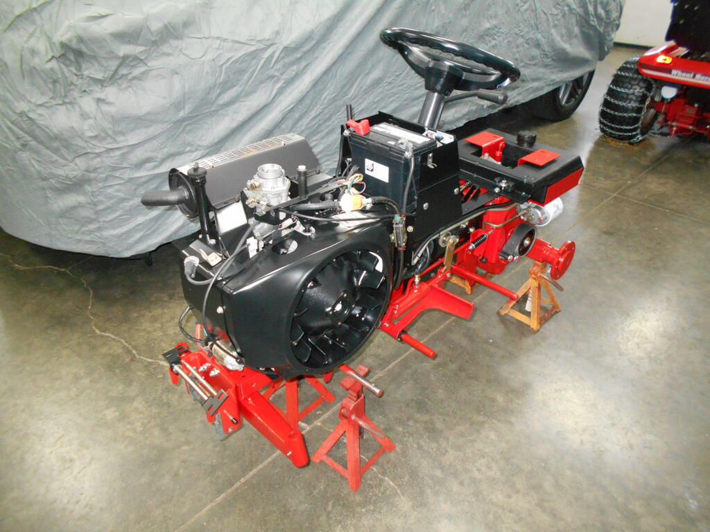

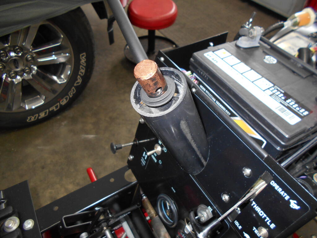

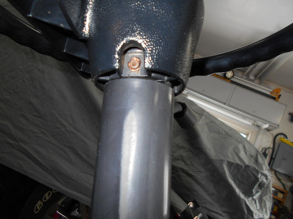

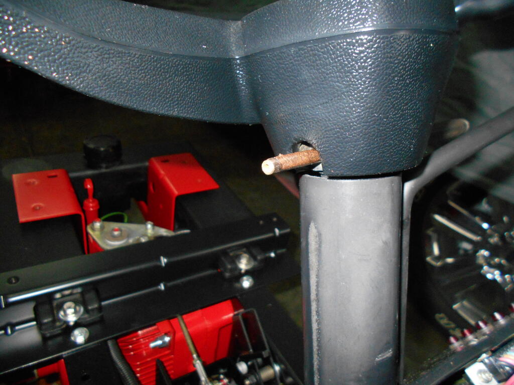

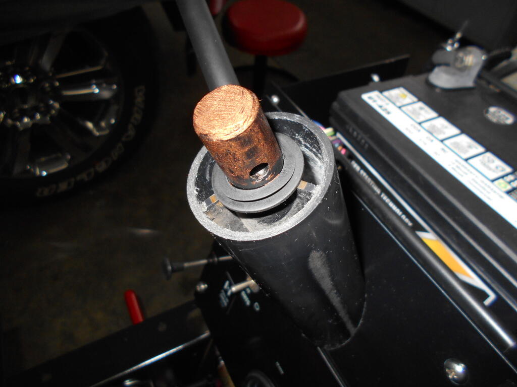

cleat 9,441 #282 Posted January 17 Steering wheel and tube ready to be installed. Tractor ready for steering wheel to be installed. Steering tube slid onto steering shaft. Never seize applied to steering shaft. Flat then bowed washers slid onto steering shaft. Spirol pin never seized then partly installed into steering wheel but not blocking shaft hole. Steering wheel slid onto shaft then a 1/4" pin slid in opposite the spirol pin to align holes in the steering wheel and steering shaft. There is just a small amount of tension from the bowed washer to hold the tube in position. Spirol pin ready to be driven in. Spirol pin driven in with this punch that has a locating bump on the end. Spirol pin driven in until the pin protrudes out of each side of steering wheel. Steering wheel installed. Steering wheel and tube installed. 5 Share this post Link to post Share on other sites

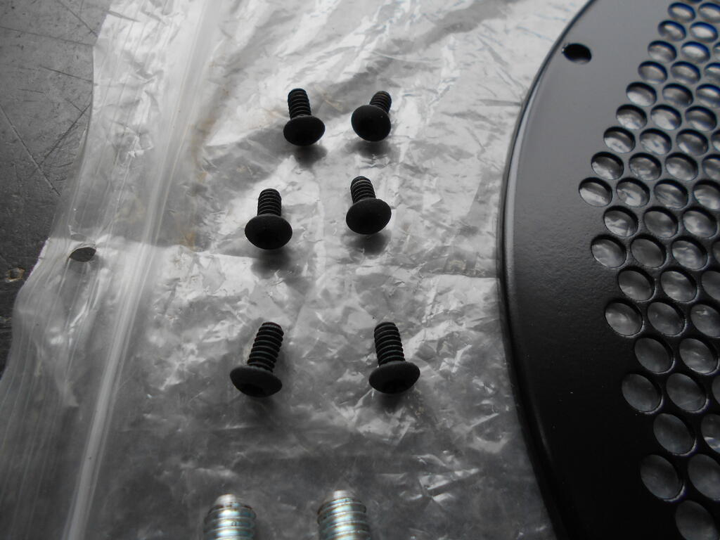

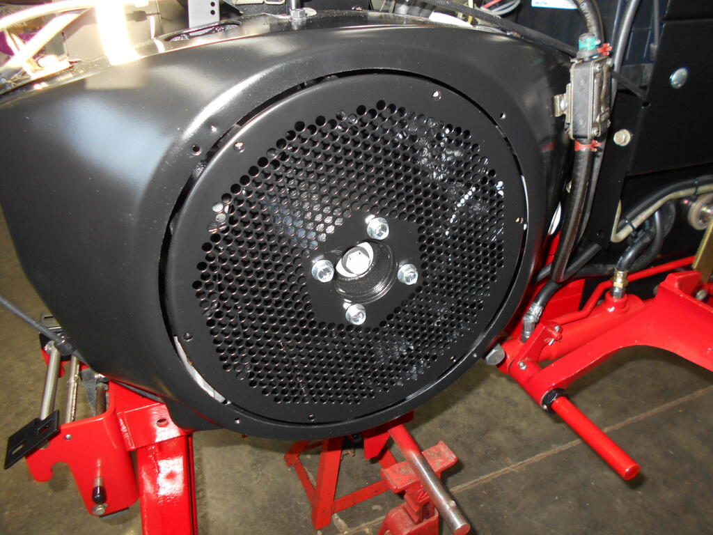

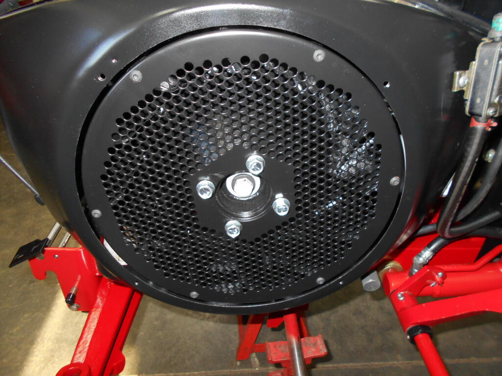

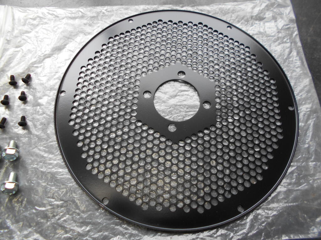

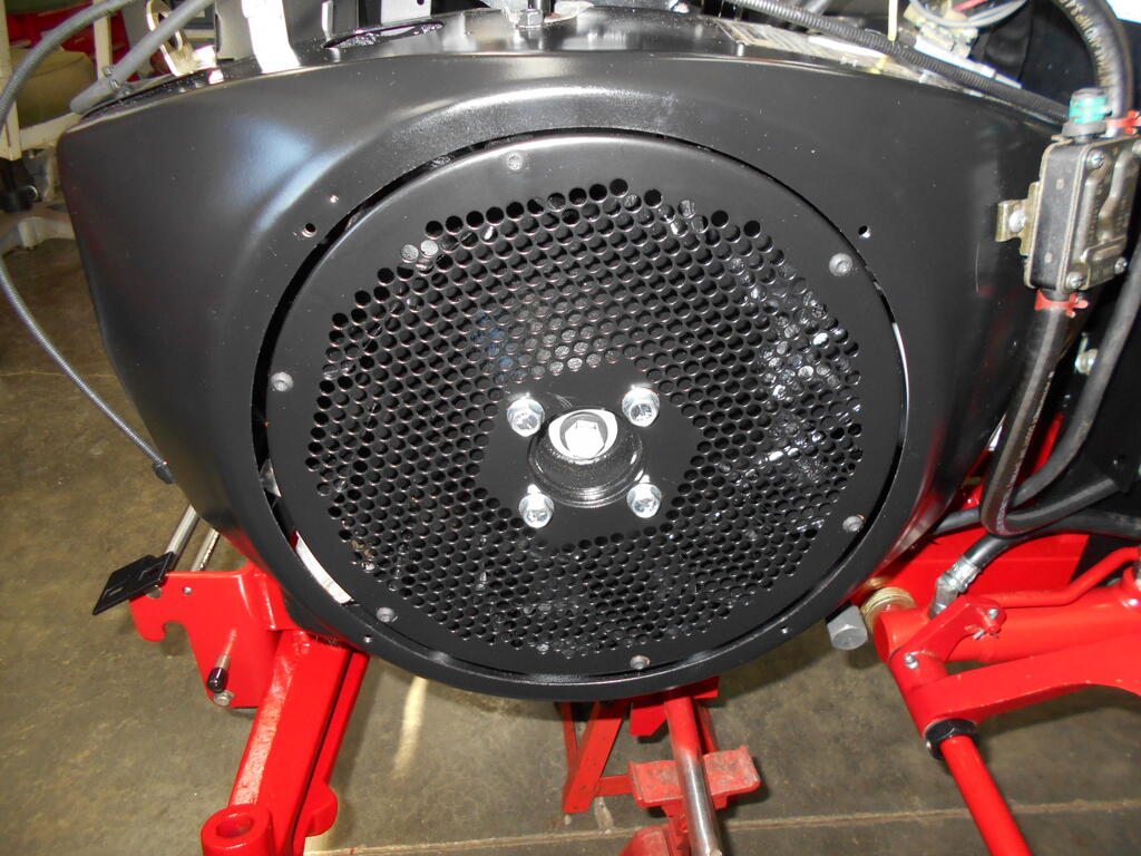

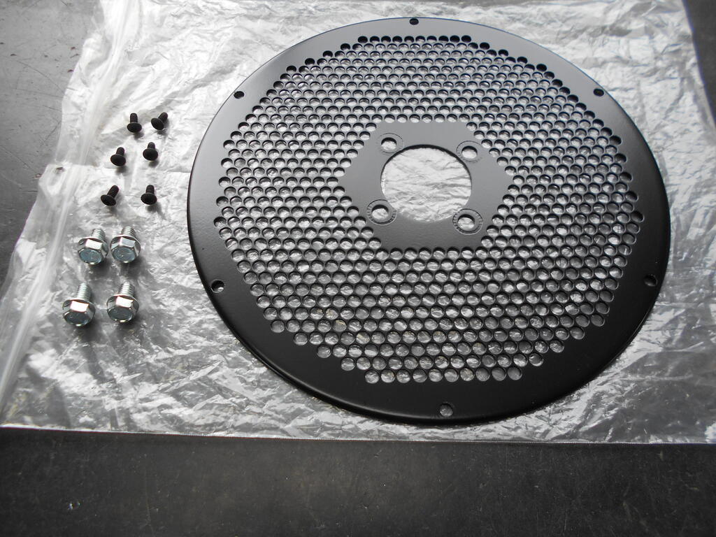

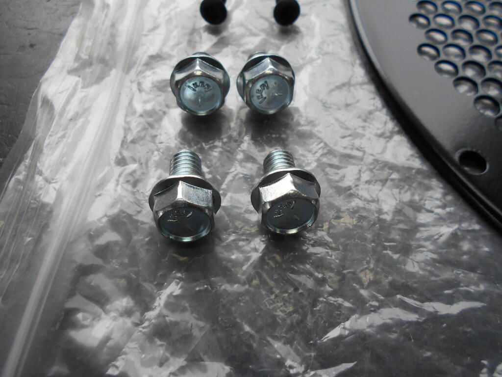

cleat 9,441 #283 Posted January 18 Flywheel screen ready to install. Flywheel screen bolts and screws ready to install. Flywheel ready for screen to be installed. Flywheel screen loosely bolted on with the four center bolts. Note the upper right hand center bolt is in line with an outer screen hole. It is critical to line this up right or the outer screw holes will not line up. Flywheel screen loosely bolted on with the four center bolts and the six outer screws. Flywheel screen bolts torqued to 180 in/lb and screws torqued to 22.5 in/lb. Flywheel screen installed. 7 1 Share this post Link to post Share on other sites

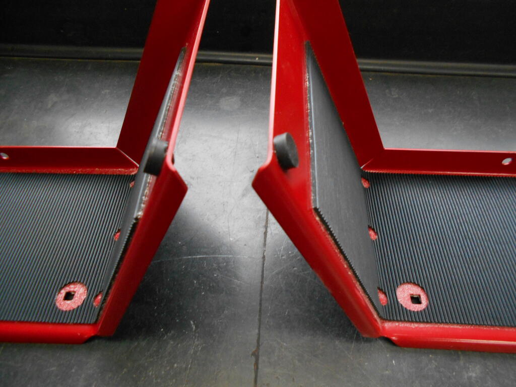

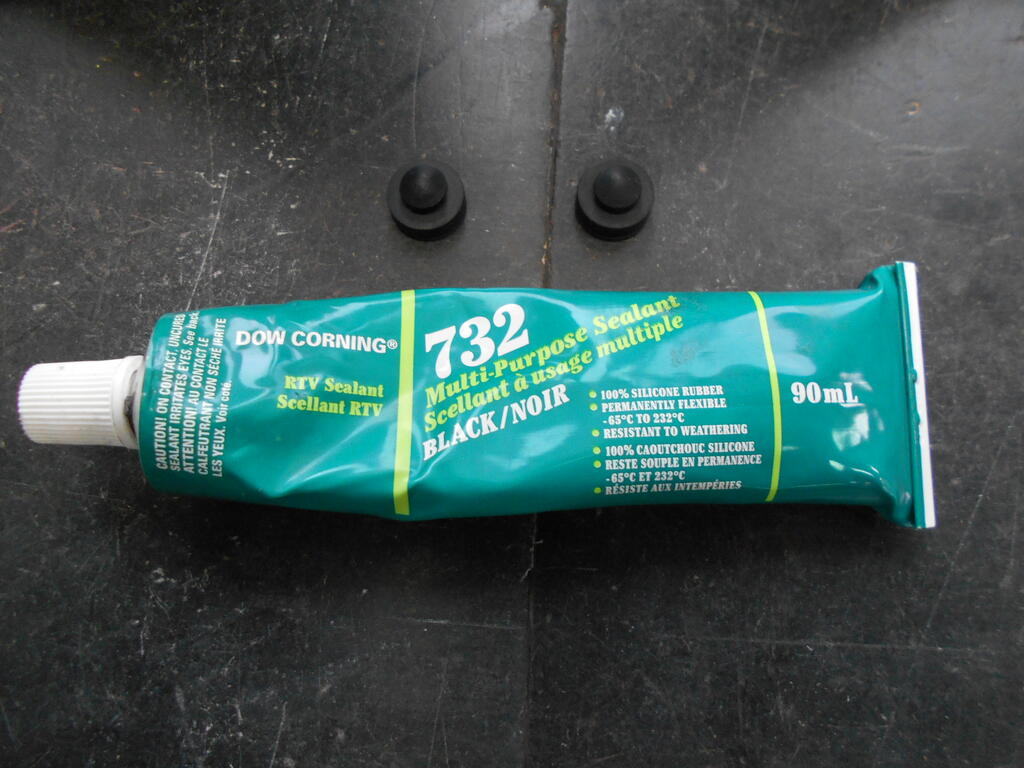

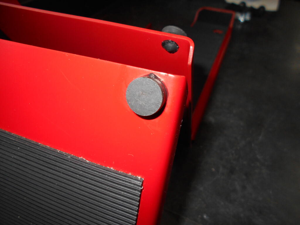

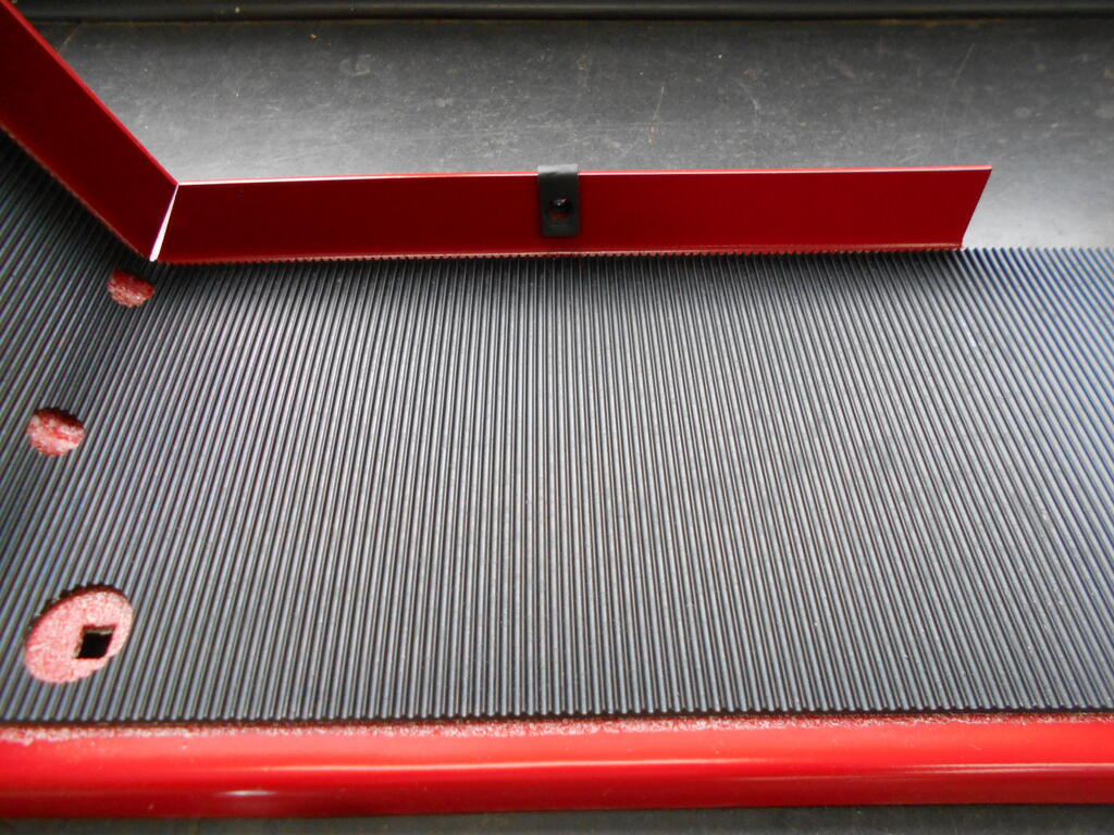

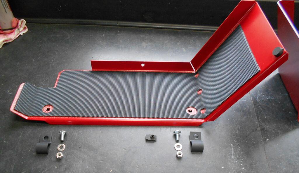

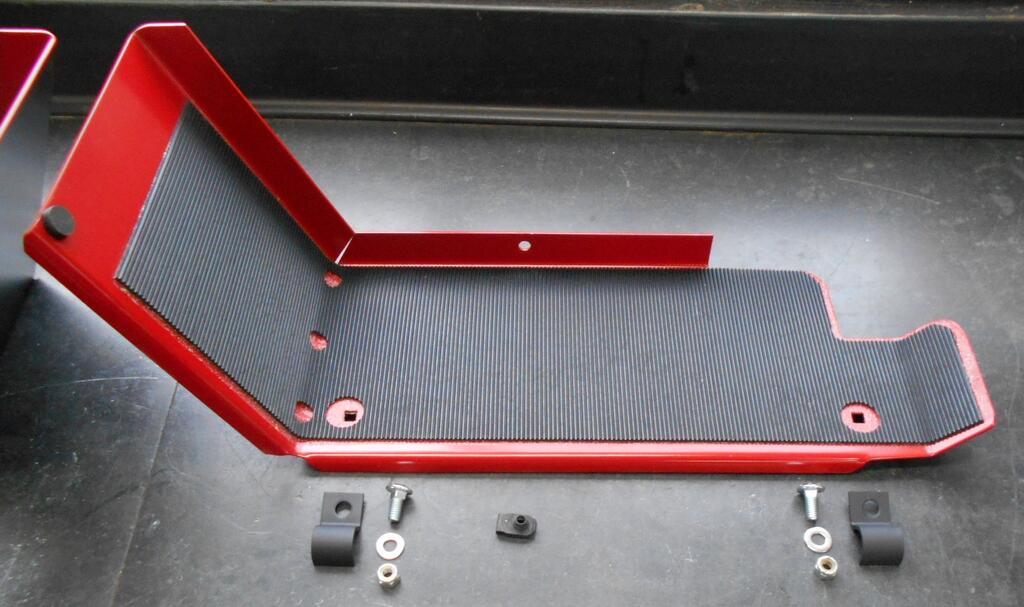

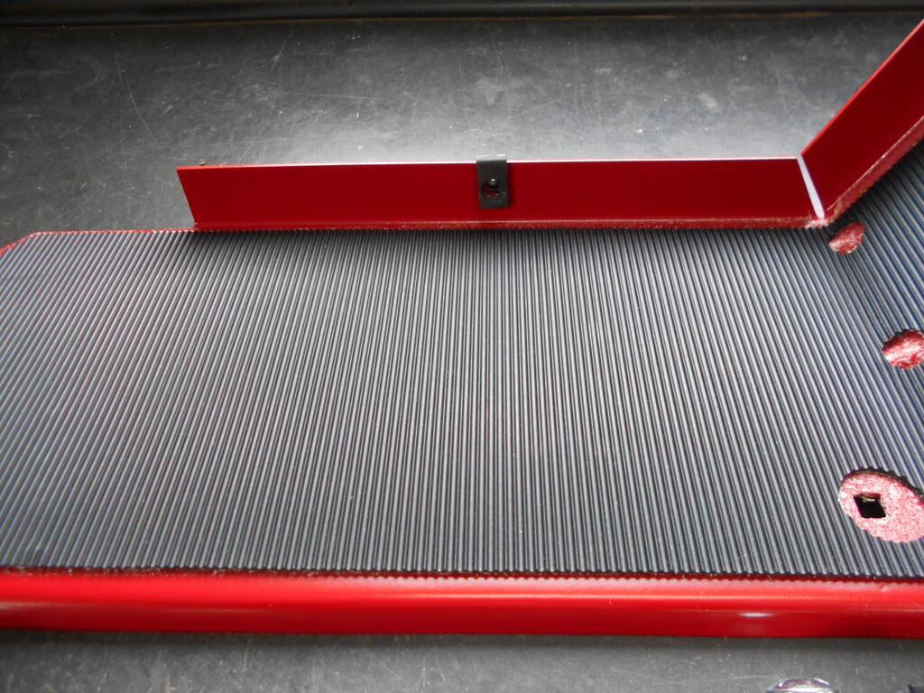

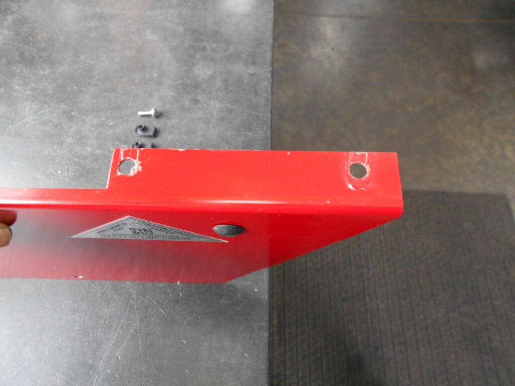

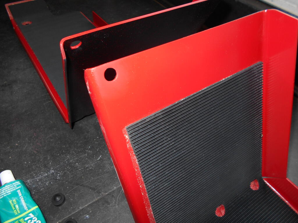

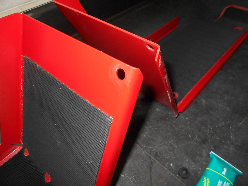

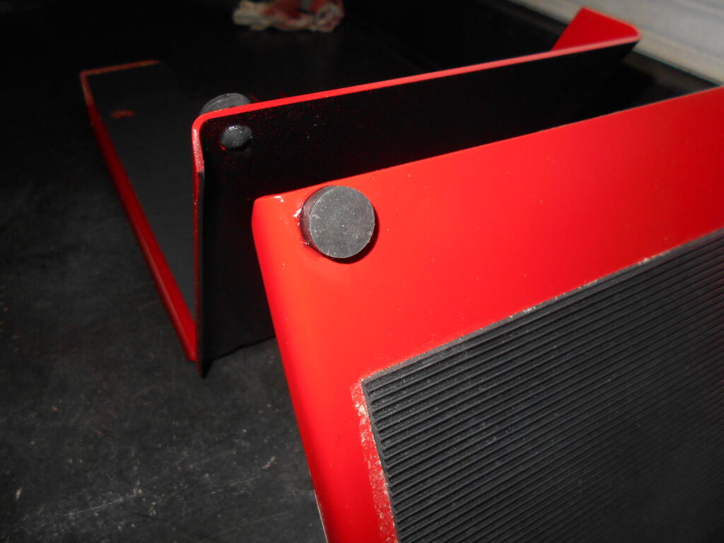

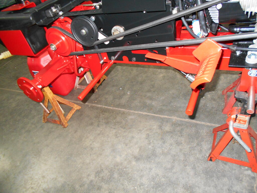

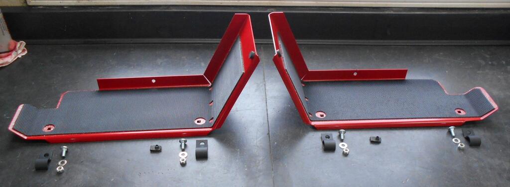

cleat 9,441 #284 Posted January 19 Foot rest rubber bumpers ready to install. These are just what I happen to have here, not really the ones that were used originally. Foot rest rubber bumpers silicone used as adhesive since the holes in the foot rests are just slightly too big for the bumpers to firmly snap onto. Foot rests ready for rubber bumpers to be installed. I cleaned the footrest and rubber bumper where the silicone is to be applied with contact cleaner so it will bond better. Foot rest rubber bumpers installed. I used a small screwdriver to apply just a thin layer of silicone to the rubber bumper before installing them to the foot rests. 5 Share this post Link to post Share on other sites

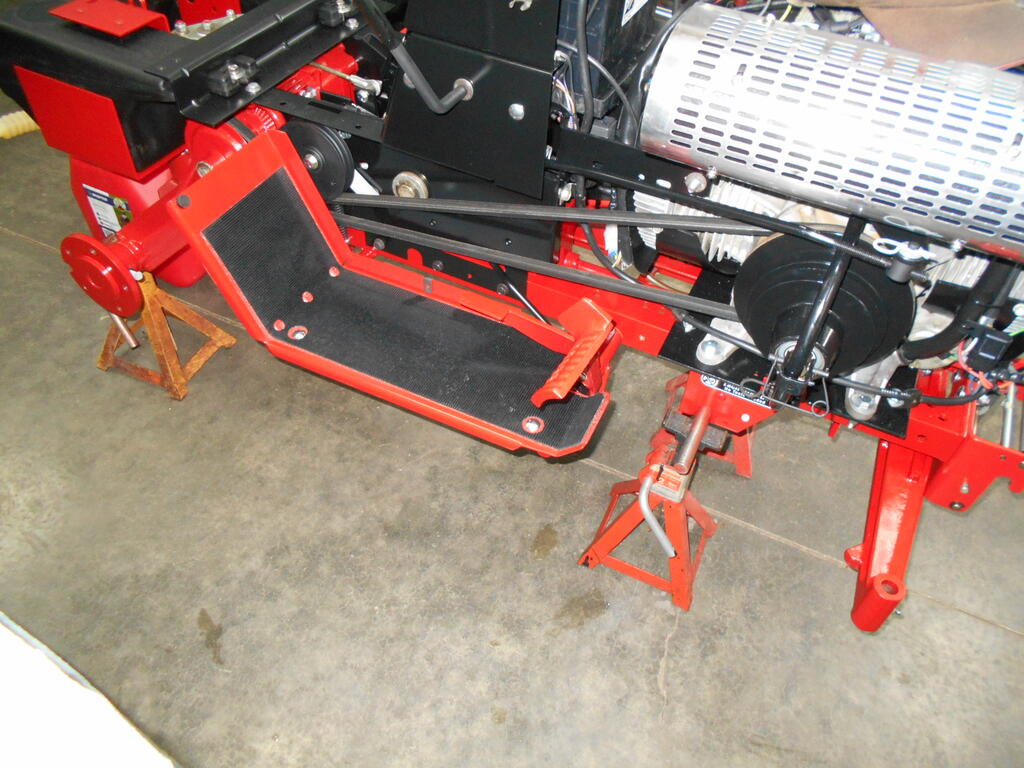

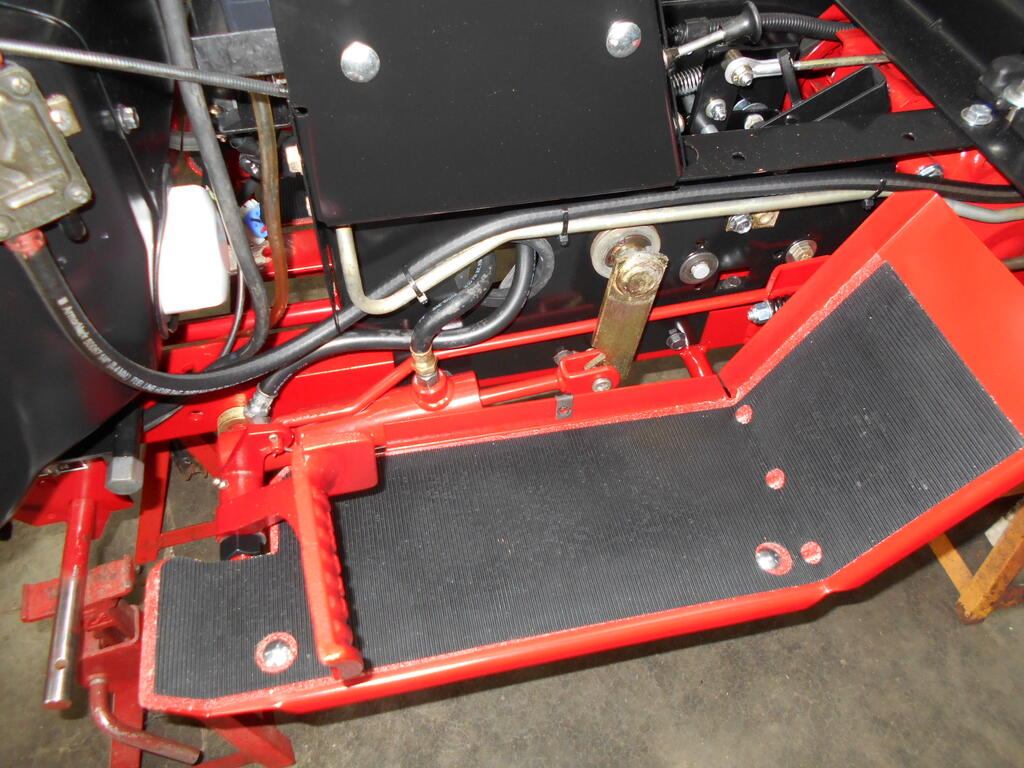

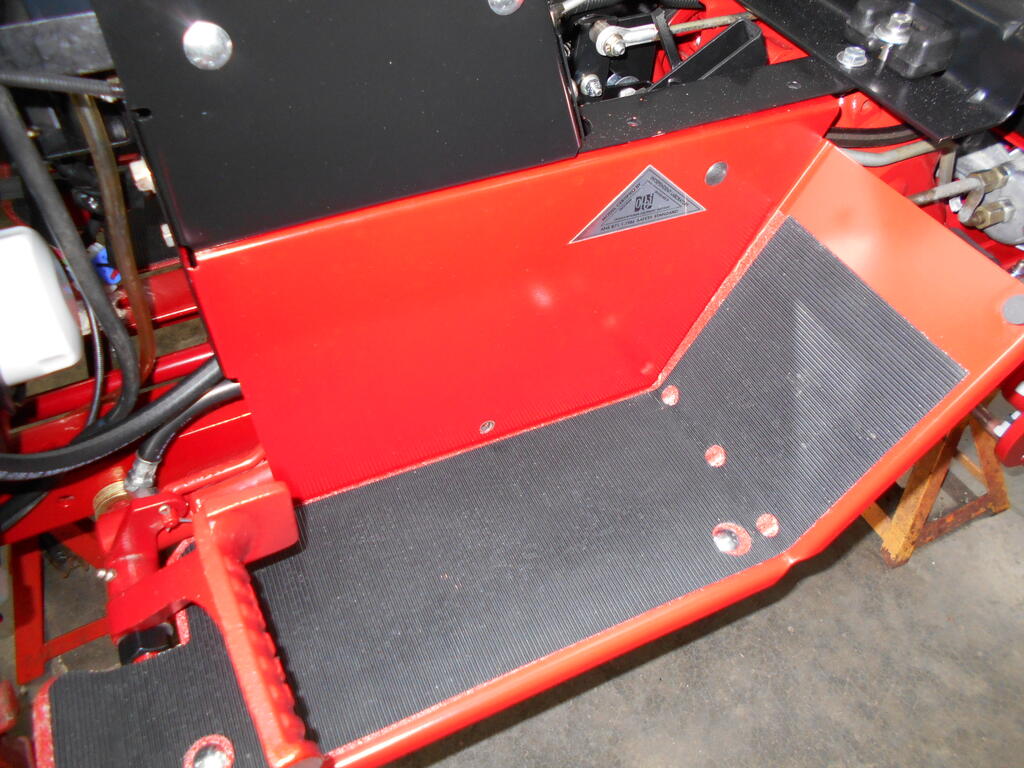

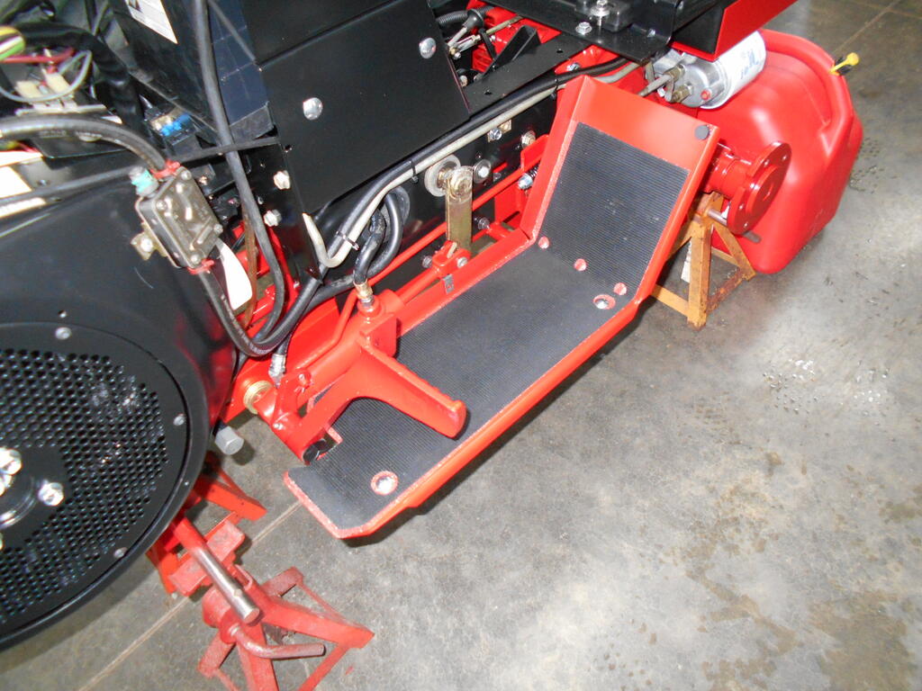

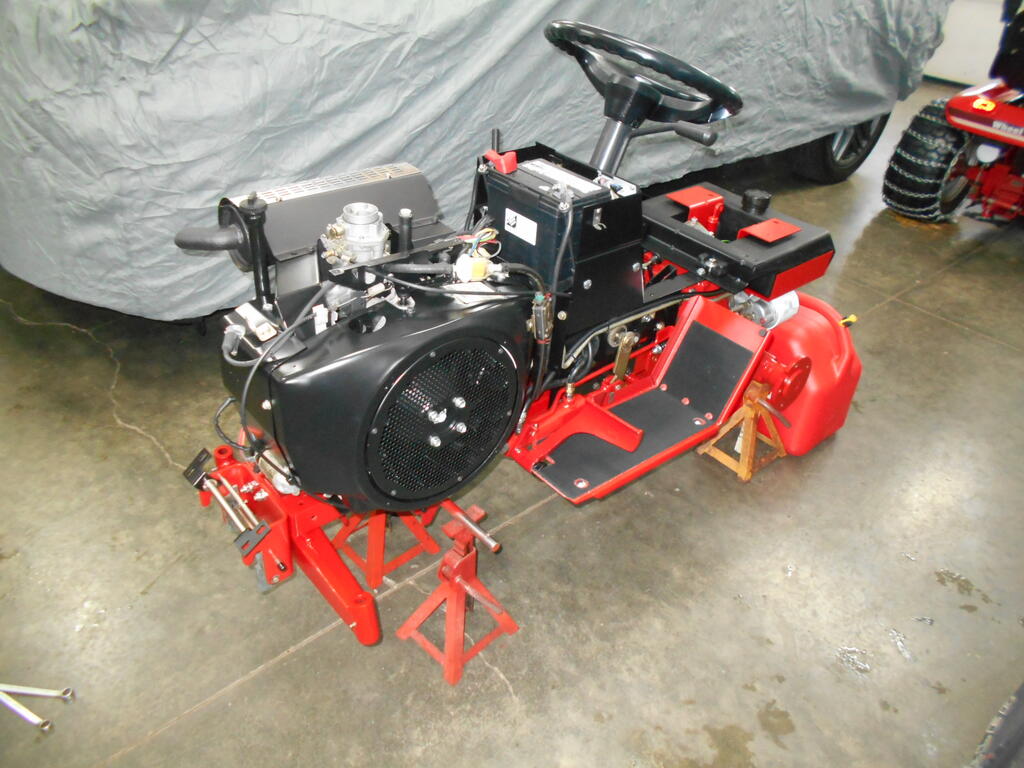

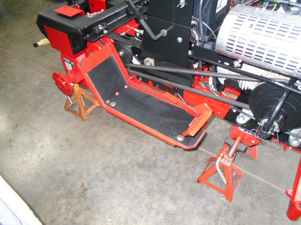

cleat 9,441 #285 Posted January 19 Foot rests ready to install. Left side foot rest ready to install. Right side foot rest ready to install. Tractor ready for foot rests to be installed. Now I need to wait a while for the silicone to cure so don't knock the bumpers off installing the foot rests. 5 Share this post Link to post Share on other sites

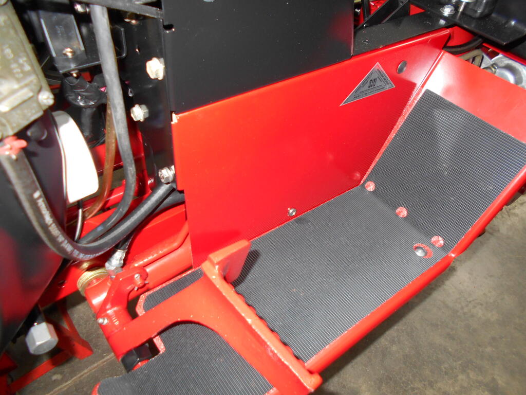

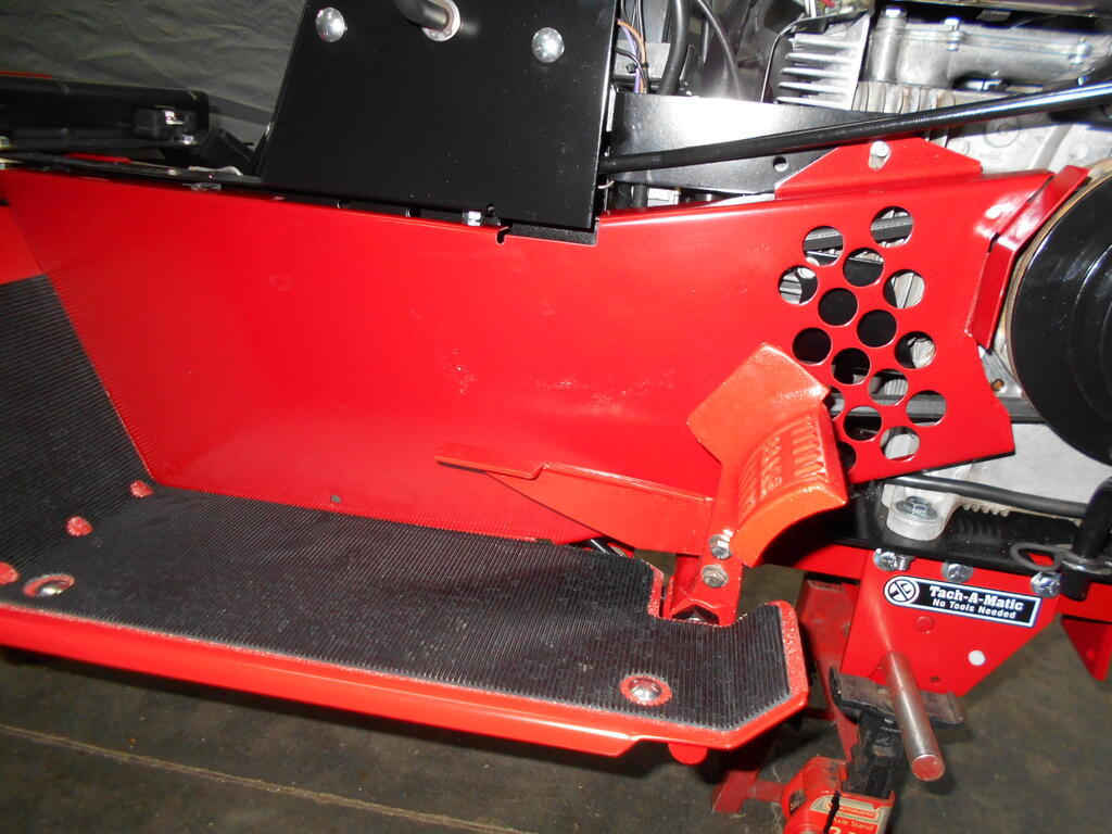

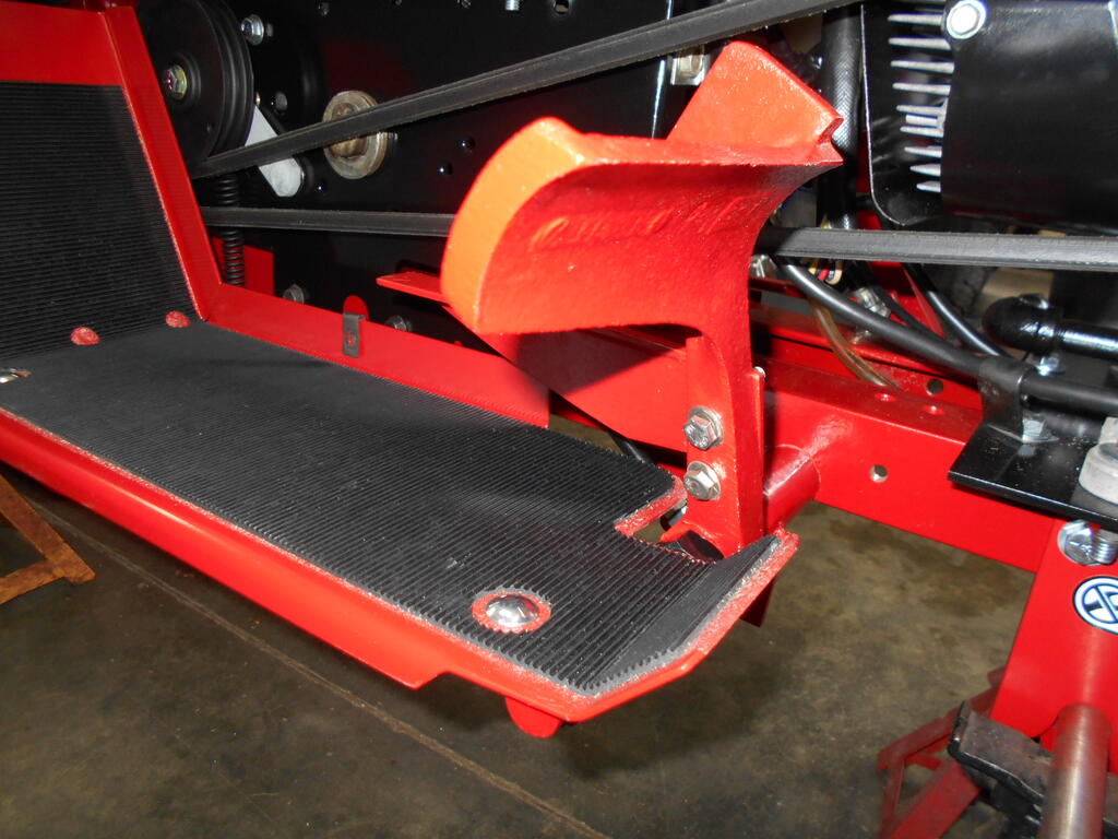

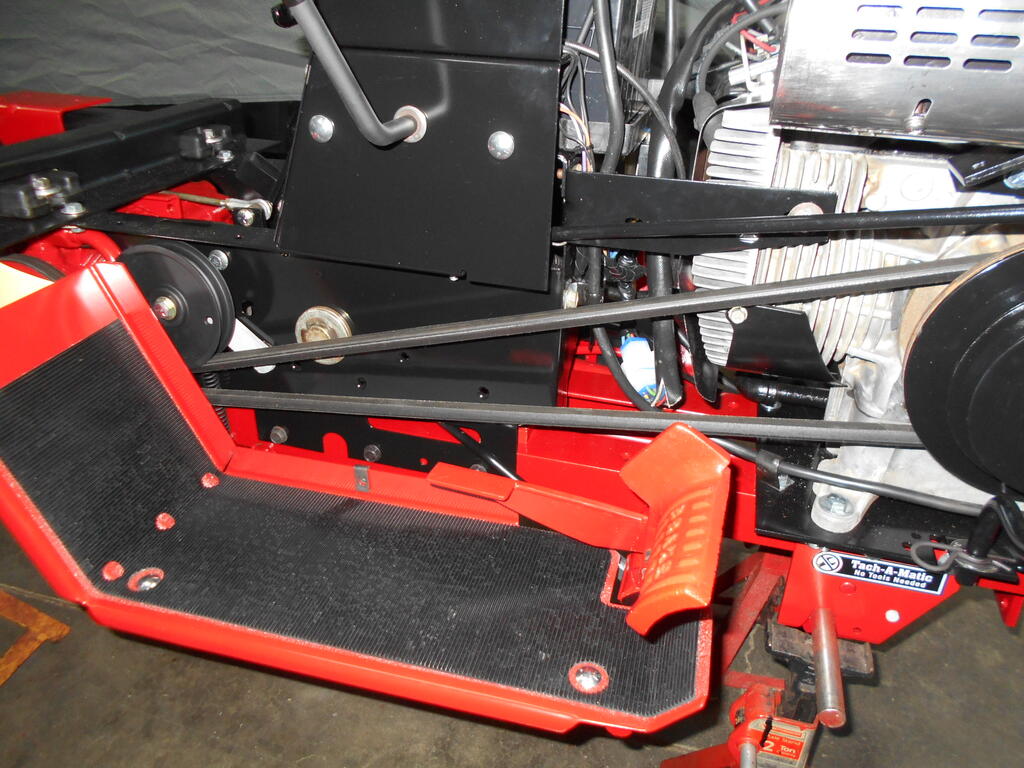

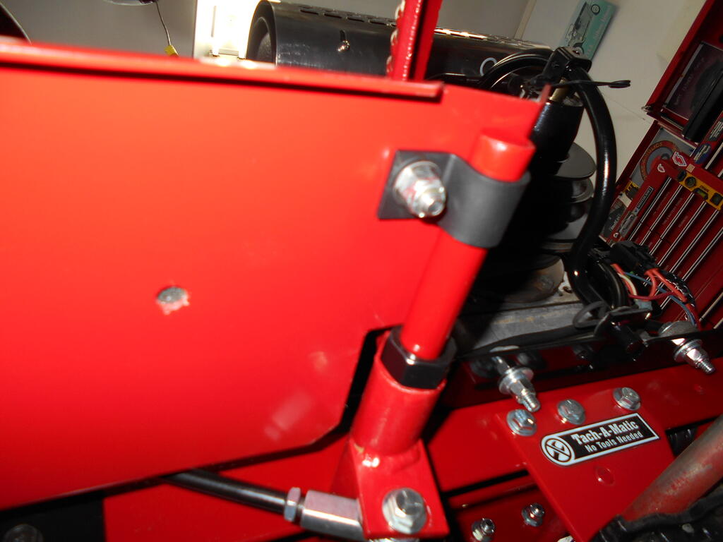

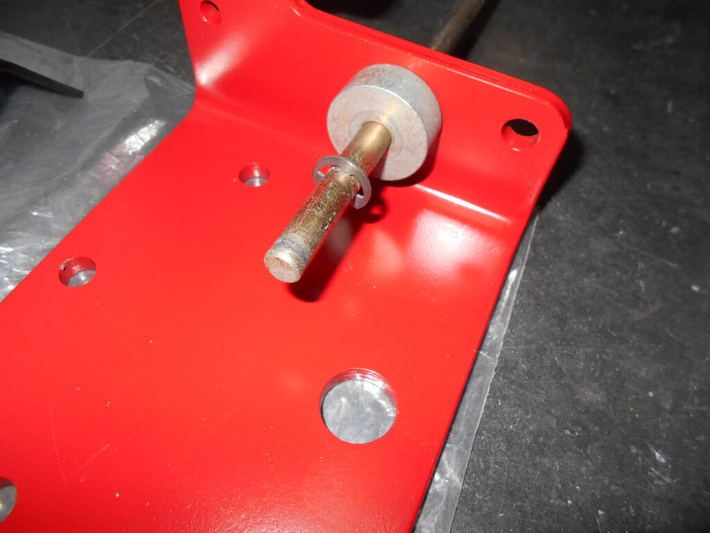

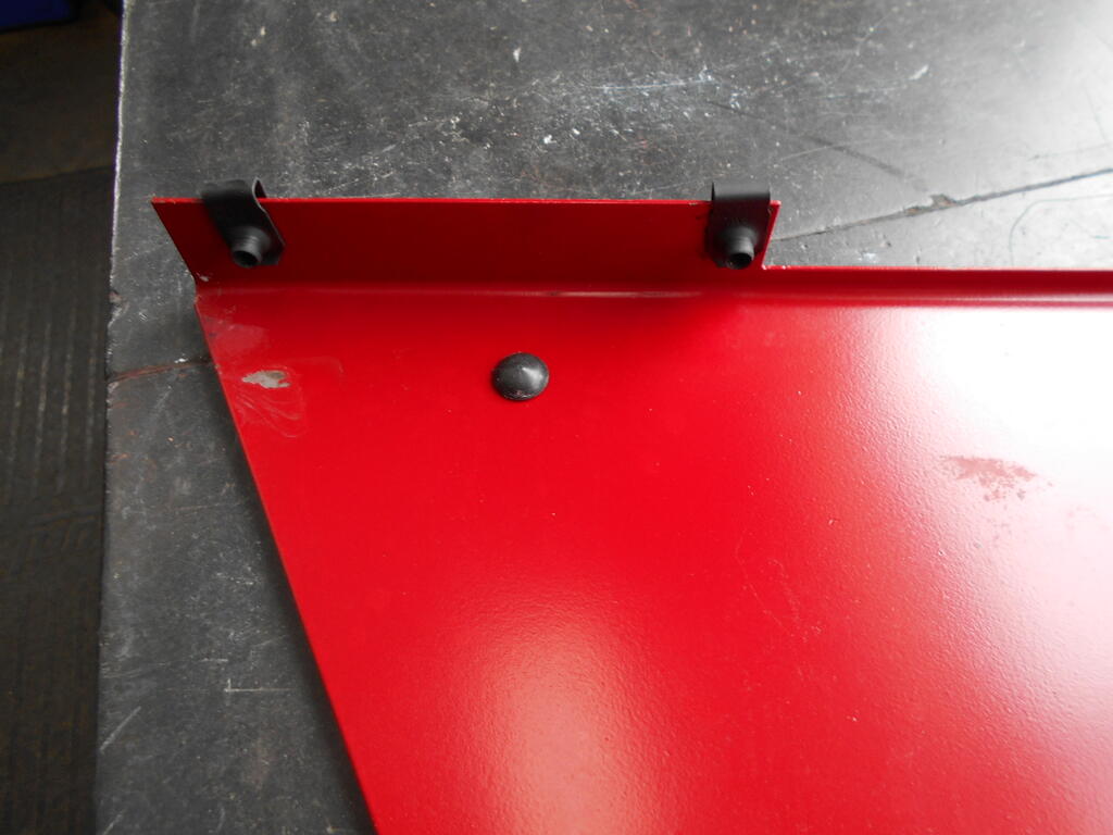

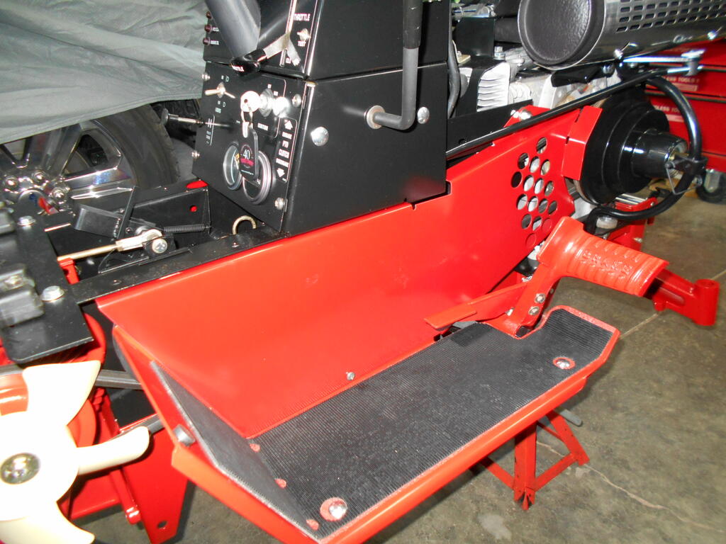

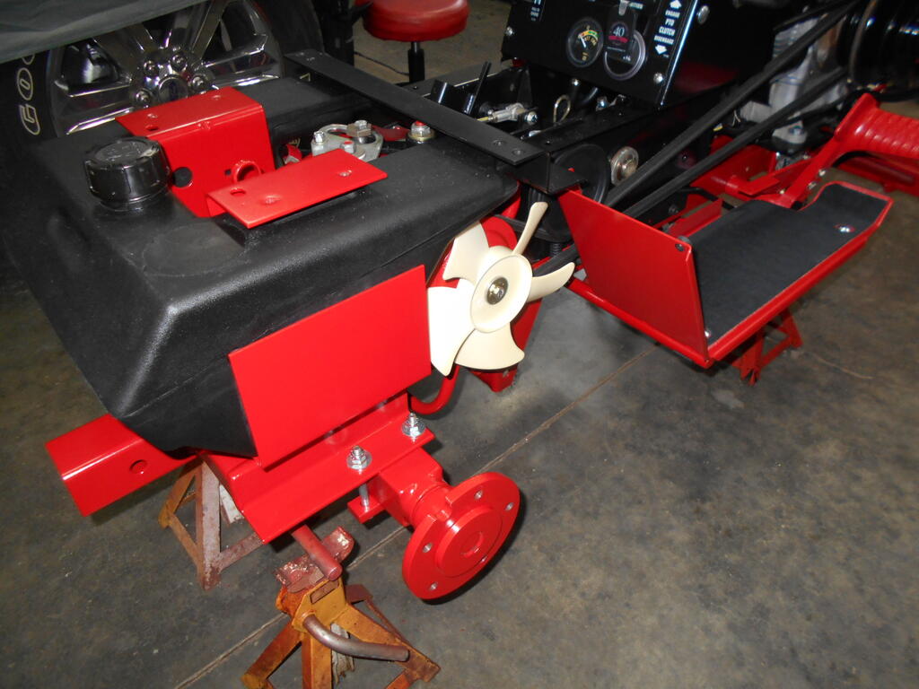

cleat 9,441 #286 Posted January 19 Took a break for a snack and a coffee, silicone seems to be holding foot rest bumpers well. Foot rest clips installed. Left foot rest installed. Right foot rest installed. All four foot rest bolts torqued to 204 in/lb. Right foot rest installed showing clips underneath. 1 1 Share this post Link to post Share on other sites

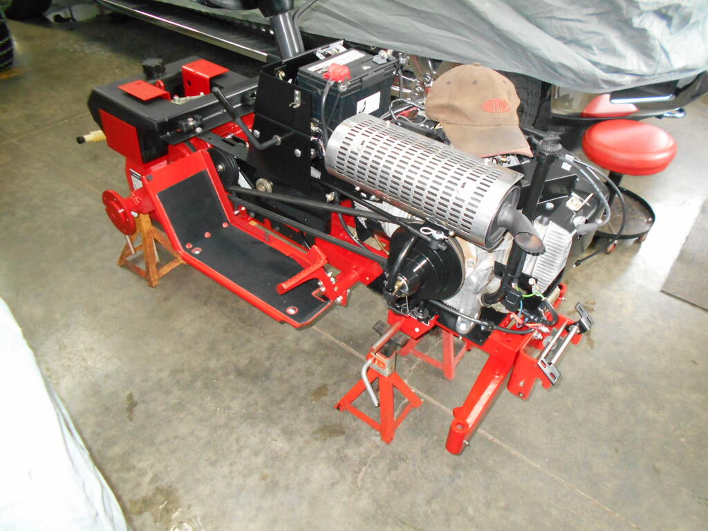

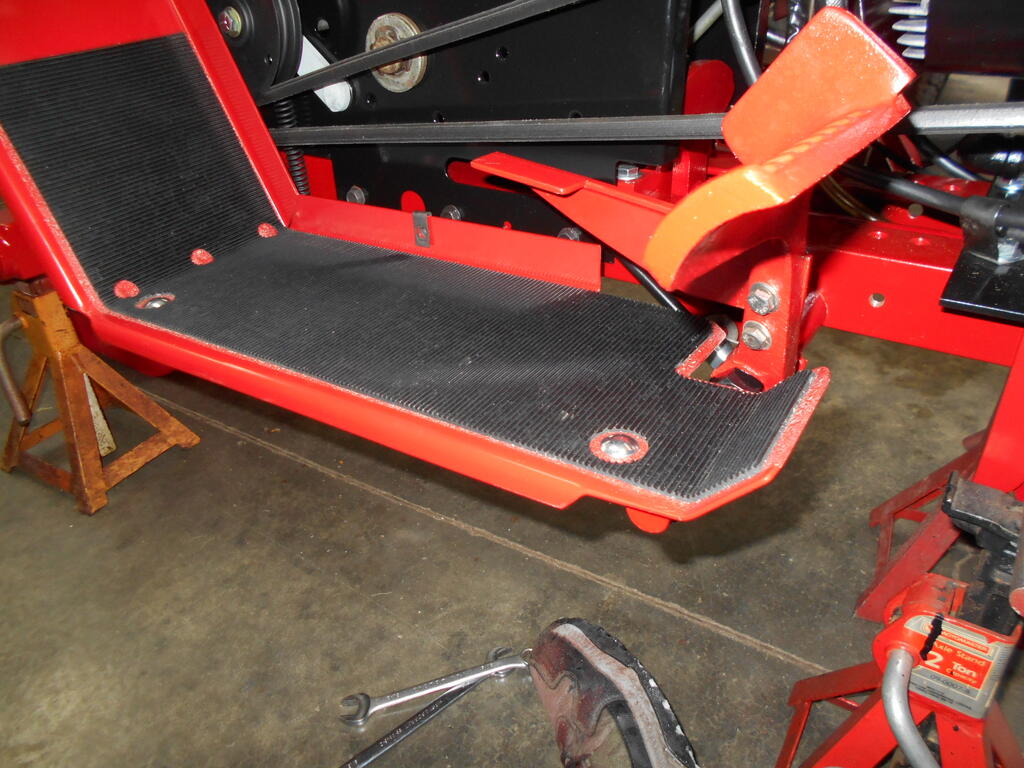

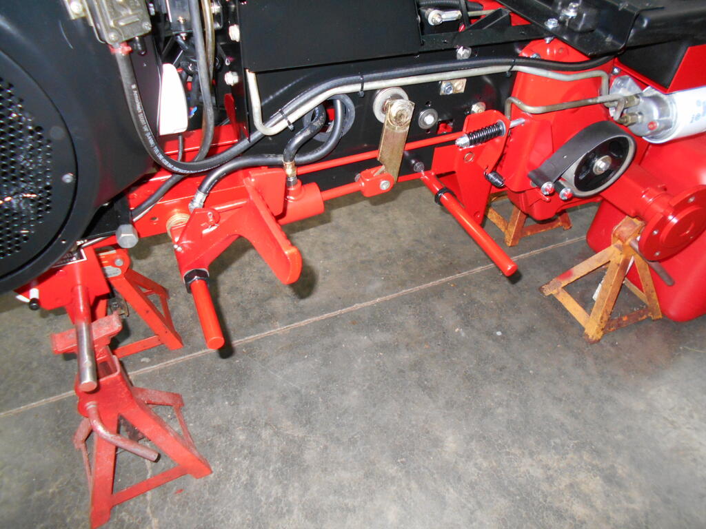

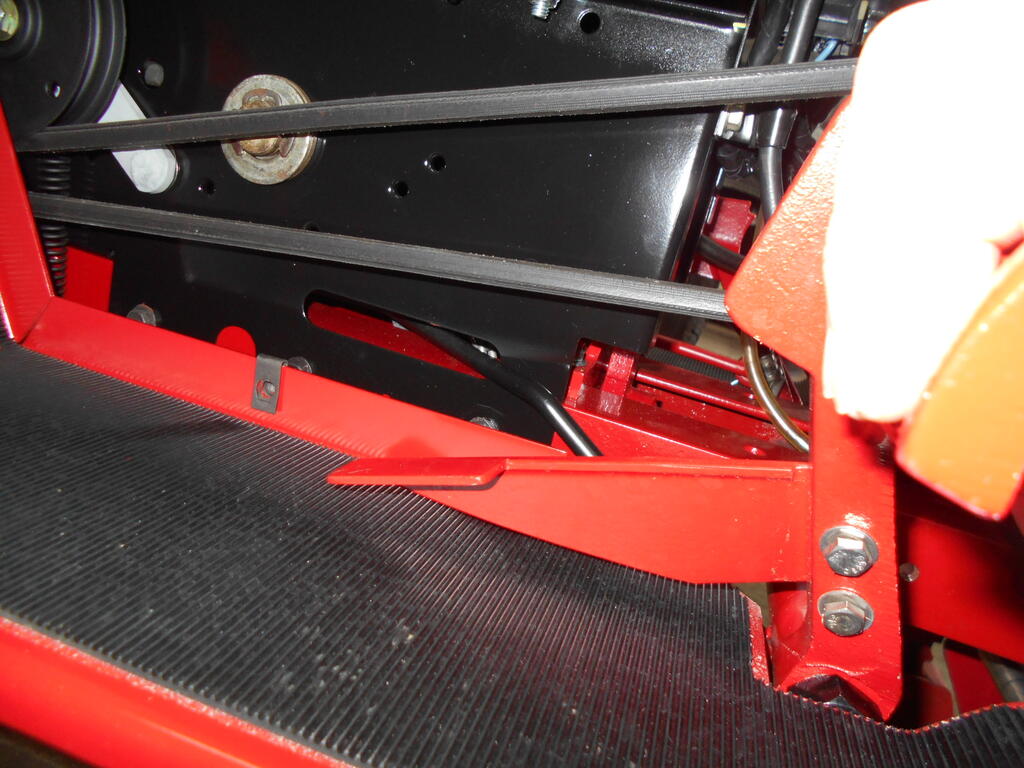

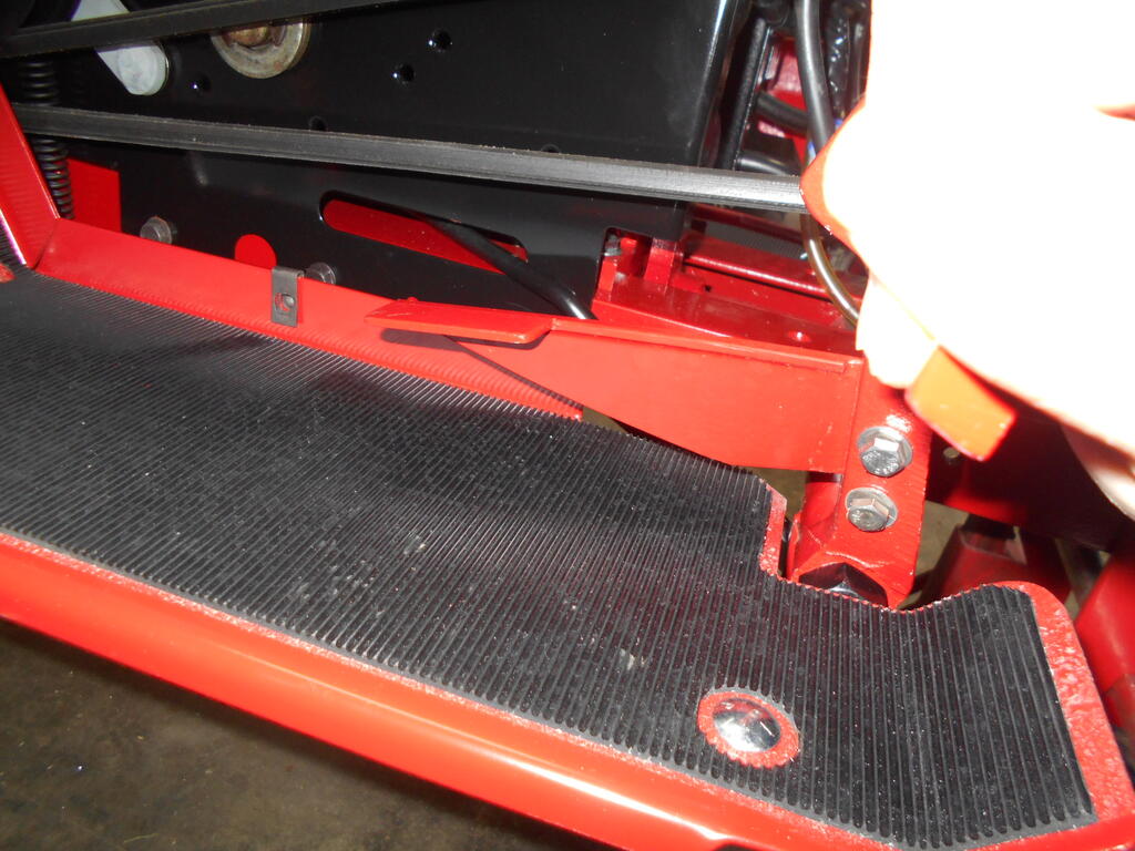

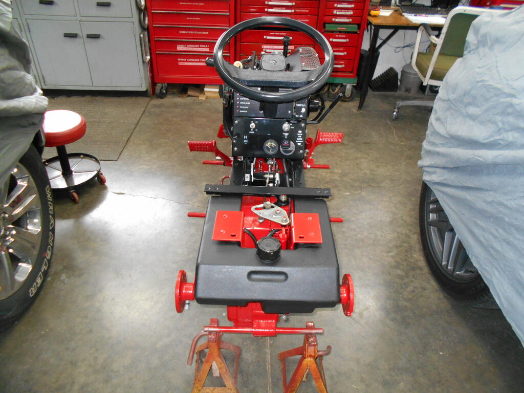

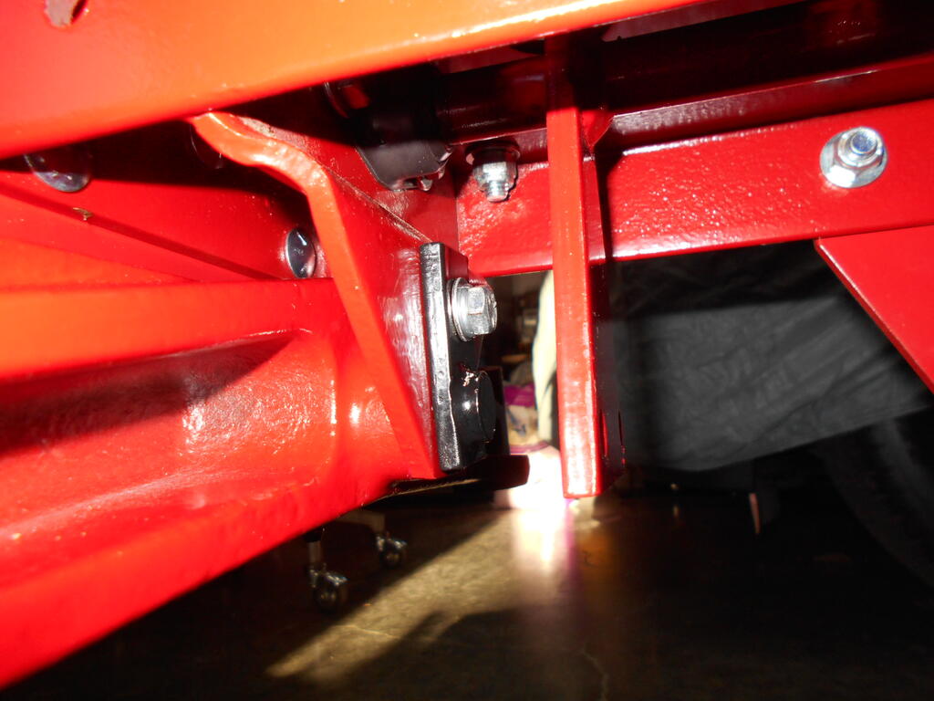

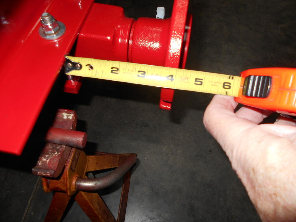

cleat 9,441 #287 Posted January 19 (edited) Now that the foot rests are on I can set the foot pedal height. I initially screwed the heim joint in all the way on the foot pedal control rod so the pedal is too far forward as shown. Here I am holding the pedal in full reverse and you can see the large gap between the reverse pedal and the foot rest. To adjust the pedal, unbolt the heim joint from the foot pedal and unscrew it a few turns on the rod then bolt it back to the pedal. Then push the pedal to full reverse again. When you have it set right the pedal will almost touch the foot rest but there should be a small gap. This will ensure you have full reverse speed. Once the heim is set in the right place the jamb nut can be tightened on the control rod to lock the heim joint in place. Here is the foot pedal in full reverse showing the slight gap to the foot rest. Here is how the foot pedal sits in neutral now. Tractor overview as of today. Edited January 19 by cleat 6 Share this post Link to post Share on other sites

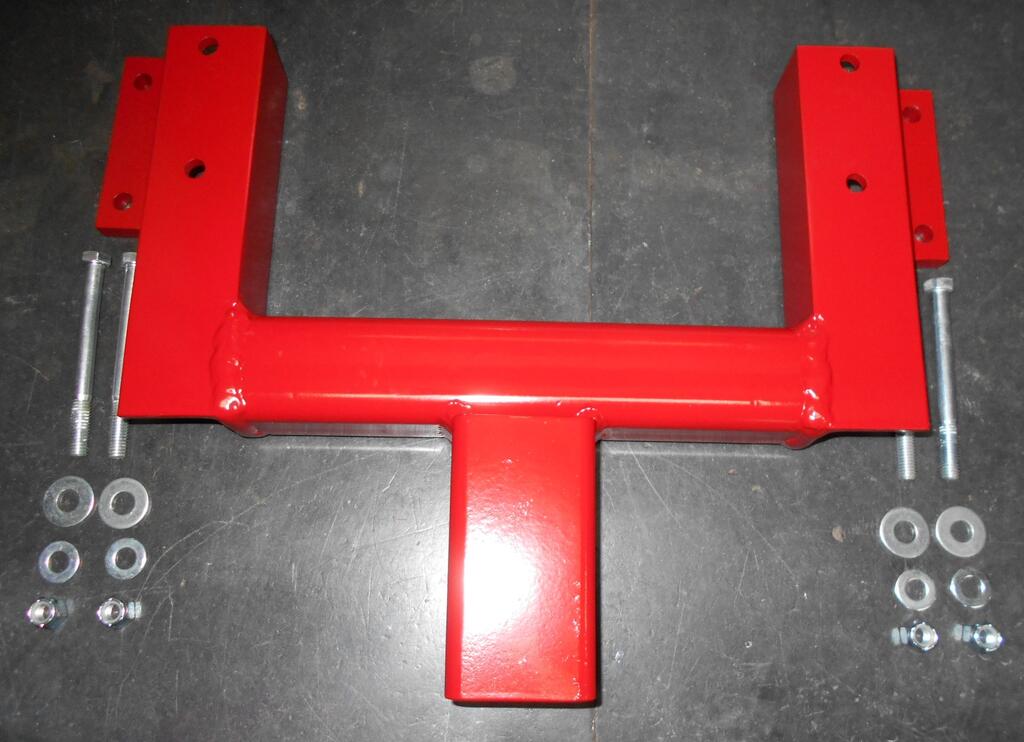

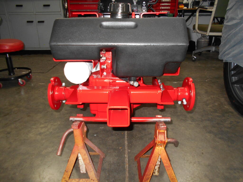

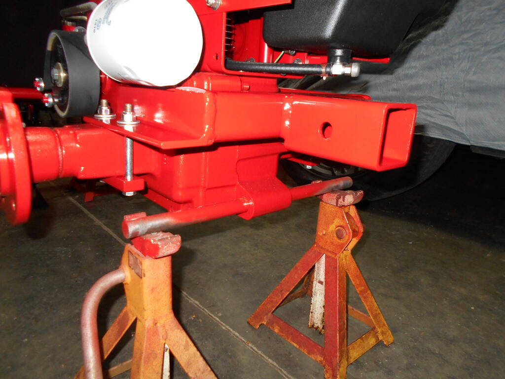

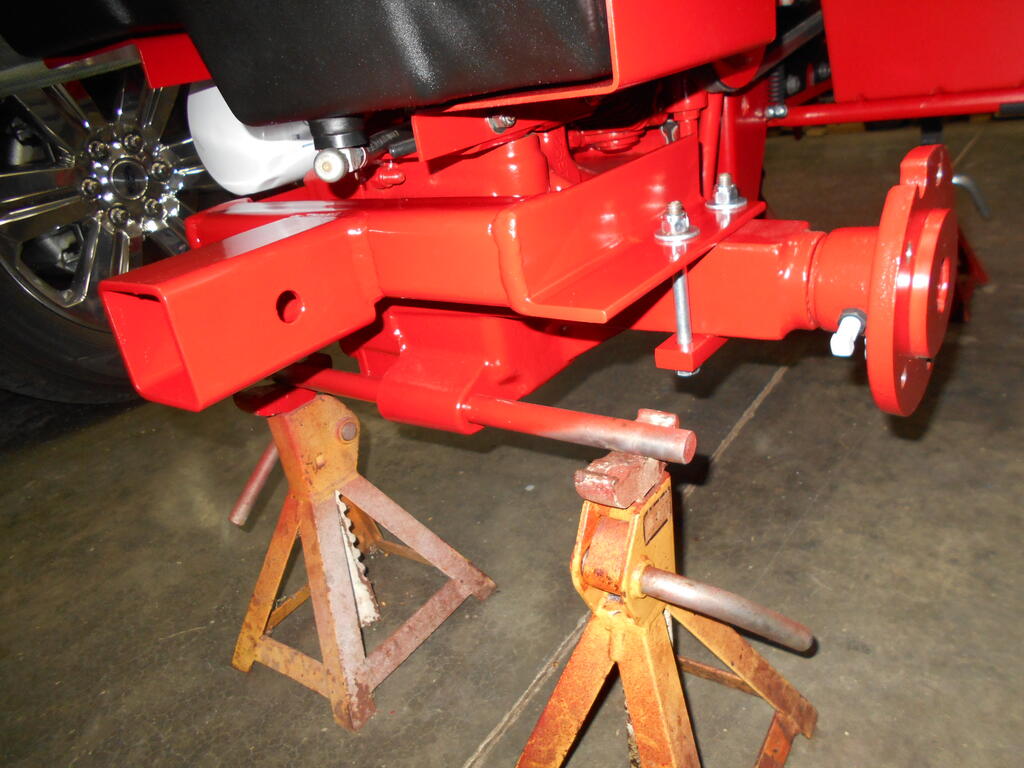

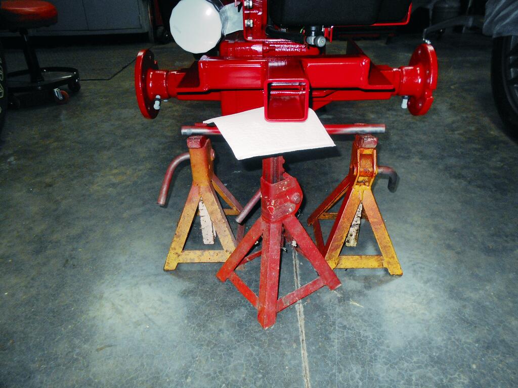

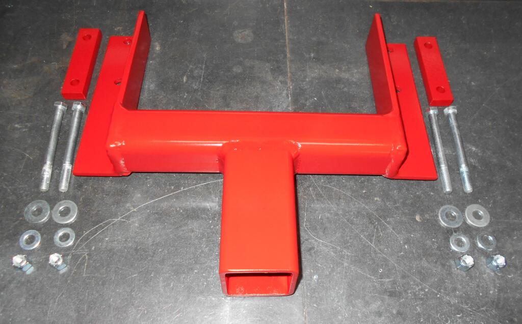

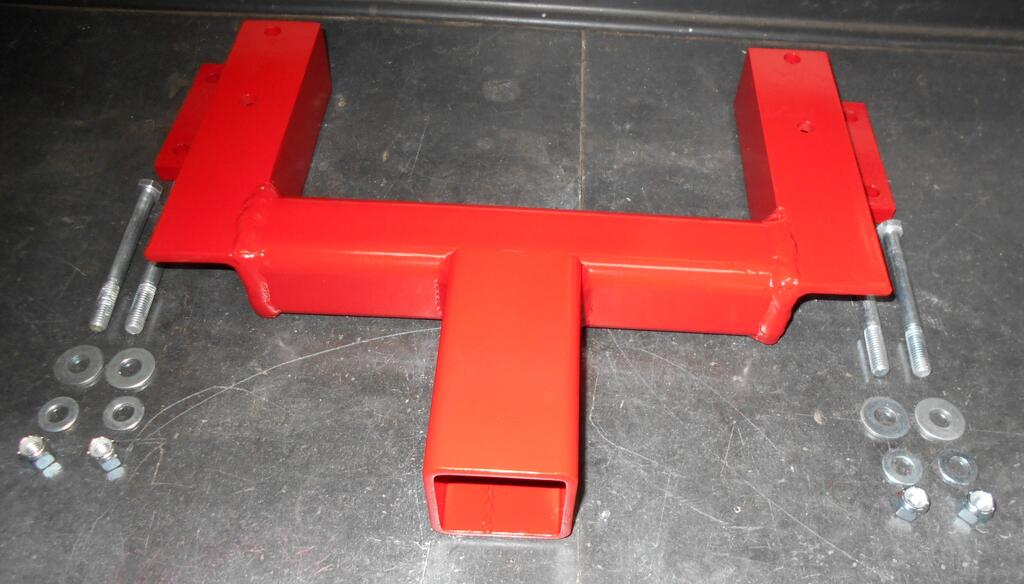

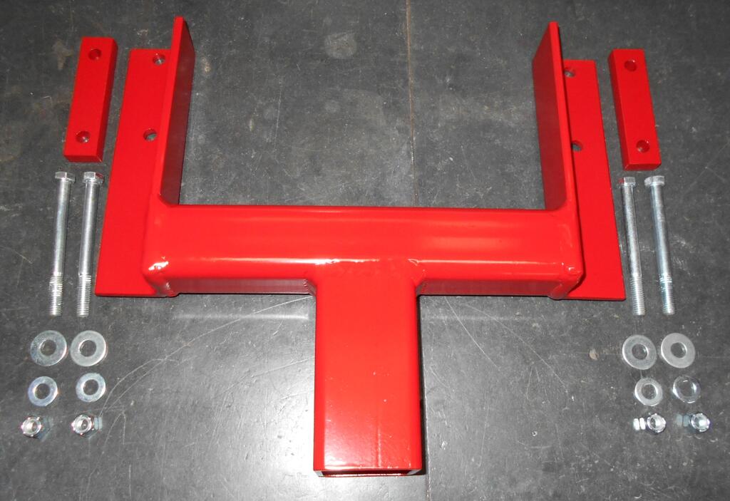

cleat 9,441 #288 Posted January 20 Rear receiver hitch ready to install. I made this up a few years ago at a previous work place. It is really just two pieces of 2" angle iron welded to a piece of 2" square tubing and the receiver is 2-1/2" square tubing. Rear receiver hitch sat in place held up by jack stand. Rear receiver hitch attaching hardware installed and loosely bolted up allowing a little free play to adjust hitch. Rear receiver hitch centered side to side. Rear receiver hitch bolts evenly snugged keeping hitch gently pulled rearward. Rear receiver hitch bolts torqued to 28 ft/lb. Rear receiver hitch installed. 5 3 Share this post Link to post Share on other sites

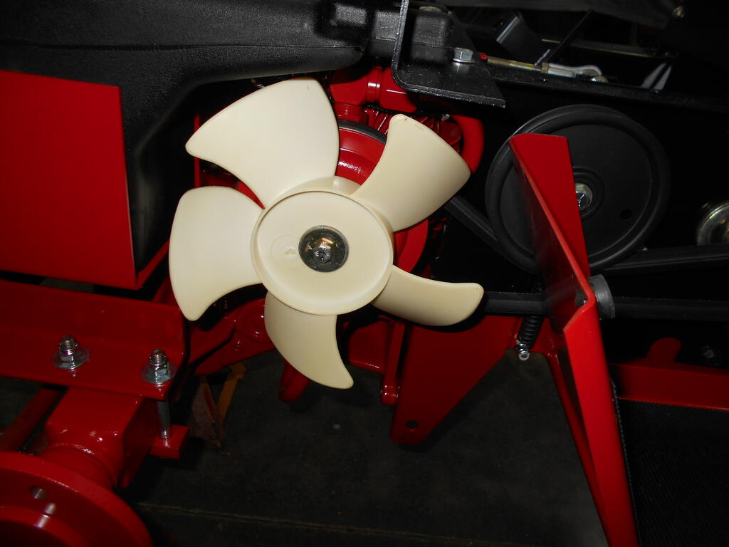

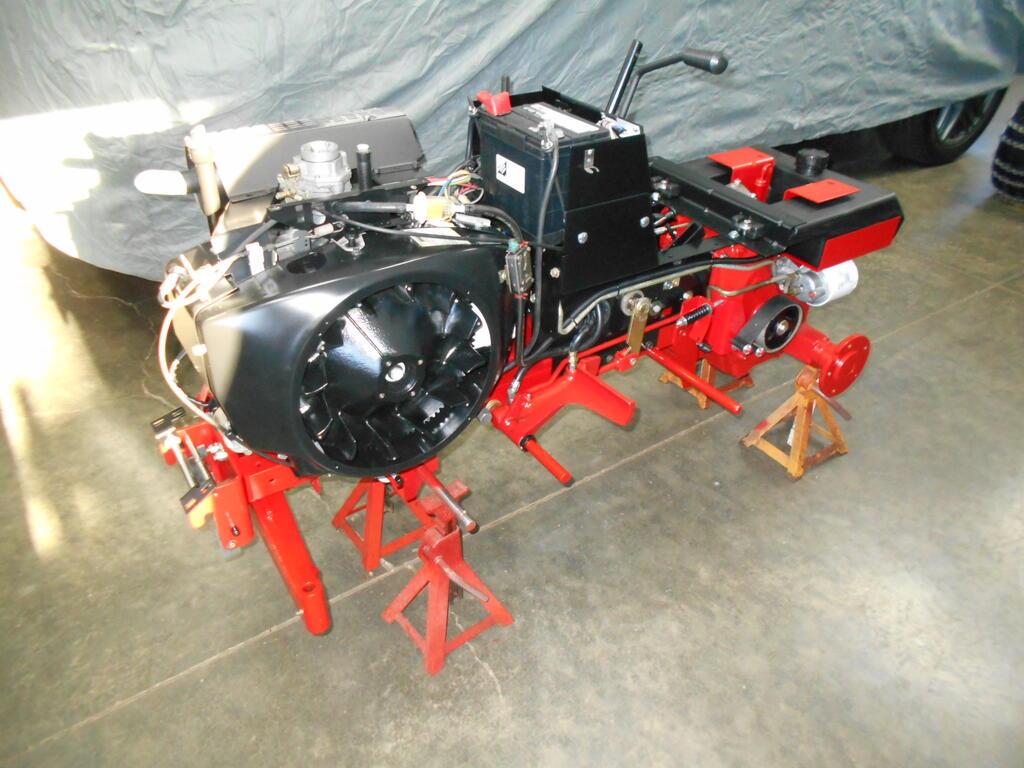

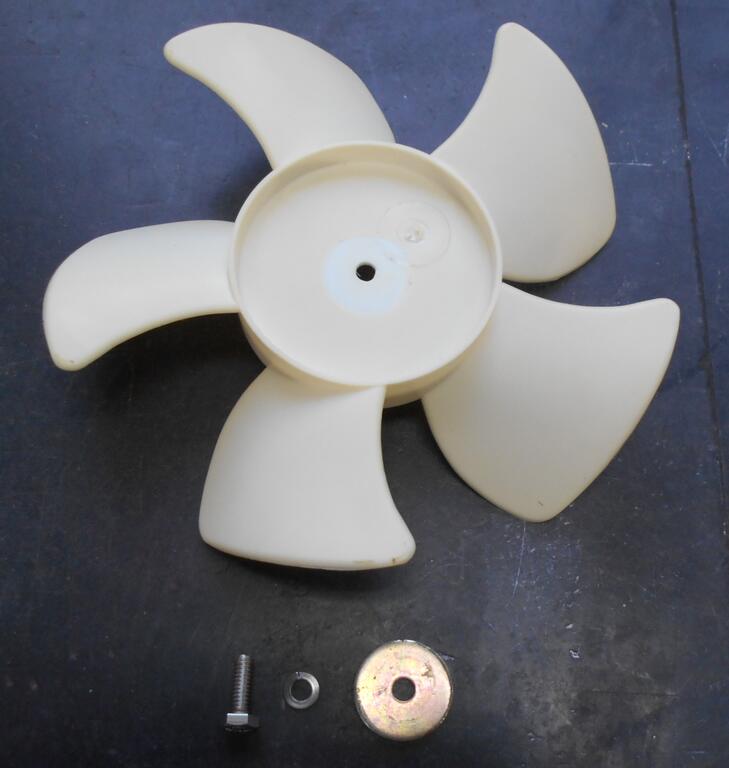

cleat 9,441 #292 Posted January 21 Hydro fan ready to install. Tractor ready for hydro fan ready to be installed. Hydro fan installed bolt torqued to 84 in/lb. Hydro fan installed. 2 Share this post Link to post Share on other sites
cleat 9,441 #293 Posted January 21 Here are the plans I drew up for the rear hitch. Wheel Horse heavy duty rear hitch plans.pdf And here are the plans for the flat plates to bolt the hitch on (two required). Rear hitch plate.pdf 3 1 Share this post Link to post Share on other sites

Bar Nuthin 3,639 #296 Posted January 22 11 hours ago, cleat said: Here are the plans I drew up for the rear hitch. Does your hitch have any type of diagonal brace for vertical support? Or, do you feel it's not needed? Obviously, mine required it because I used flat bar stock as a cross bar (hitch for my Cyclone Rake), and it also gets used to maneuver my stone trailer around. Plus, I think the diagonal takes a lot of stress off the bolts. 2 3 Share this post Link to post Share on other sites
cleat 9,441 #297 Posted January 22 9 hours ago, Bar Nuthin said: Does your hitch have any type of diagonal brace for vertical support? Or, do you feel it's not needed? Obviously, mine required it because I used flat bar stock as a cross bar (hitch for my Cyclone Rake), and it also gets used to maneuver my stone trailer around. Plus, I think the diagonal takes a lot of stress off the bolts. Yes that brace would add strength. When I designed and built mine I had not seen one before and did not think to add that brace. That said, I have four tractors with my design hitch and have moved some heavy loads without issue over the years. 2 1 1 Share this post Link to post Share on other sites

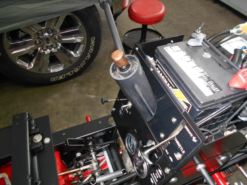

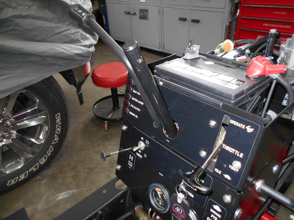

peter lena 10,123 #298 Posted January 22 @cleat that battery tray area is what stared me on , eliminating regular , consistent issues , also very simple , experimentation stage ? started with washers to firm up initial movement stage , of course , lucas green , to insure , that smooth / solid action , that led me to heim joint experimentation , on angularity movement change , you know where i,m going . your break down work , far exceeds mine , don,t have the set up for it . that led me to the next repetitive failure stage , every related bearing , was cleaned out and lucasized , with over rated lubrication , that led me to a " WHY NOT " trial of repetitive issue , you already know what fails , really like doing that . also say paint it red or black , and you don't even see it , for me I think bearing failure , is the basis of tractor issues . my first, deck rebuild , was the basis for my view on basics , used that as a foundation , to every stage , i,m at the end of my , tractor involvement , but like to see what's going on , retired millwright , pete Share this post Link to post Share on other sites

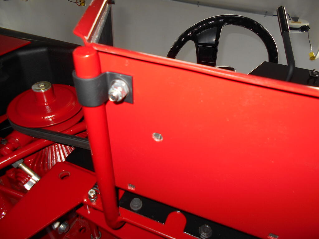

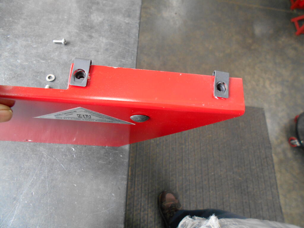

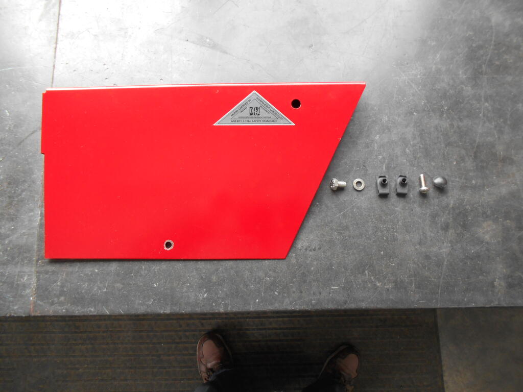

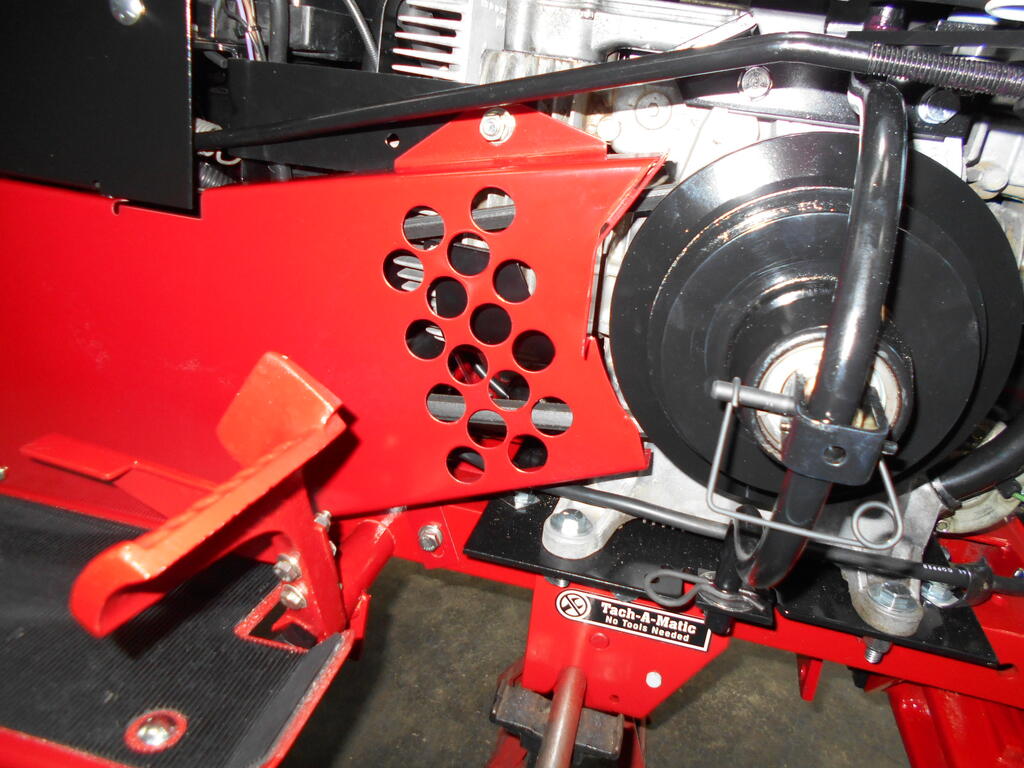

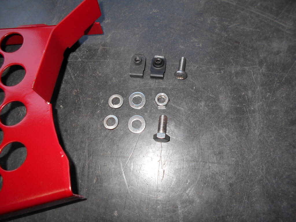

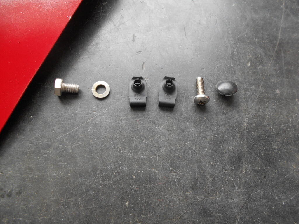

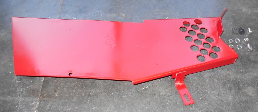

cleat 9,441 #299 Posted January 22 (edited) Right side cover ready to install. I punched some ventilation holes with an electrical knockout punch. This is a cover I had on hand and is not in perfect condition as it has some pitting and a wear hole at the very top. The one from this tractor originally had the bolt near the front for the plastic belt cover that I am not using on this build. Right side cover hardware ready to install. Tractor ready for right side cover to be installed. Right side cover speed nuts installed. Right side cover sat in place. Right side cover loosely bolted into place. Edited January 22 by cleat 3 4 Share this post Link to post Share on other sites
cleat 9,441 #300 Posted January 22 Left side cover ready to install. This is the side cover from the 520H that I converted to a 520-8 I like this cover better than the original one from this tractor as the paint is good and it has the OPEI sticker on it. Left side cover hardware ready to install. Left side cover rubber plug installed as I converted tractor to old style parking brake that comes up through shift plate. Left side cover ready for speed nuts to be installed. Left side cover speed nuts installed. Tractor ready for left side cover to be installed. Left side cover sat in place. Left side cover front bolt and bottom screw loosely installed. Top screws will be installed when the shift plate is installed. 7 Share this post Link to post Share on other sites
