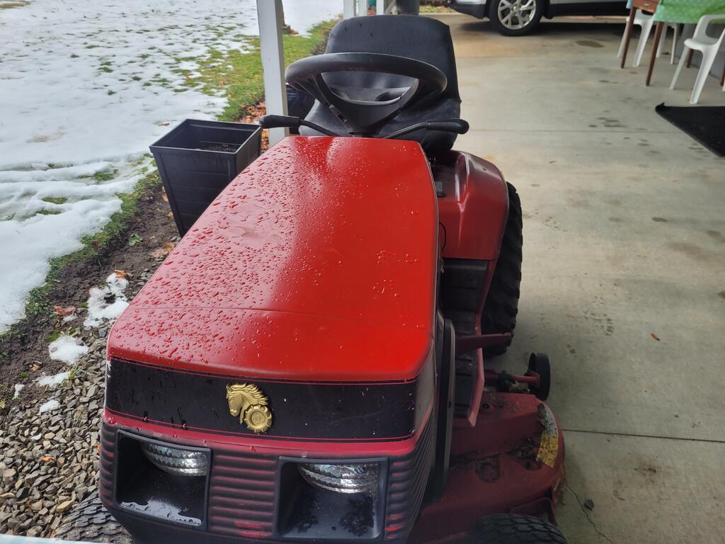

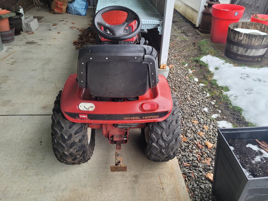

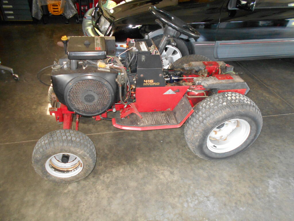

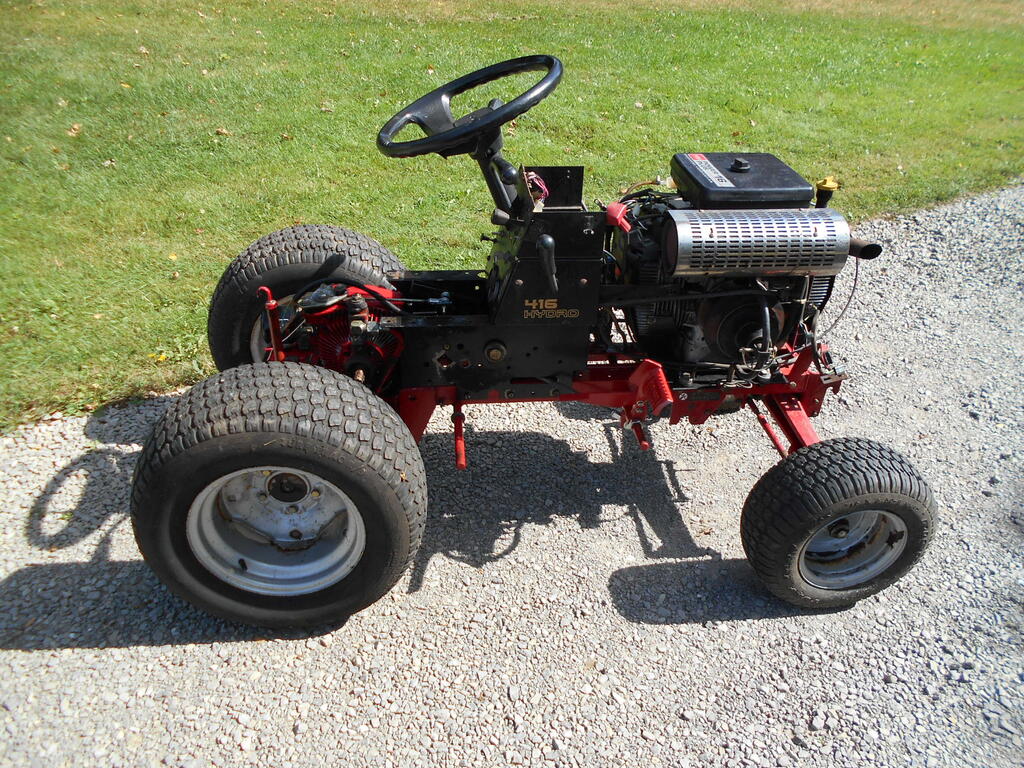

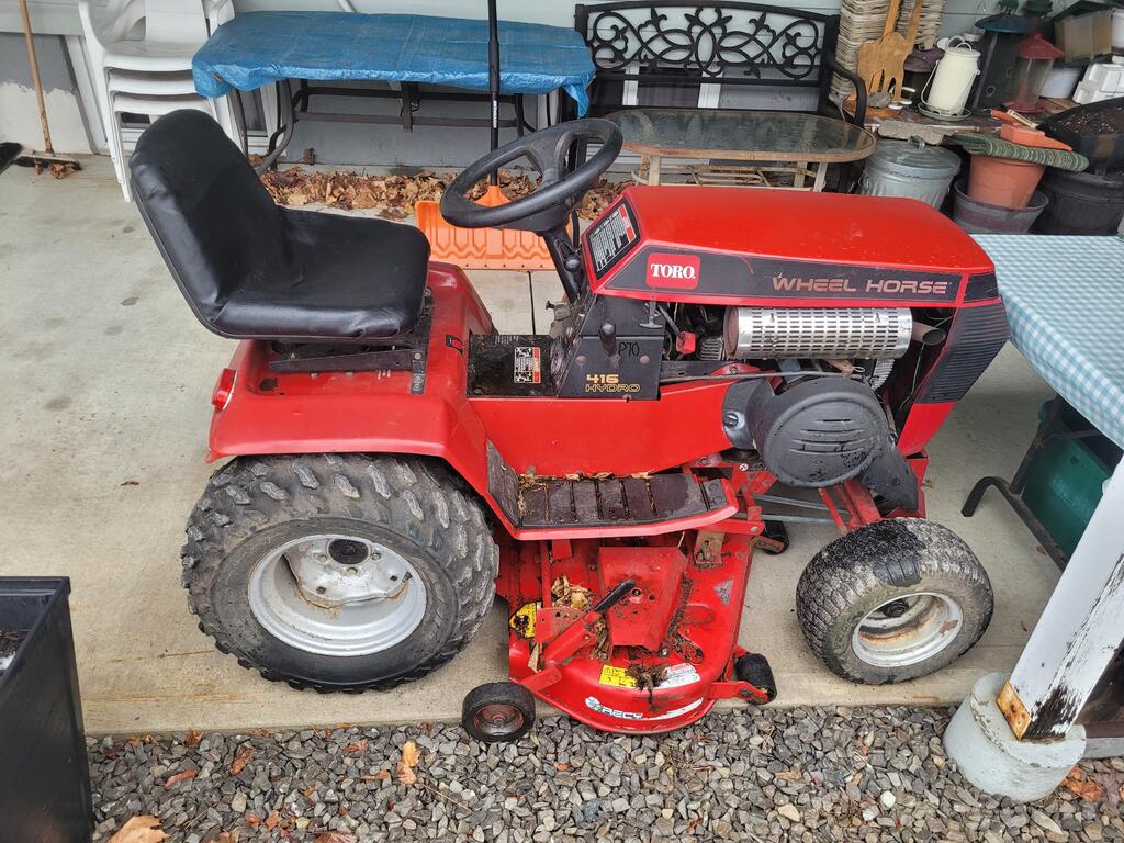

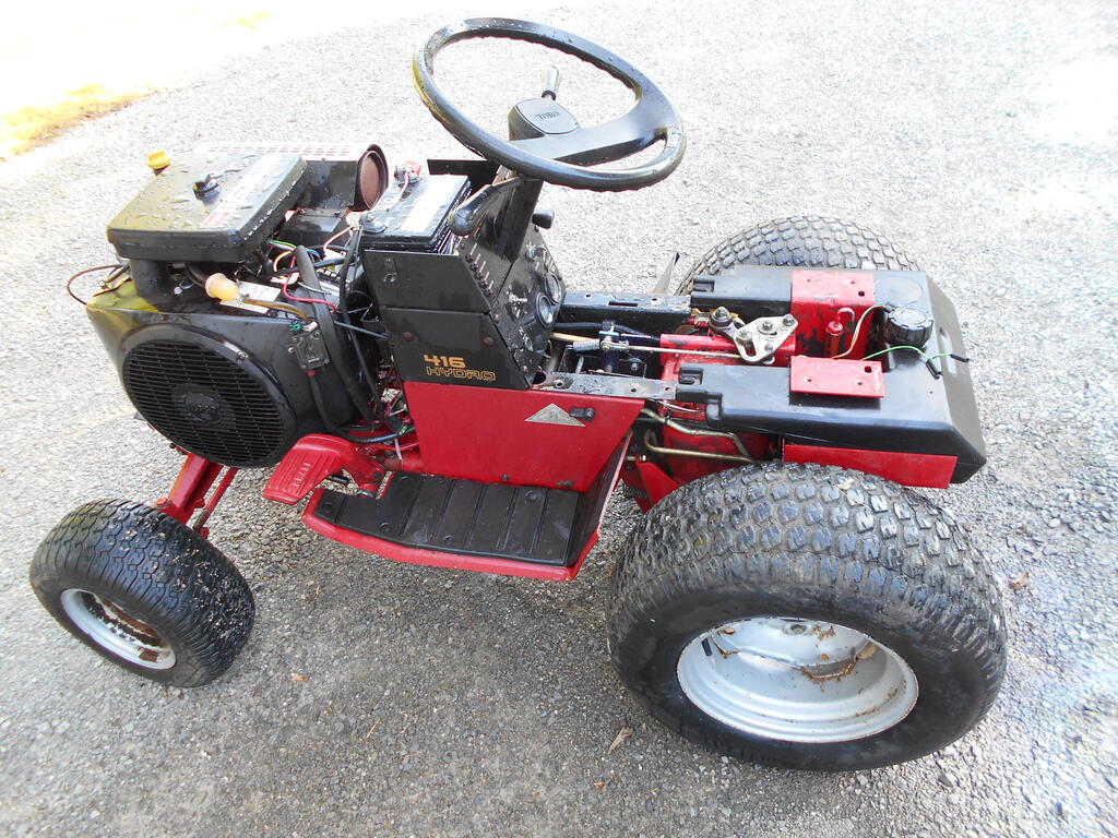

cleat 8,867 #1 Posted December 11, 2024 No mirror pics for this one because I bought it and just drove it over to my Mother in laws house just a few blocks away. Just poured in a gallon or so of fresh gas and swapped in a fully charged battery. It then started right up even though it was -10 degrees celsius or so out. Ran a little rough at first but by the time I got it to it's temporary home it was running smooth and quiet. Hydro lift and drive both work perfectly. Deck might be seized or frozen, I will deal with that later. Has oversize tires on it, not sure what I am going to do about that. I did not make note of the hours or if the hour meter even works as the volt gauge does not. 6 19 Share this post Link to post Share on other sites

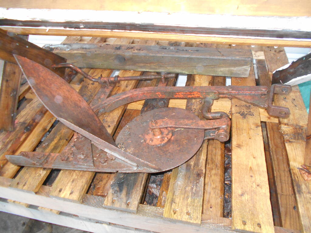

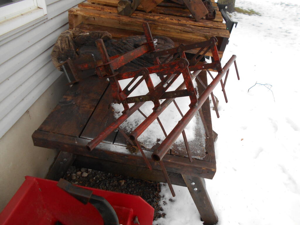

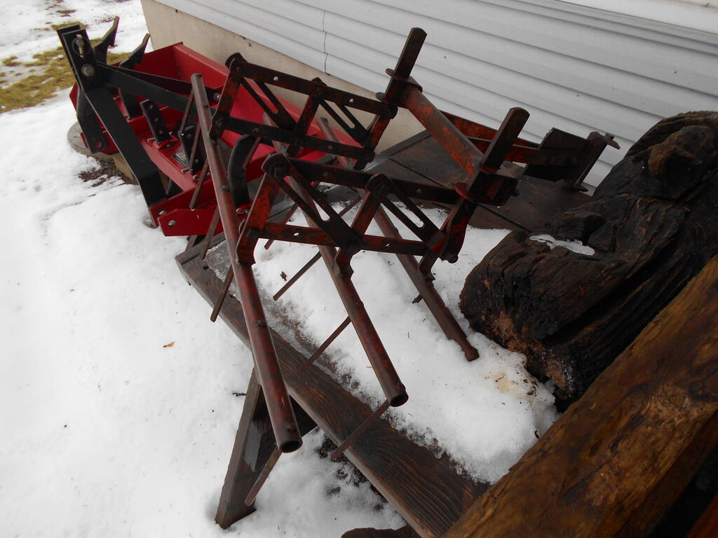

cleat 8,867 #3 Posted December 11, 2024 Seller threw these in as well. Tractor does not have the rear lift but just some contraption bolted to the rear hitch to adapt to these. However, I do have the proper sleeve hitch and lift on a couple of my machines so I can use them. 4 6 Share this post Link to post Share on other sites
Treepep 1,099 #4 Posted December 11, 2024 Well that's worth the price of admission! Excellent 1 Share this post Link to post Share on other sites
Achto 31,415 #5 Posted December 12, 2024 Awesome tractor !! The implements look like they are originally for a Simplicity walk behind tractor. 1 Share this post Link to post Share on other sites
oliver2-44 11,333 #6 Posted December 12, 2024 (edited) 5 hours ago, cleat said: Do I recall that the Gold Horse Hood Ornament was used on the WH anniversary year tractors? Amazing that the tractor started and ran at -10 C. That was one cold tractor ride. Being from Texas, I sure don’t run at that temp! Edited December 12, 2024 by oliver2-44 3 Share this post Link to post Share on other sites
cleat 8,867 #7 Posted December 12, 2024 2 hours ago, oliver2-44 said: Do I recall that the Gold Horse Hood Ornament was used on the WH anniversary year tractors? Amazing that the tractor started and ran at -10 C. That was one cold tractor ride. Being from Texas, I sure don’t run at that temp! Actually, it was a nice ride. I have not even got a winter coat out yet, just a sweat shirt and light plaid jacket. Topped off with a ball cap. No gloves required for a day that nice either. And just a couple of months ago it was in the 30's (around 88 degrees F) You just adapt. I don't bother fixing the AC in any of my old cars but need the heat to de-ice the windshield in the winter. Share this post Link to post Share on other sites

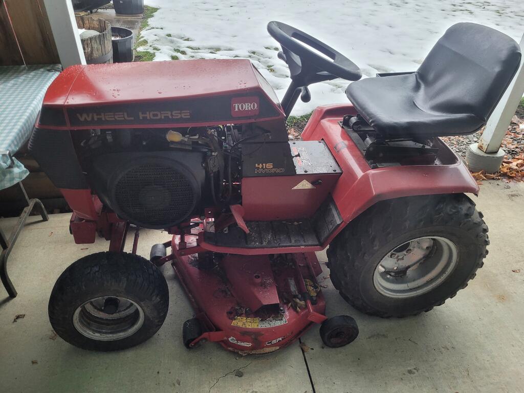

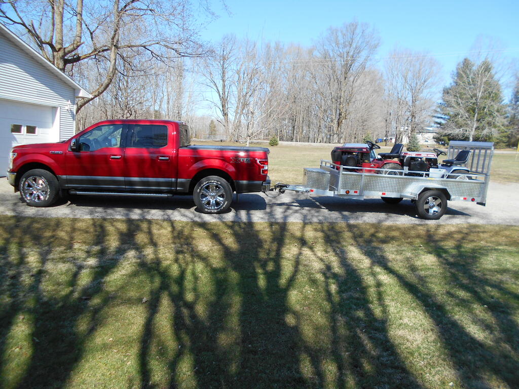

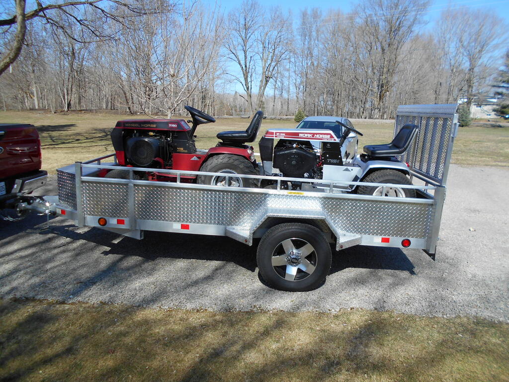

cleat 8,867 #10 Posted April 18, 2025 Finally brought the 416 home from the mother-in-laws place. When I got home I thought I would drive the GT1600 onto the trailer to ensure two tractors would fit. They do. Trailer dropped down 1" (from 4" fender to tire to 3" fender to tire) with the weight of the tractors so I am happy with that as well. 3 5 Share this post Link to post Share on other sites

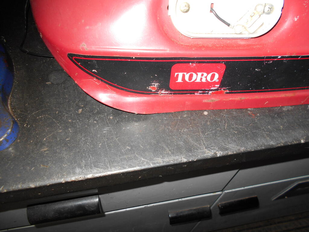

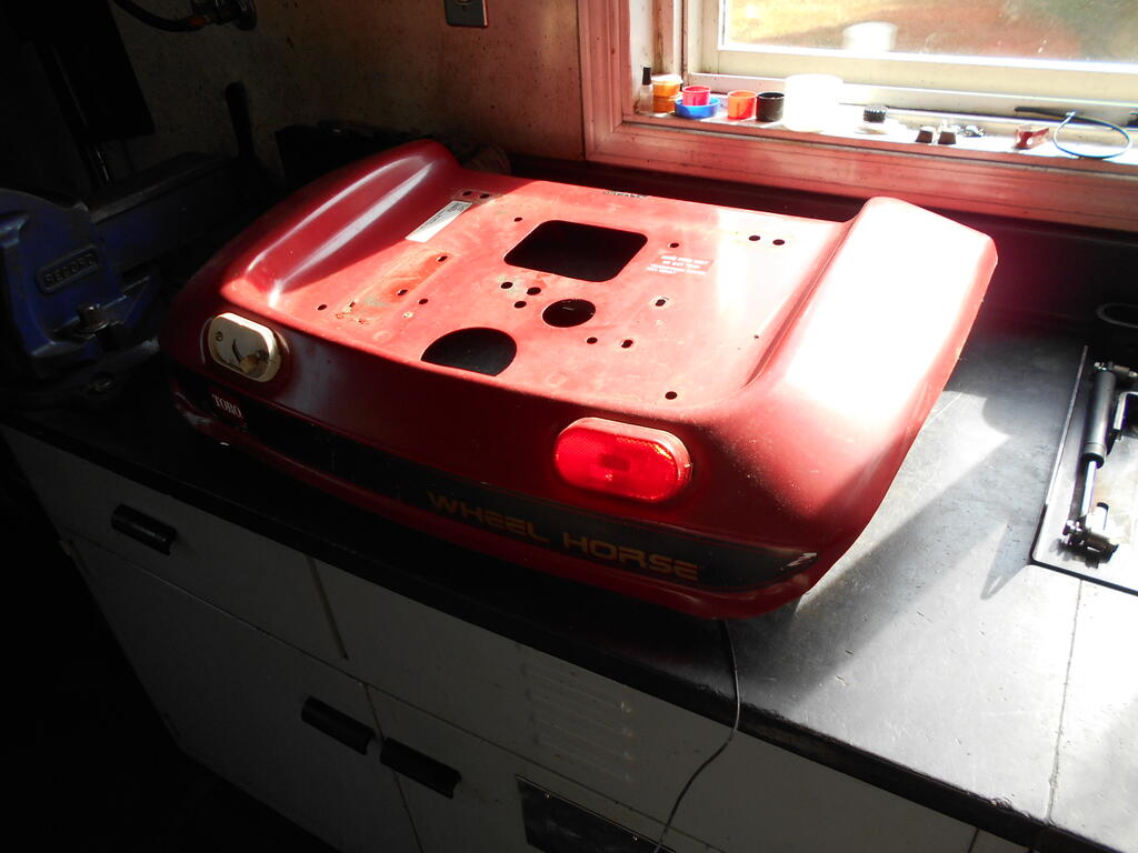

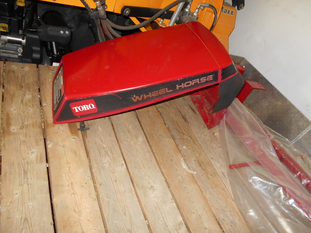

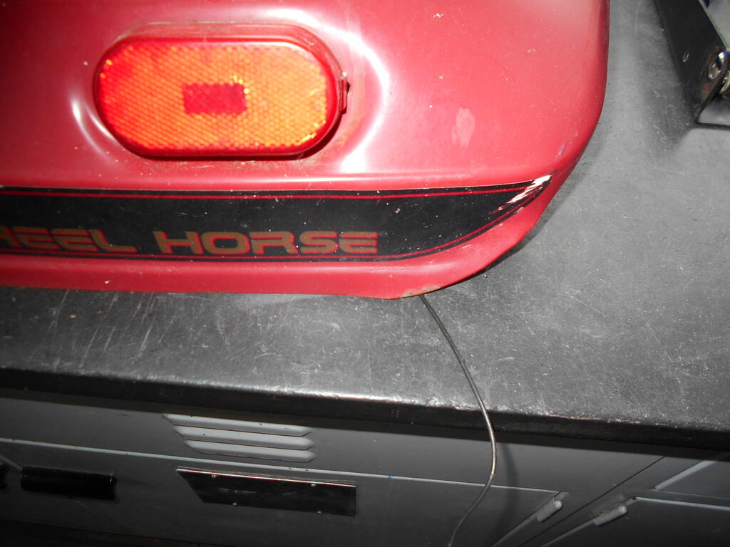

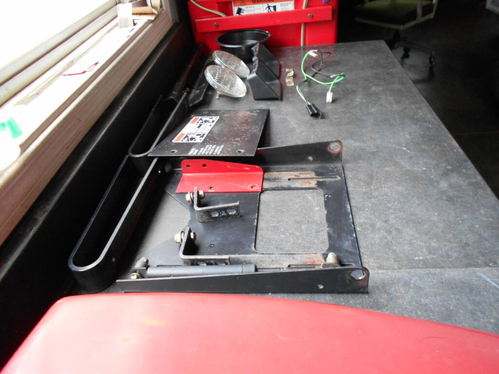

cleat 8,867 #11 Posted August 17, 2025 Well the teardown has started. Hood and fender removed. Hood set aside for now. These parts are cleaned up. You can see the bends in the fender that the PO did to clearance the oversize tires. I will attempt to straighten these. 1 3 Share this post Link to post Share on other sites

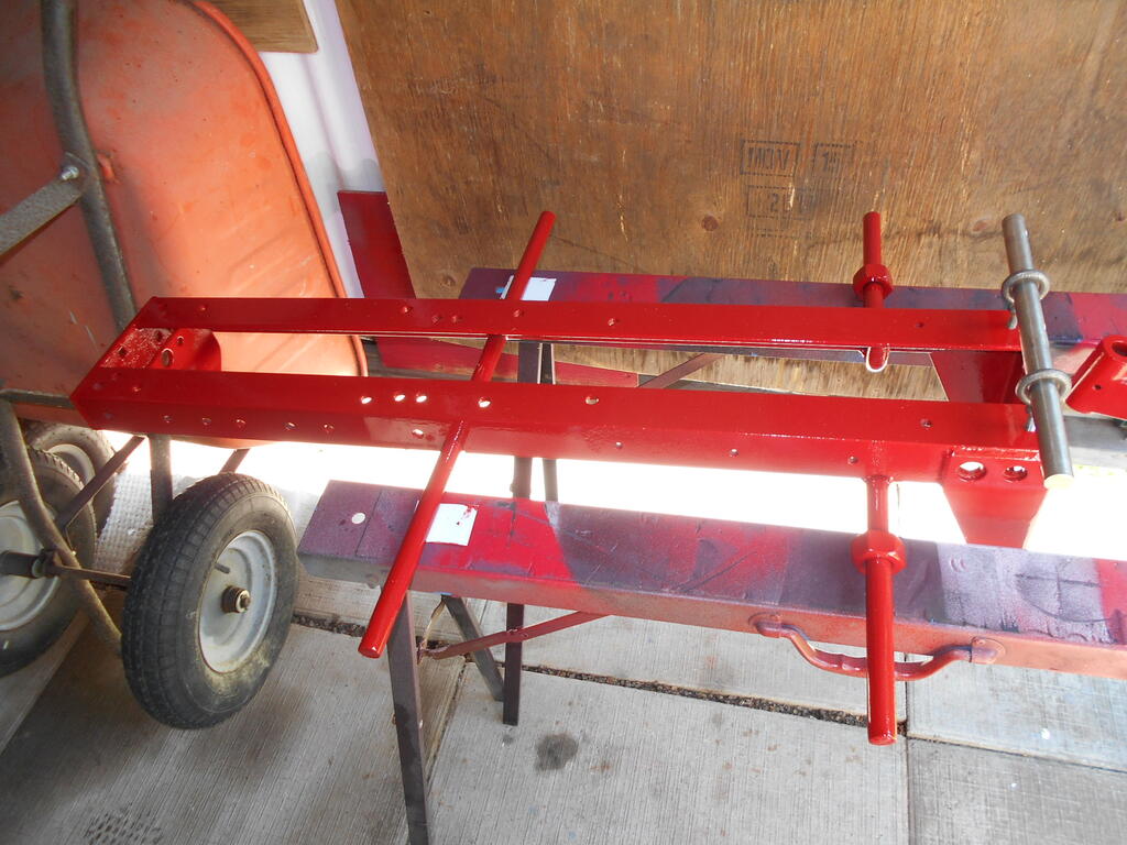

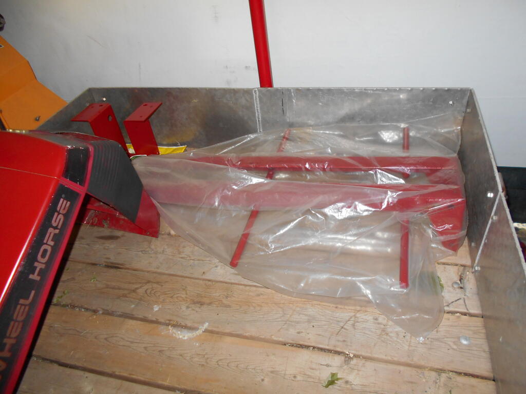

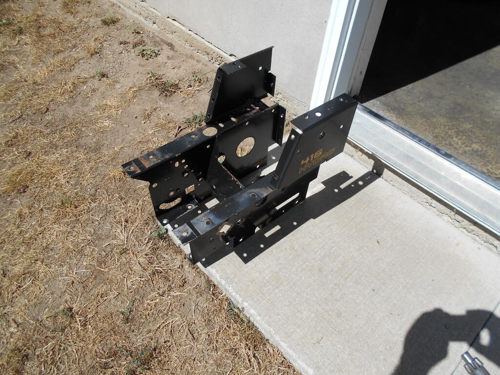

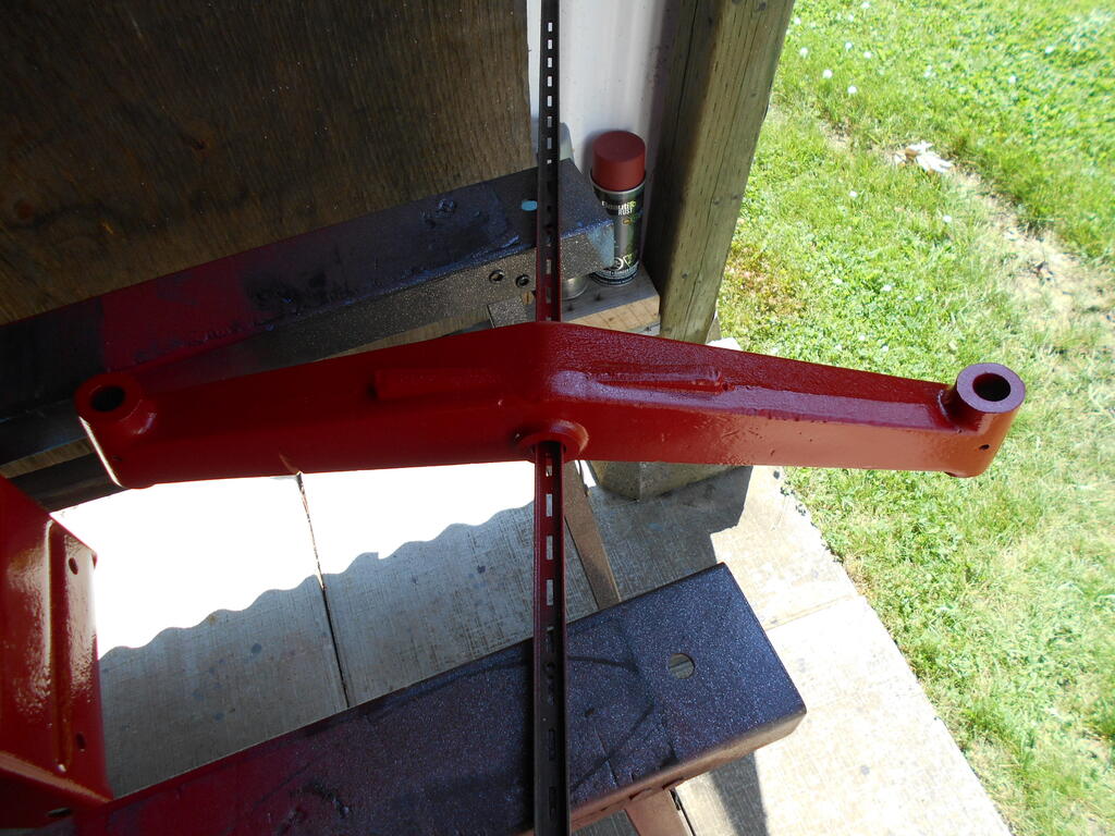

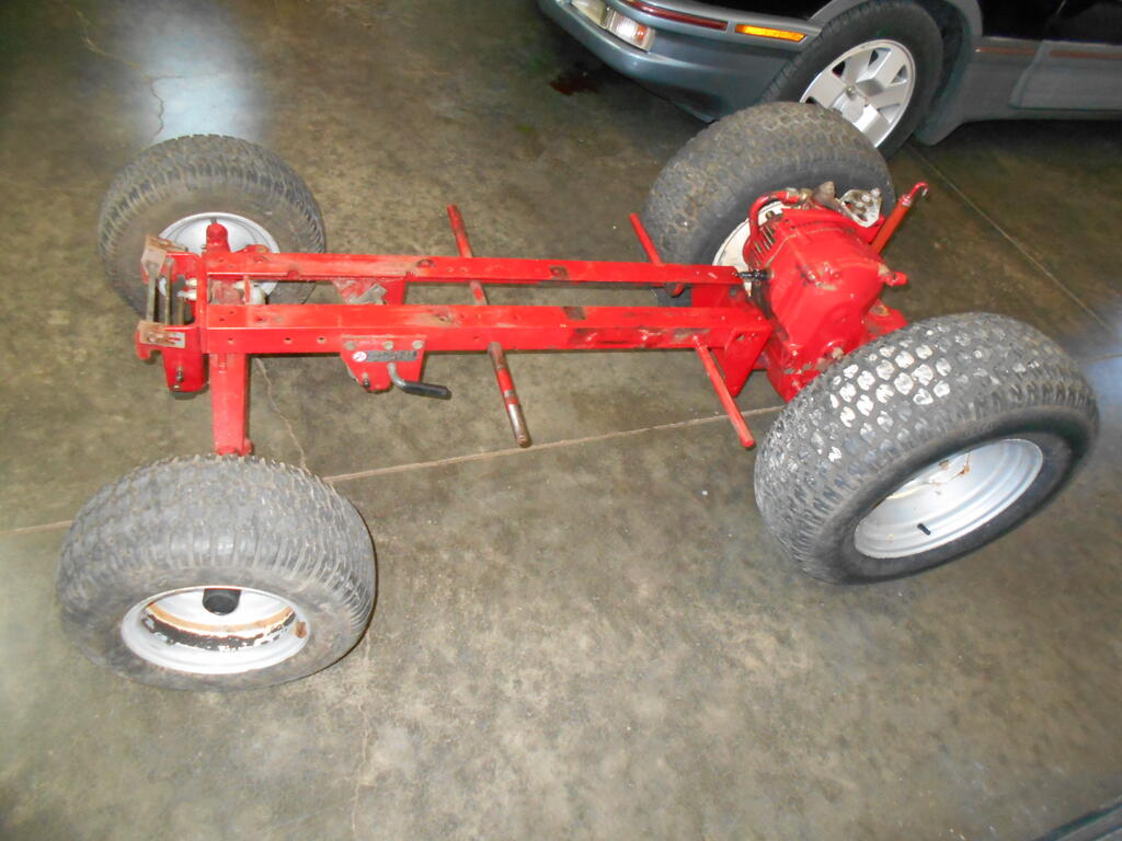

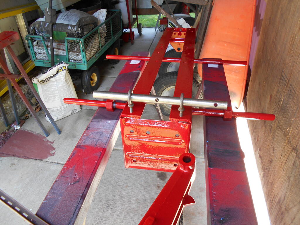

cleat 8,867 #12 Posted August 17, 2025 Spare frame has been painted and is ready to be used on this tractor. I want this one because it has the longer foot rest support bars used with the early foot rests. The new style foot rests with the rubber pads have shorter bars. Frame set aside for now. 2 4 Share this post Link to post Share on other sites

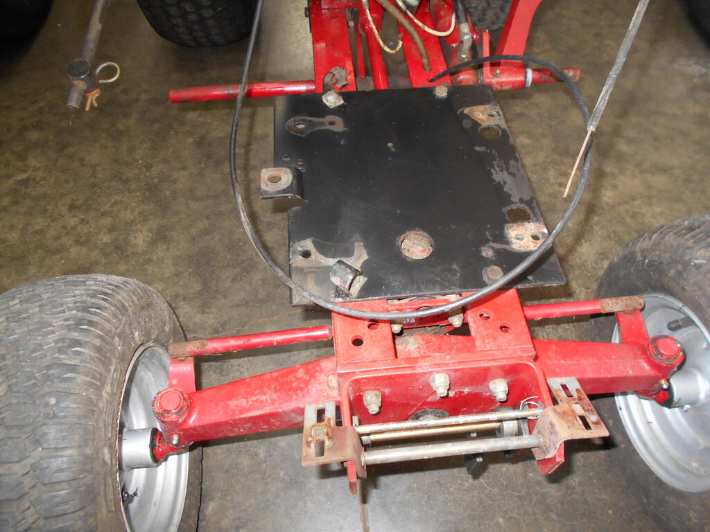

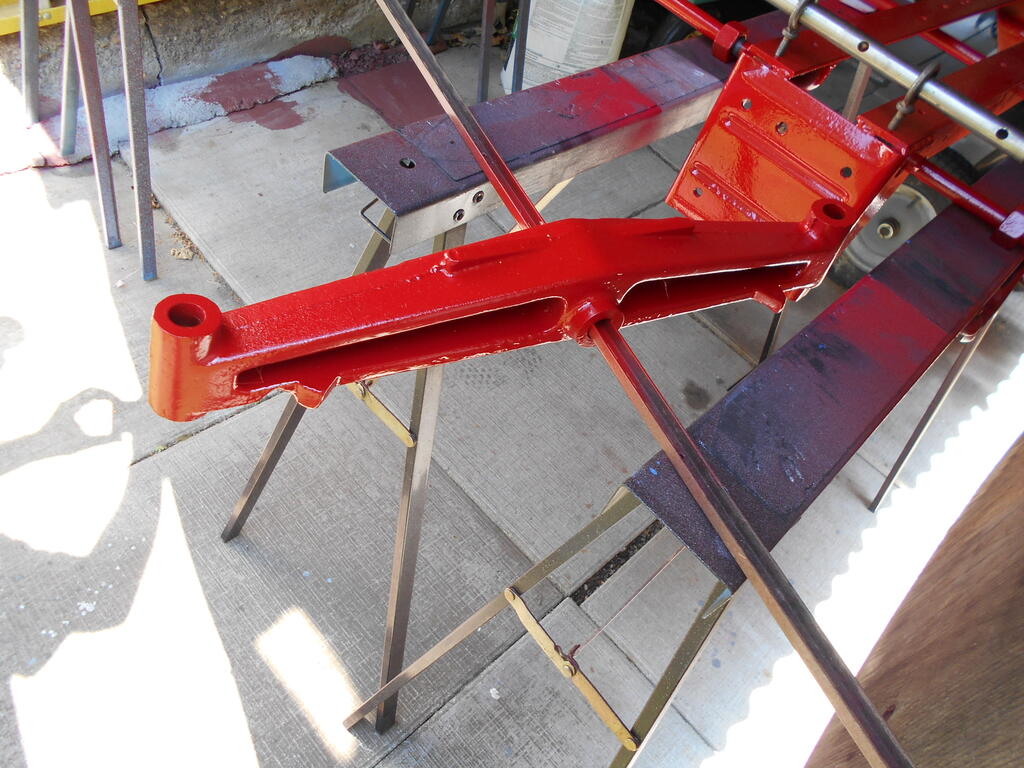

cleat 8,867 #13 Posted August 17, 2025 Spare front axle cleaned up and painted. I will do the same to the one from this 416 and use the best one on final assembly. 4 6 Share this post Link to post Share on other sites

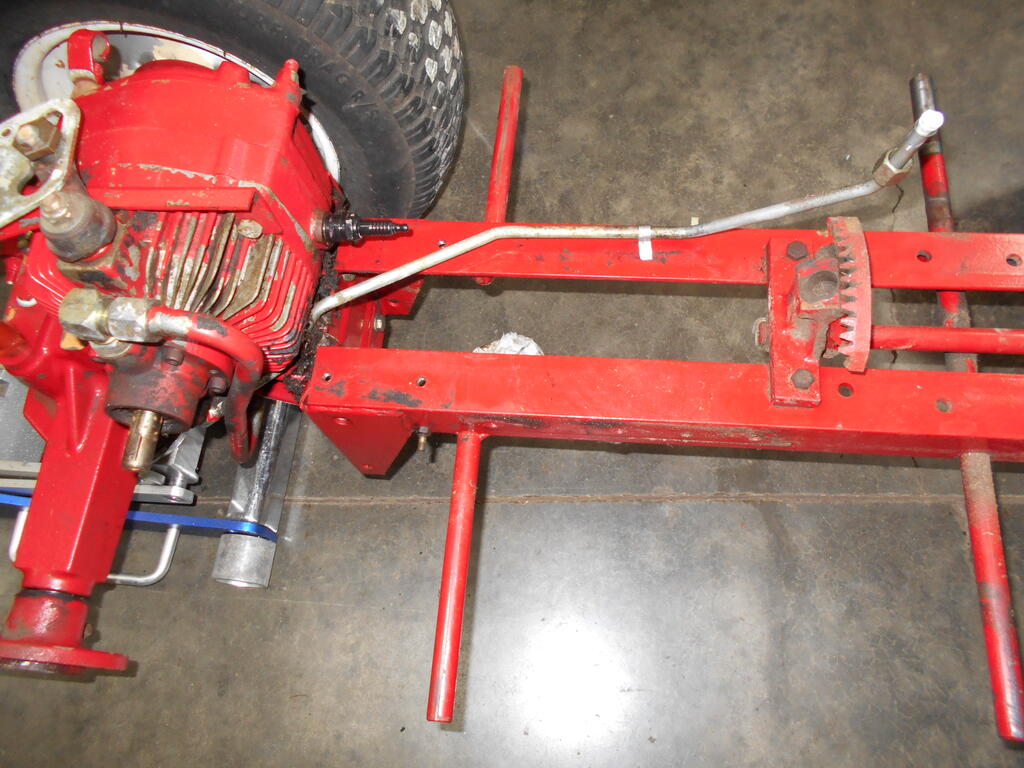

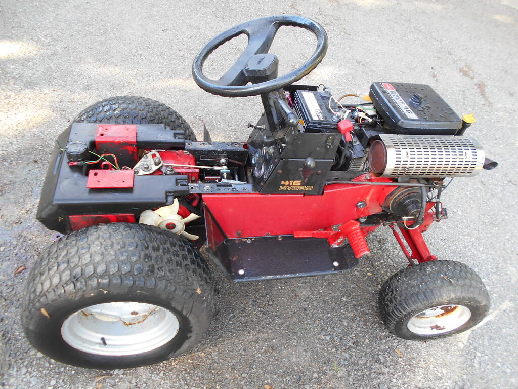

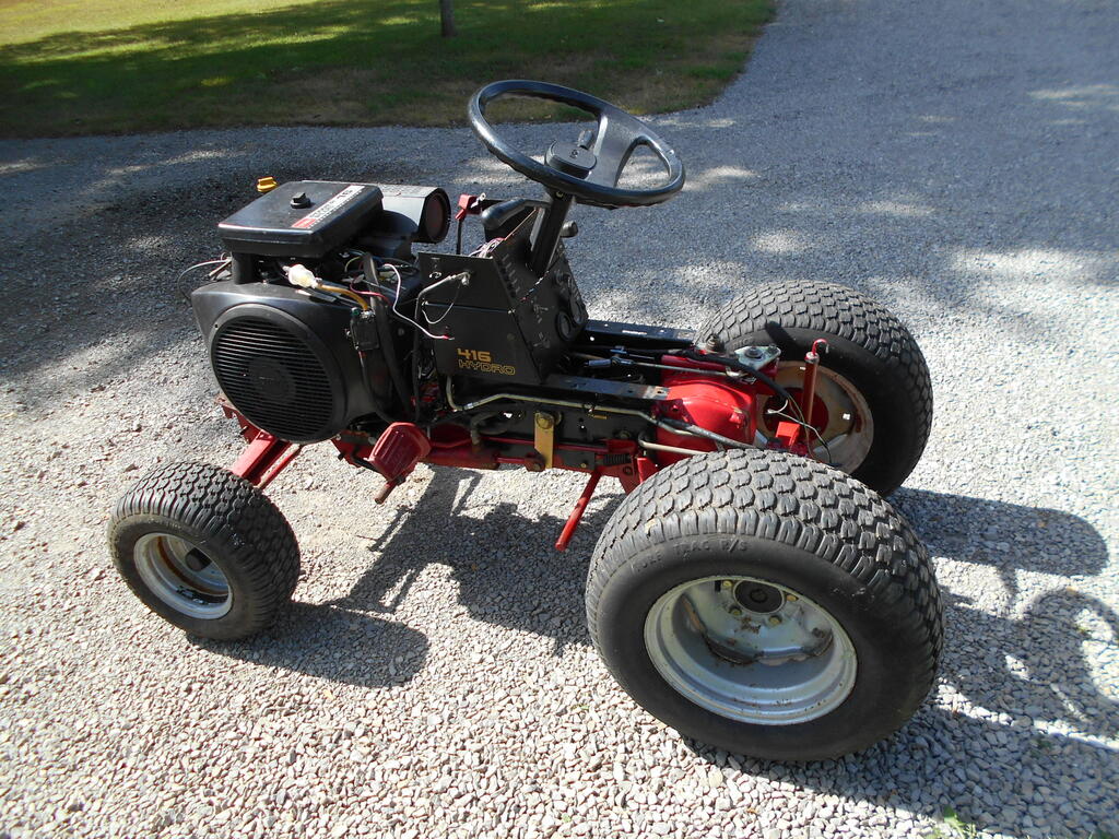

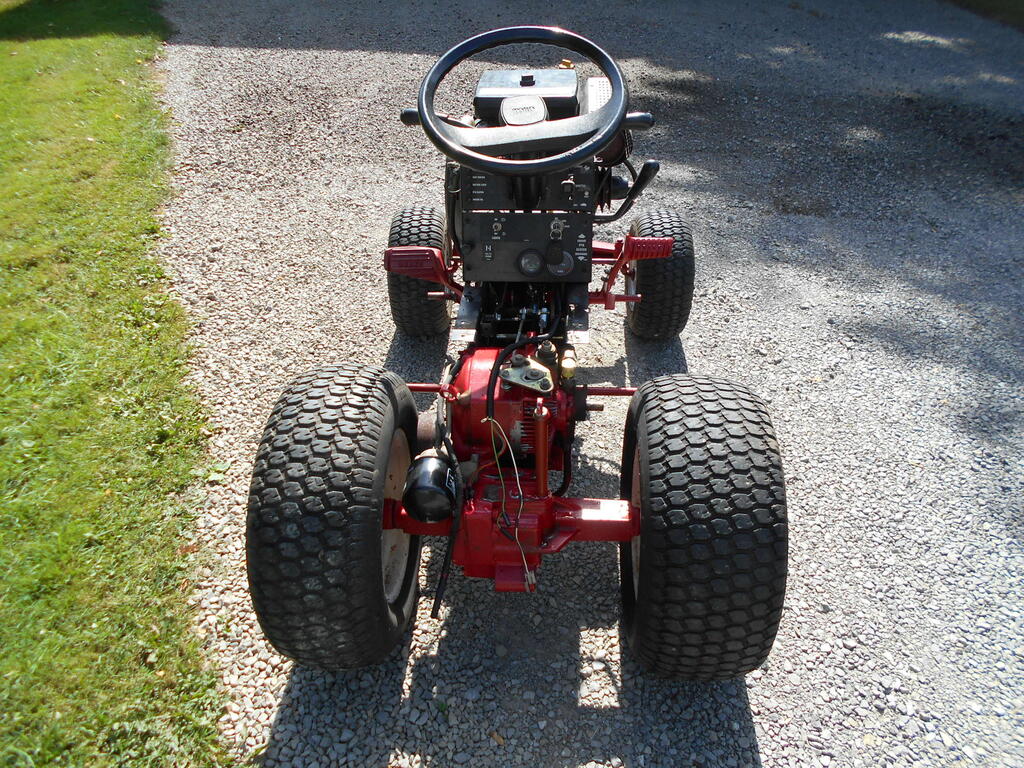

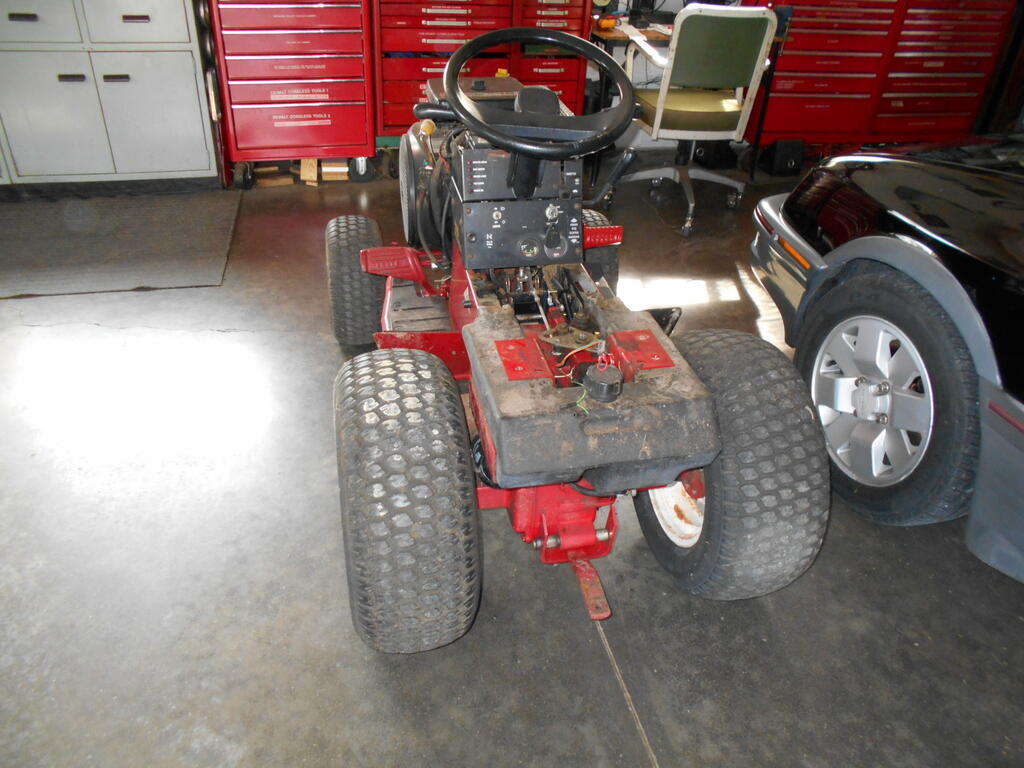

cleat 8,867 #15 Posted August 18, 2025 Hosed tractor off to get the big chunks removed. Removed fuel tank and fender support bracket, side covers and foot rests, drive belt, drive pulley and fan, All parts removed have been degreased and washed. Tractor degreased. 7 Share this post Link to post Share on other sites

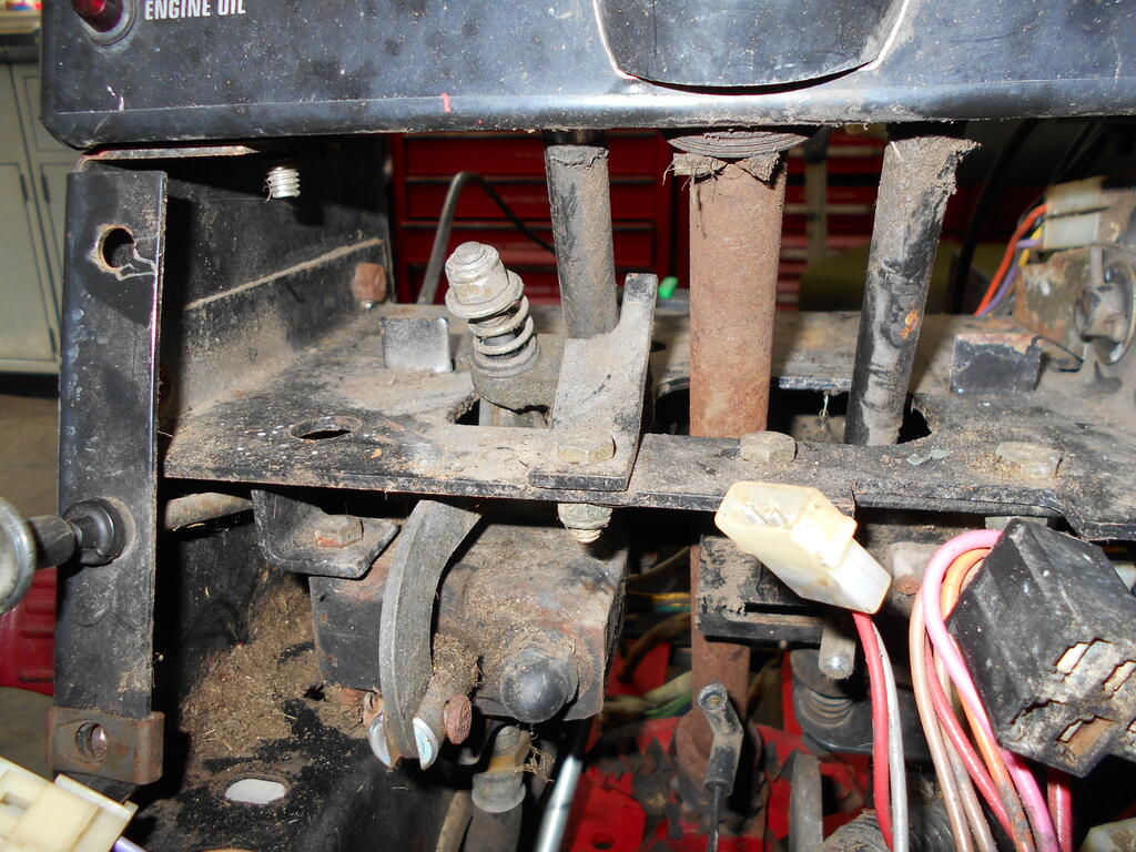

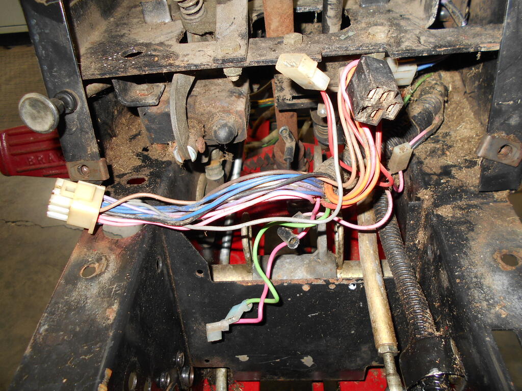

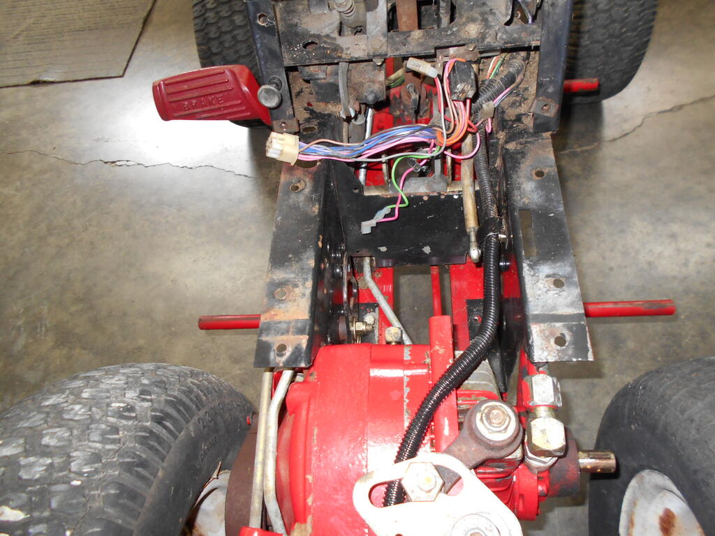

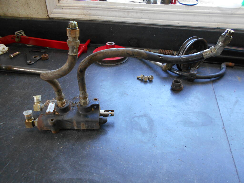

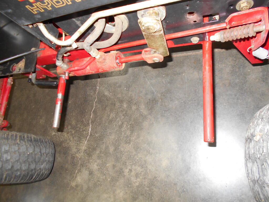

cleat 8,867 #16 Posted August 19, 2025 (edited) More disassembly completed. Wire harness as found. Hydraulic return lines at filter Hydraulic control valve linkage as found. Edited August 19, 2025 by cleat 3 Share this post Link to post Share on other sites

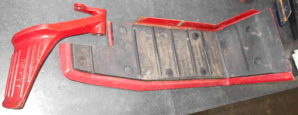

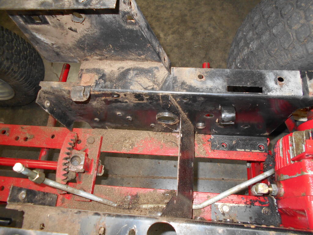

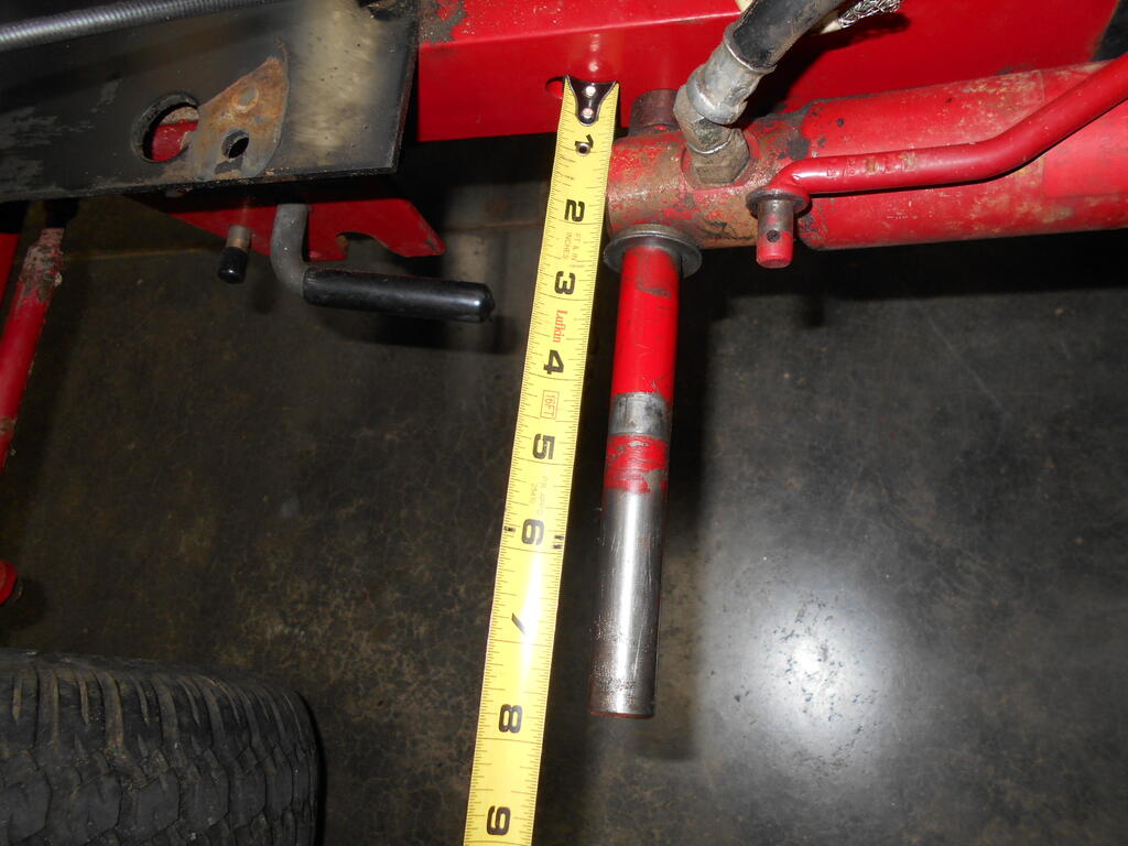

ebinmaine 77,971 #17 Posted August 20, 2025 On 8/17/2025 at 9:18 AM, cleat said: Spare frame has been painted and is ready to be used on this tractor. I want this one because it has the longer foot rest support bars used with the early foot rests. The new style foot rests with the rubber pads have shorter bars. Can you please elaborate on this? Years used? Actual measured difference? I'm interested to know for the build of our future Backhoe chassis. 1 Share this post Link to post Share on other sites

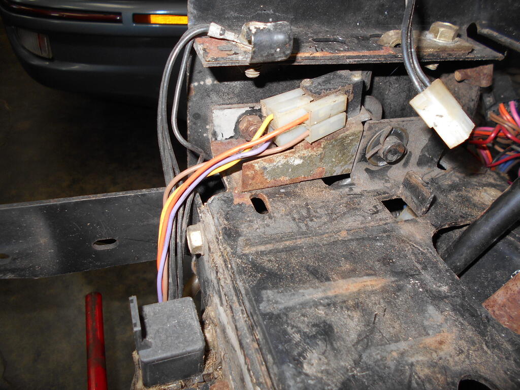

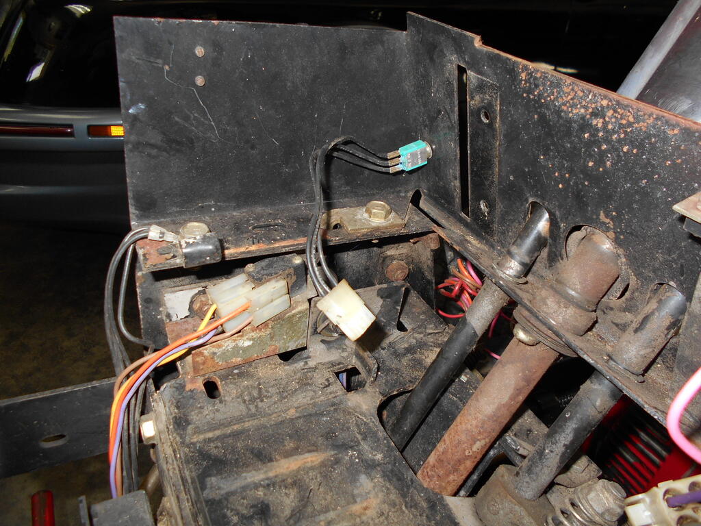

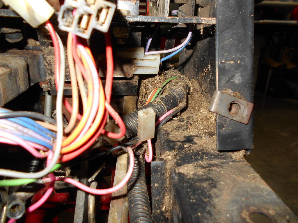

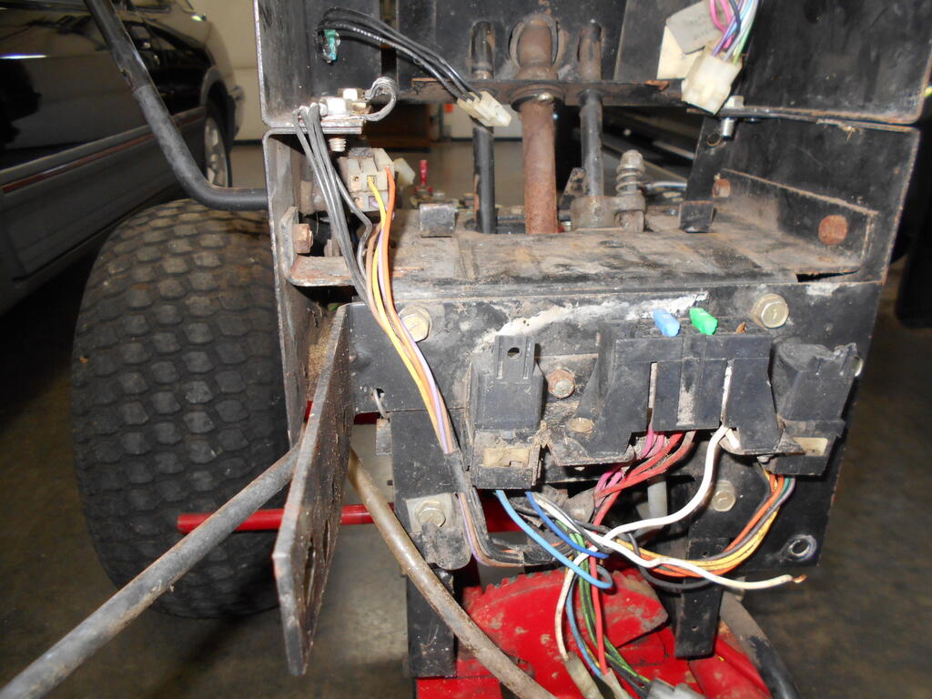

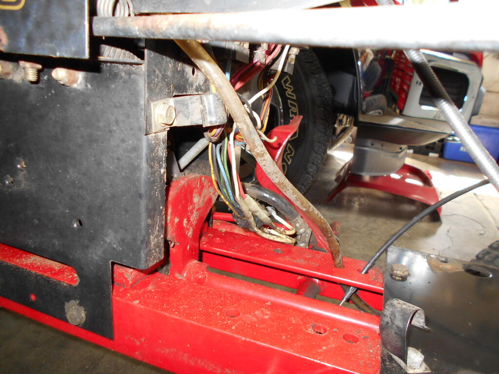

ebinmaine 77,971 #19 Posted August 20, 2025 @cleat Looks like some of that harness got a little toasty. Easy fixes? 1 Share this post Link to post Share on other sites

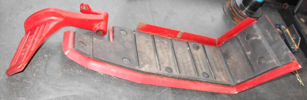

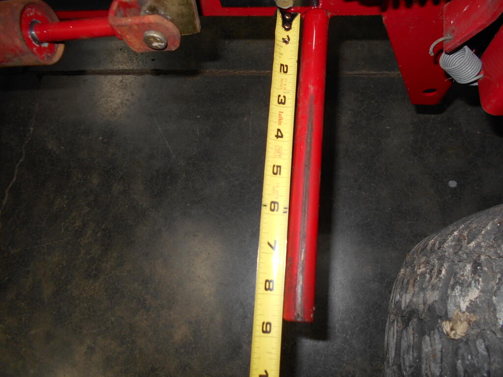

cleat 8,867 #20 Posted August 20, 2025 56 minutes ago, ebinmaine said: Can you please elaborate on this? Years used? Actual measured difference? I'm interested to know for the build of our future Backhoe chassis. Sure. This picture shows an older style frame with the equal length foot rest bars. This is the late model frame with the shorter front bar. Here are the measurements of the late model bars. This is the foot rest and pedal used on the late model frame. 2 1 Share this post Link to post Share on other sites
cleat 8,867 #21 Posted August 20, 2025 59 minutes ago, ebinmaine said: @cleat Looks like some of that harness got a little toasty. Easy fixes? I will be pulling the harness and rebuilding it to repair any issues and to modify it to suit my needs. 9 pin will also be replaced with new. 4 Share this post Link to post Share on other sites

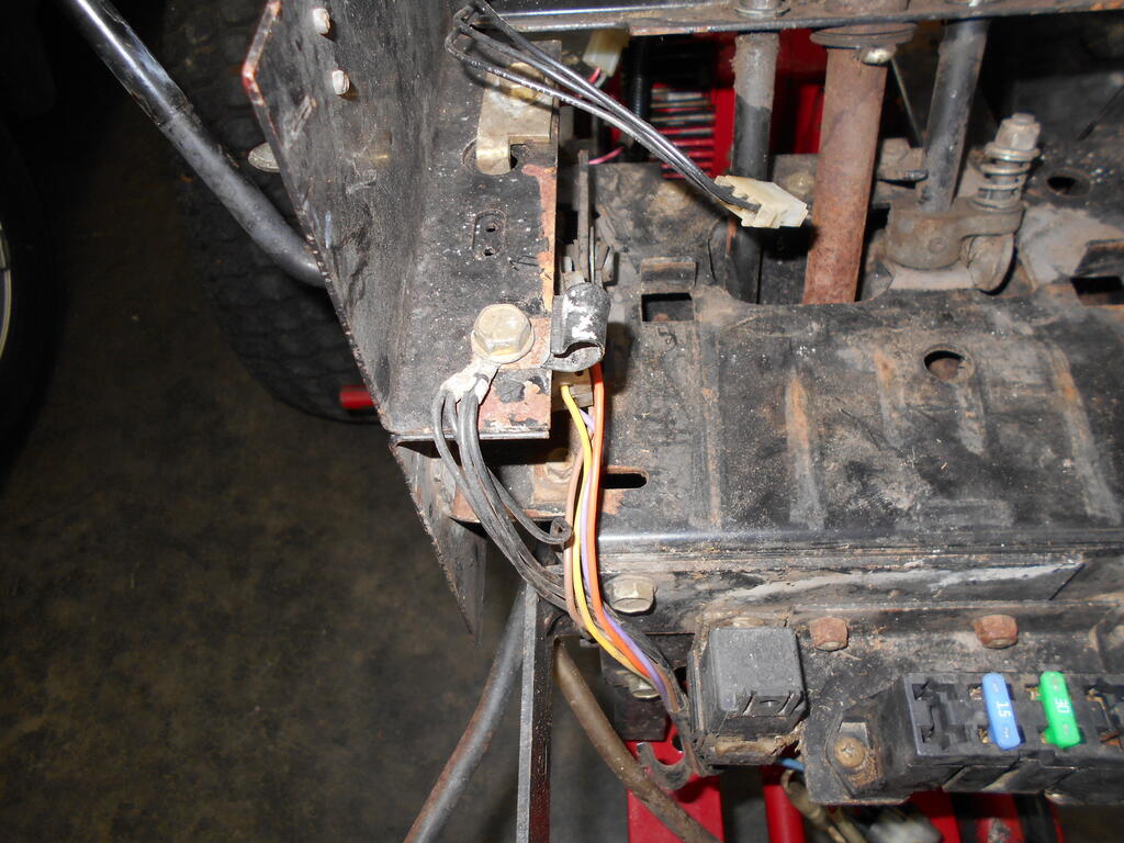

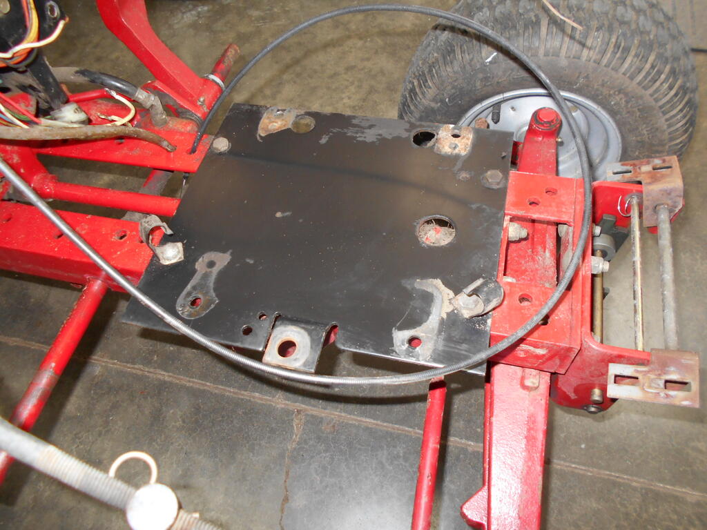

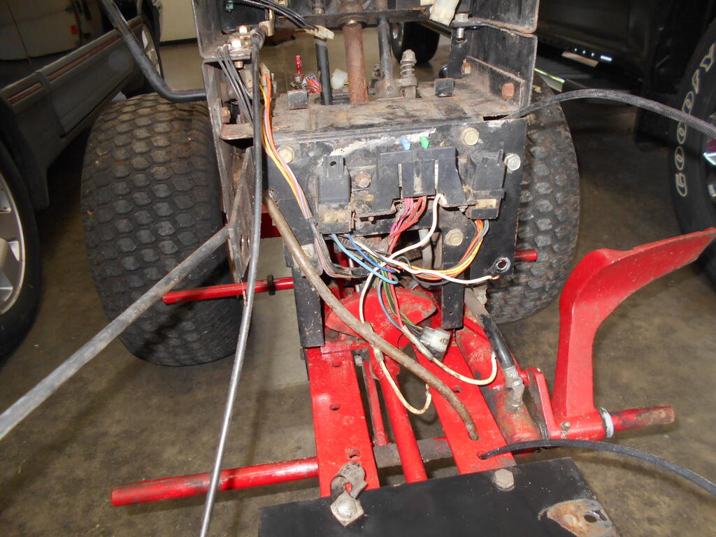

cleat 8,867 #22 Posted August 22, 2025 Wire harness routing as found. 3 Share this post Link to post Share on other sites

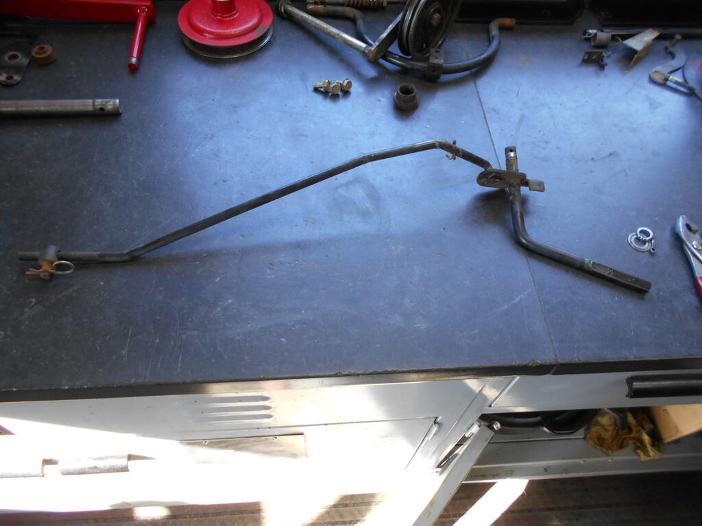

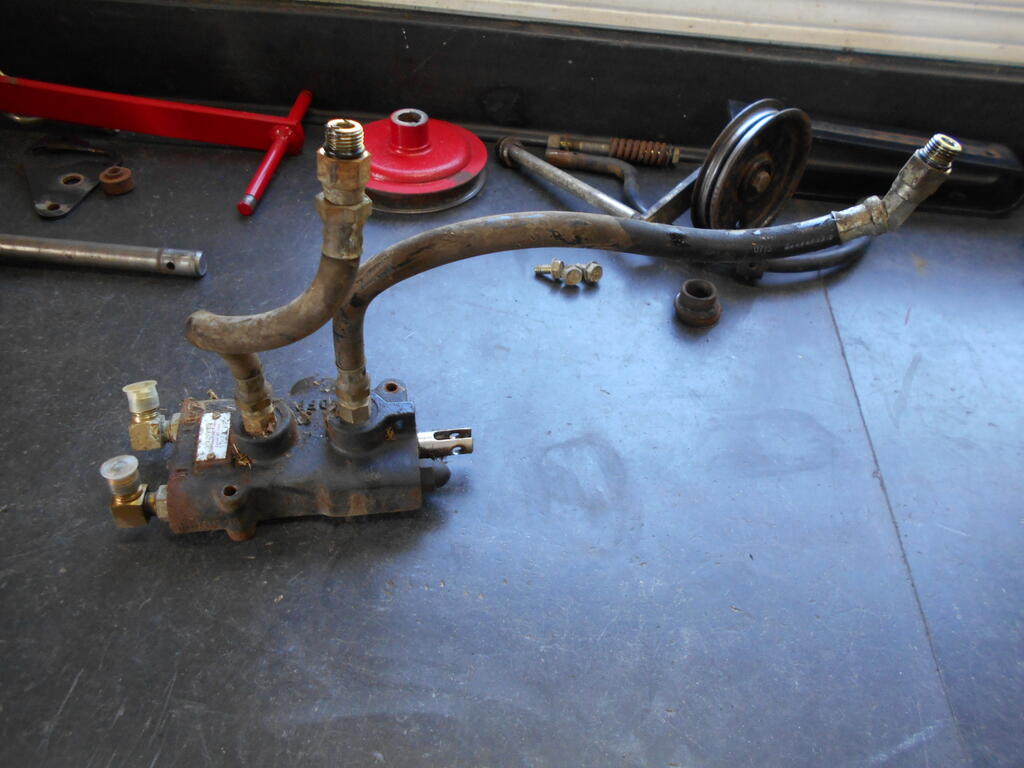

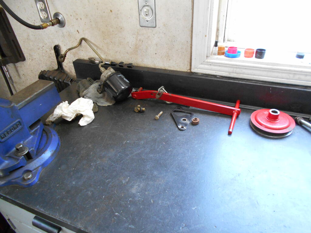

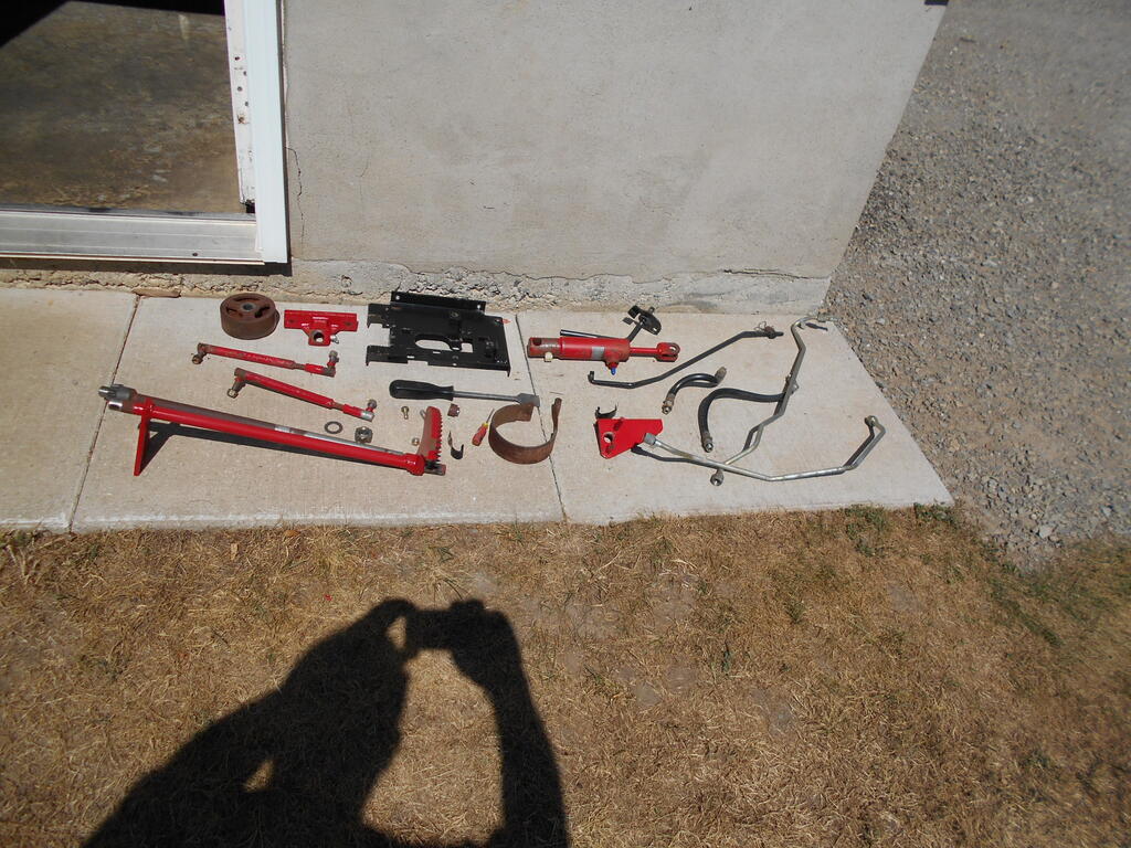

cleat 8,867 #23 Posted August 22, 2025 Hydraulic supply line as found. Hydraulic valve and cylinder hoses as pulled. PTO lever and rod as pulled. Wire harness retaining clips as found. 3 Share this post Link to post Share on other sites

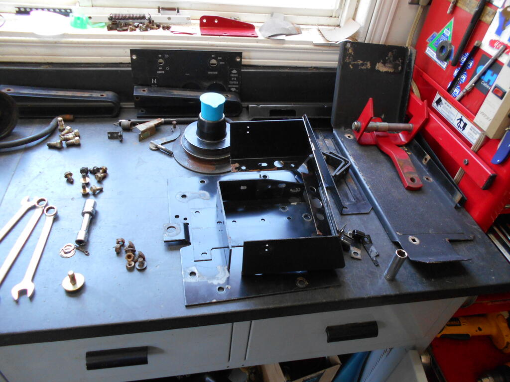

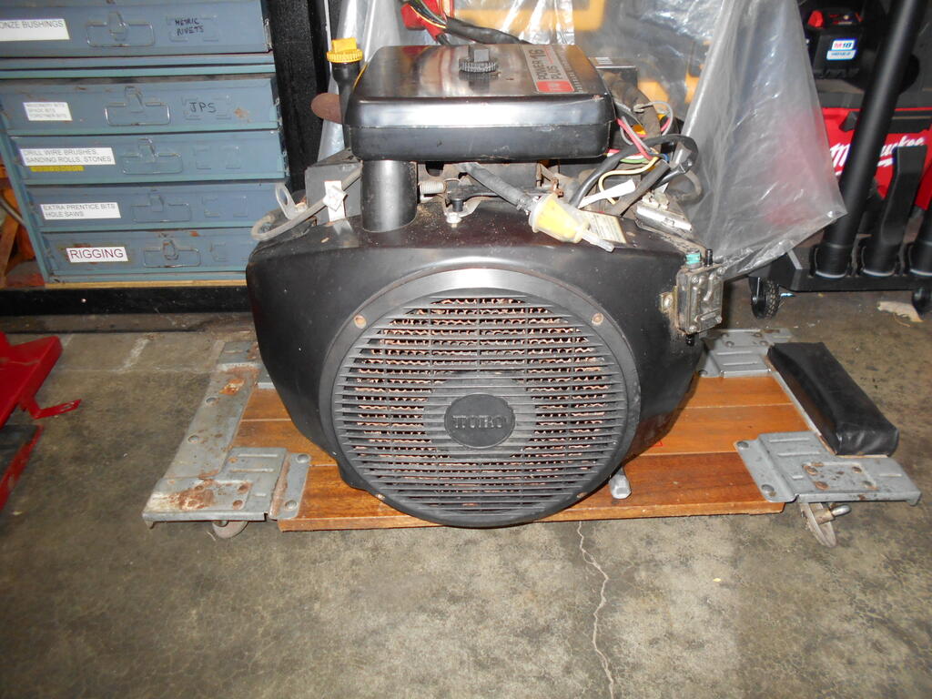

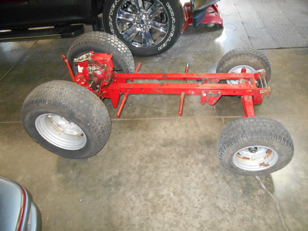

cleat 8,867 #24 Posted August 22, 2025 Tractor is slowly losing parts. Some parts degreased and washed. Some parts awaiting cleanup. 7 Share this post Link to post Share on other sites
