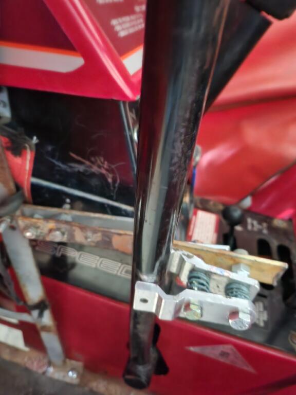

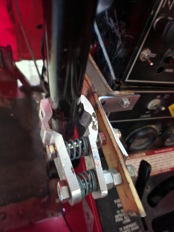

Leland 16 #14 Posted December 11, 2024 thanks for all the help and attached is a HOPEFULLY fix which took a while. If anything is rusty would have to be in the spring area on top as this tractor has always been stored in a heated garage since I had it but our son did use it for a few years but stored it in a shed and no rust anywhere I can see actually looks like a little grees or spary oil around the L shaped rod where it latches in. . Now I cannot gurantee what I did in the picture will hold up and after many tries and errors ( mostly error) then a quick ride out the garage over a slight bump and down the road a little = So far so good. Share this post Link to post Share on other sites
