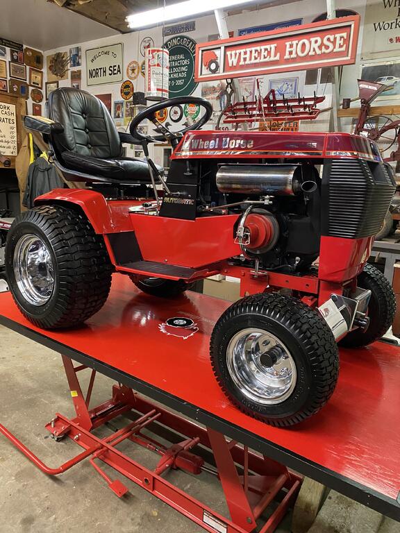

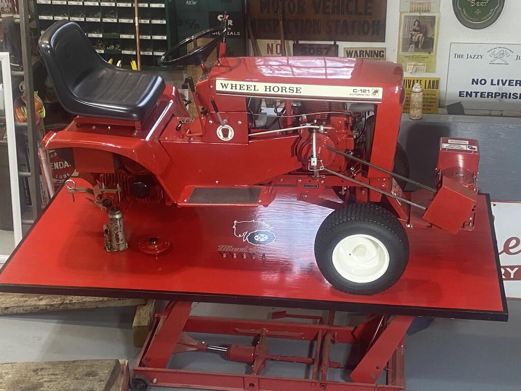

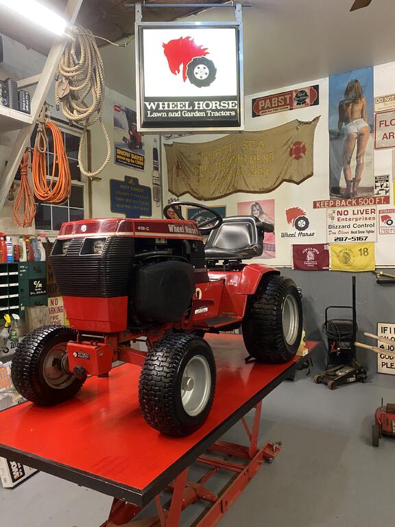

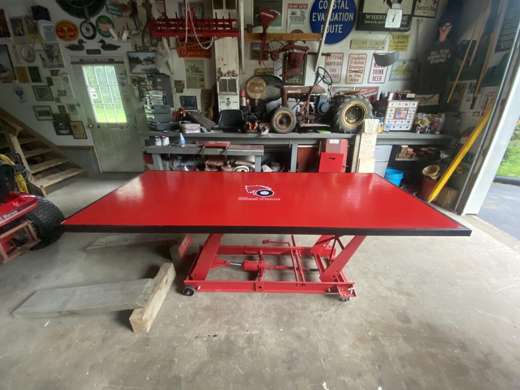

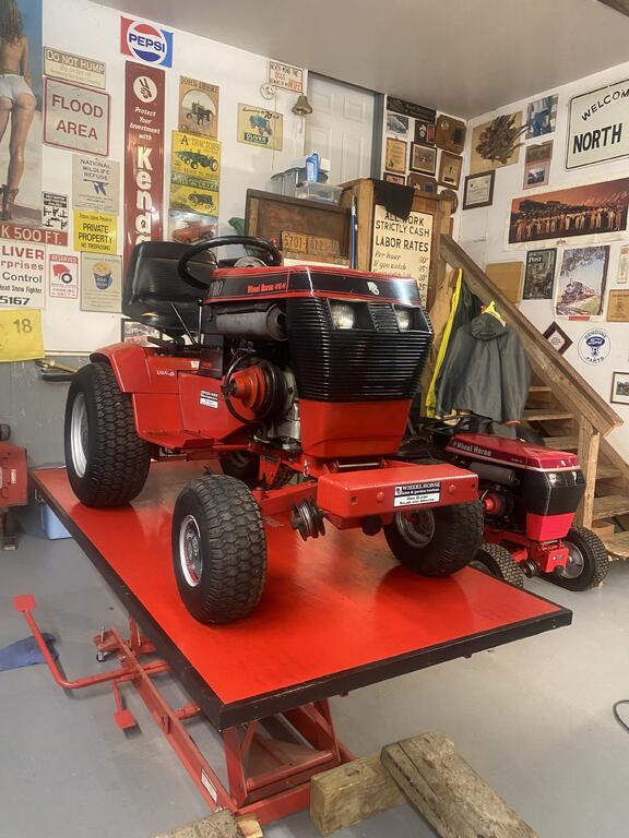

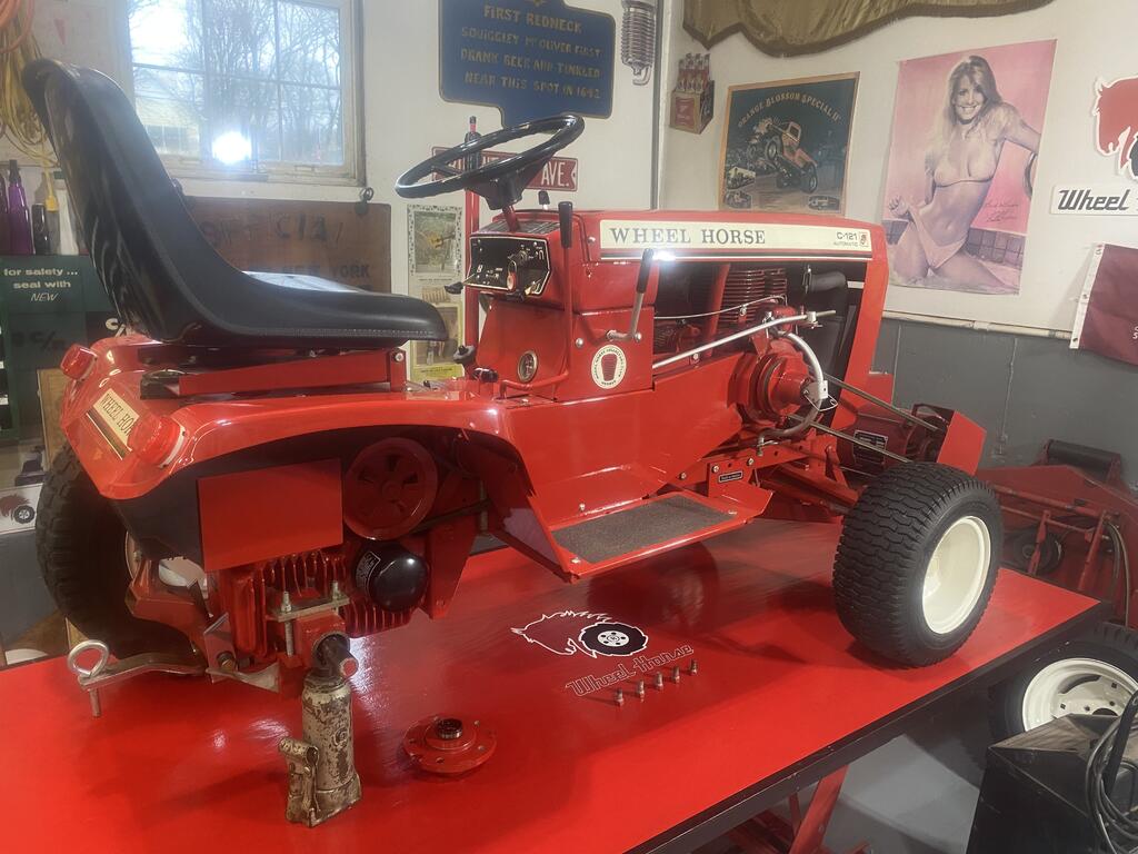

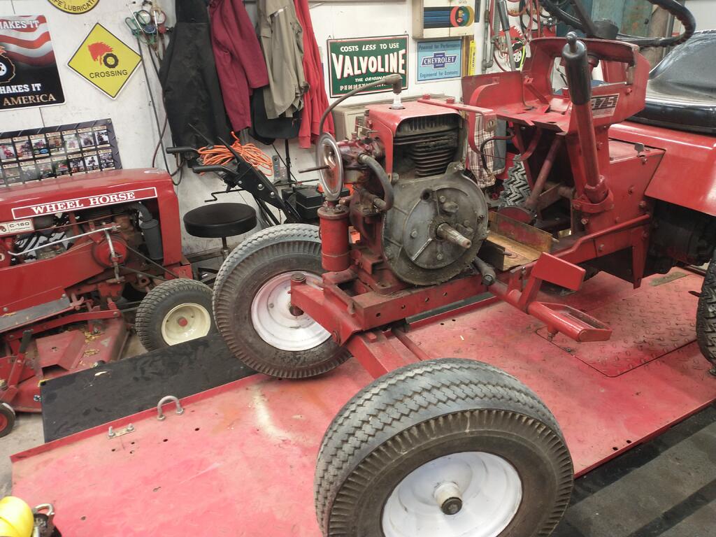

c-series don 10,255 #3 Posted December 10, 2024 Hi Dave, I have a lift table that I bought from Harbor freight. It’s a motorcycle lift that I made the top wider to accommodate my tractors. I doubled up 3/4” oak plywood and banded it with poplar. I waited until it went on sale and I think I paid around 500 bucks for it. My only regret is not buying it sooner! Since I have a bad back this is really a game changer. Now I stand up and work on them without having to stop because my back hurts. Unless I’m doing something simple it’s going on the table! You want pictures? I got em! 1 4 2 Share this post Link to post Share on other sites
dmoore 962 #4 Posted December 10, 2024 Don I had forgot all about yours! Perfect! Thank you for these photo's as well buddy! Looks to be the way to go, and its mobile! I'm sure the capacity is more than enough to handle our tractors as you show. I will be in a Harbor Freight Friday! Share this post Link to post Share on other sites

Bar Nuthin 1,172 #6 Posted December 10, 2024 19 minutes ago, c-series don said: Excuse me, sir, but you left your tractor on the workbench - just in case you were looking for it. 5 Share this post Link to post Share on other sites
dmoore 962 #7 Posted December 10, 2024 What a nice finishing touch! So it doesn't go low enough to just roll the tractor on? I see your ramps there. Share this post Link to post Share on other sites
kpinnc 14,899 #8 Posted December 10, 2024 1 hour ago, Bar Nuthin said: Excuse me, sir, but you left your tractor on the workbench - just in case you were looking for it. We now know why @c-series don back hurts if he ever complains! 6 Share this post Link to post Share on other sites

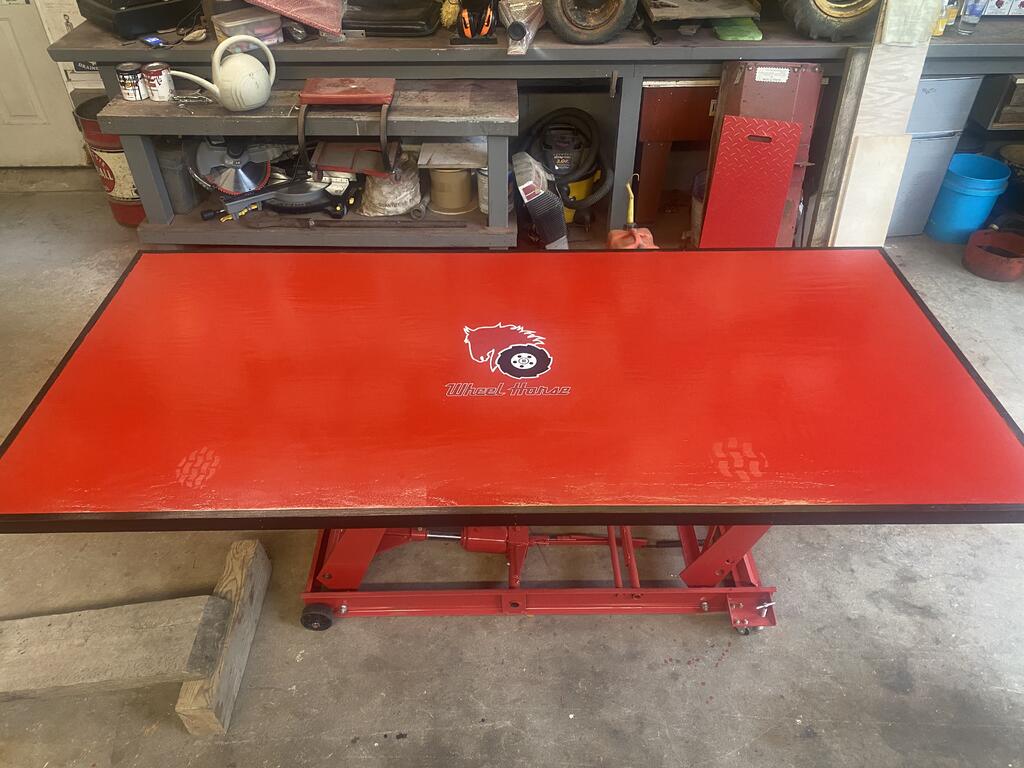

dmoore 962 #10 Posted December 10, 2024 Don could you post a few from underneath showing how you secured the oak to the frame? Share this post Link to post Share on other sites

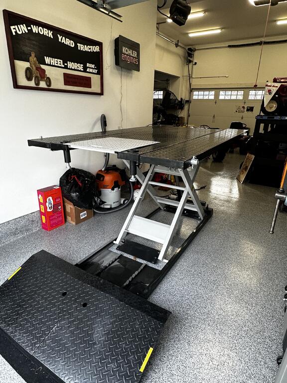

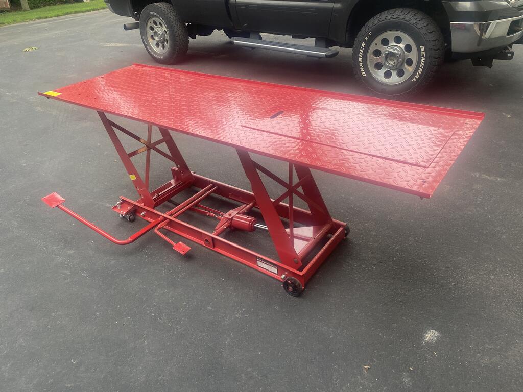

squonk 44,092 #11 Posted December 11, 2024 I got my HF table from FBMP. Tons of them on there. Mine came with removable side wings for width, heavier casters and an air over hyd jack which is a nice upgrade! 1 Share this post Link to post Share on other sites

c-series don 10,255 #14 Posted December 11, 2024 @dmoore You see how the edges of Squonks table are turned up? Mine is the same way. So I made the bottom piece three pieces, one fits inside the edges and then two pieces outside of the edge. The top is then one piece and it’s screwed together. It’s all 3/4” oak furniture grade plywood. It was actually LESS money than 3/4” CDX plywood! Funny story, when I was doing this I screwed it together from the top down. Wanting a nice smooth top, I filled the screw holes with wood filler. While doing this my brother stopped by and said “You dumb ass, if you just screwed it from the bottom up you wouldn’t be filling and sanding all those holes!!” From the factory there’s holes in the table that you can put 1” lag screws in from underneath to affix it. I still haven’t built a good ramp setup yet, so I just use some pieces of wood. Not really ideal but it works for now. 1 Share this post Link to post Share on other sites

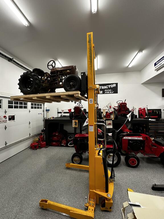

kpinnc 14,899 #15 Posted December 11, 2024 I really like that HF lift table. It’s smaller than my stand, and would work well in the garage. Maybe I’ll catch them on clearance one day. At least I hope so… I built my stand with the capability to be towed around from my old barn to my old shop. Now at the new house I don’t need that ability as much. It’s a great stand, but takes up a lot of real estate. But, I can start or finish with nothing but a standard WH frame, and go from there. For that, nothing works better! 3 2 Share this post Link to post Share on other sites

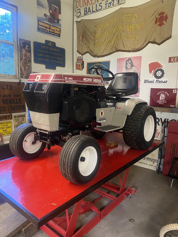

adsm08 3,461 #19 Posted December 12, 2024 On 12/9/2024 at 9:50 PM, c-series don said: I need to point out, that this sir, is not a horse. Wheeled or otherwise. 3 Share this post Link to post Share on other sites
kpinnc 14,899 #21 Posted December 22, 2024 (edited) @whtractors24 Thank you! I no longer feel that I have a tractor problem. …Because my horse stall will NEVER look like that! My bleeping living room isn’t that nice! Edited December 22, 2024 by kpinnc 1 Share this post Link to post Share on other sites
