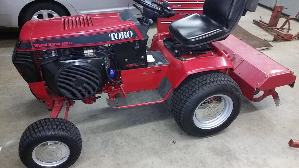

matthewg84 3 #1 Posted December 10, 2024 Hey, I'm new to forums but we have e a wheelhorse 520H and have a tiller as well for it. We can get the tiller hooked up but can't figure out the bar or chain to hookup for the hydraulic lift. Does anyone have pictures of how to hook up the hydraulic lift to the tiller? Or what arms i need? Thanks Share this post Link to post Share on other sites

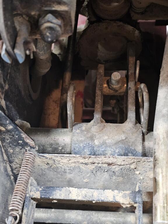

matthewg84 3 #8 Posted December 10, 2024 1 hour ago, lynnmor said: All of the parts in the previous post stays on the tractor. The only PITA when mounting the tiller is latching the right side. The bell crank needed is different than the one on it now. Does that need swapped out each time when I switch from tiller to mower deck? It's for raising the deck Share this post Link to post Share on other sites
WHX?? 58,302 #9 Posted December 10, 2024 1 minute ago, matthewg84 said: swapped out each time when I switch from tiller to mower deck? That is called the mid rockshaft and no should not have to. There should be two arms on it. The top one for the deck and the bottom for front and rear implements. Top one is tucked up underneath and almost have to lay under the tractor to see it. Share this post Link to post Share on other sites
matthewg84 3 #10 Posted December 10, 2024 1 minute ago, WHX?? said: That is called the mid rockshaft and no should not have to. There should be two arms on it. The top one for the deck and the bottom for front and rear implements. Top one is tucked up underneath and almost have to lay under the tractor to see it. Yes, the existing one on it has two arms that are the same length that the trunnion is on. The one you are talking about, the arms are different angles and I need to buy that one. I'm trying to figure out how to post pictures. Share this post Link to post Share on other sites

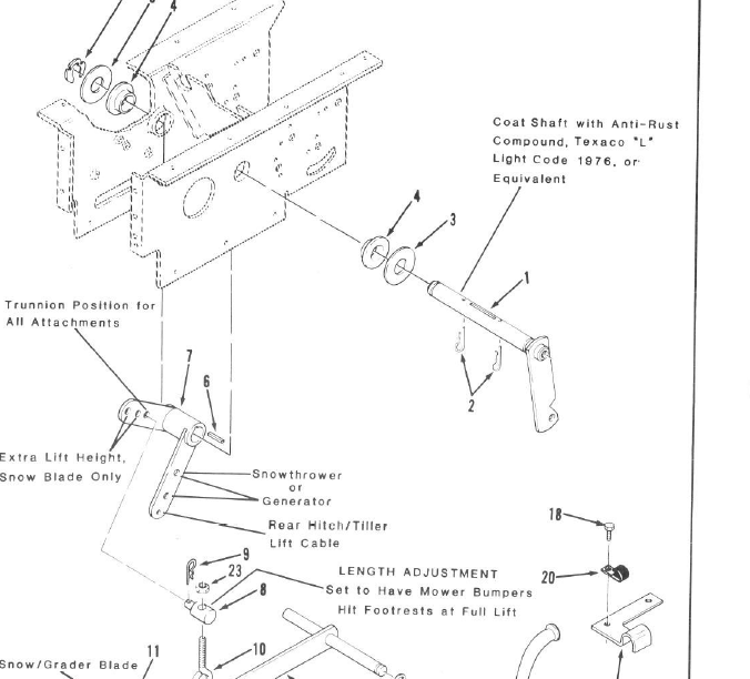

WHX?? 58,302 #12 Posted December 10, 2024 Maybe this will help you out. From a 520 IPL. You should have one of those and a operators manual for 520s. If not we can get you one we have them here. Share this post Link to post Share on other sites
Handy Don 17,558 #13 Posted December 10, 2024 (edited) 2 hours ago, WHX?? said: Maybe this will help you out. Part #7 in the diagram is the older style of mid-rock shaft with a single arm in both directions. Yours is the newer model with a double arm supporting the chain trunnion for upward lifting (for heavy mowers or mid-mount grader blades). Your lower arm will be as pictured. The cable that runs to the rear rock shaft (for lifting the tiller or other rear attachments) attaches to the lower arm of the mid-rock shaft using a long clevis & pin, runs through a tube under the hydro pump/motor, and comes out at the rear above the transaxle. Typically, it attaches to the rear rock shaft with another trunion. The tiller lift chain runs from that rear rock shaft to the tiller. The mid-rock shaft, cable, tube, and rear rock shaft all routinely stay in the tractor regardless of which implement is attached. Edited December 10, 2024 by Handy Don Share this post Link to post Share on other sites
matthewg84 3 #14 Posted December 10, 2024 1 hour ago, Handy Don said: Part #7 in the diagram is the older style of mid-rock shaft with a single arm in both directions. Yours is the newer model with a double arm supporting the chain trunnion for upward lifting (for heavy mowers or mid-mount grader blades). Your lower arm will be as pictured. The cable that runs to the rear rock shaft (for lifting the tiller or other rear attachments) attaches to the lower arm of the mid-rock shaft using a long clevis & pin, runs through a tube under the hydro pump/motor, and comes out at the rear above the transaxle. Typically, it attaches to the rear rock shaft with another trunion. The tiller lift chain runs from that rear rock shaft to the tiller. The mid-rock shaft, cable, tube, and rear rock shaft all routinely stay in the tractor regardless of which implement is attached. So it sounds like all I need is the cable and clevis with the tube that it runs through and maybe another trunnion for the other side of the cable to get my tiller to be able to lift? Share this post Link to post Share on other sites
Handy Don 17,558 #15 Posted December 10, 2024 1 hour ago, matthewg84 said: So it sounds like all I need is the cable and clevis with the tube that it runs through and maybe another trunnion for the other side of the cable to get my tiller to be able to lift? Maybe. The most common lift setup is the cable, tube, rear rock shaft, tiller chain setup. This is described in the tiller owner manual with pictures and install instructions. SOME members skip the rear rock shaft and fashion a cable direct from the mid-rock shaft to the tiller. Pros: fewer parts. Cons: extra friction on transaxle, trickier cable length adjustment, harder to use for lifting a sleeve or slot hitch implement, extra cable hanging out when tiller is off. These folks tend to have an always-mounted tiller. ALL tractors have a factory-installed mid-rock shaft, either manual, hydraulic, or electrically powered. SOME tractors have a factory-installed tube for the rear lift cable (model- and year-dependent). If yours does (likely, as it’s a 520), you’ll find the exit for the tube at the rear (yellow arrow below). I don’t think ANY tractors had a factory installed rear rock shaft, including the connecting cable. These were a dealer- or owner-installed option. If you bought a titler from the dealer they would make sure you got it. If you do have the rock shaft, it’ll have an arm (to which the cable end would attach with a trunion) hanging down just to the rear of the cable tube exit. Likeliest in your situation is the tube is there and you need this kit from Wheel Horse Parts and More for the cable, clevises, bushings, and rock shaft. If you do not have the tube, you’ll need the kit that has the tube and clamp. Share this post Link to post Share on other sites

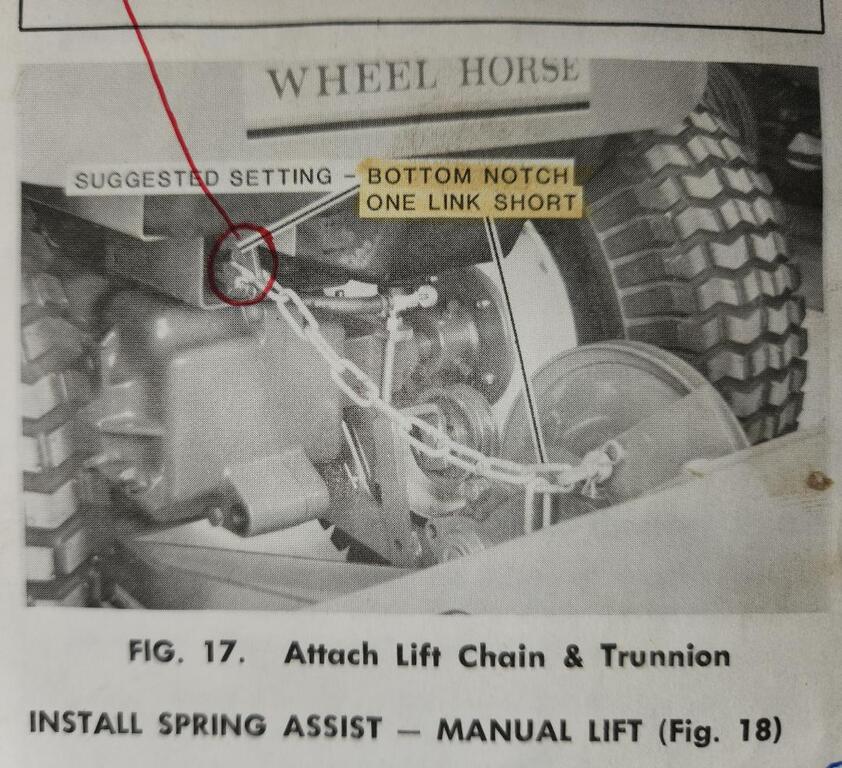

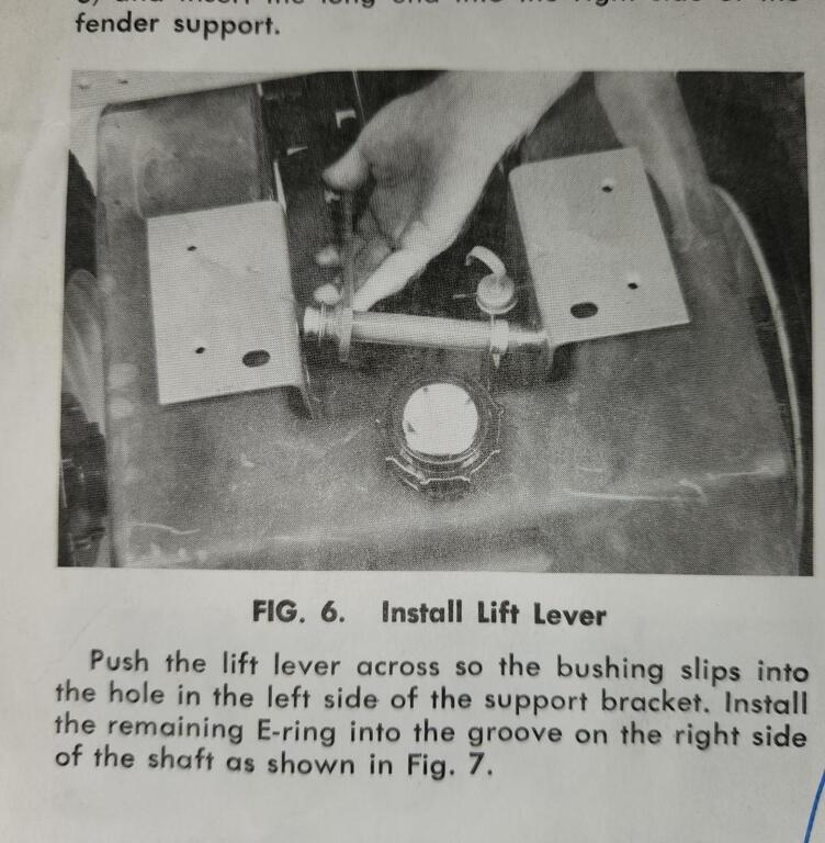

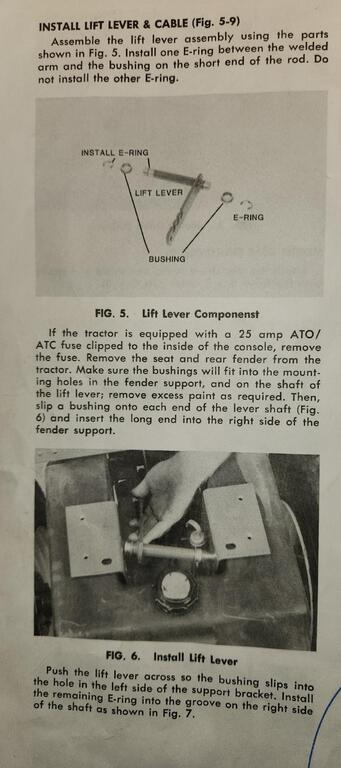

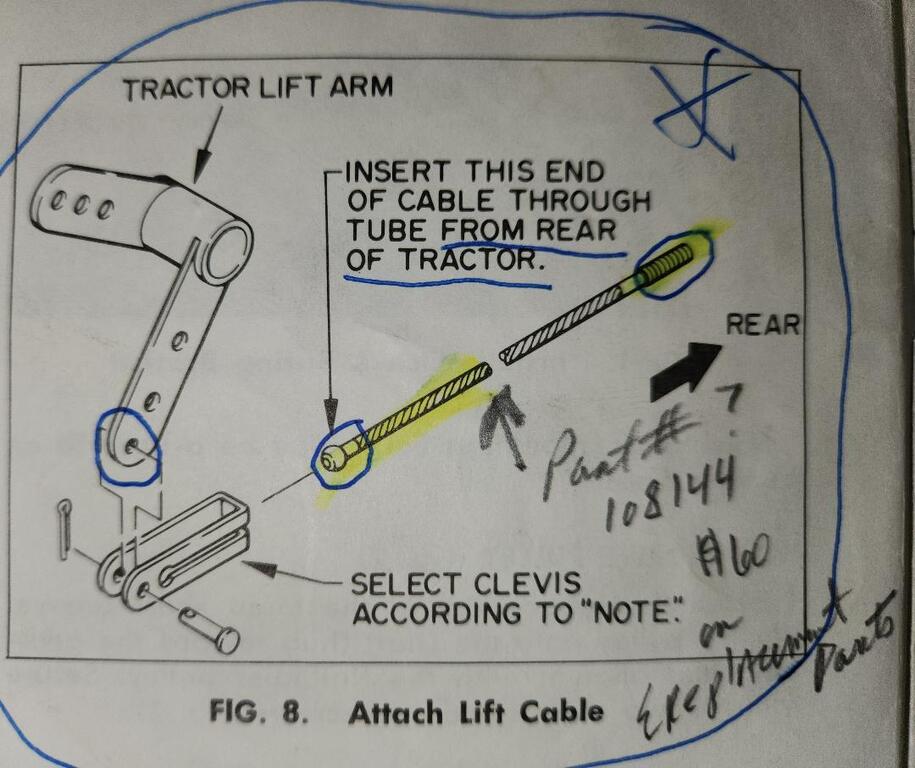

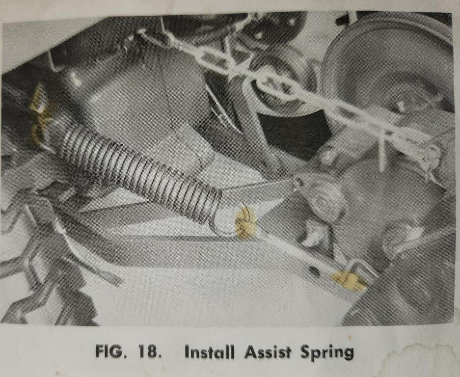

Brockport Bill 2,479 #20 Posted December 11, 2024 i did not search the manual section here -- but i am hoping they have a tiller manual for you to down load???????? if not - here are a couple relevant photos from my tiller manual 1 Share this post Link to post Share on other sites

matthewg84 3 #22 Posted December 11, 2024 46 minutes ago, Brockport Bill said: i did not search the manual section here -- but i am hoping they have a tiller manual for you to down load???????? if not - here are a couple relevant photos from my tiller manual I did get one downloaded. Thank you for these, they definitely help. Share this post Link to post Share on other sites
