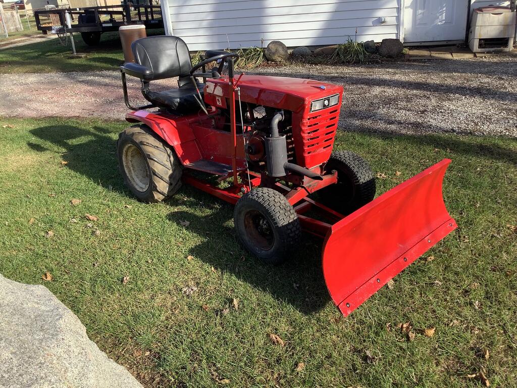

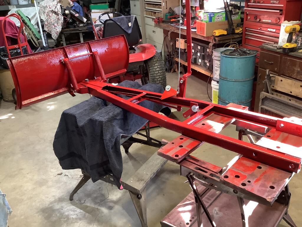

CRF857 1,139 #1 Posted December 9, 2024 Acquired a well used snow blade. Decided to primp it a little before mounting. installed it on an Electro 12 that had been repowered with a kohler 16 hp. And cone clutch. Disassemled, cleaned primed and topcoated. Temp have been in the low 50s so parts got hung in shop bathroom with a heater going to help the drying process. Put it all back together today. 4 9 Share this post Link to post Share on other sites

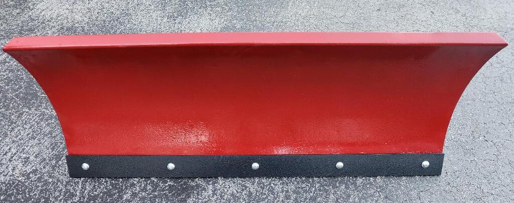

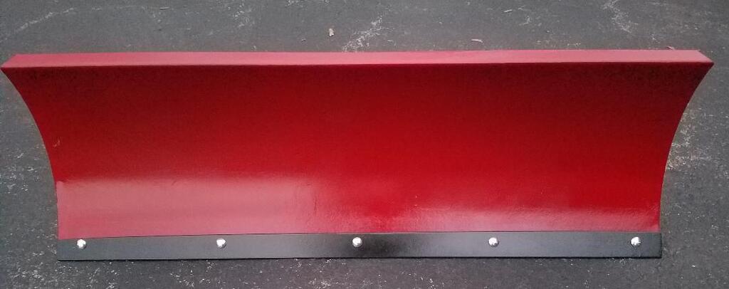

Brockport Bill 2,478 #4 Posted December 10, 2024 i have rehabbed various plows - some in pretty ugly condition - cleaning/sanding or blasting off the rust -- then primer paint, then final red -- usually a new "wear edge" blade, plus new carriage bolts -- and typically rehab to the springs and rods - always a worthwhile project 4 Share this post Link to post Share on other sites

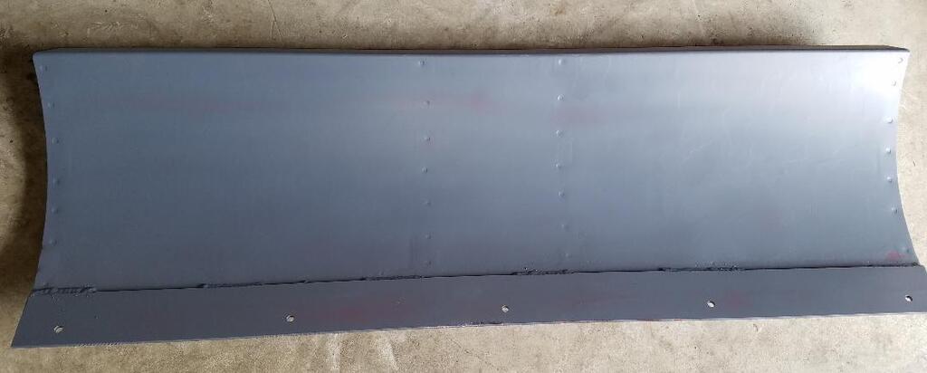

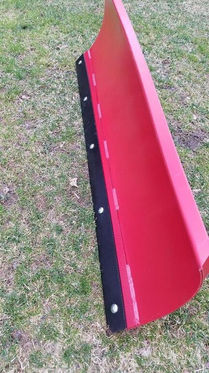

Brockport Bill 2,478 #6 Posted December 10, 2024 2 hours ago, Bar Nuthin said: Any recommendation for one that's twisted? i try to avoid getting a plow that has any significant bend or deformity -- but i suppose heat and a hammer would maybe have some success? I suppose you could take it to a welder fabricator shop that maybe with heat and some press type tool could do some rehab realignment ?? As a side note i see the bottom of blade was so worn through the wear edge blade it actually wore up through the carriage bolt holes in the blade itself -- One plow i got had that problem and couldn't even hold the bolts so i took to fabricator and had him weld an extension piece on bottom of blade - then he did new holes for carriage bolts --- then i was able to install new wear edge bar over those holes in the extension - - you can see the weld marks in the photos i attached above on the one plow blade 1 Share this post Link to post Share on other sites
SylvanLakeWH 32,558 #7 Posted December 10, 2024 6 hours ago, Bar Nuthin said: Any recommendation for one that's twisted? When on a worker for working - Heat, hammer, drill new holes, use new wear bar to even it out, paint it and go... to a degree the top doesn't matter... it pushes snow, not diamonds... 2 Share this post Link to post Share on other sites
